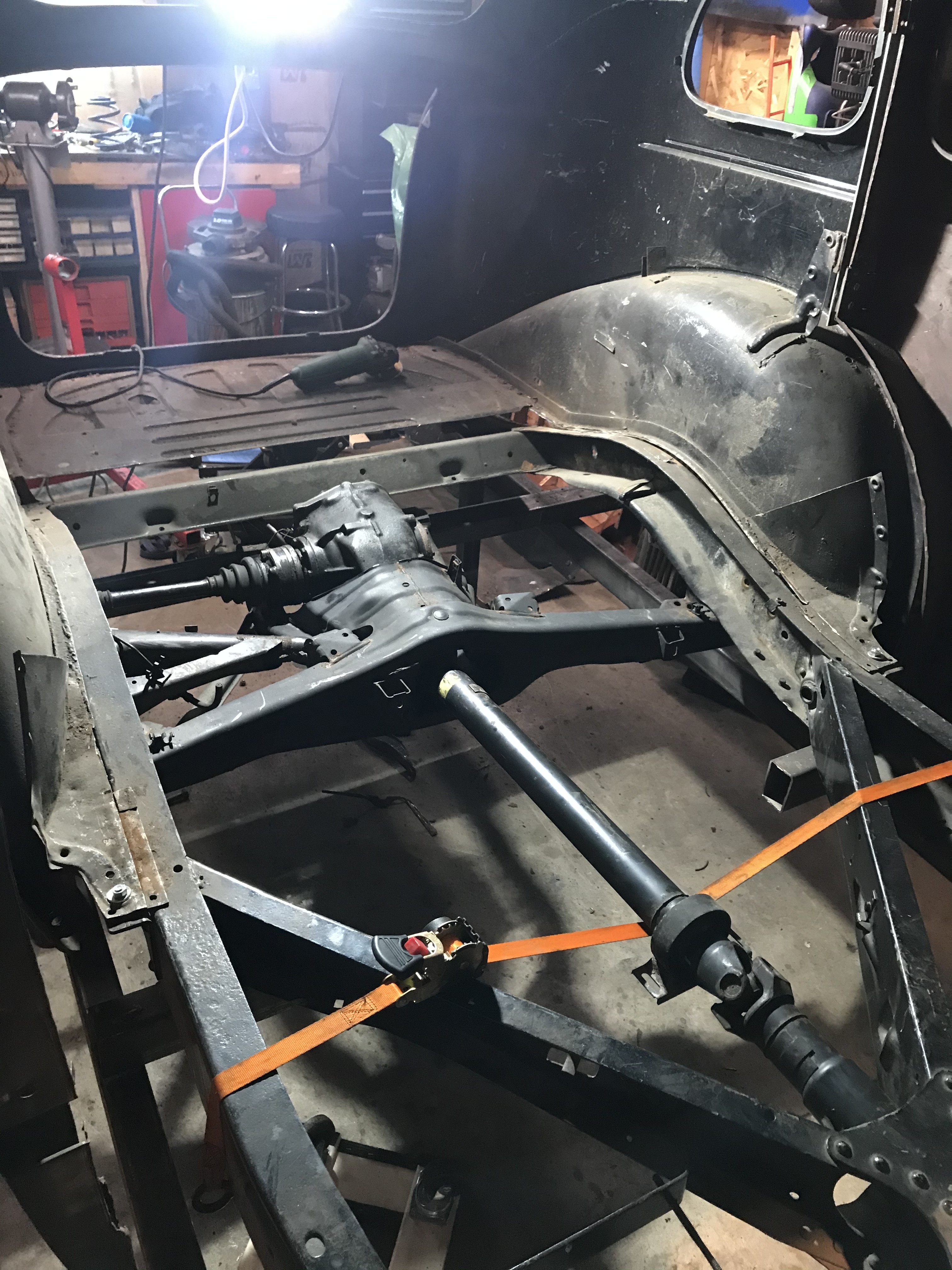

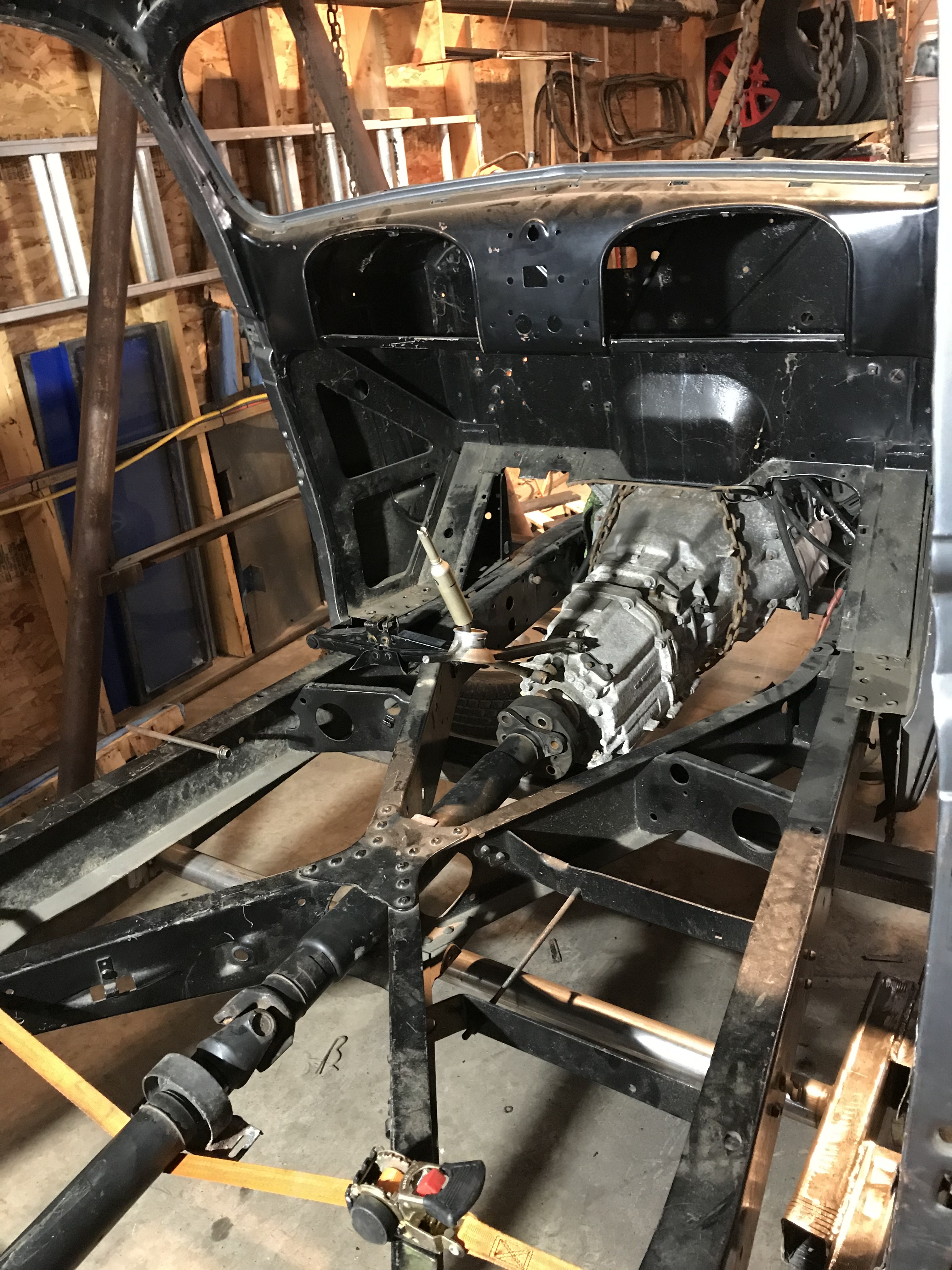

    Today’s progress flipped the frame back over and set the body back on. Dropped the motor in and line up the drive line components.
    Up next motor mounts and rear sub frame modification. I have to finish weld the the front subframe. And waiting on rear wheel from bassets racing.  So I can start string lining gauging for. Rear sub Frame mounts.

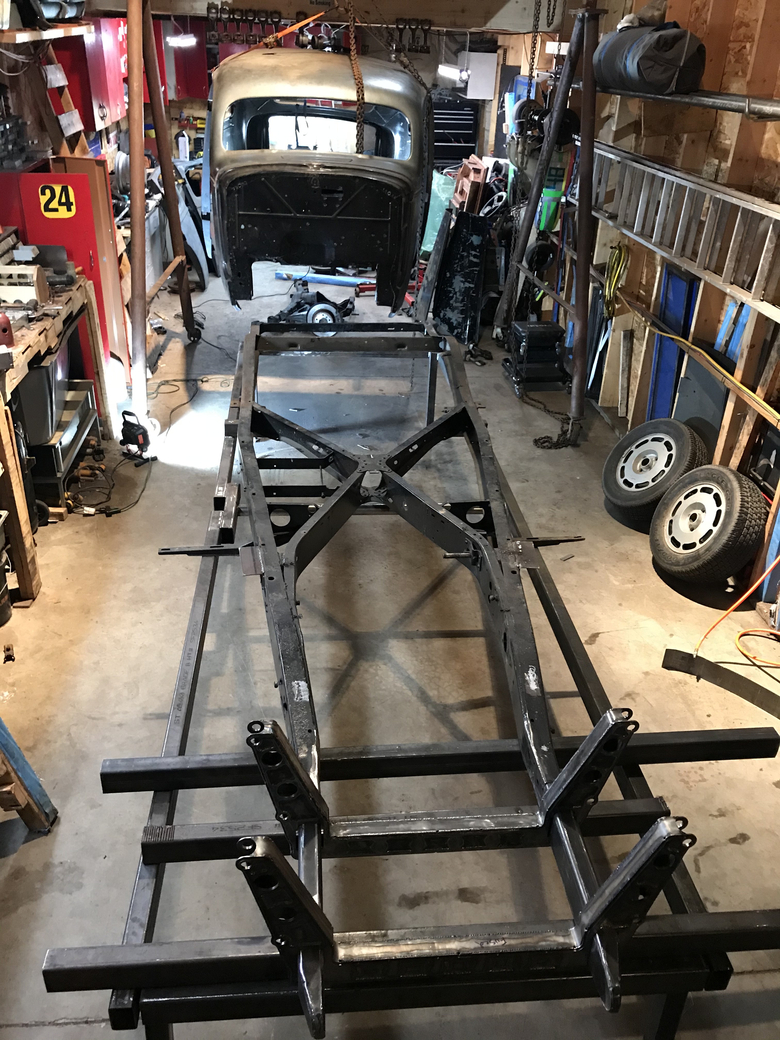

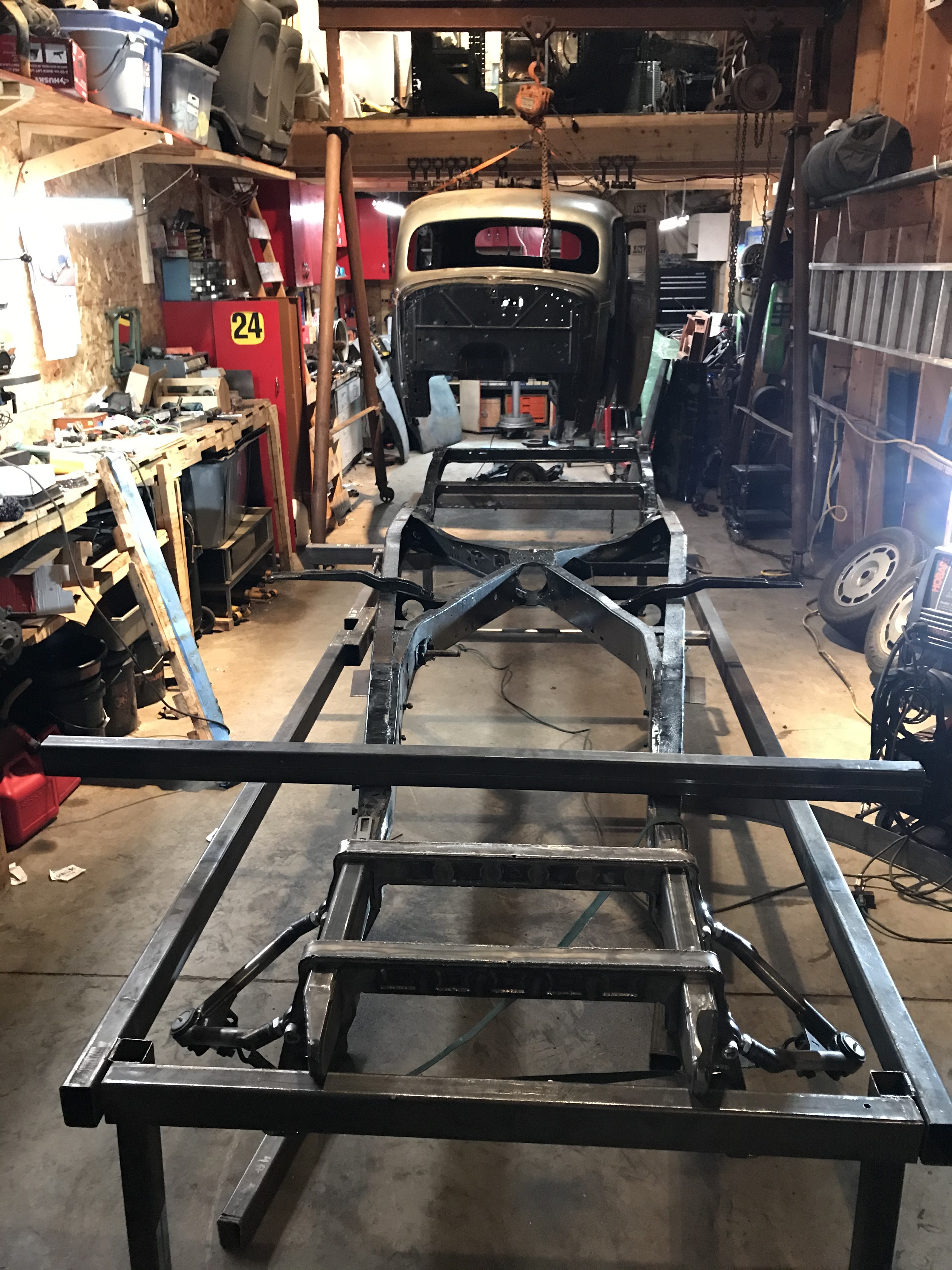

  • 540i Swapped Rat rod Build thread
    ThatRatRodProjectT ThatRatRodProject
    Members BMWs

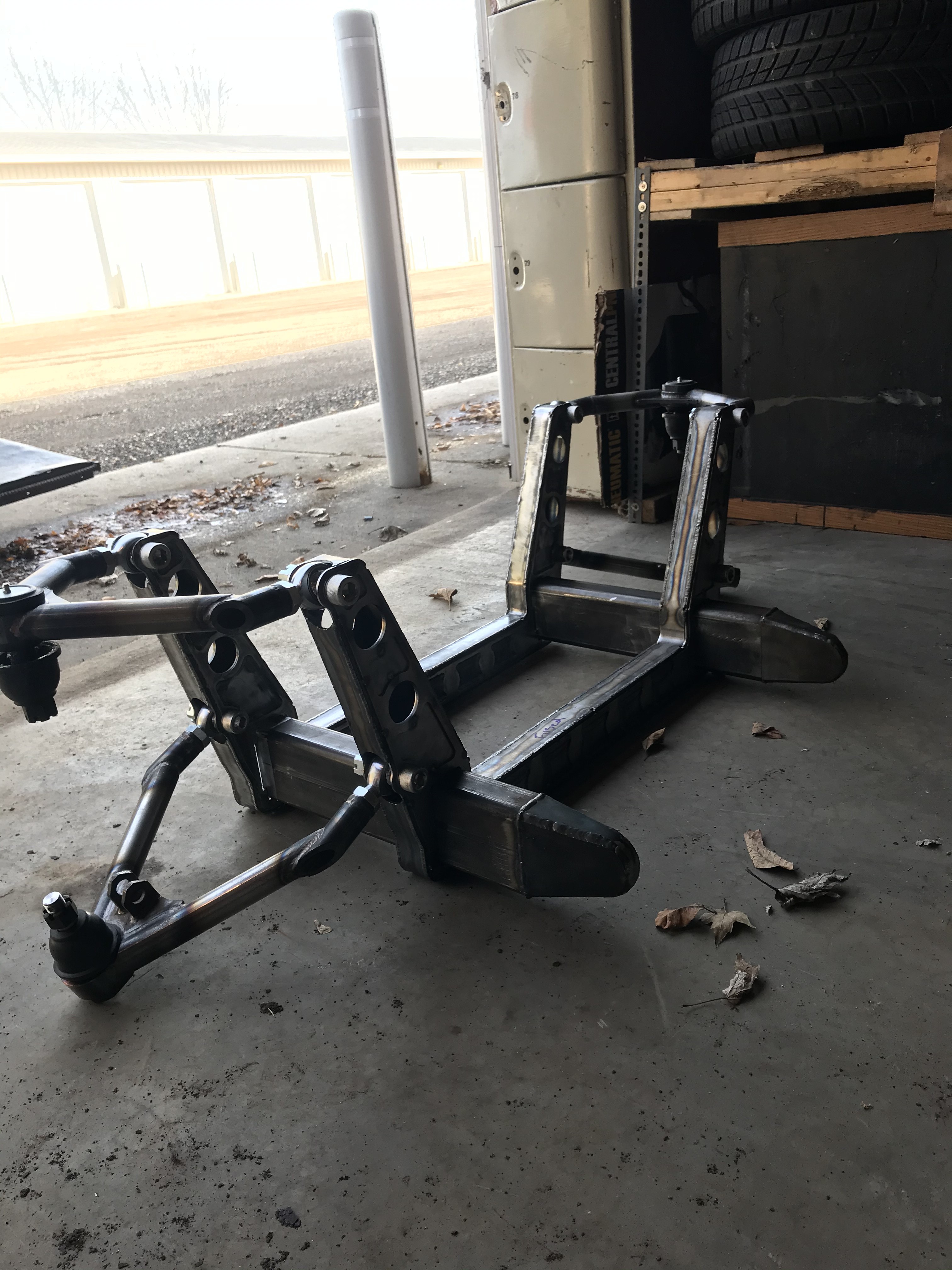

    Pulled the frame out from underneath the car and worked on getting the front end mounted to the frame. Holiday week is letting me get some shop time in. I’m just waiting on the rear wheels  From basset racing. and then I will have everything to make it a roller. Glad to see all me card board templates and napkin drawings are working out.

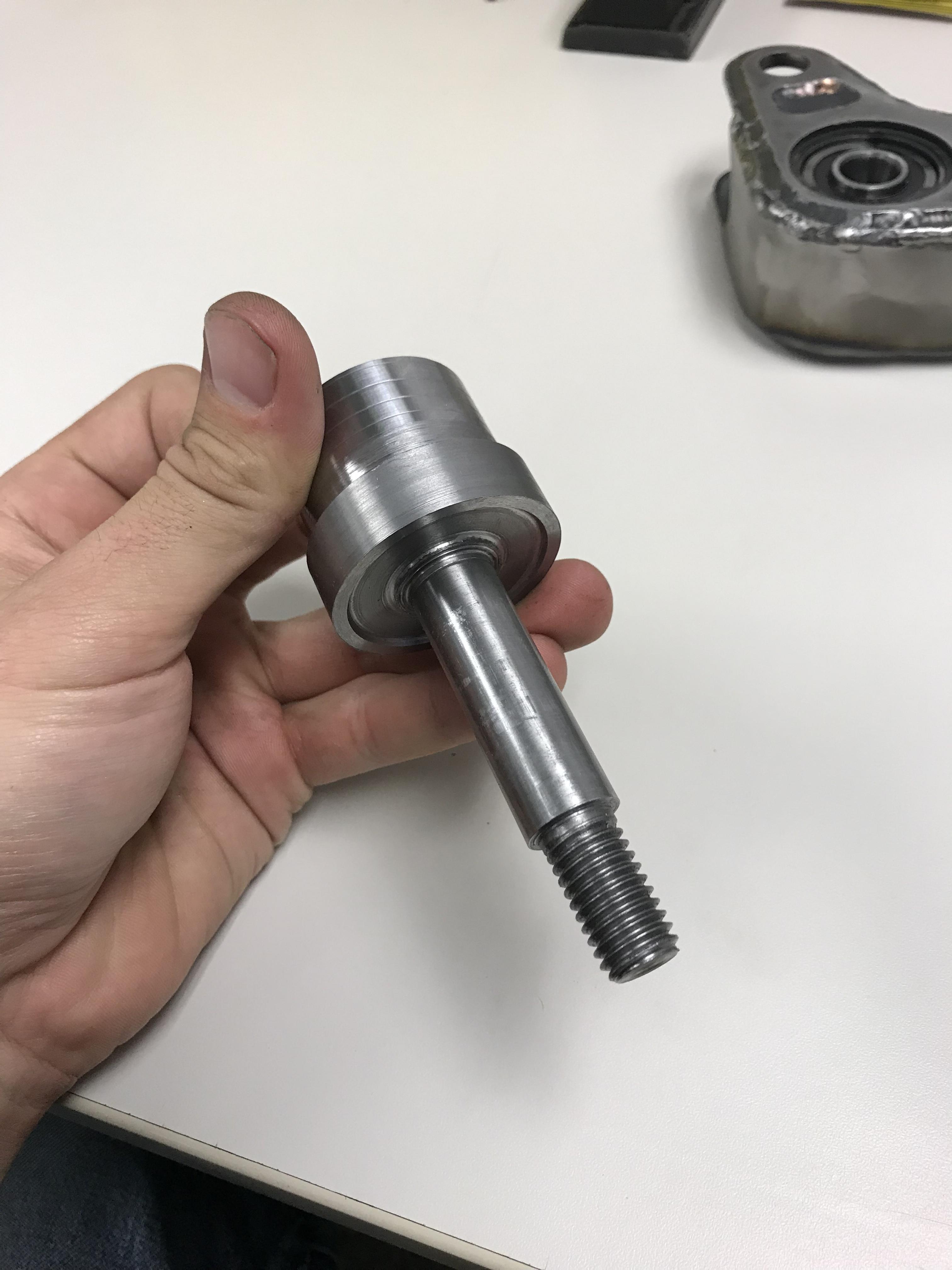

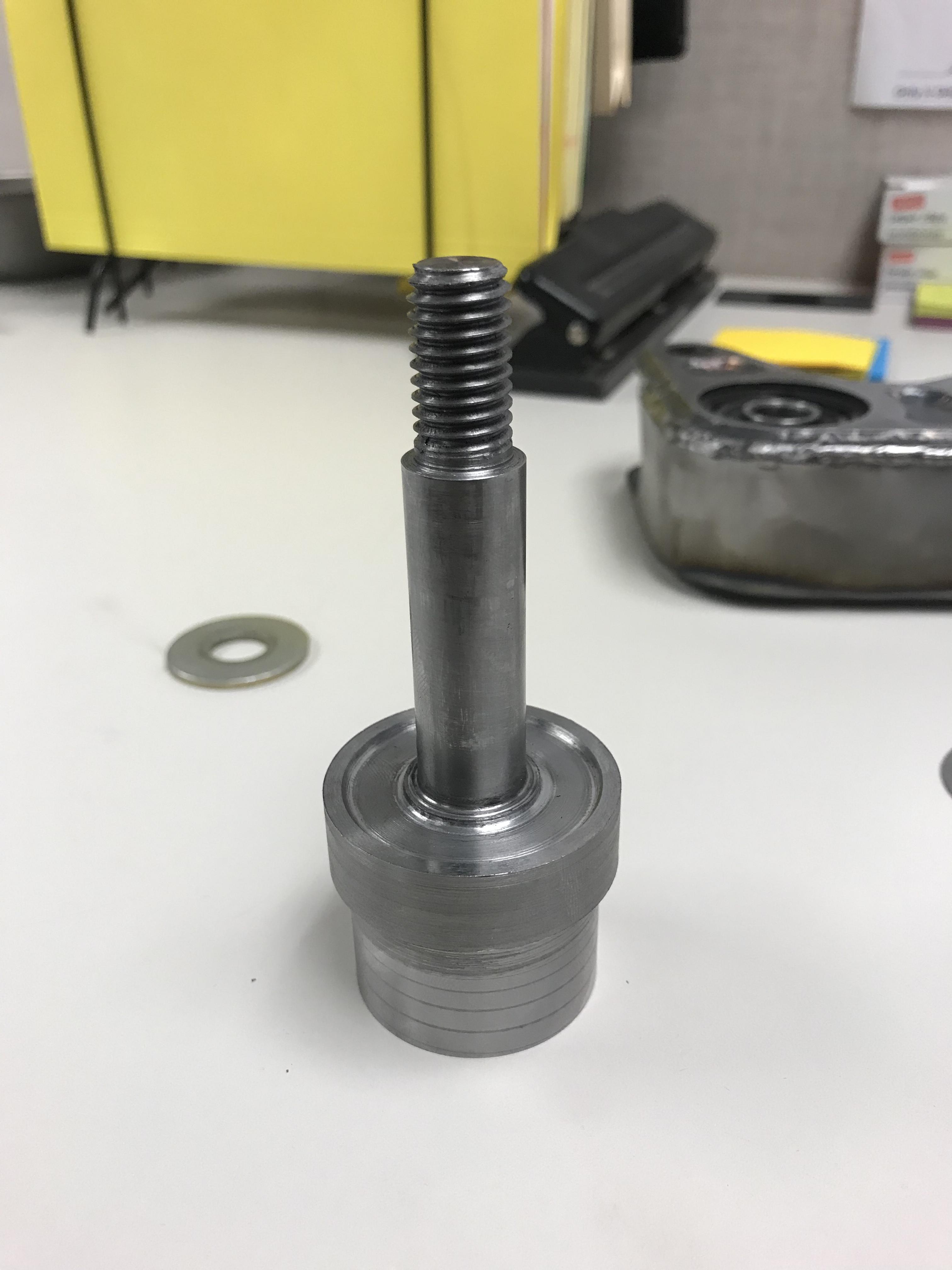

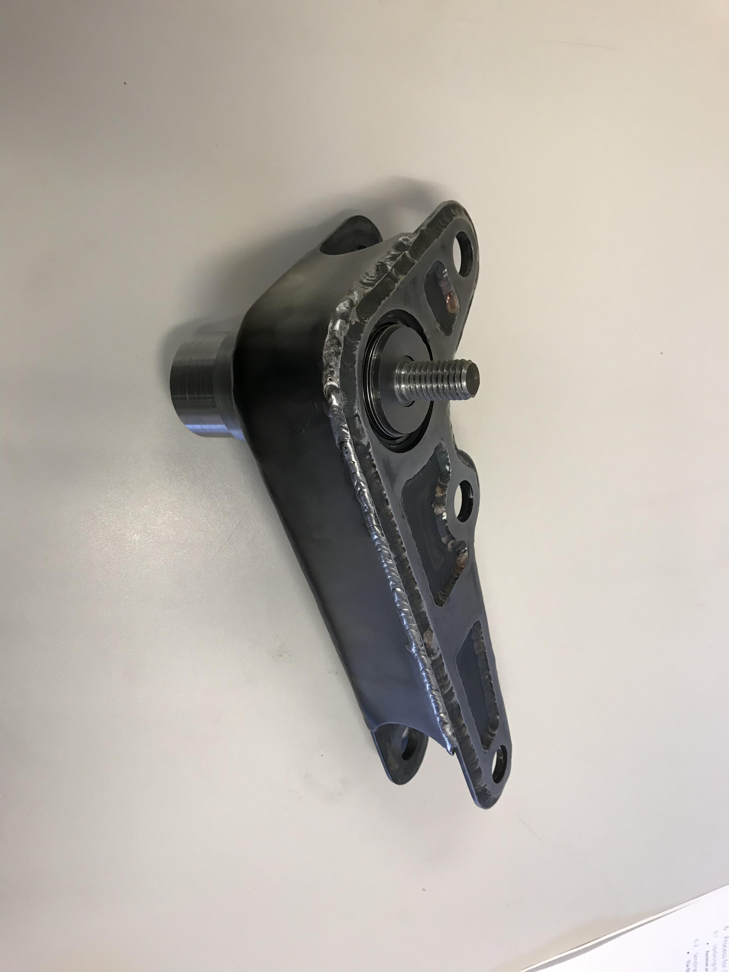

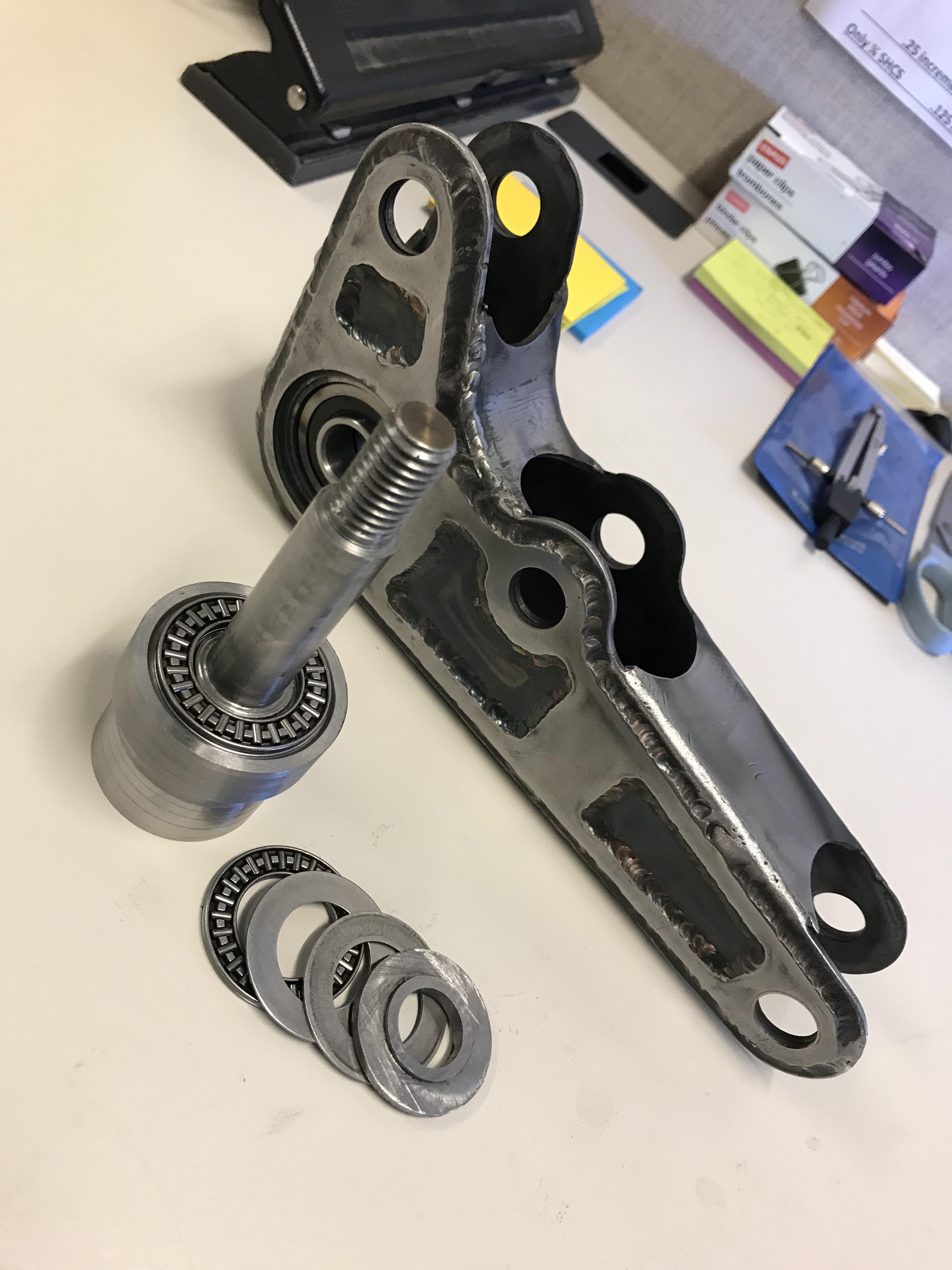

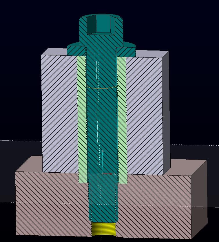

    Great work man! You may also consider using oil impregnated solid thrust washers instead of roller bearing thrust washers if the loads are low enough and you want to improve environmental protection.
    The castle nut is a great idea
    I would like to possible try 3d Printing some bushings for weather protection. Out of some soft filament. Or Nylon
    Members BMWs

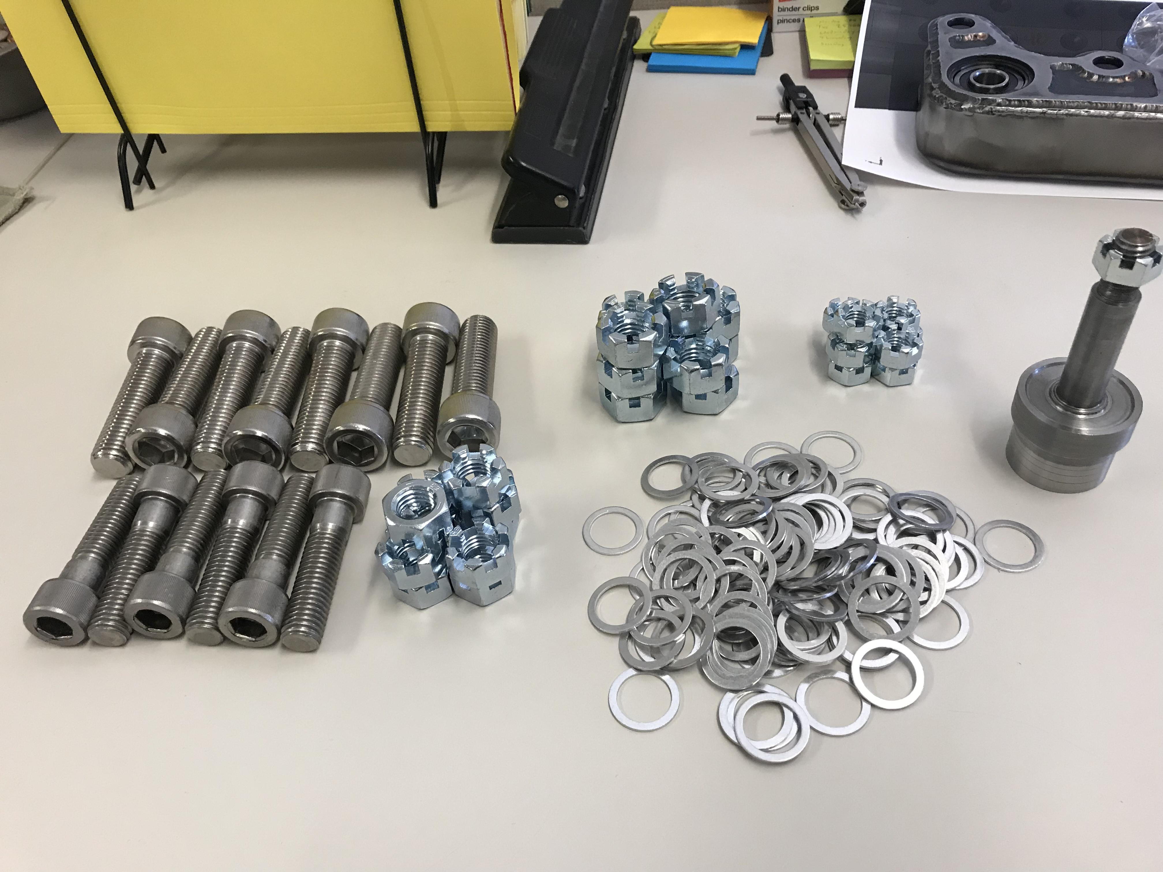

    RobZR said:

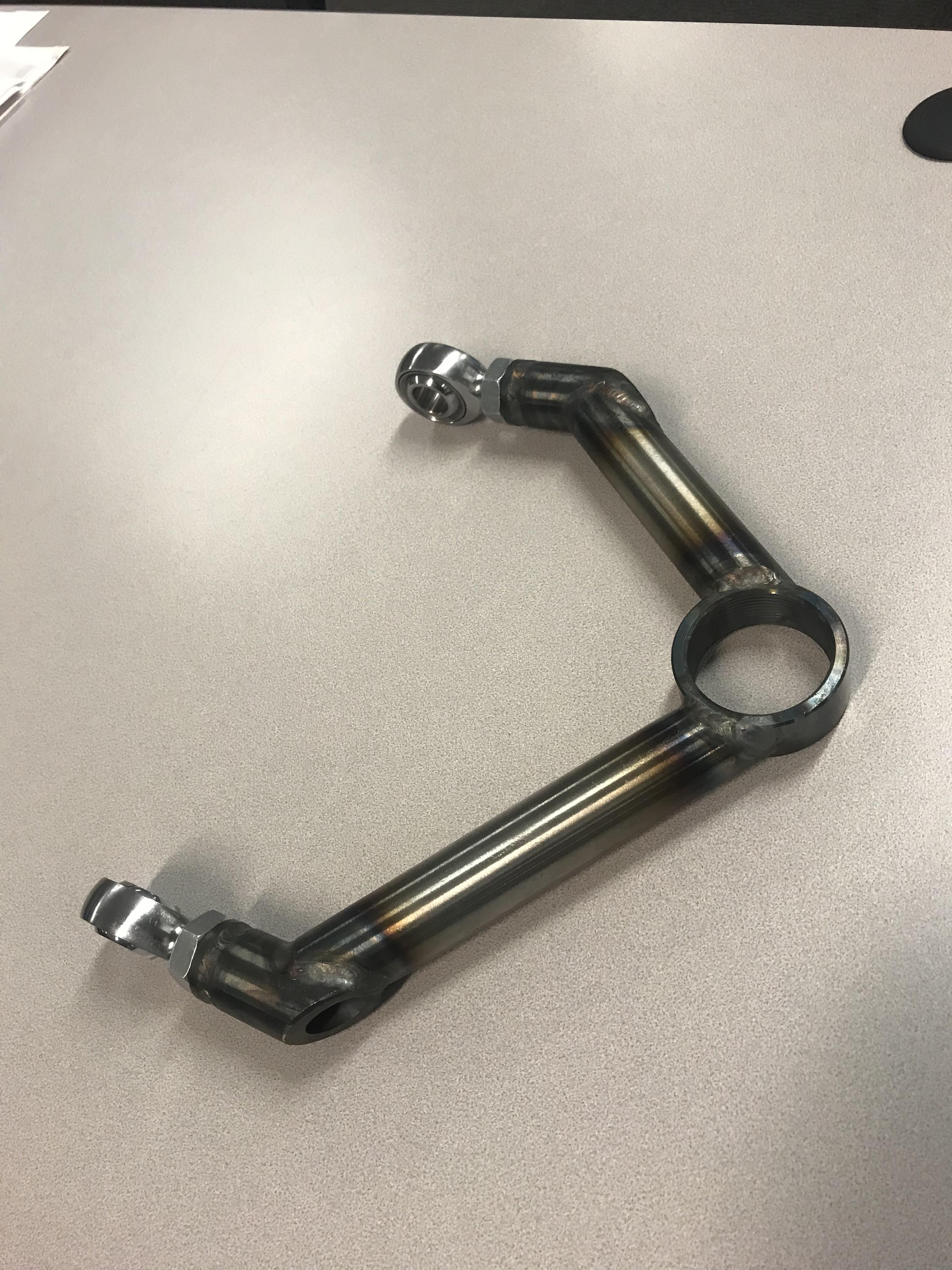

    With some help from RobZR. I believe we have reached a much safer option from using a shoulder bolt. I made up this spindle design last night. This will have a castle nut and cotter pin in its end form. I did tighten it all down and I’m very pleased with how it turned out. zero play.
    Members BMWs

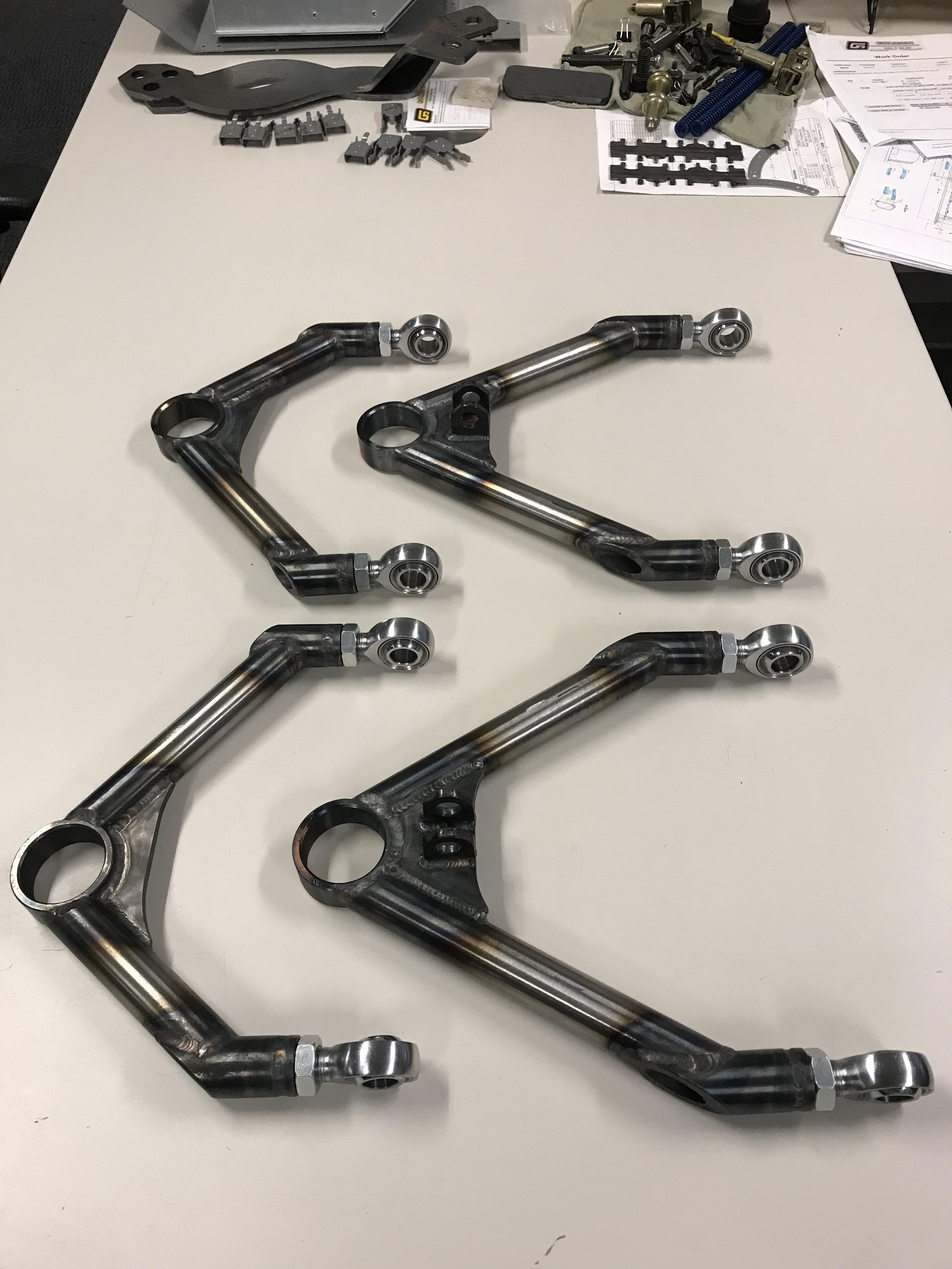

    All 4 done and ready to go. They will be powder coated in the future but first I gotta get some mock-up done.

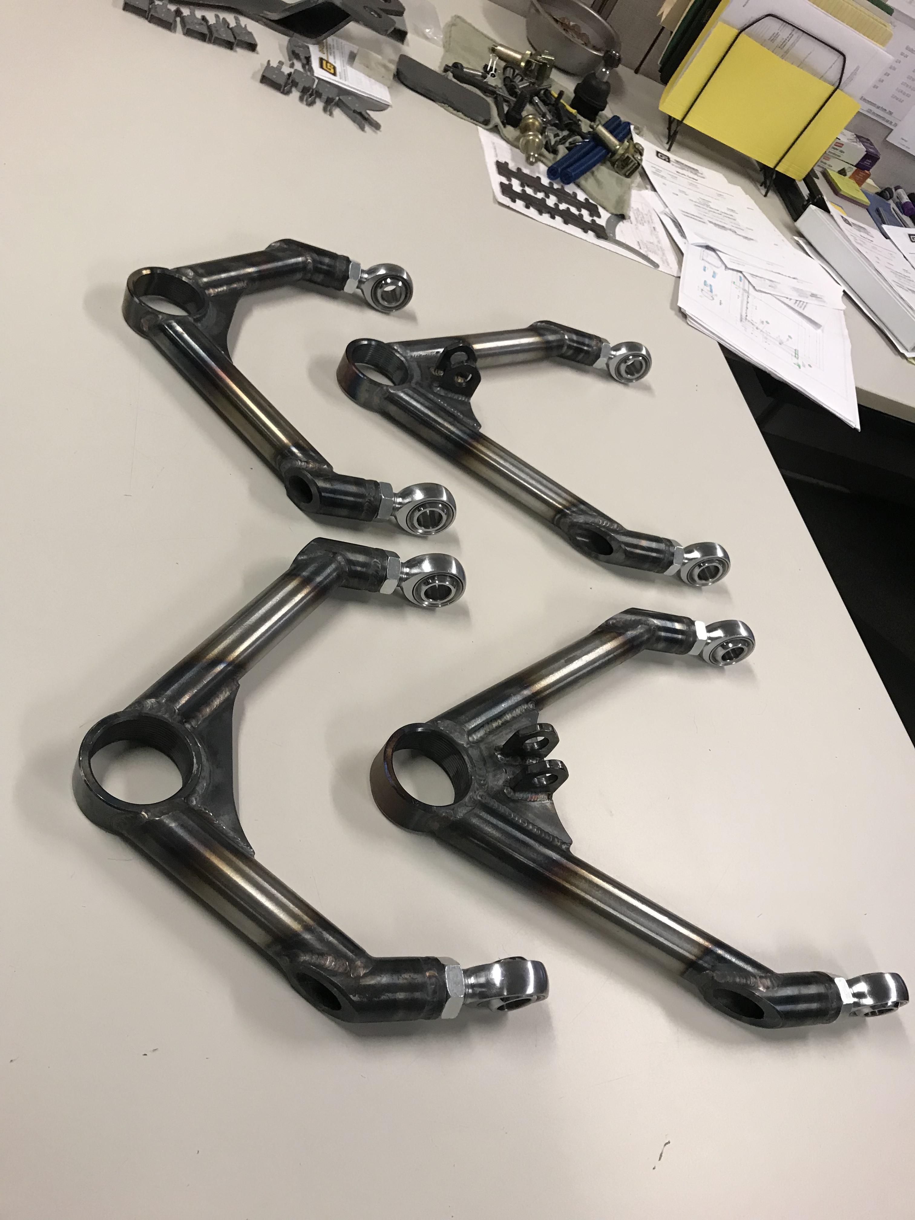

    Members BMWs

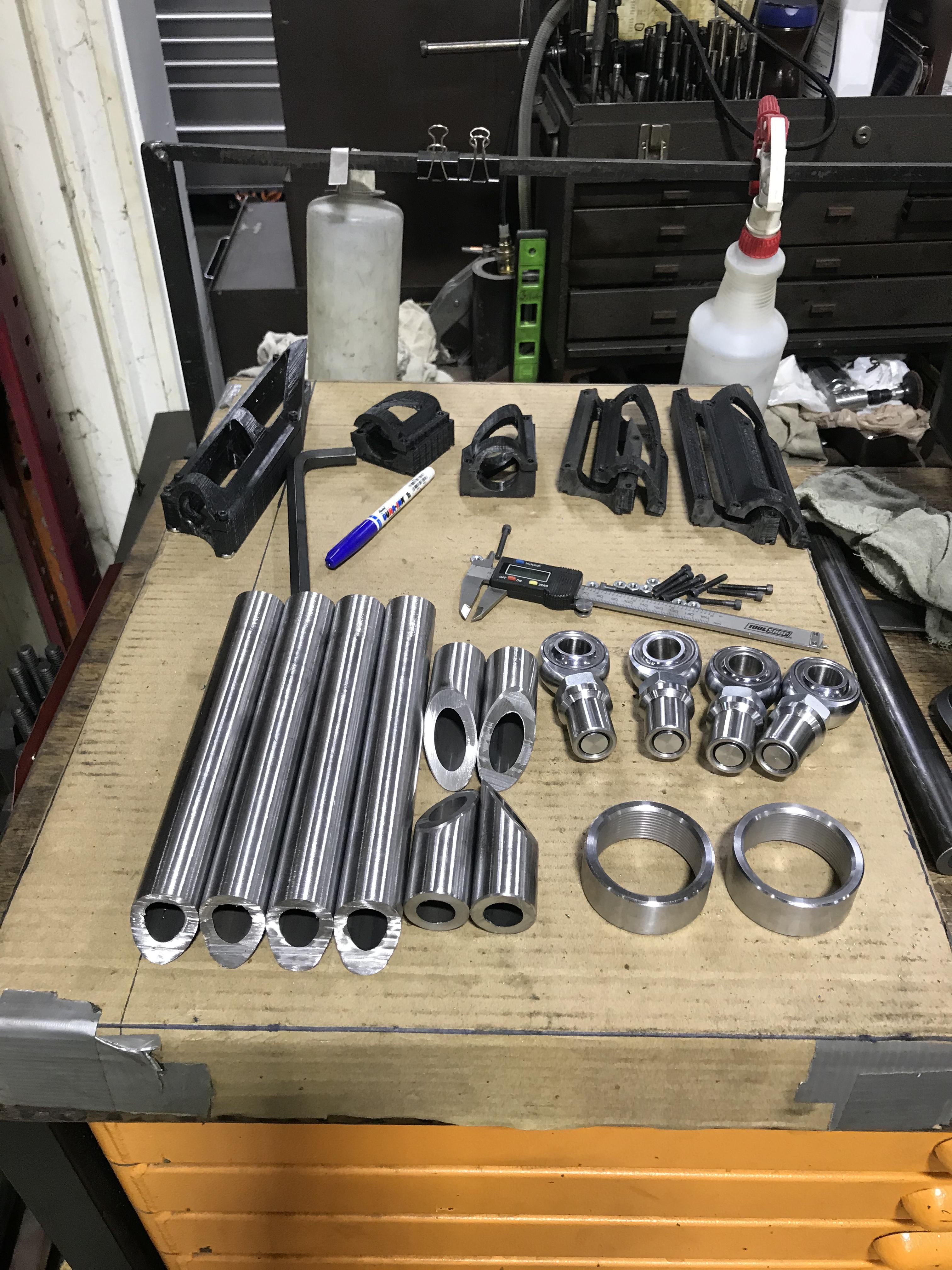

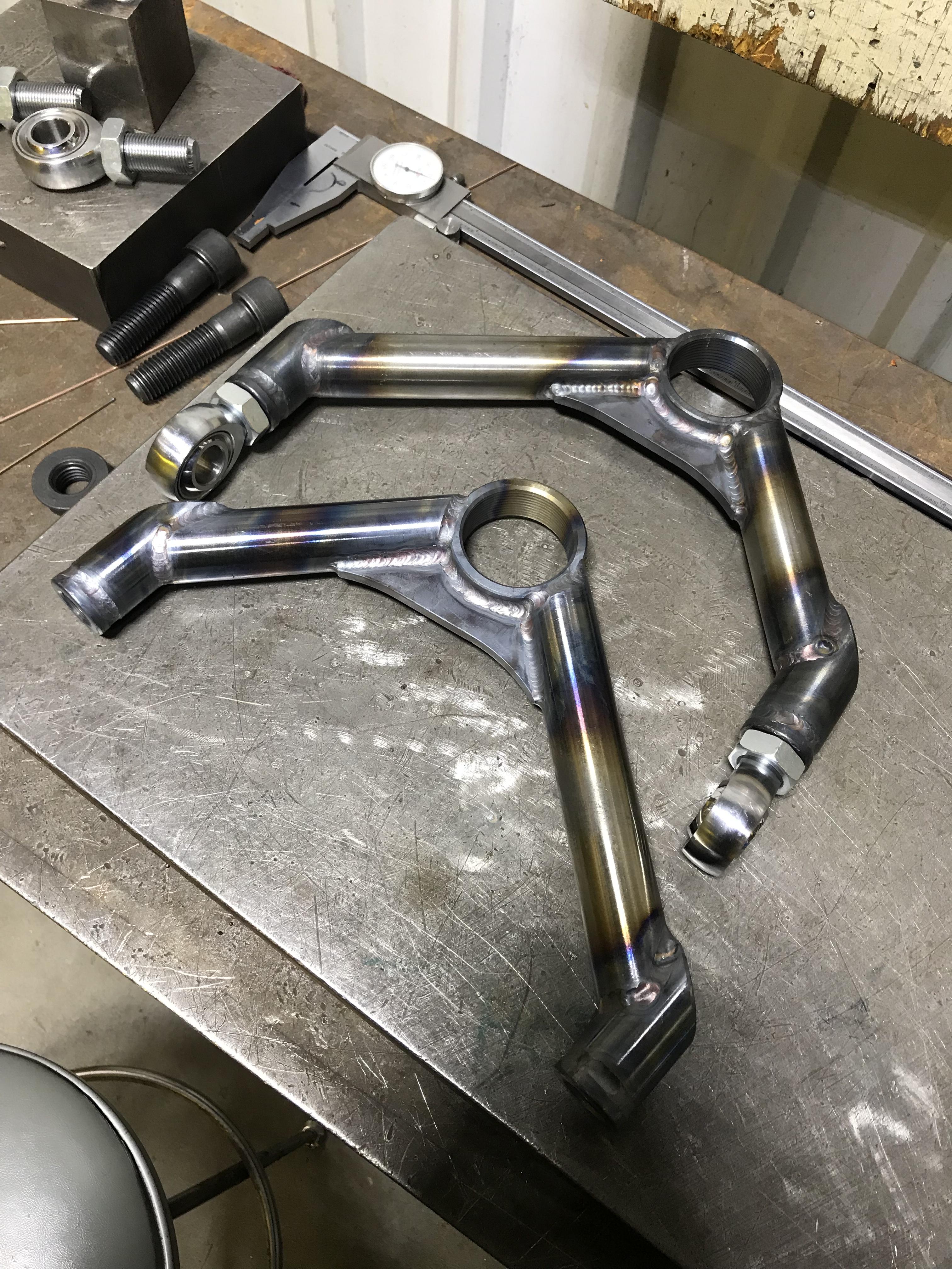

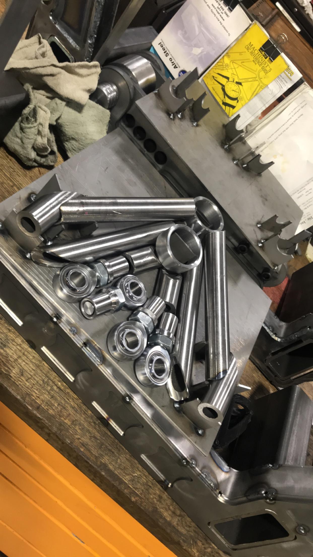

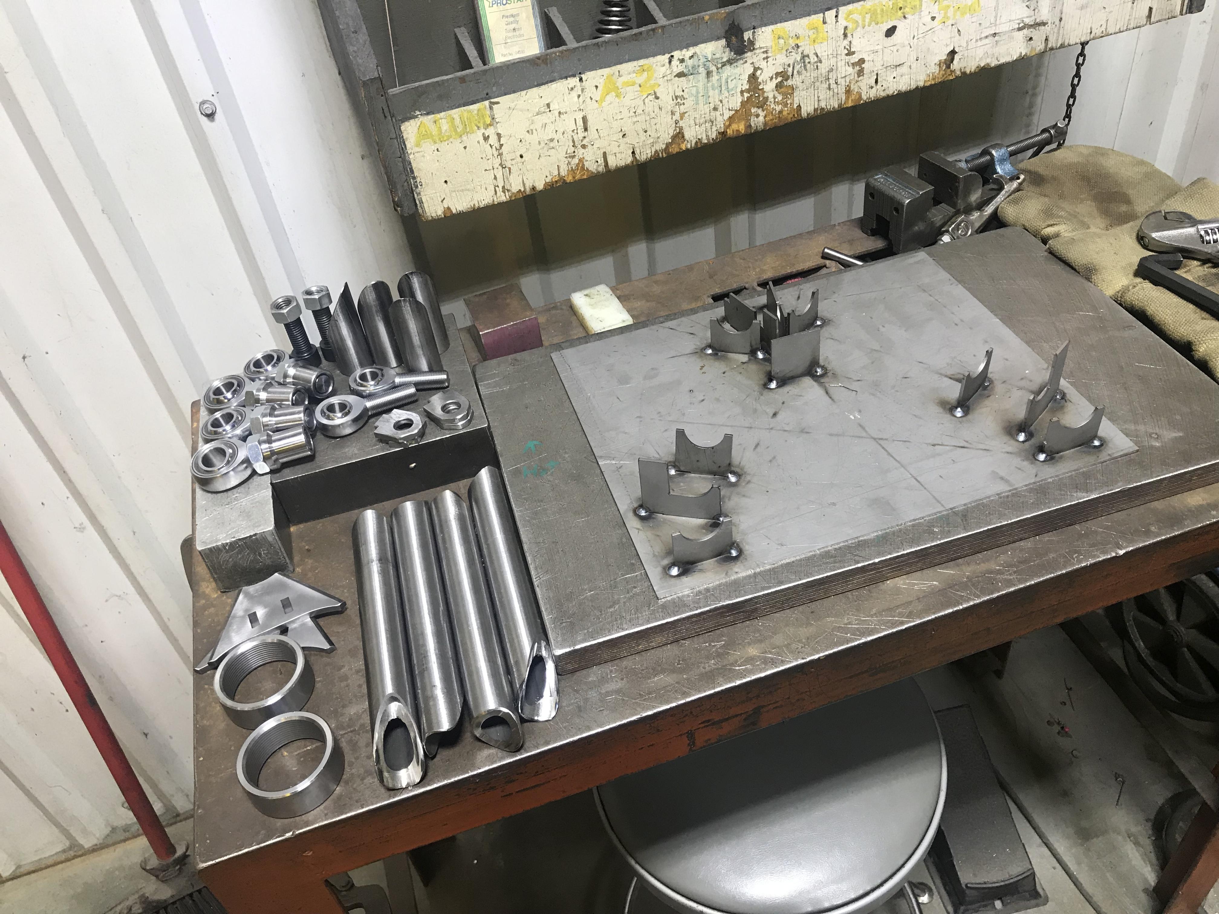

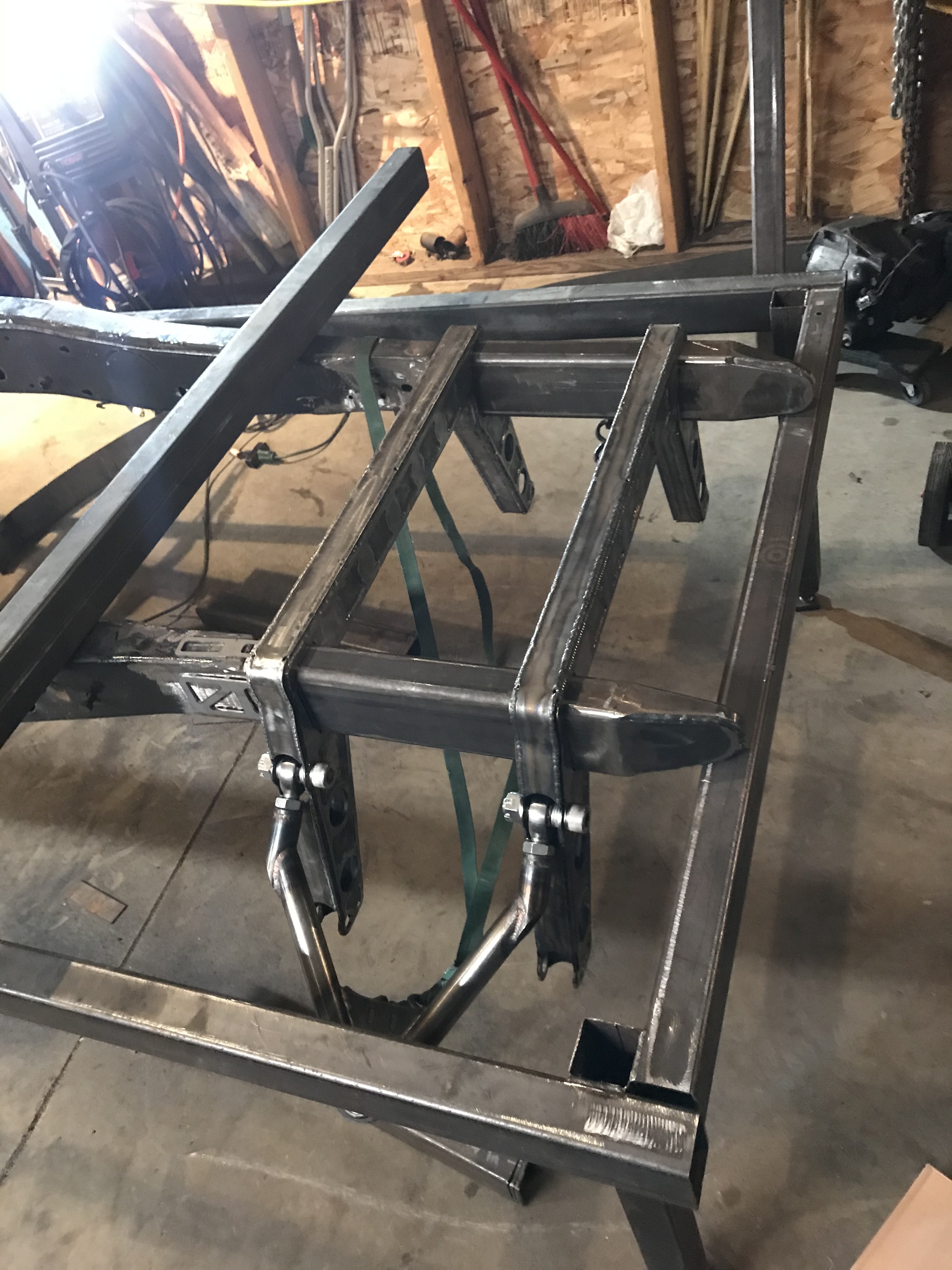

    Update.
    I gotta finish welding up the last control arm but here’s 3 of them.
    I used 3d printed jigs to replicate the tube lengths and made up a quick fixture.
    AD34B246-ADD6-4A4C-8B34-FB7E0FD25502.MP4
    • AD34B246-ADD6-4A4C-8B34-FB7E0FD25502.MP4
