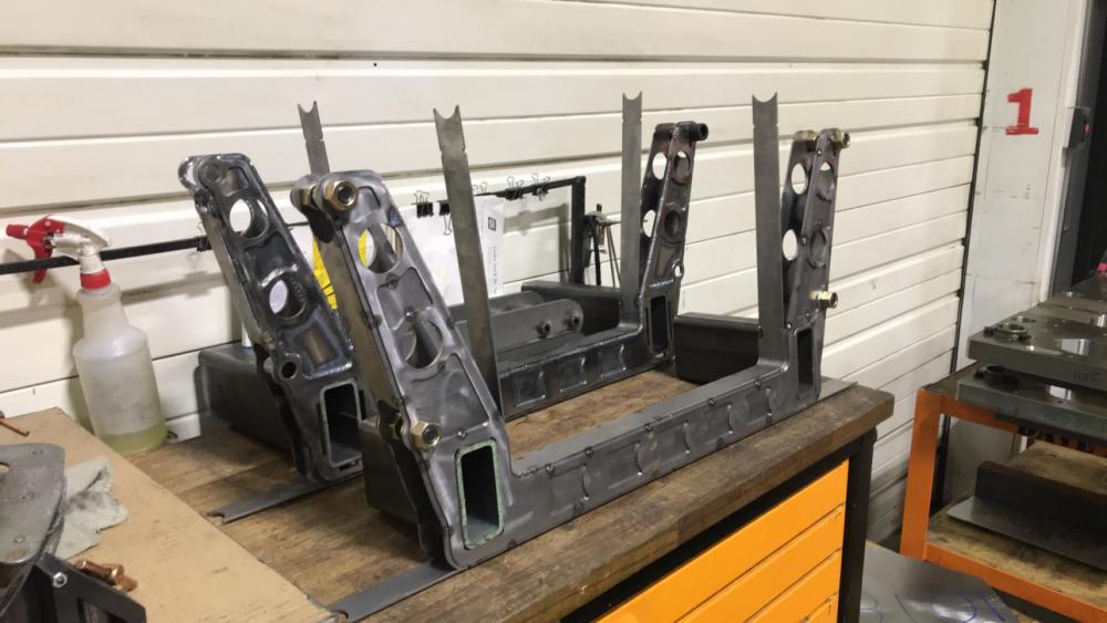

              #83
              All 4 done and ready to go. They will be powder coated in the future but first I gotta get some mock-up done.
              • ThatRatRodProjectT
                ThatRatRodProjectT
                ThatRatRodProject

                      #87
                      Quick up date.
                      Got some of my hardware to assemble my front end just waiting on ball joints and got a finish up some welding
                        ThatRatRodProjectT
                        ThatRatRodProject
