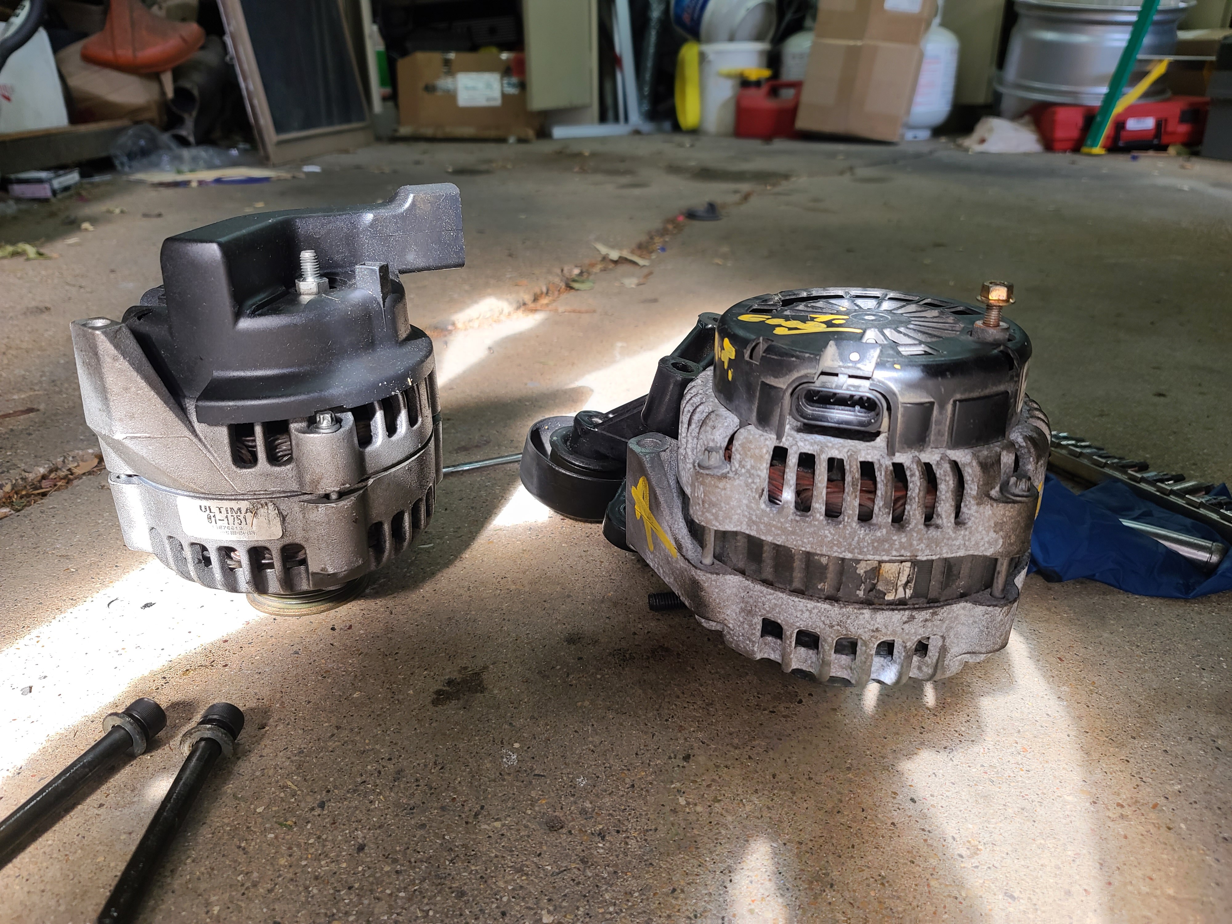

    145amp truck alternator going in!

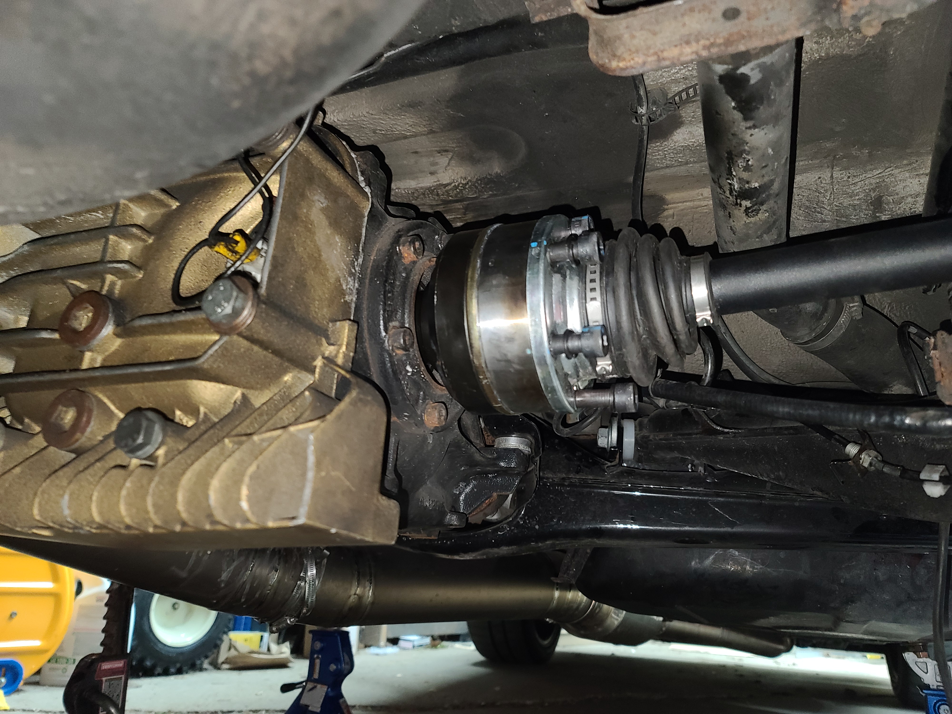

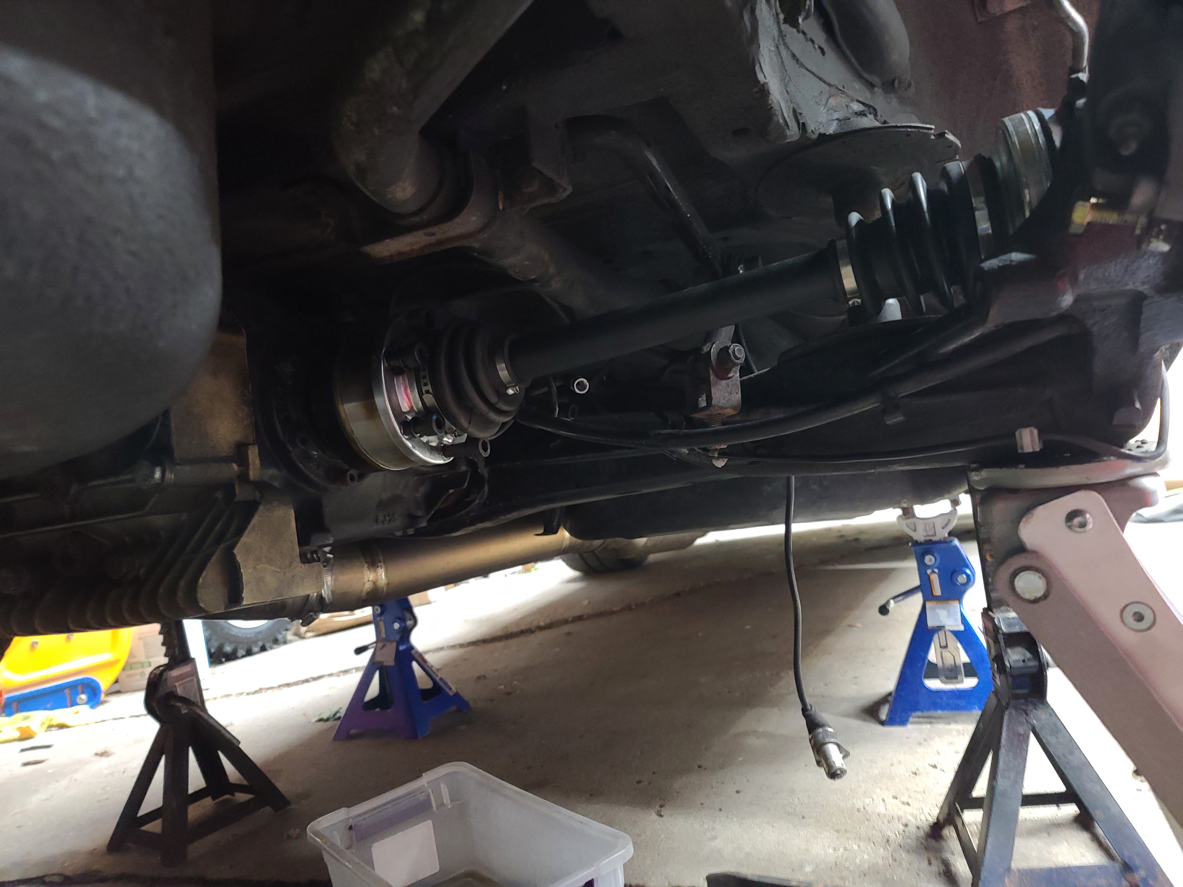

    2 weeks ago I finally popped in the Drives Shaft Shop Level 5 700hp Axles.  They are not direct bolt in for this '89 325is. Had to remove the ABS ring and grind down a manufacturing "bump" on the inside of the hub for them to fit.  This involves mounting, removing the axle and grinding 10-ish times to get the clearance right. The output shafts are SUPER beefy.  Out of a 930 Porsche I think?

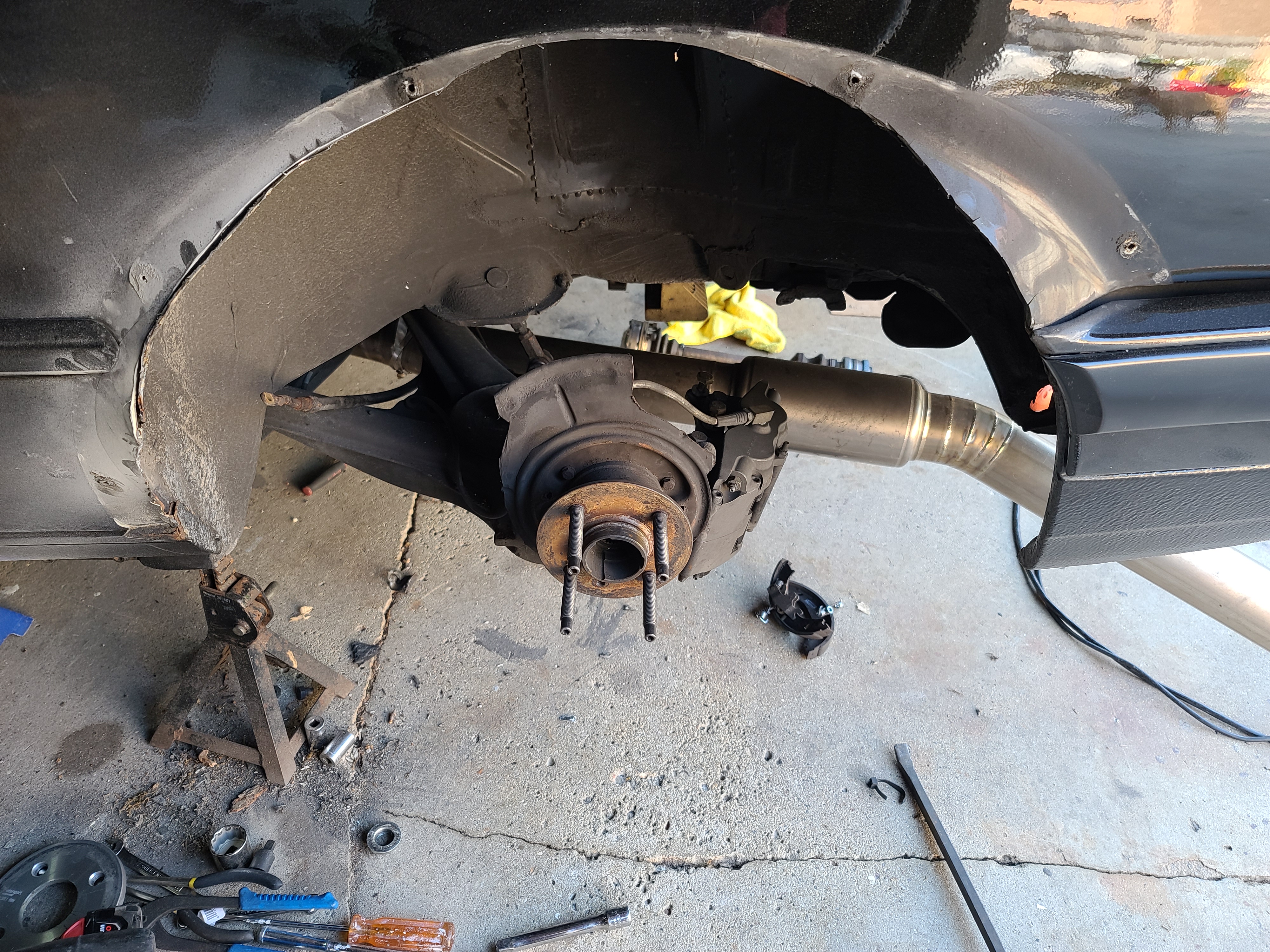

    Cut off some more fenders to try and stop the tires rubbing.  I think it worked 💪
