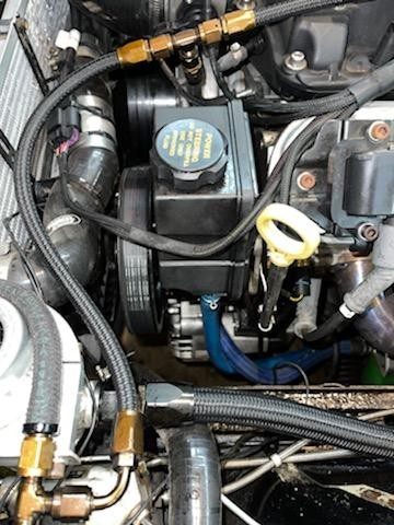

              Had Mike pop in new front oem wheel bearings.  We removed the oem grease and packed them with Redline's CV grease to help avoid premature wear. Replaced the leaking power steering pump as well.
                   @DrLeadFoot

                        Car is running great outside of a power steering leak.
                        Removed the ABS pump.
                             @DrLeadFoot
