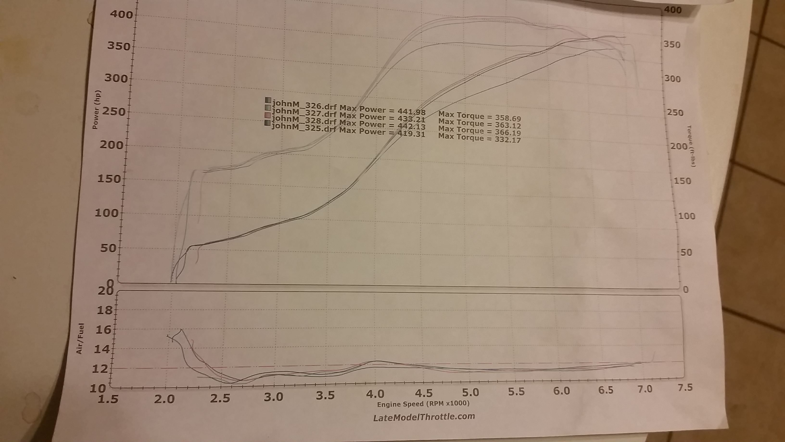

                    Last time I dyno'd it it was 442whp at 13psi.
                    I'm now at 18psi with a slipping clutch... I just want to break the 500whp mark.
                    I also have to pop in a new t3 turbo gasket. Mine currently is venting to atmosphere.

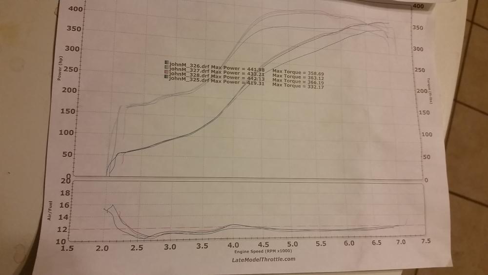

                         @DrLeadFoot
                    • CMartC
                      CMartC
                      CMart

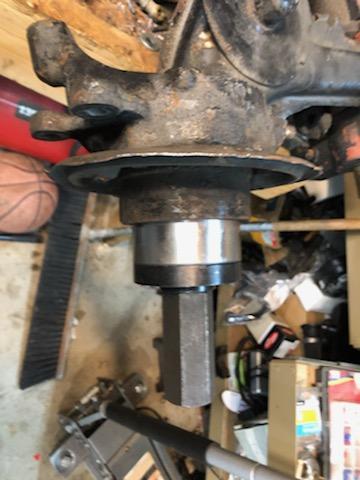

                        Got around to doing a little work on the car while in my basement.
                        Popped of the foamy thing.
                        It was all oil mush.
                        Gently pry a bit.
                        Off she comes!
                        New vs. Old
                        Oiled up the gasket, took a 15mm socket and tapped it home.
                        After cleaning up the tar-ish residue on the rod popped on the new foamy thing on with the dowel held in by the snap ring.

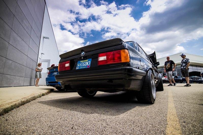

                              Stopped out by Dan THE Exhaust Man's place.
                              The wing is in the works!!
                              6a6bafadadf56a166943e36124a33378.jpg8c60fe6e5032fb890fc4d0c8242f691f.jpge68e39b8703bdfe1fbd4e315f5eace9a.jpg8aac5e2d767e7a659aa08b449ef353a5.jpg
                                   @DrLeadFoot

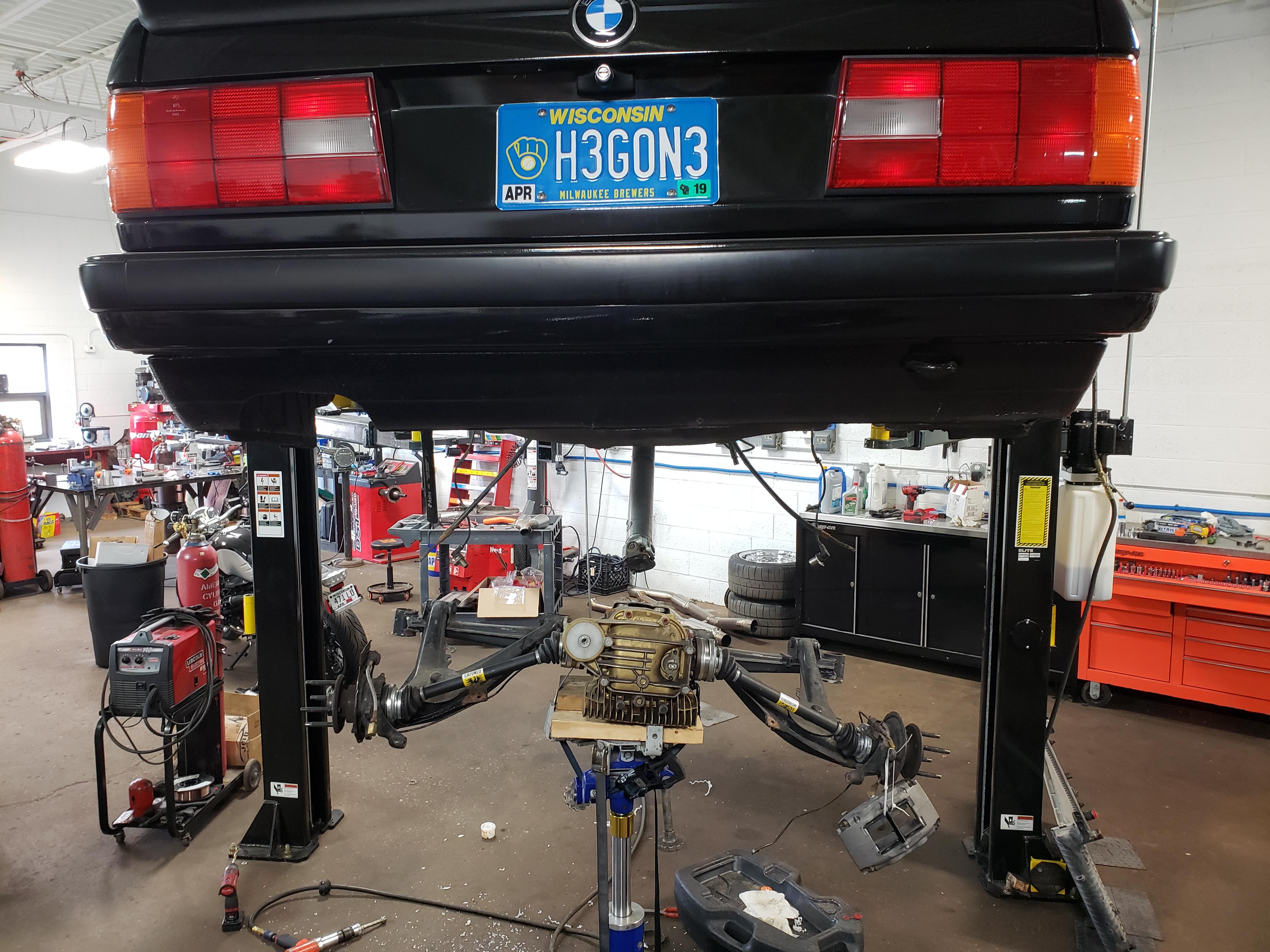

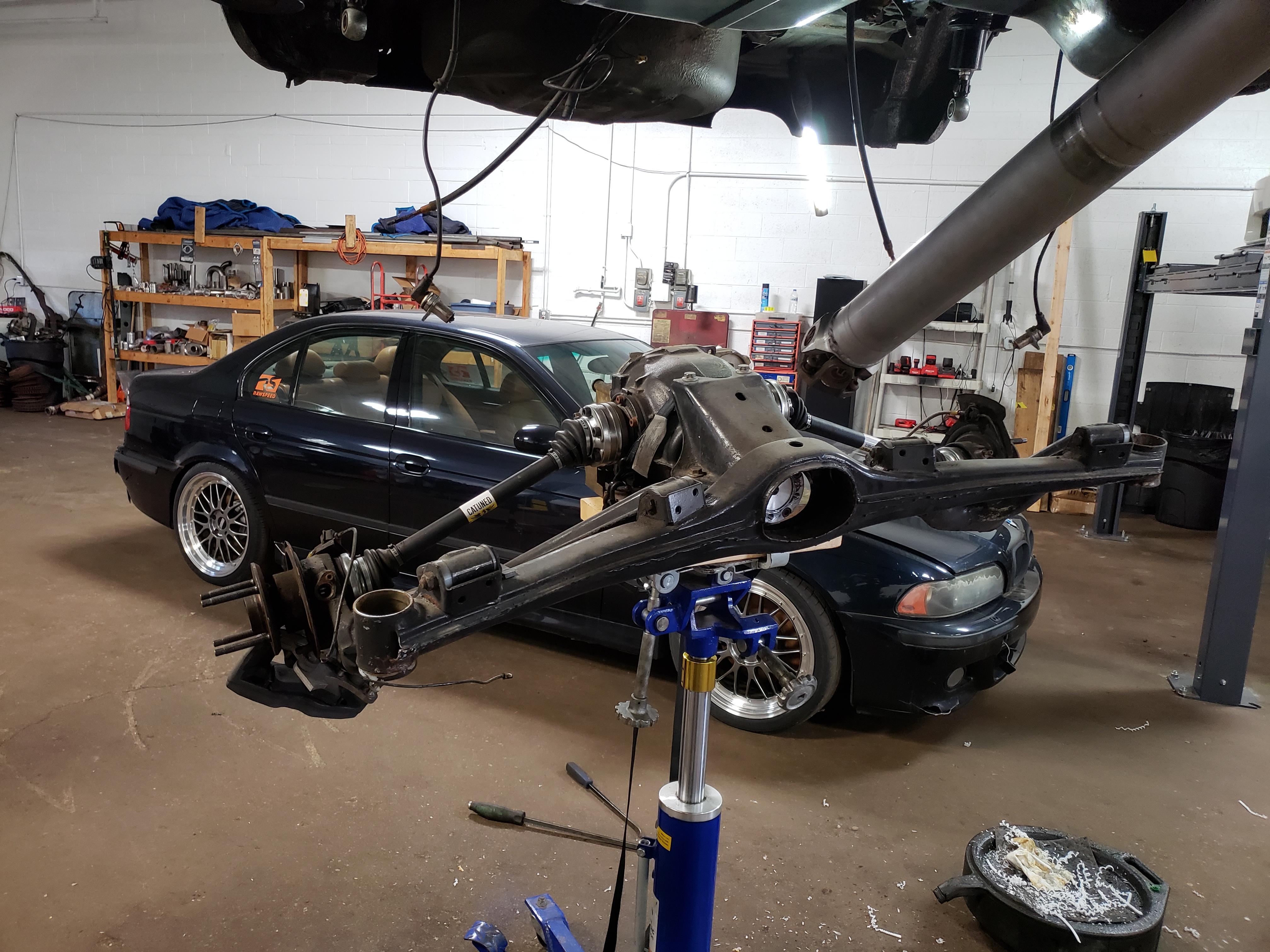

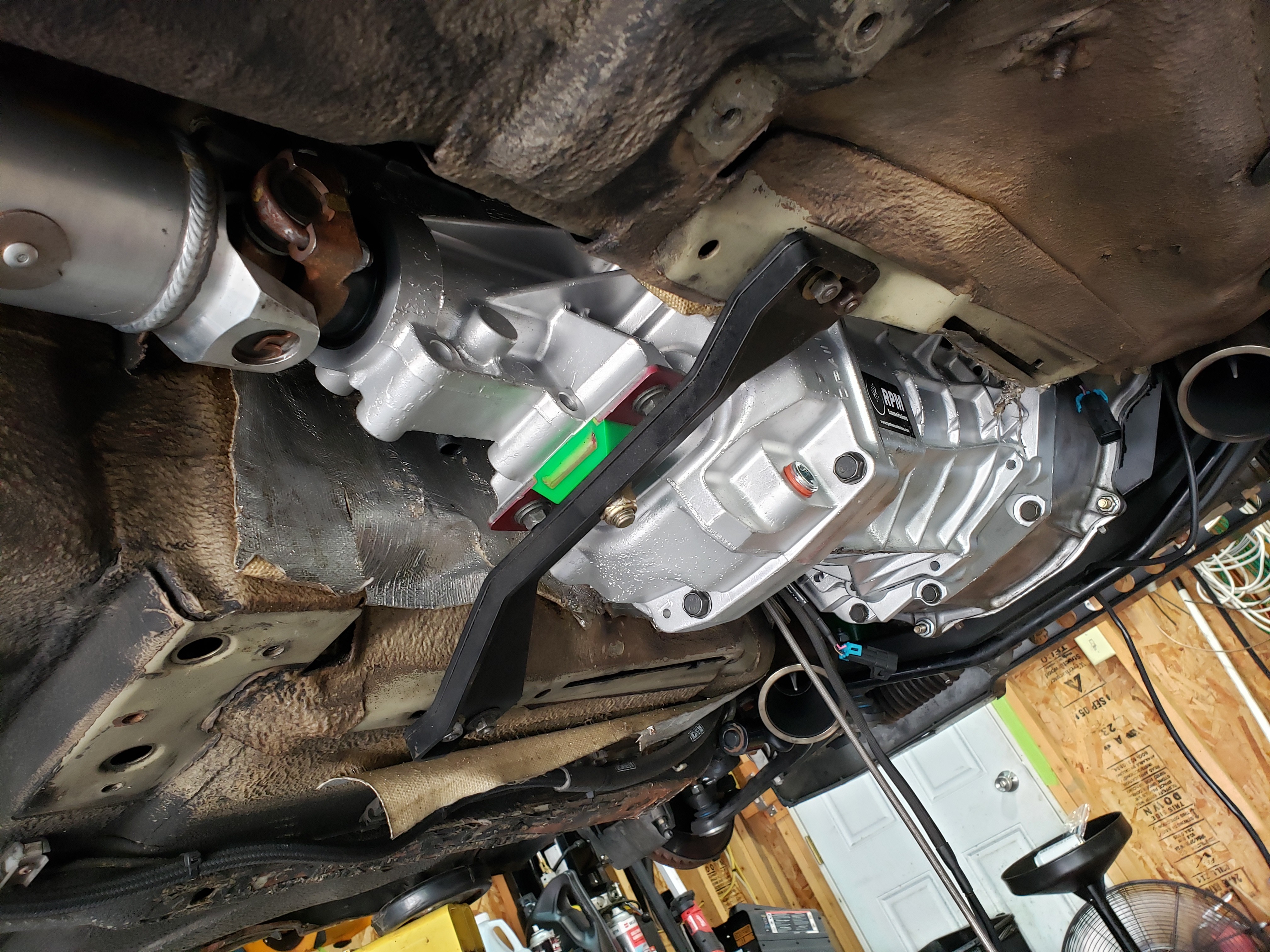

                                Got the driveshaft and trans out.
                                Now let's go Marquette Warriors!!!
                                     @DrLeadFoot

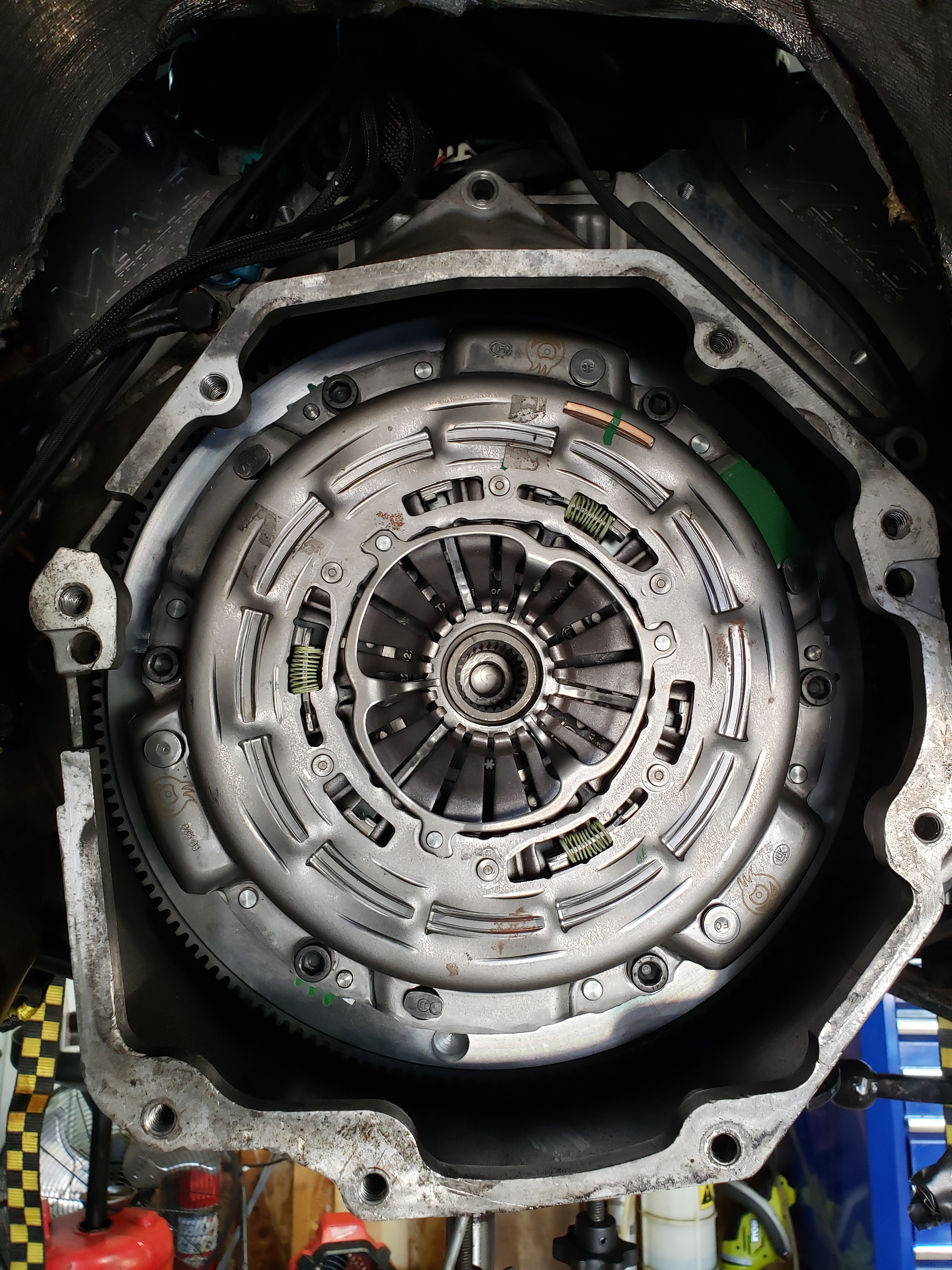

                                      Got the clutch and flywheel out. Gotta love zipties!
                                      66c39628d0864011e43a490b08373b12.jpg507e3cddbdb748efc018dec55e67eeb5.jpgd327f7f7983d3571fd0dfa77e9b54b60.jpgc2fc8810fa05a96638eb169b2824f0b0.jpg1e04fe356e99a670d8488ed089068ccd.jpg
                                      A little slipping going on there. The pressure plate is a Sachs, clutch is a Southbend stage 4 and JB racing flywheel. Couldn't handle around 400ft/lbs.
                                           @DrLeadFoot

                                        #840
                                        stock pressure plate or 618 Pp? Just the southbend stage 4 disc?
                                        sk8 or die
                                        • DrLeadFootD
                                          DrLeadFootD
                                          DrLeadFoot
                                          #841
                                          Not sure. Bought the whole thing off of a guy on bimmerforums. I think it's just the disc.
