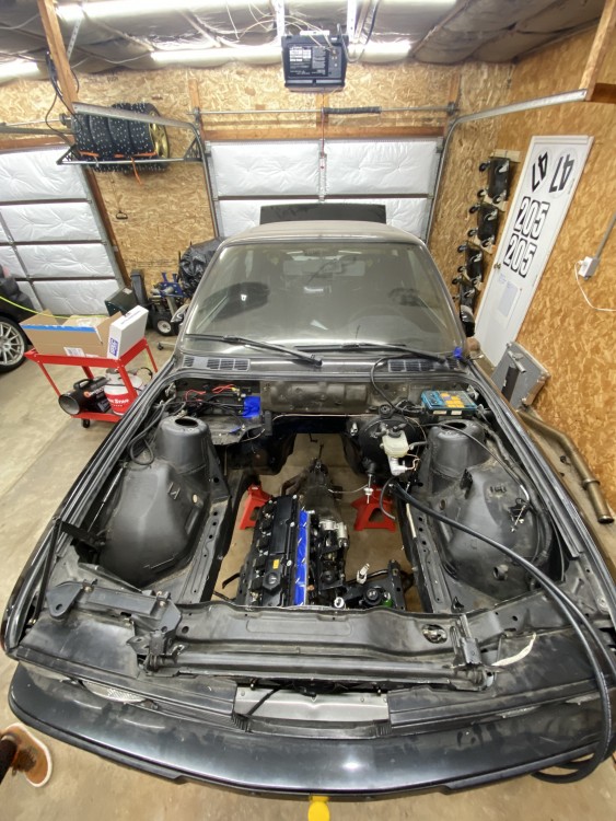

          Almost ready to drop the m52.
          Need to remove: Fuel lines, heater core hoses & front suspension (to make it easier to manage on a jack)
            #445
            Dropping it out of the bottom Is the way to go
            ABS pump is already gone, as well as all the front brake lines. Working on getting the bias adjuster mounted and remote cable ran.
            quick bend of the rear line gets the angle right for the cable to run to an already existing grommet in the firewall next to the main fuse box harness

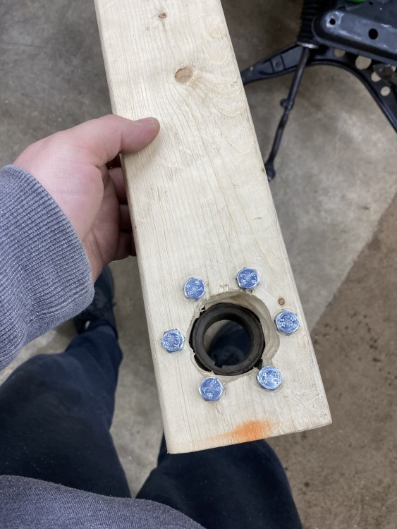

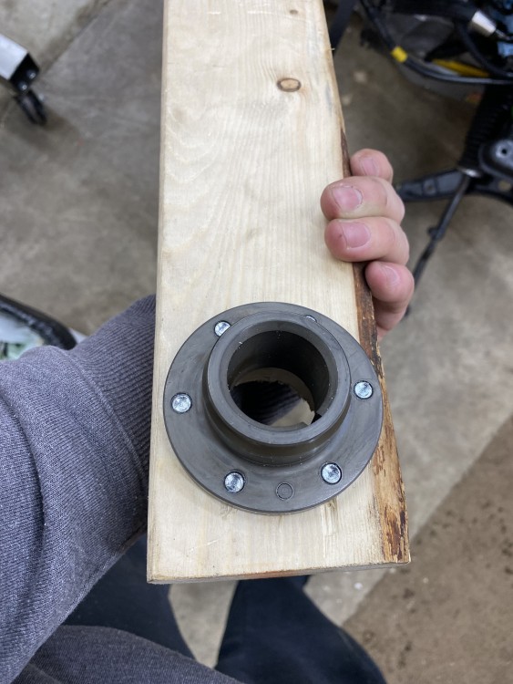

                                          @Rekpoint stopped by and we got to work. Instead of just blasting away at the crank bolt with an impact I figured I’d pick up a torque wrench that went to 300ftlbs - still needed a way to hold the crank as I don’t have that tool.
                                          the Amish-Inspired crank hub holder was born. 6D84B267-3010-474C-A715-F619EDFDCD9B.jpeg7012744B-21B7-4566-BF56-DEE0A008A8C5.jpeg
                                          in case it isn’t obvious I don’t own a hole saw. Drilled out what I could with a step bit and went after the rest with a die grinder lol
                                          Glen was the leverage and this stupid thing worked lol. Right around the last bit of torque, the end started to split but we made it to 300ft lbs lol

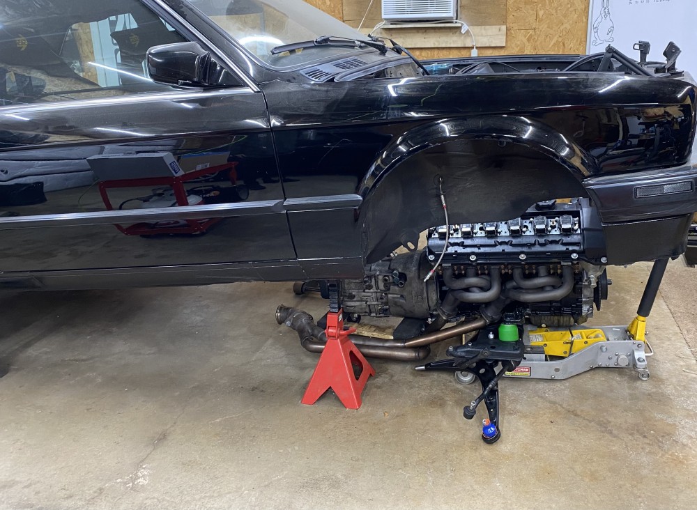

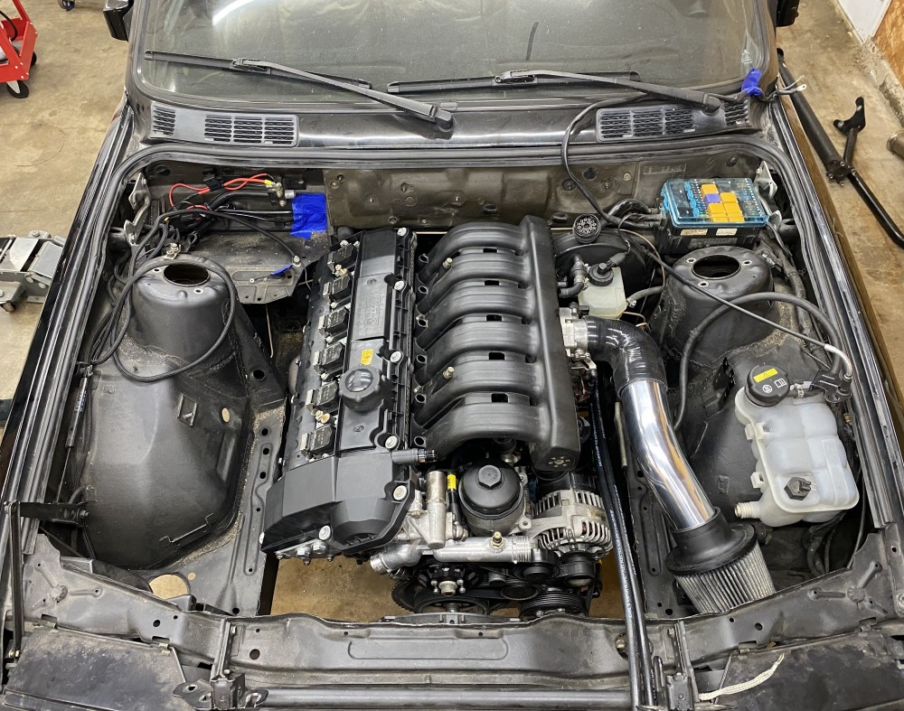

                                          Once that was torqued we made pretty quick work of it, still a fan of lifting the engine/trans/y pipe into the car all together vs using a hoist
                                          all jacked up and bolted in
                                          intake isn’t bolted up yet, just wanted to make sure the 45° bend pipe was going to work for the intake - won’t be running a maf with MS3
                                          next up is to make the car a roller again and get it down on the ground so I can get the harness in and connected as well as coolant hoses/radiator/etc etc
