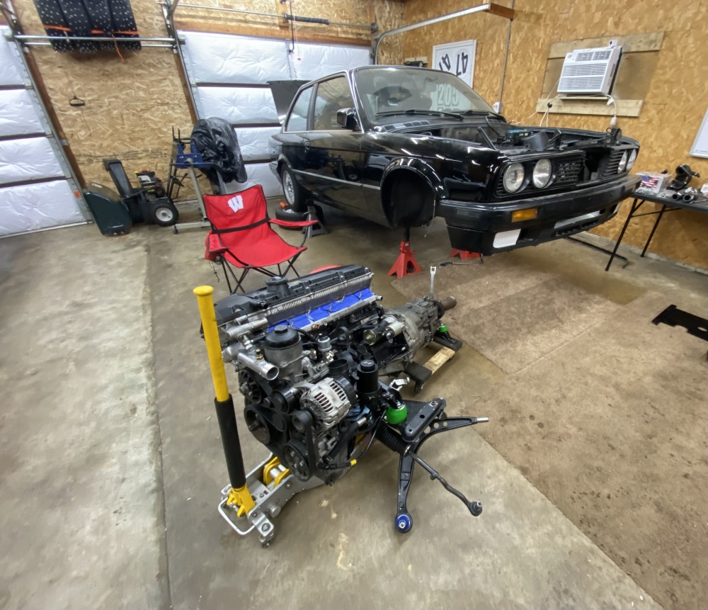

            Almost ready to drop the m52.
            Need to remove: Fuel lines, heater core hoses & front suspension (to make it easier to manage on a jack)

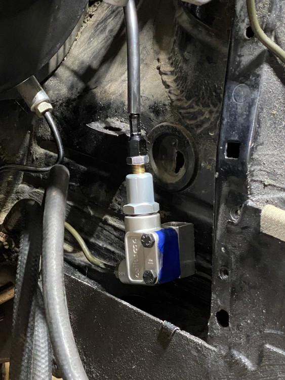

              ABS pump is already gone, as well as all the front brake lines. Working on getting the bias adjuster mounted and remote cable ran.
              quick bend of the rear line gets the angle right for the cable to run to an already existing grommet in the firewall next to the main fuse box harness

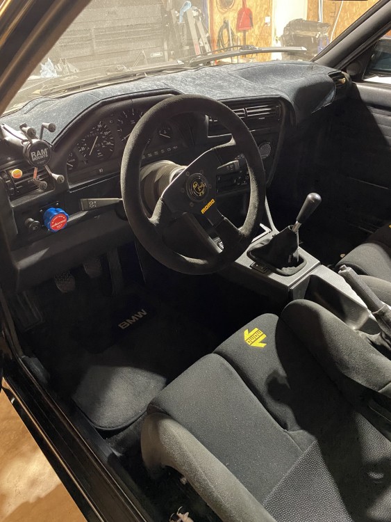

                Interior stuff is all done, remote Knob used the area for the fog lights (which Are being removed for the OEM “delete” panels)
                hoping I won’t have to touch interior stuff anymore for this chapter (wideband is already routed, just not connected to anything)
                made a quick “bracket” for the bias adjuster out of some scrap 3/4” alum square tubing.

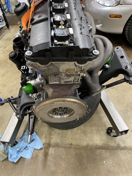

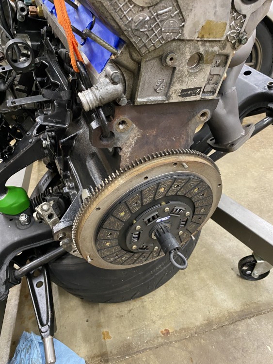

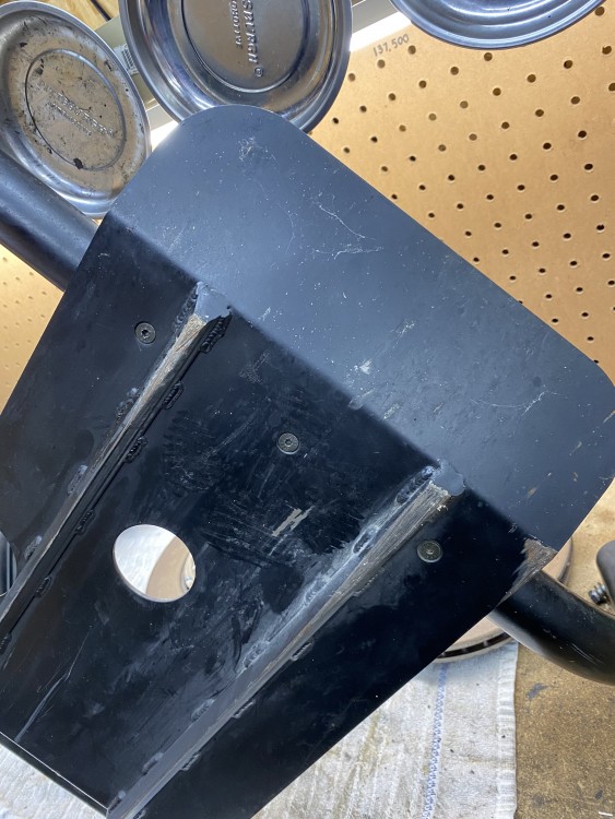

                                      Popped the front main in, installed the damper (still need to torque that, which basically means set the impact to max and send it home) engine is on the subframe now, m20 FW on with arp hardware, new spec clutch/pressure plate,TOB/PB, clutch pivot pin with grease fitting, trans put on, new control arms, bushings, etc etc 5140E845-79D0-4F4C-BFAF-788F1333C95E.jpeg6D479B9A-1D20-4217-ACCB-7D1CF0DB2B7D.jpeg8AA47068-9D58-4C26-A9DB-E549EFB872E0.jpeg
                                      @Rekpointis stopping by to help toss this thing in

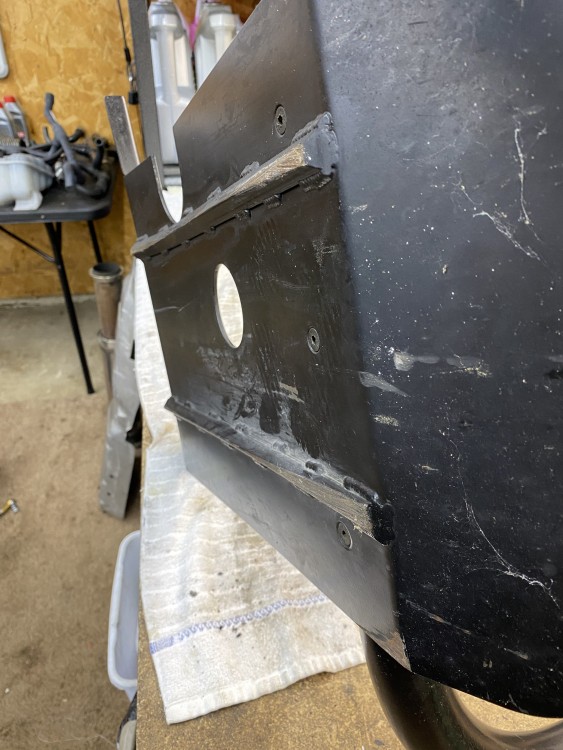

                                      side note, this hikfab plate has probably saved me from purchasing around 70 oil pans AEBC33A5-FF37-4BBF-AD77-EDB729CAD296.jpeg5B950114-3B06-4BFD-BBB5-F83490AF8E2E.jpeg
                                      it did pick up a slight bend, but I’m going to toss it in the press to see if I can’t straighten it back out a bit
                                      also, say no to brass pivot pins lol. This maybe had like 4k miles on it - was previously running a south bend stg3 street clutch/pp
