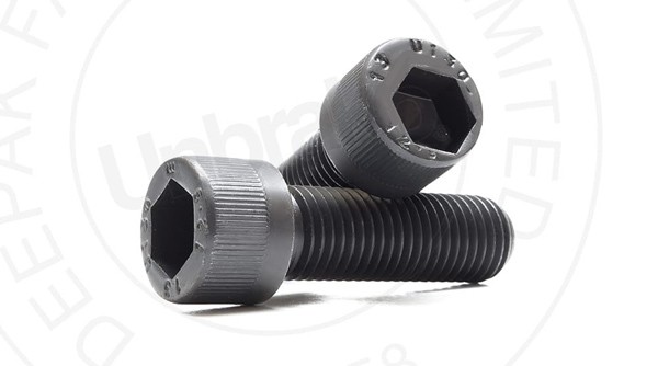

    i've seen worse from actual manufacturers these days.  i wish i would have saved the socket cap bolt that was sent as a kit with some cheap rear dog-bone arms for the e34. the hex opening in the head was like this: (photoshop representation)
    That's hilarious. It would be entertaining to watch someone tighten one of those down with a drill.
