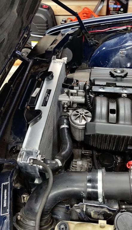

              Headliner was cleaned out and tucked back away for a later date .

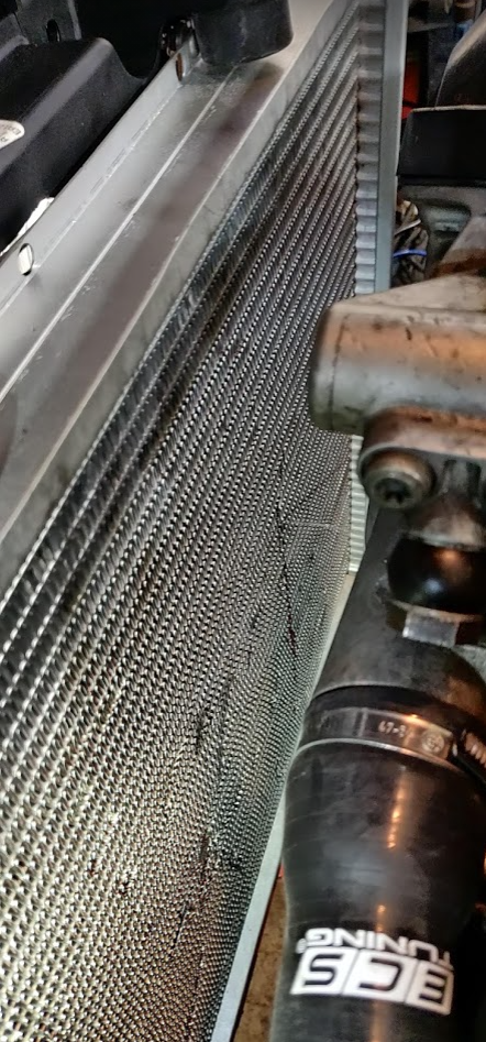

              Cooling this engine had been sub optimal before, so I threw money at the problem.
              Stewart water pump, Z3m triple core, SPAL branded fan.
              Clearances are tight, but man does this help keep temps in check!

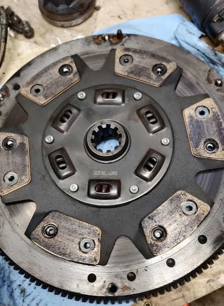

                                    I question if the horrid old clutch in there didn't help the situation any, as it would chatter like a mother.
                                    Previous dude also speculated that it was ticking shortly after assembly, but not as bad.

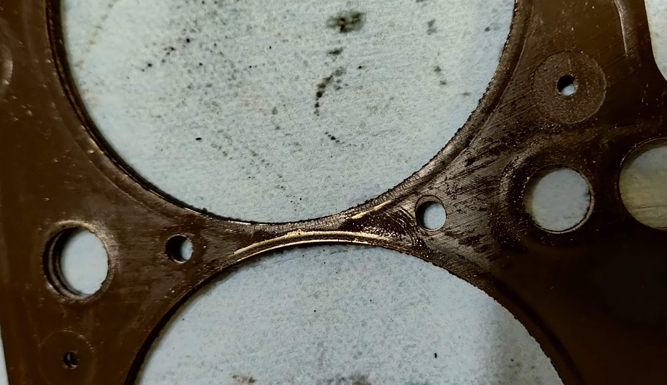

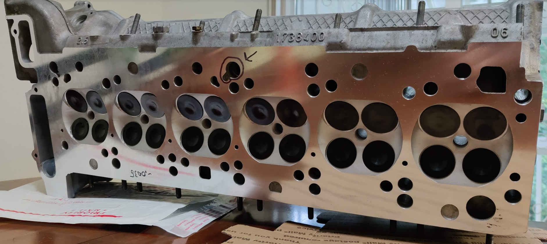

                                      Well, fired it up and it sounded the same.
                                      Pulled the head and brought it to the shop, as that's the only thing left.
                                      Dude called and said I had a bent valve or 24, so at least root issue was found. He noted the guides were ovals so it had been this way for quite some time, must've been a very subtle bend on most of them.
                                      Ordered some goodies and will be back better than ever.

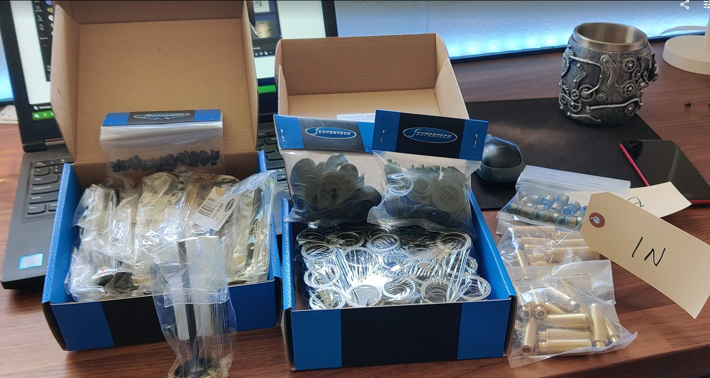

                                        #62
                                        Supertech Upgraded dual spring kit
                                        Supertech Stock size exhaust valves
                                        Supertech +1 Intake Valves
                                        Supertech Single Groove Valve Locks
                                        Supertech Valve Seals
                                        Achilles Upgraded Valve Guides
                                        Further head port work to accommodate and capitalize on the oversized intake valves
                                        I'm looking forward to the re-tune on the dyno, last time my crank sensor was on the fritz so I was limited to 6100ish RPM depending on engine temp. With the new springs and such we will happily running it up nice and high in the revs without concern!

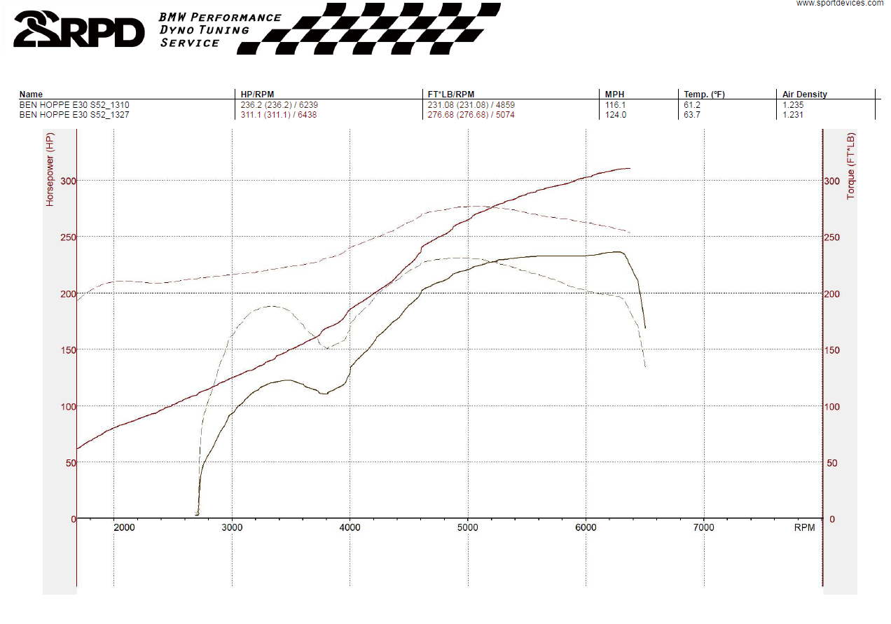

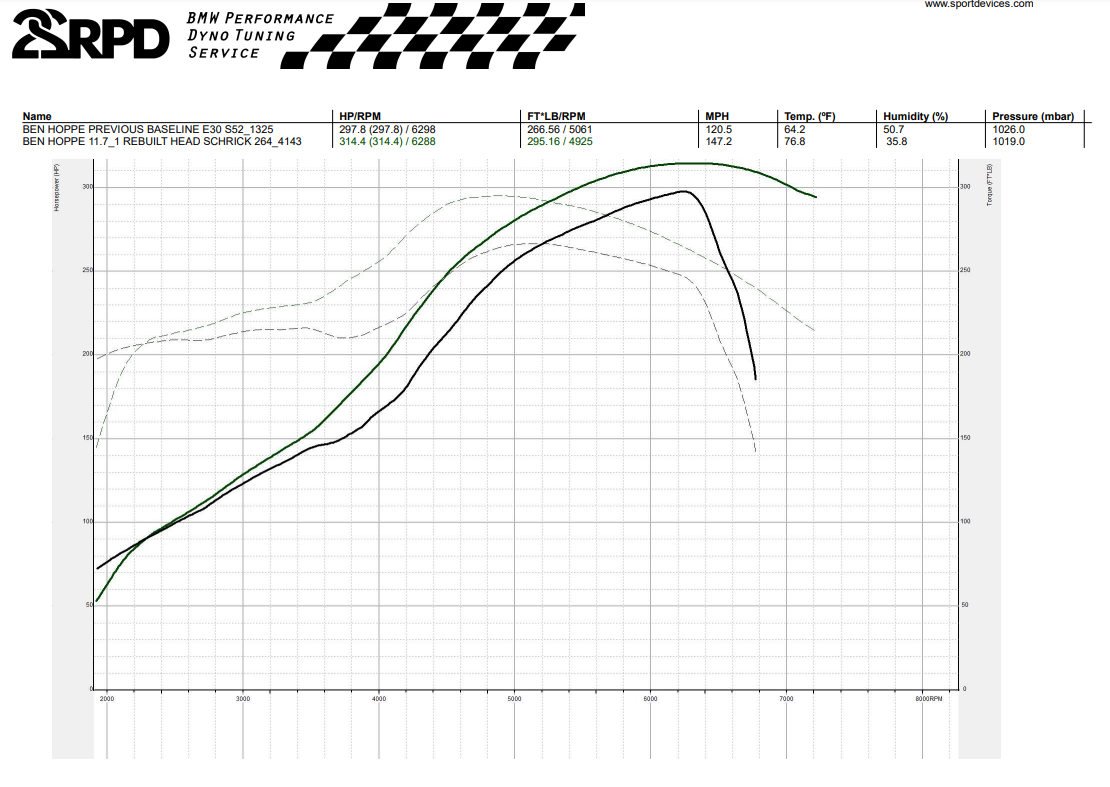

                                          #63
                                          The results are in!
                                          Last tune vs new tune
                                          That pickup in torque is very noticeable, the top end doesn't feel all that much different but feels much smoother than last time.
