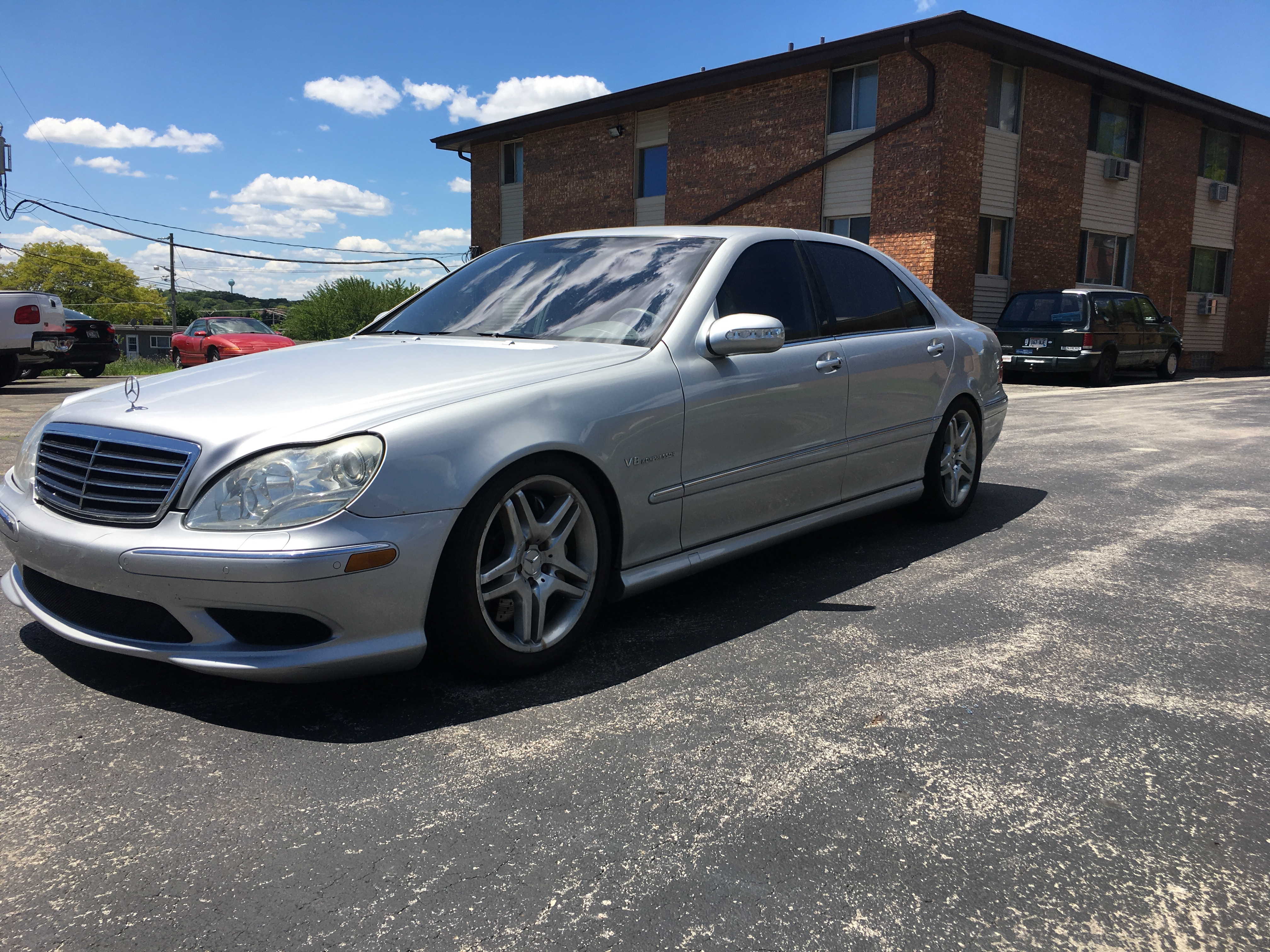

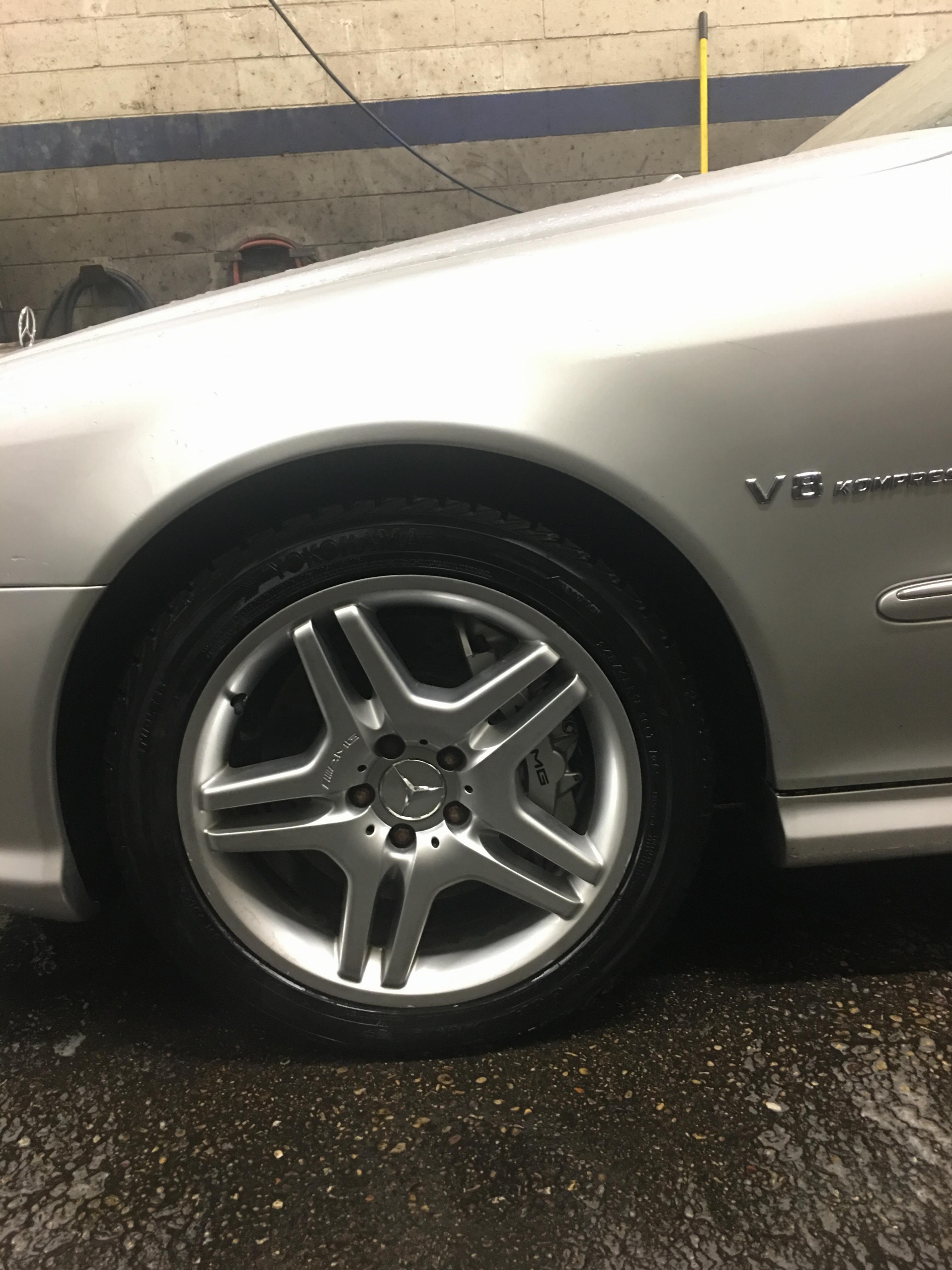

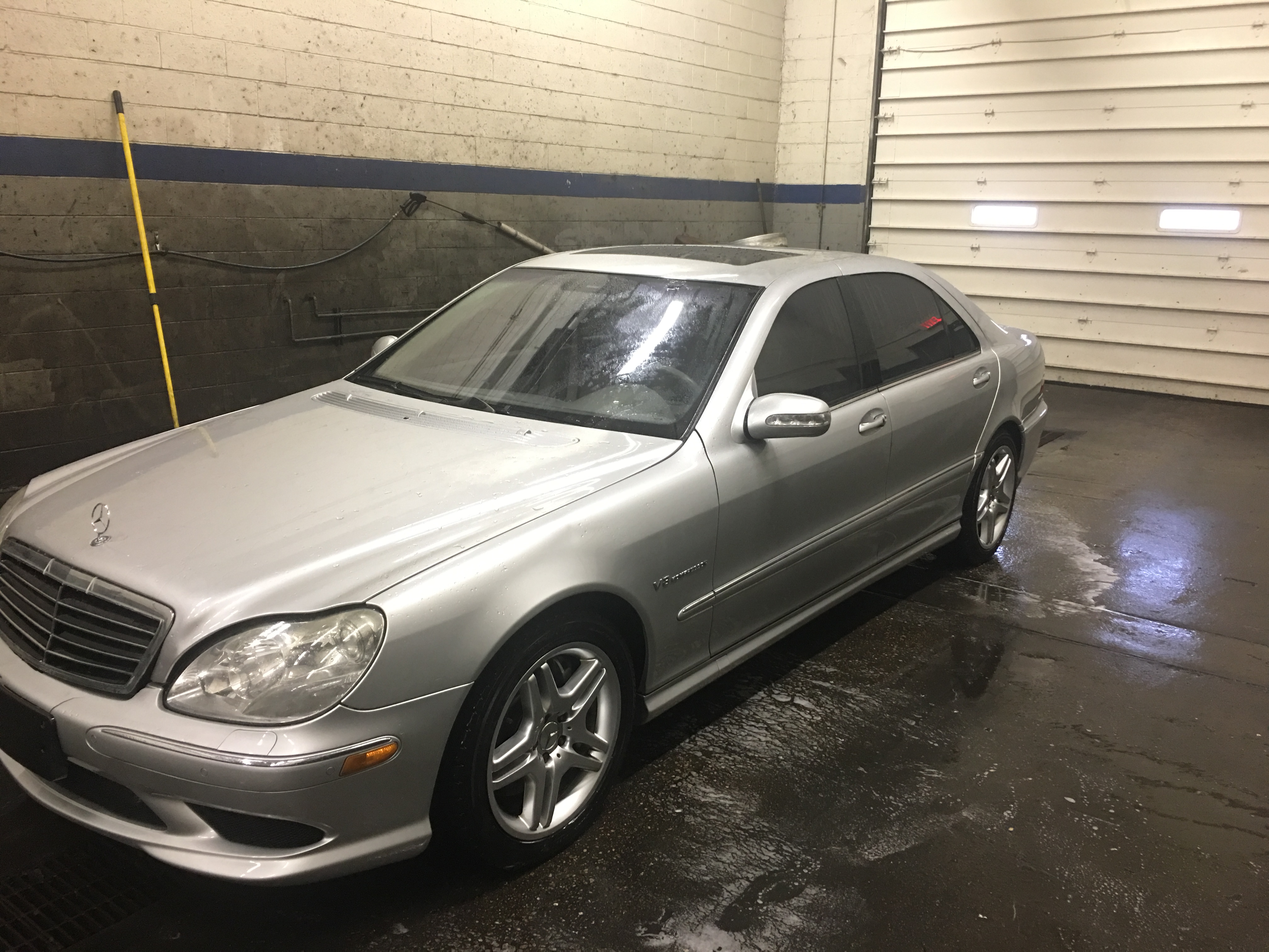

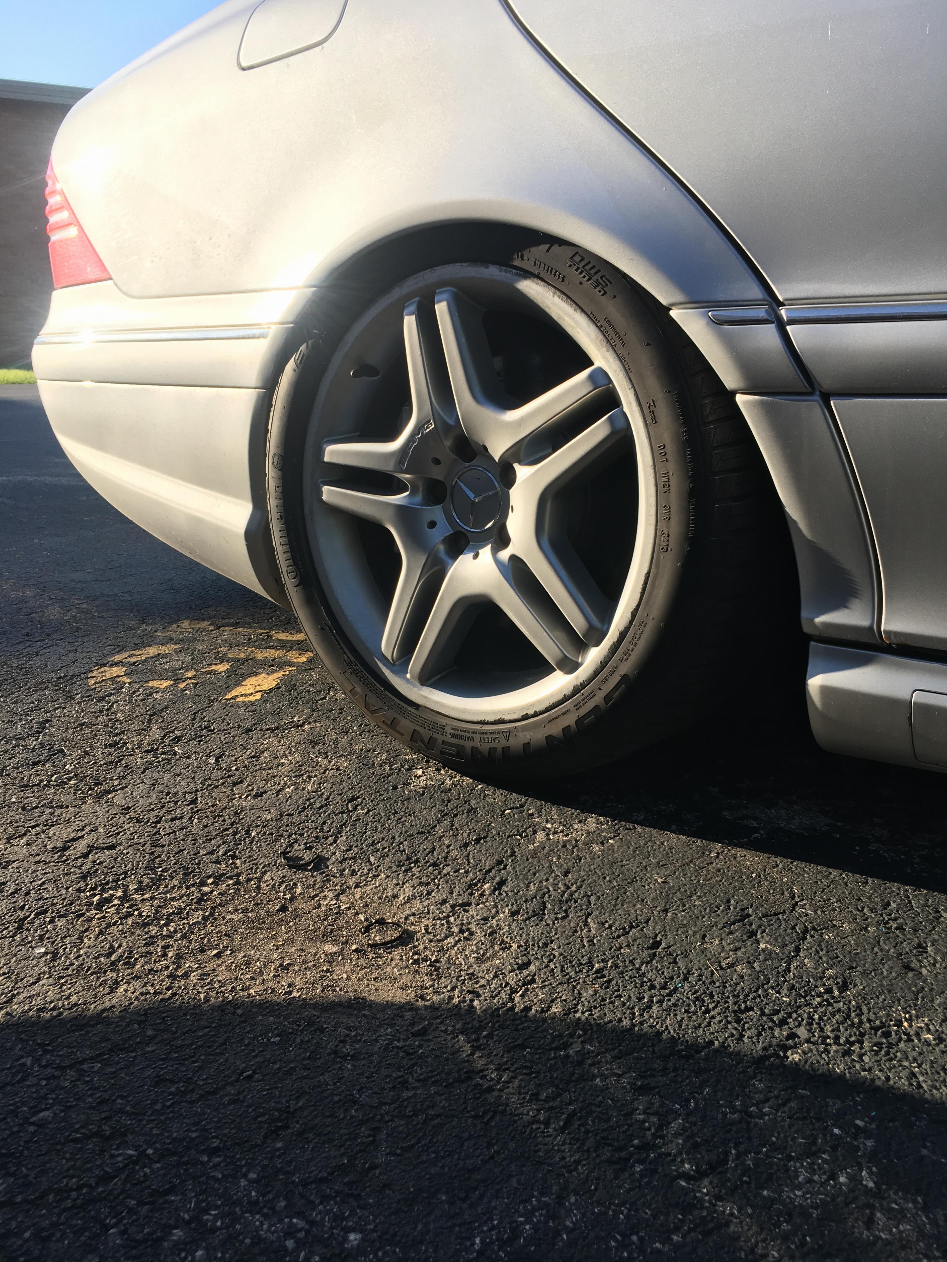

    Went ahead and put the summer tires on yesterday.
    Went to a couple different places to get some prices for taking winter tires off and summers put on.
    discount tire $150
    tires plus $90
    firestone $55
    So I went to firestone where zippy the pin head put my tires on, quite impressive watching this considering his pants were falling off.
    I told the manager make sure they put the tires on right because the rims are staggered, the 295s go on the 9 inch rim.
    "But these are 18 inch rims?"
    "don't worry we're professionals I'll make sure we get it right."
    well they get my wheels on and I notice one of the rear tires has some pretty excessive bulge so I say, you put the wrong tire on this rim.
    "no we put the wider tires in the rear"
    then I say, yeah but the rim width is different for this wheel
    "manufacturers make all the rims the same size"
    words exchanged
    "well they are already on there"
    Long story short, I had them take the wheels off and show them how you read the rim size.
    They fixed the issue at end of the day
    rant over....
    Front 265 40 18
    rear 295 35 18
    cuntinentals dws
    pictures don't do it justice

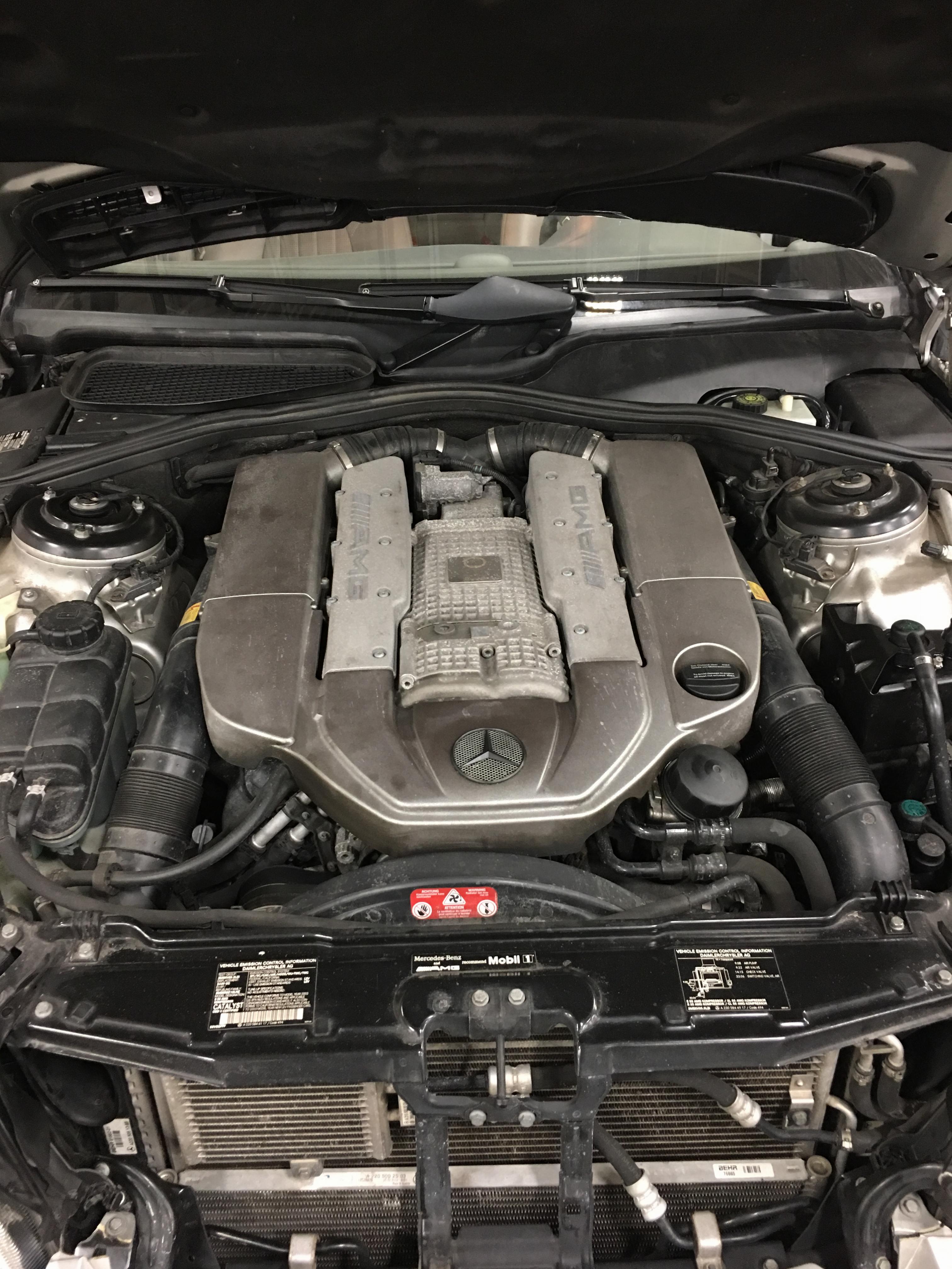

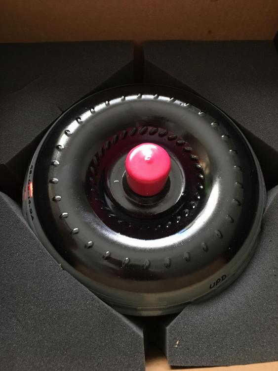

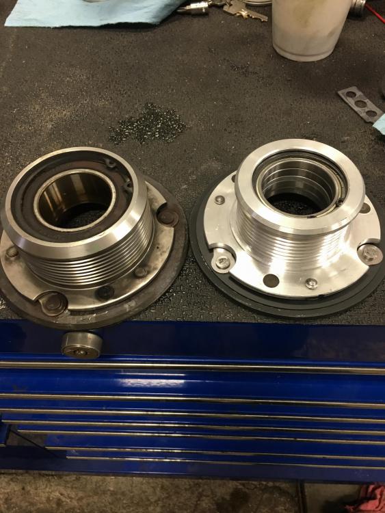

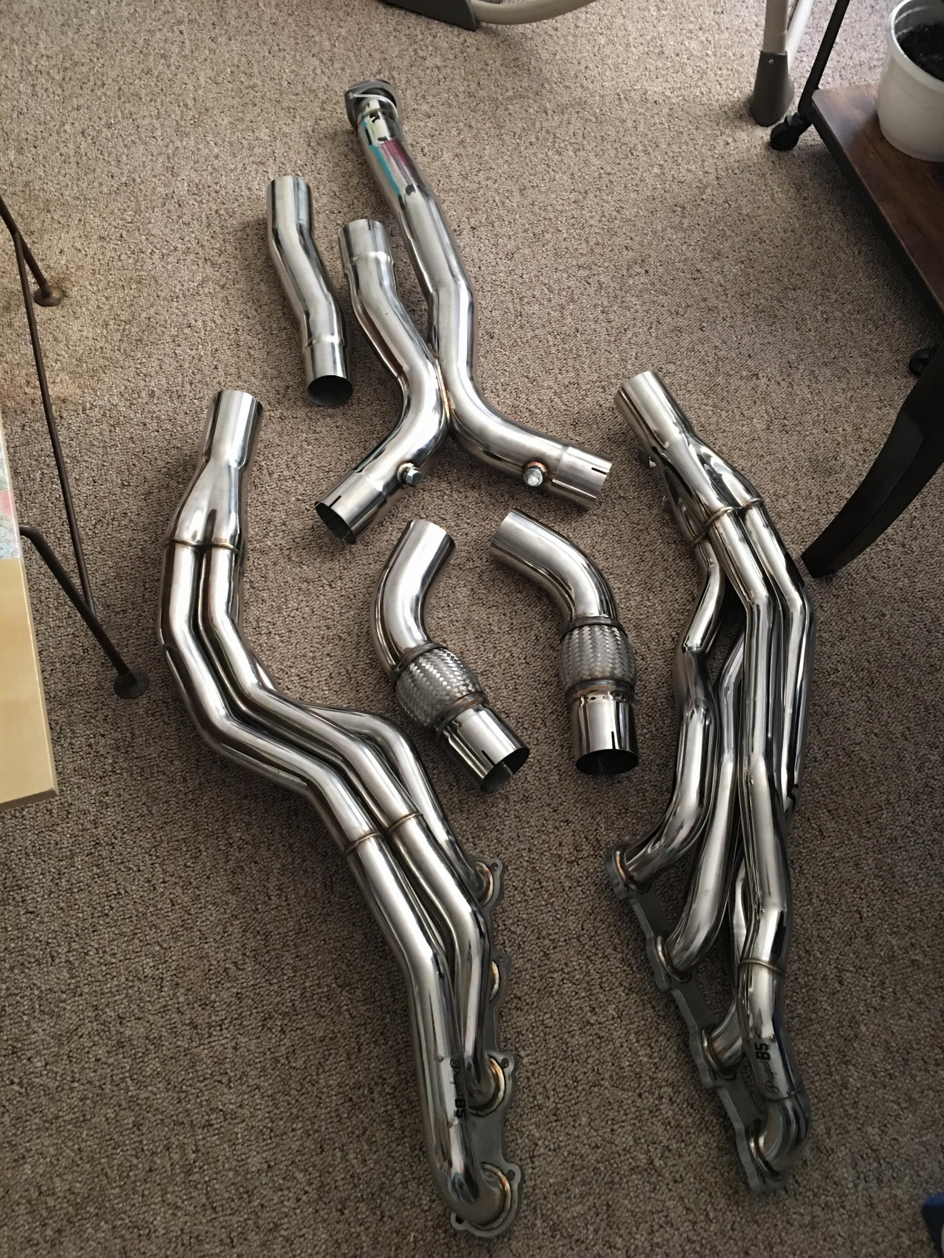

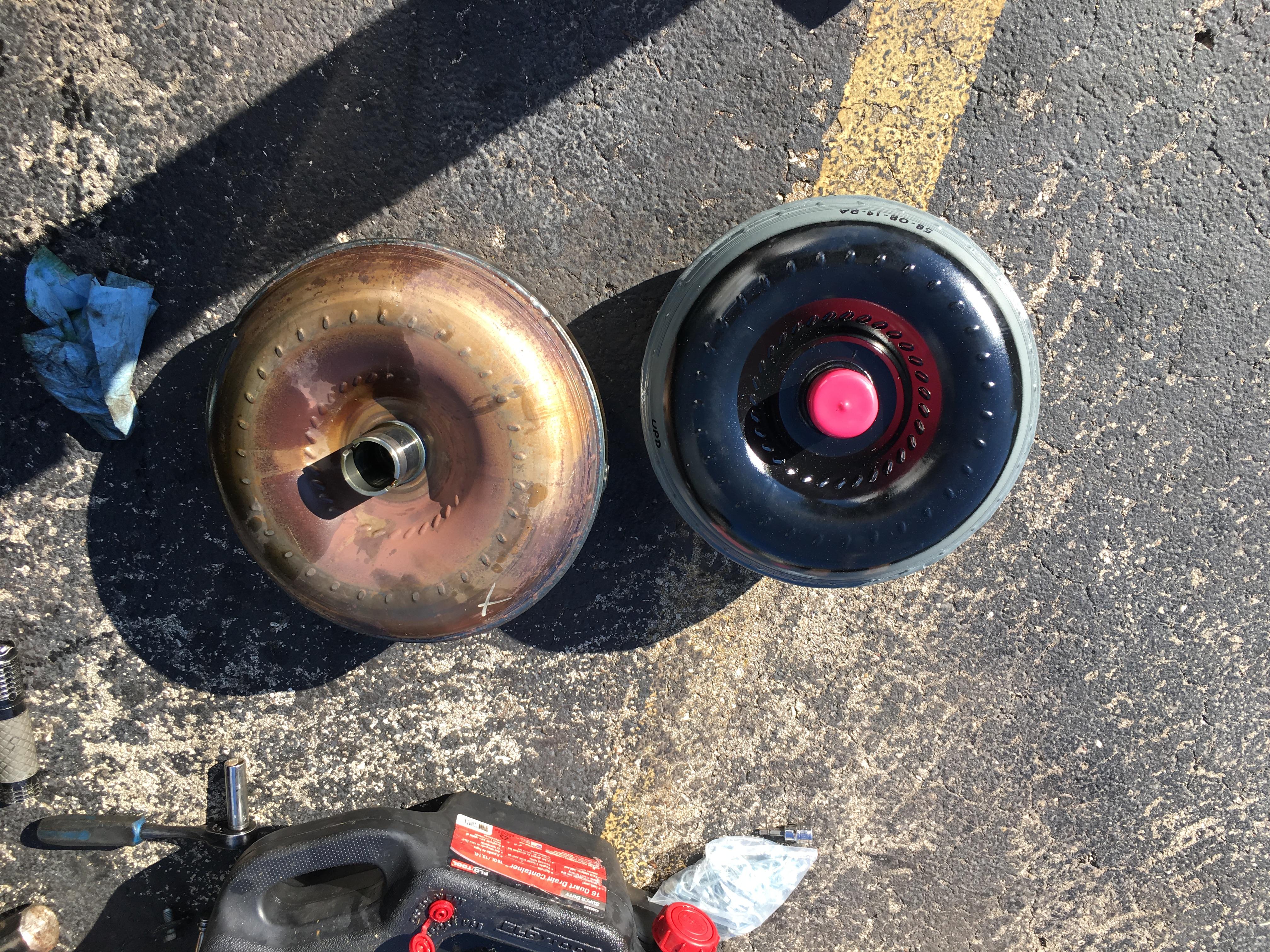

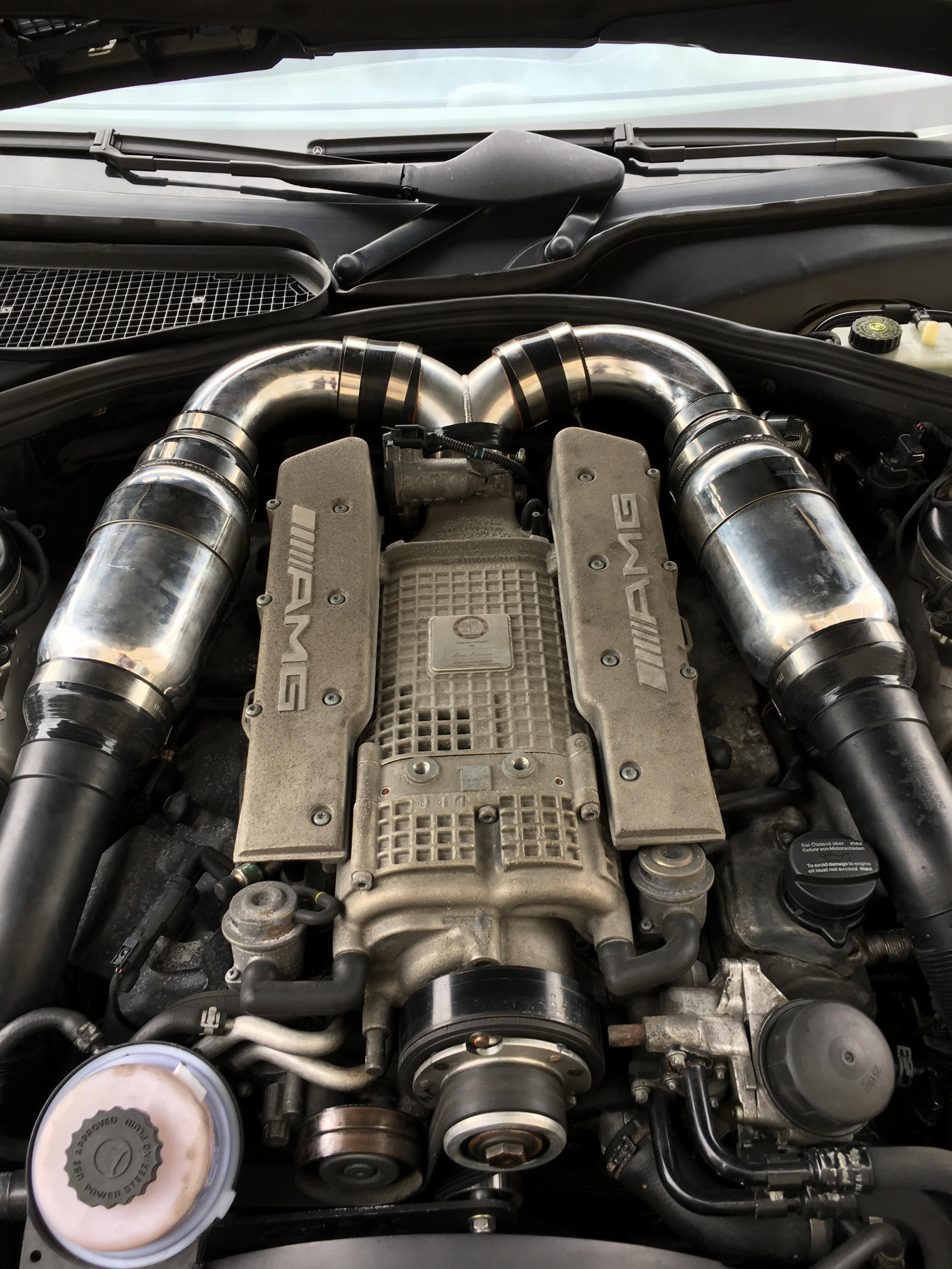

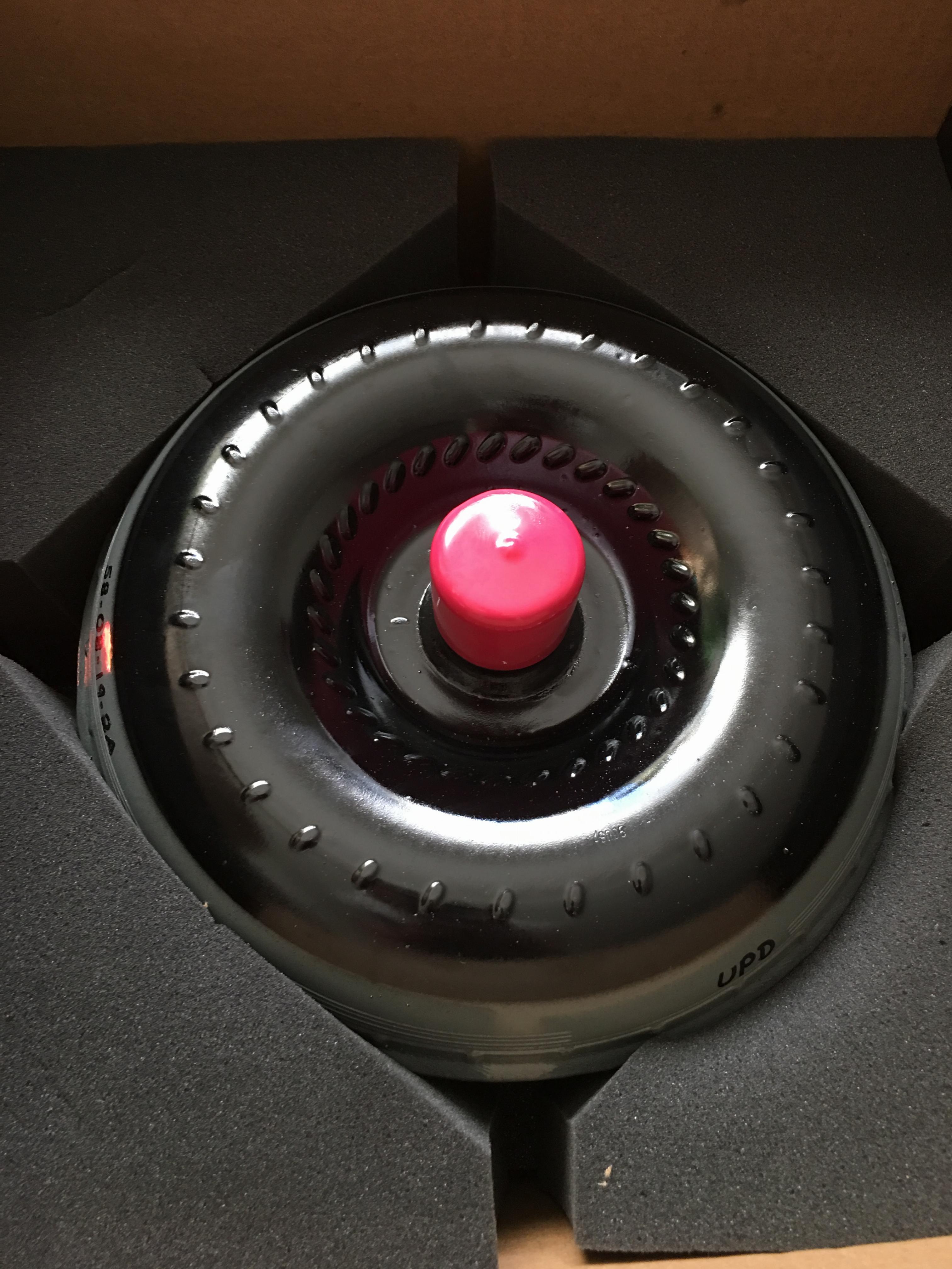

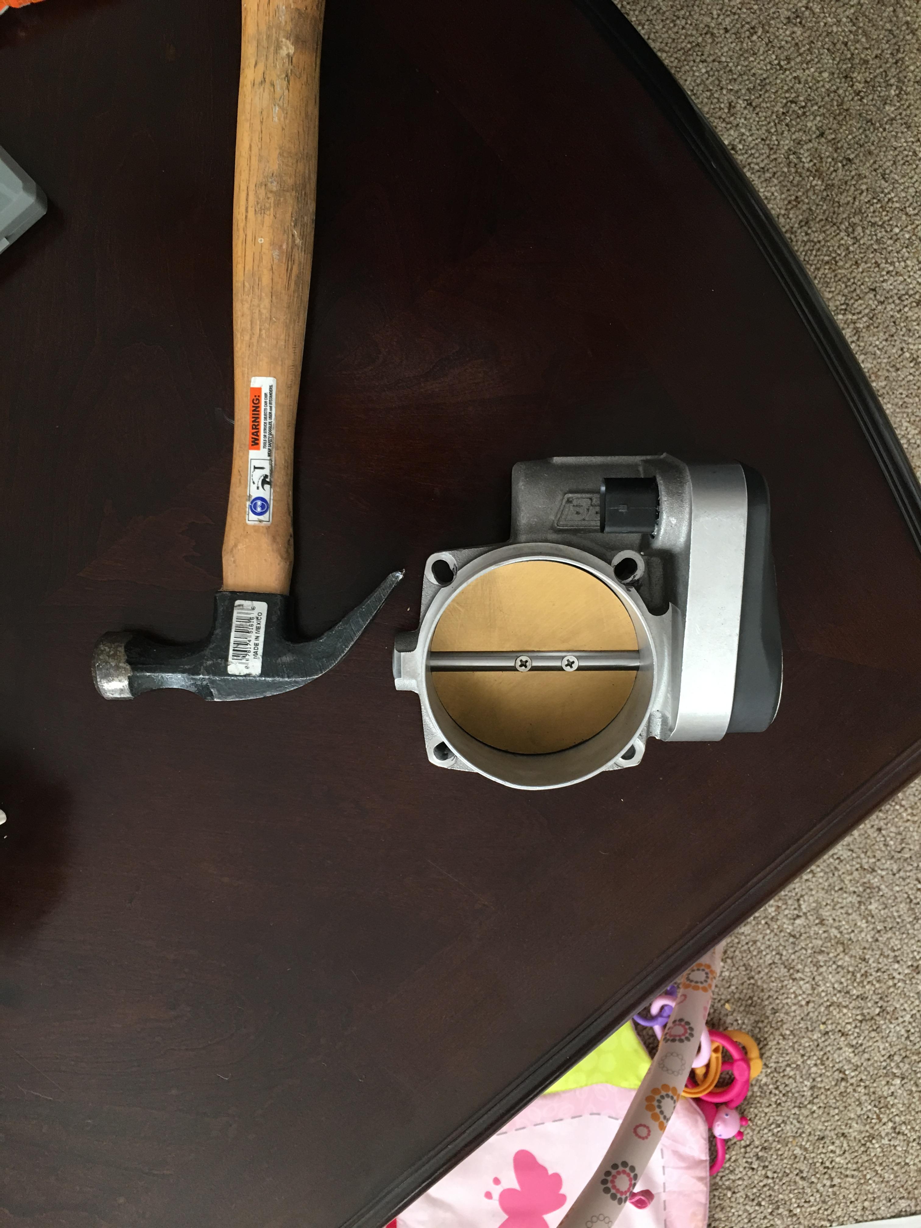

                          Picked up some goodies soon to go in.
                          90 mm bbk (big black kock) throttle body for one of them dodges

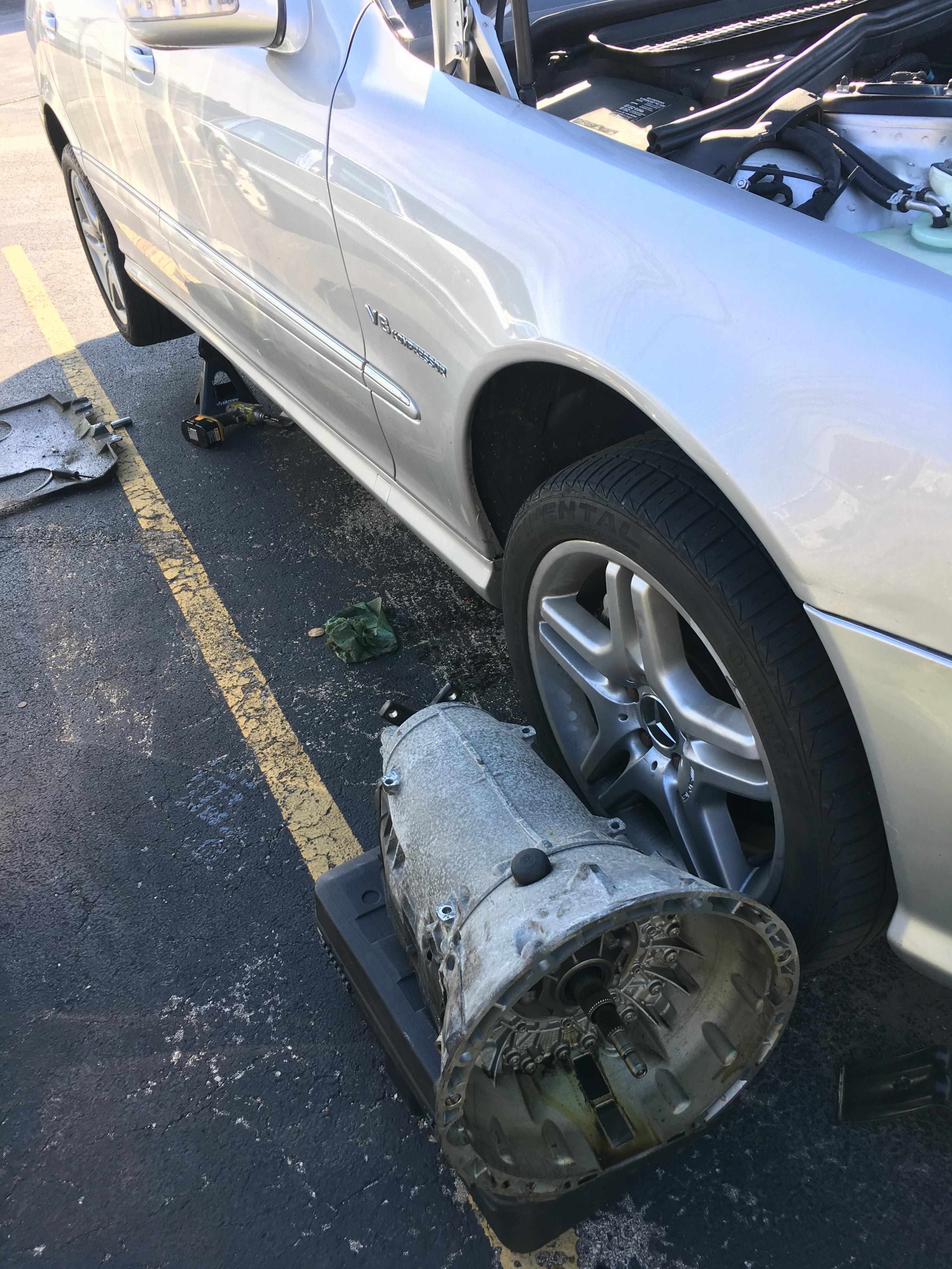

                          Custom made 3k stall torque converter, have to do rear main seal so figured if the tranny is out do some mods.
                          car is running good, got a check engine light for evap system (very small leak)
                          cleared it and hasn't come back, I think it's due to leaving my car running when I fill up.
                            I had to stop drinking my cup of water when I read this

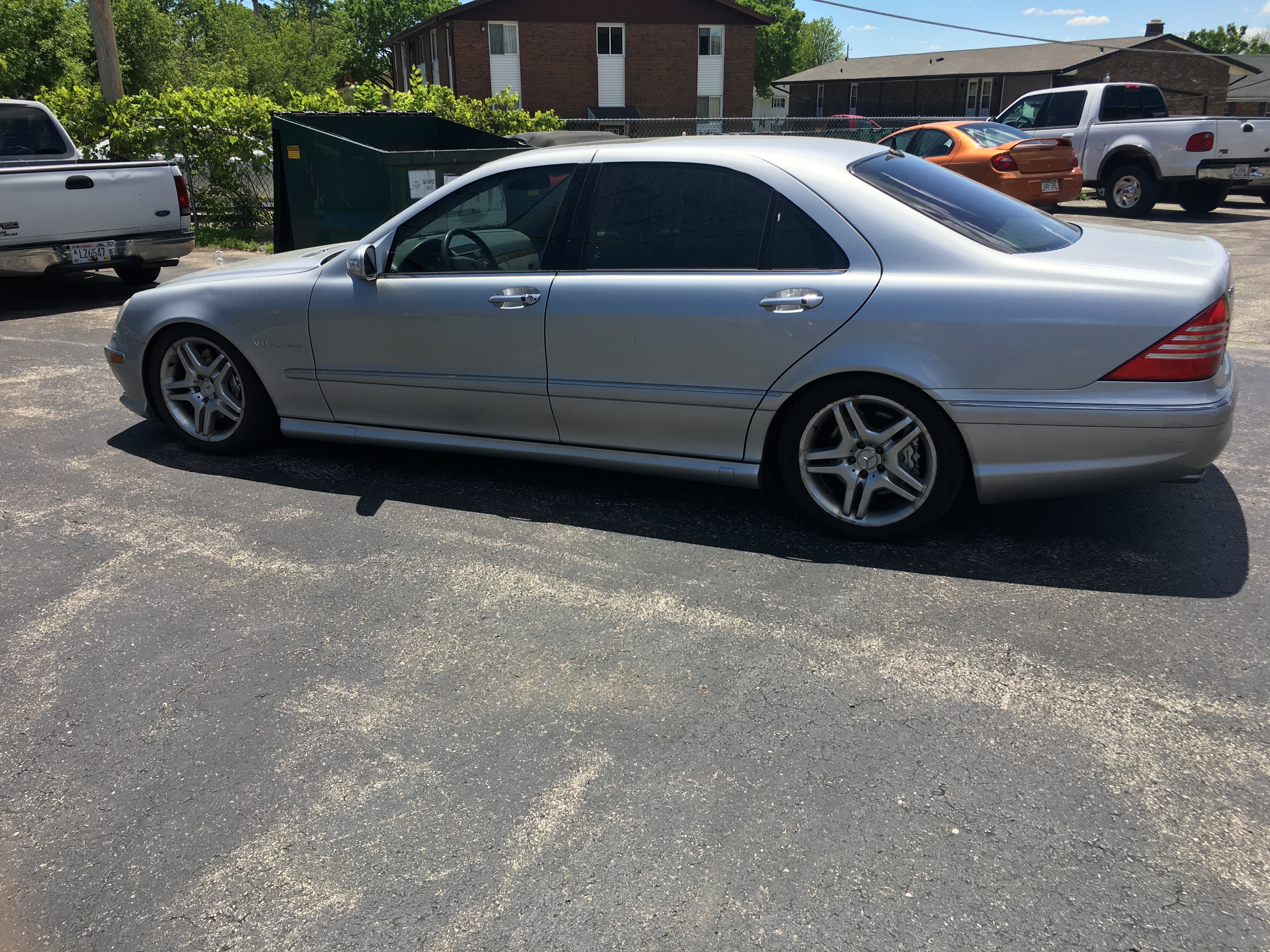

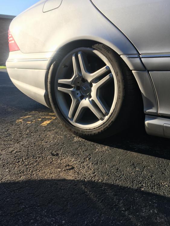

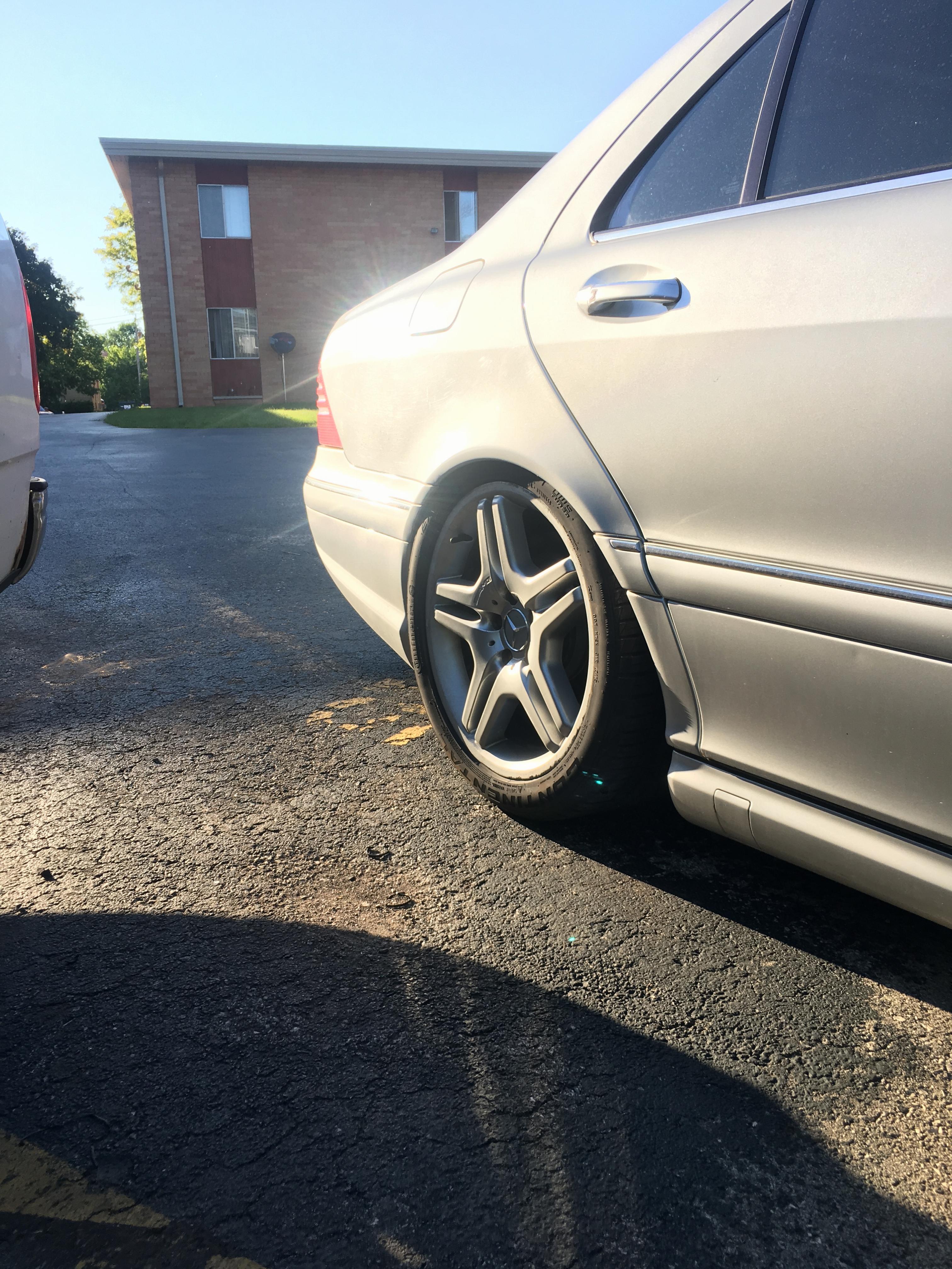

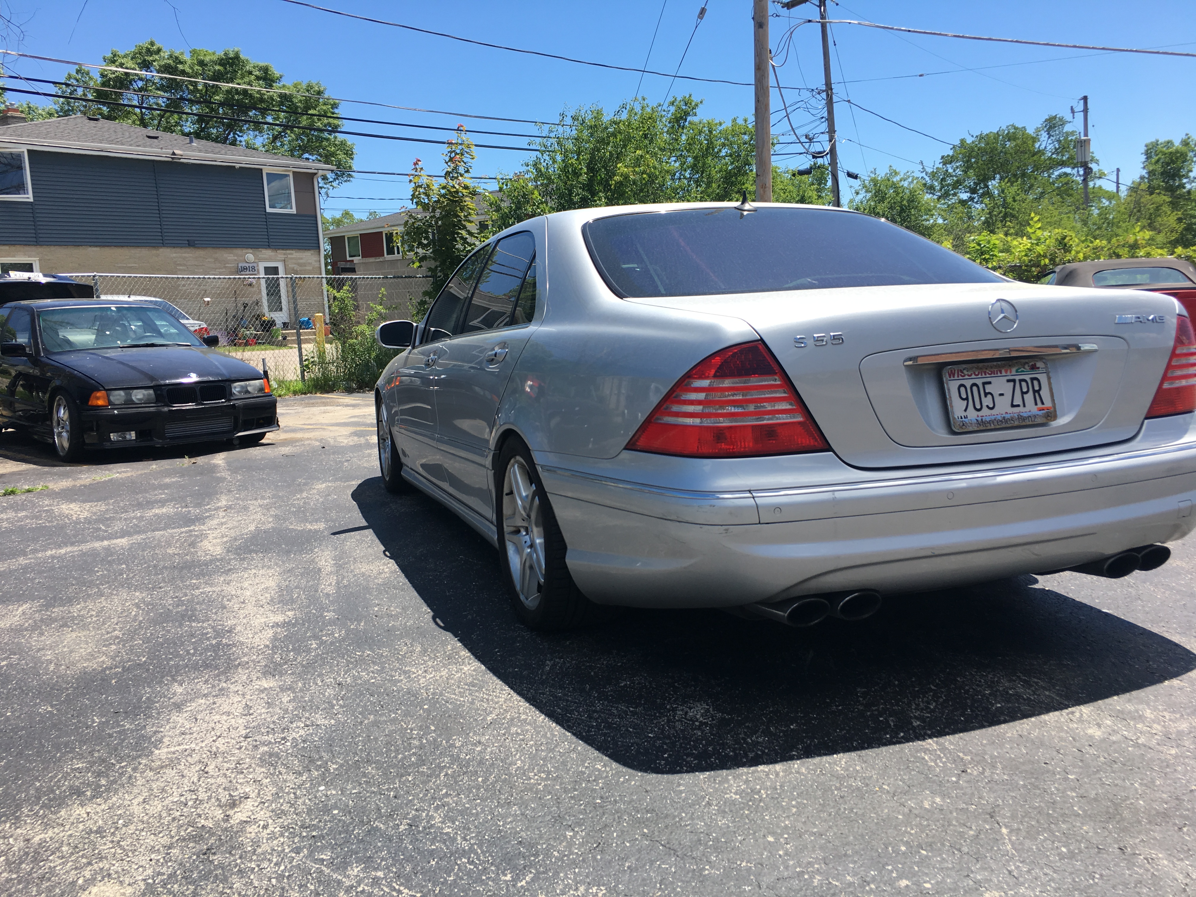

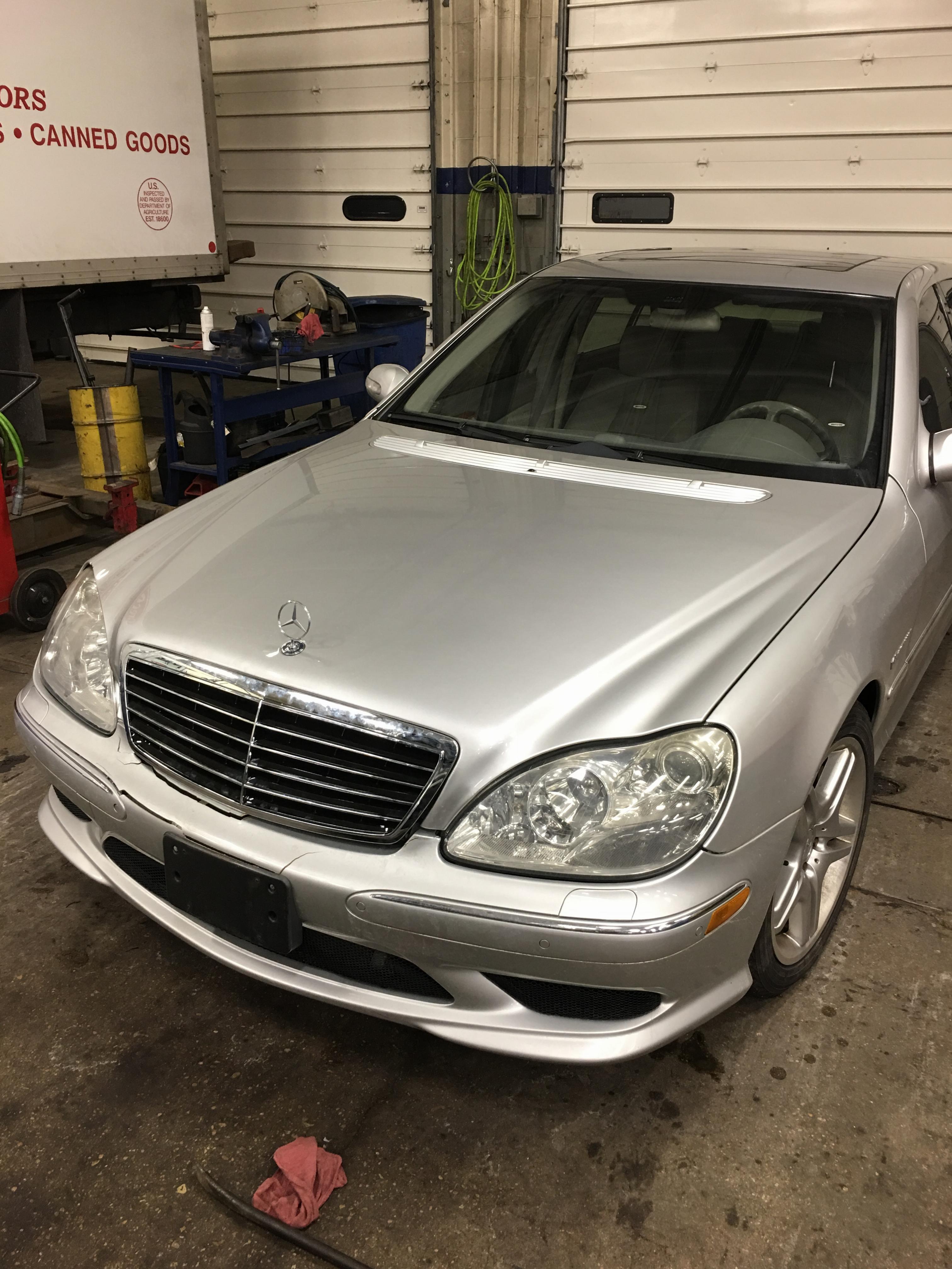

                              Figured out my car had adjustable links, when I was checking things out for the torque converter install, in the rear for the ride height sensors (hydraulic suspension)
                              So naturally I tested them out this is only half way they were in monster truck mode.
                              The front appears to be adjustable if I were to add some washers on the bolt holding the sensor to the bottom of the upper control arm, also with a longer bolt I should hit maximum low.
                                #36
                                Drive it like that yet? Looks like rub city

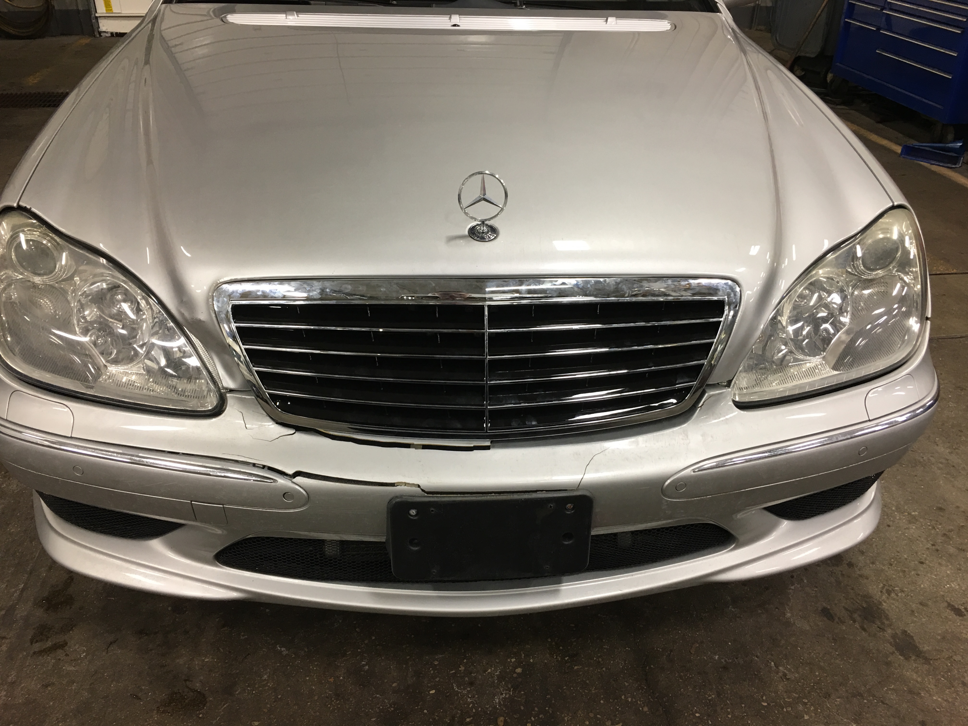

                                  8 dollars later
                                    #38
                                    Fancy!
                                      #39
                                      Is that max low in front or just with a few washers?
                                      • D
                                        Daggerty
                                        #40
                                        It can go lower I'm testing the waters for scrapage and drivability issues, the nice thing is I can raise it either 1 inch or 2 inch from the cabin.
