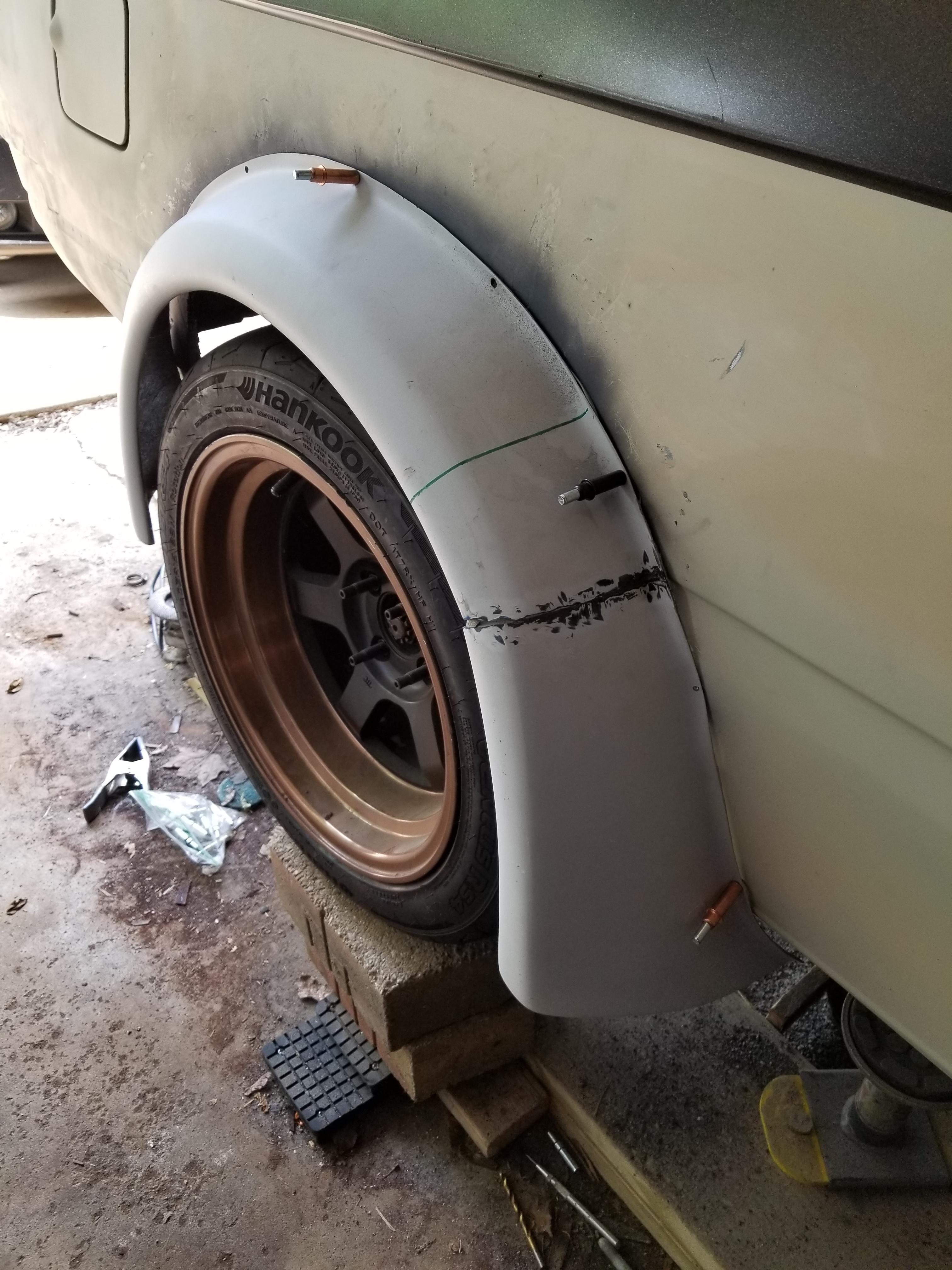

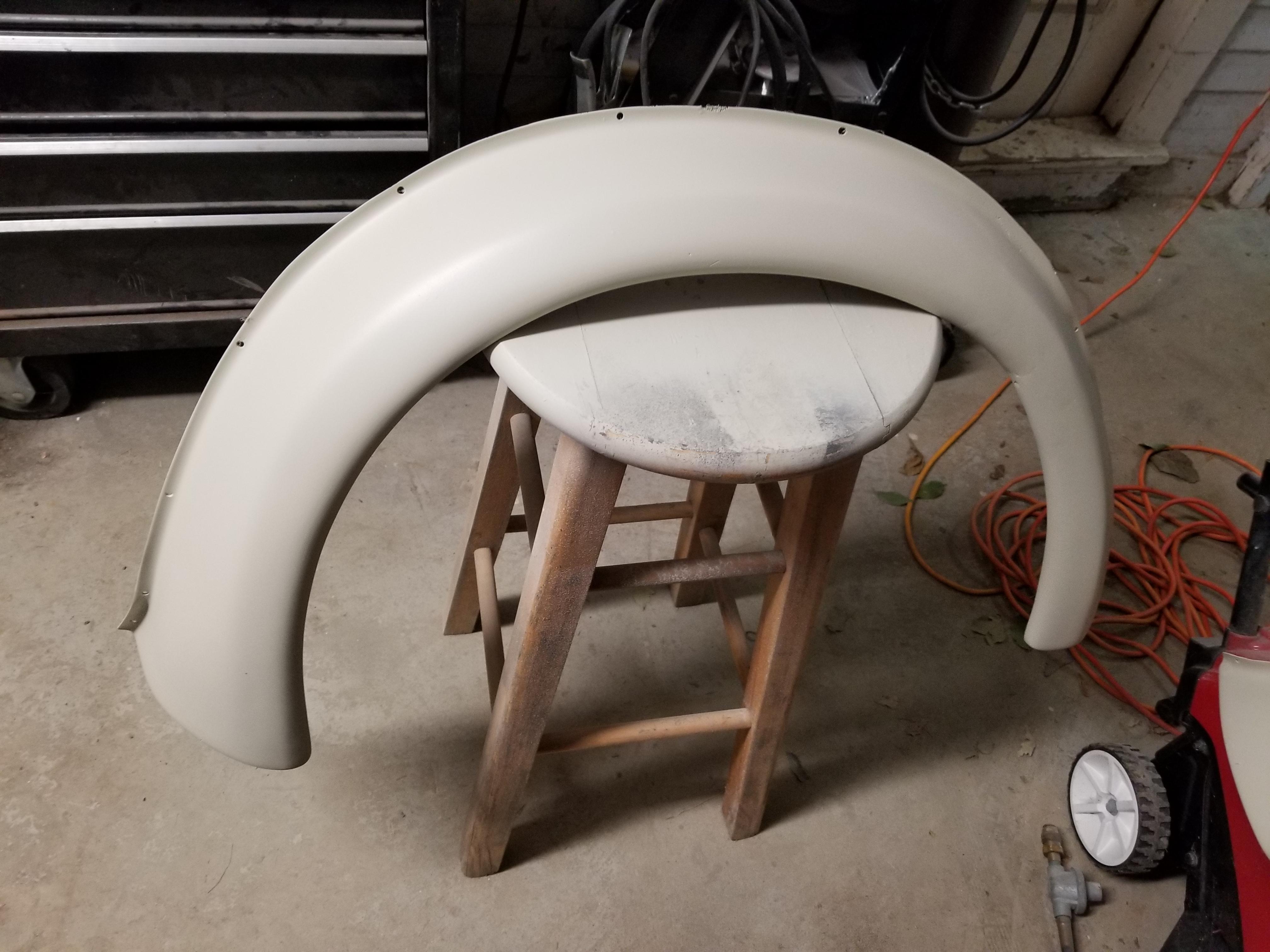

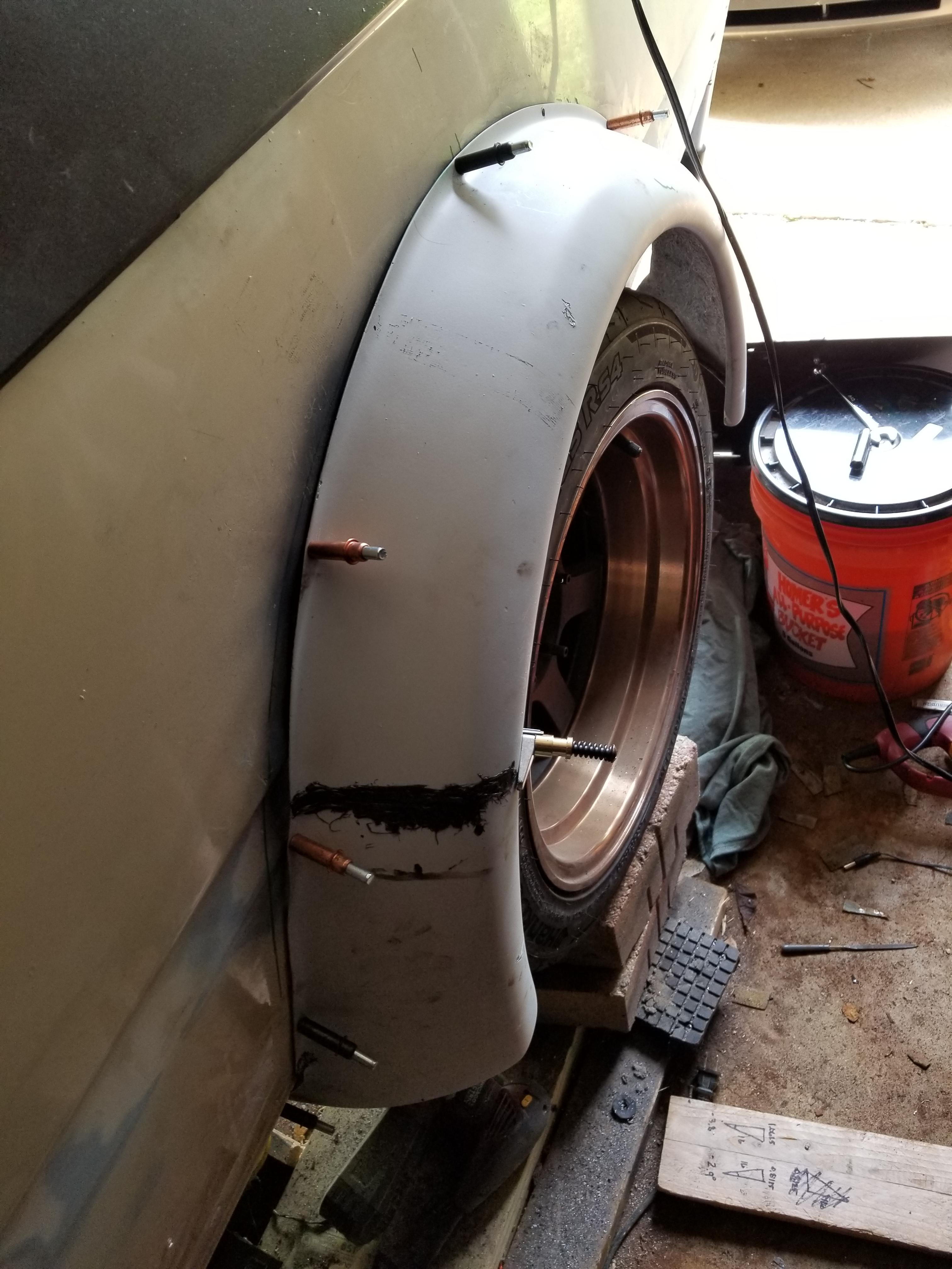

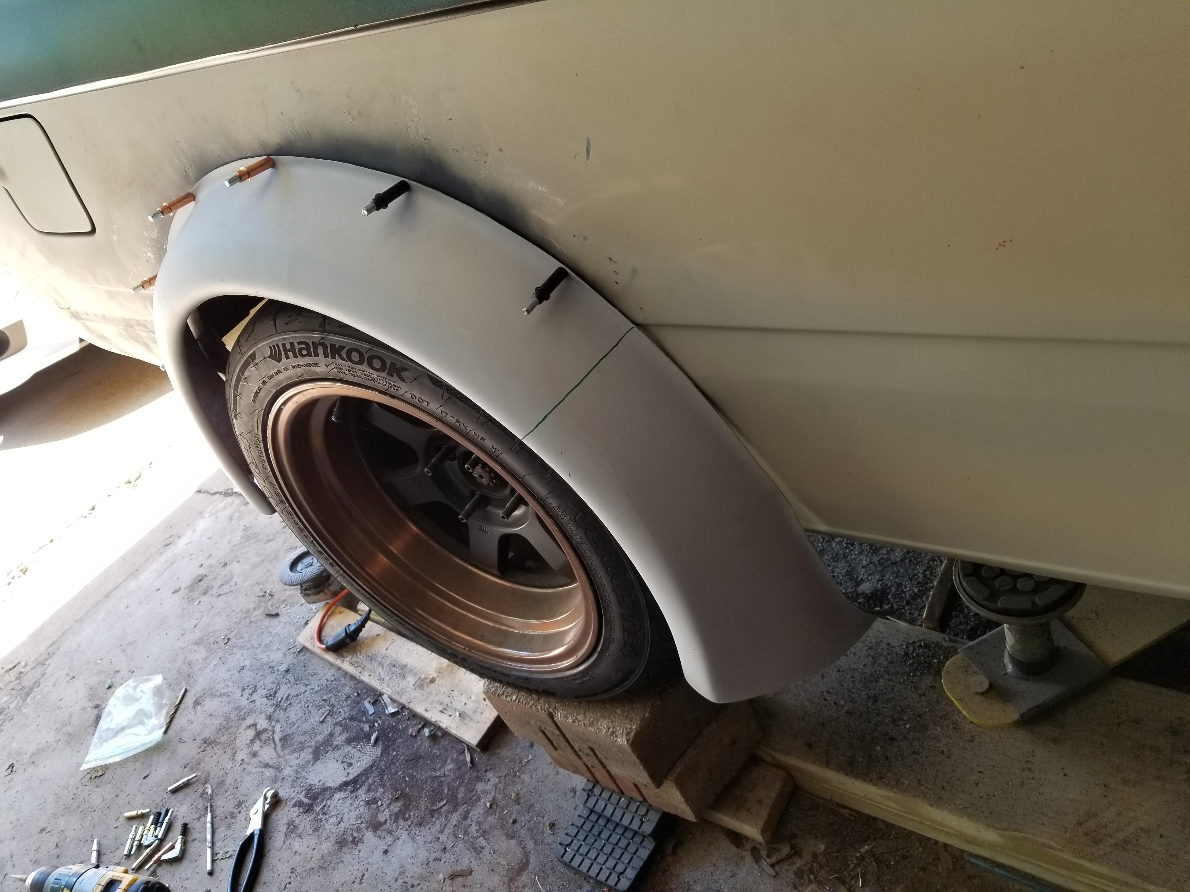

        Was finally able to do more work on this. Got the passenger side rear flare cut, sectioned and fiberglassed back together. Used it to get the measurements and did the same on drivers side. Will just need some finishing with bondoglass and body filler before 2k epoxy primer and vinyl wrap.

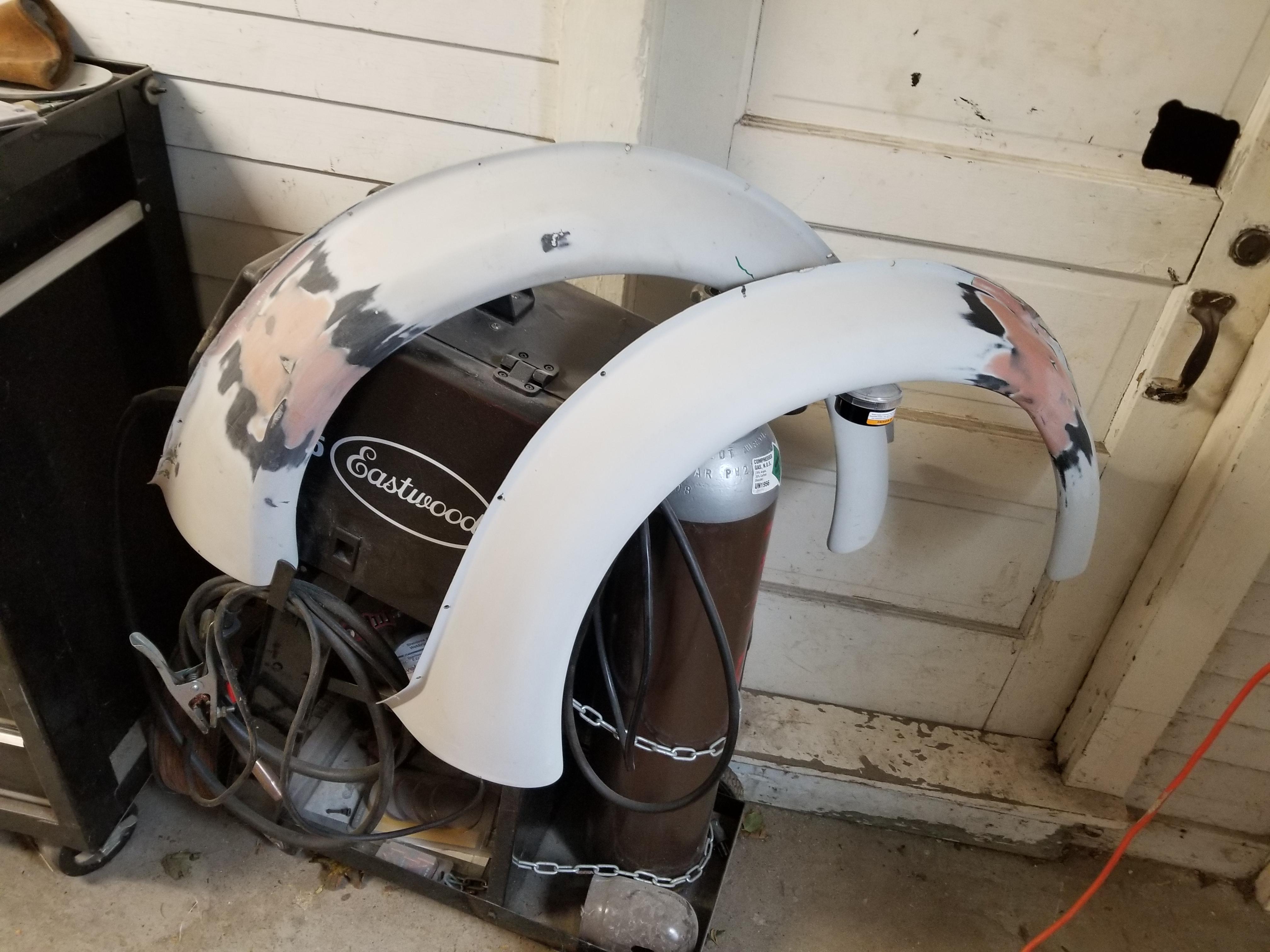

              Well life has finally slowed down, just in time for winter ... uugh. Wish it was spring, but better late than never. Finishing up sanding and priming the rear flares so they can get vinyl wrapped. Then the rest of the car can be wrapped as well.

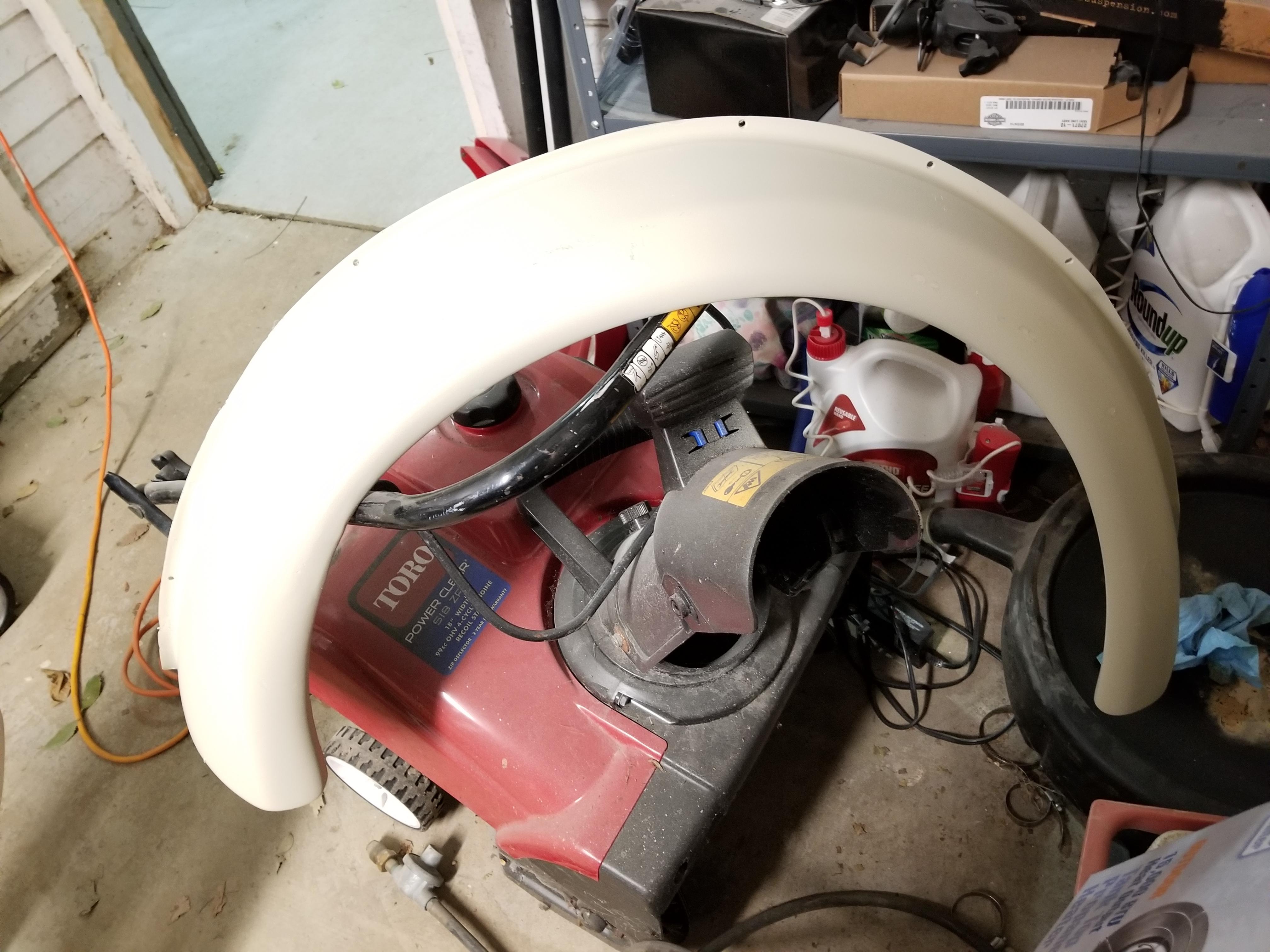

                  All primed and ready for wrap next weekend hopefully.

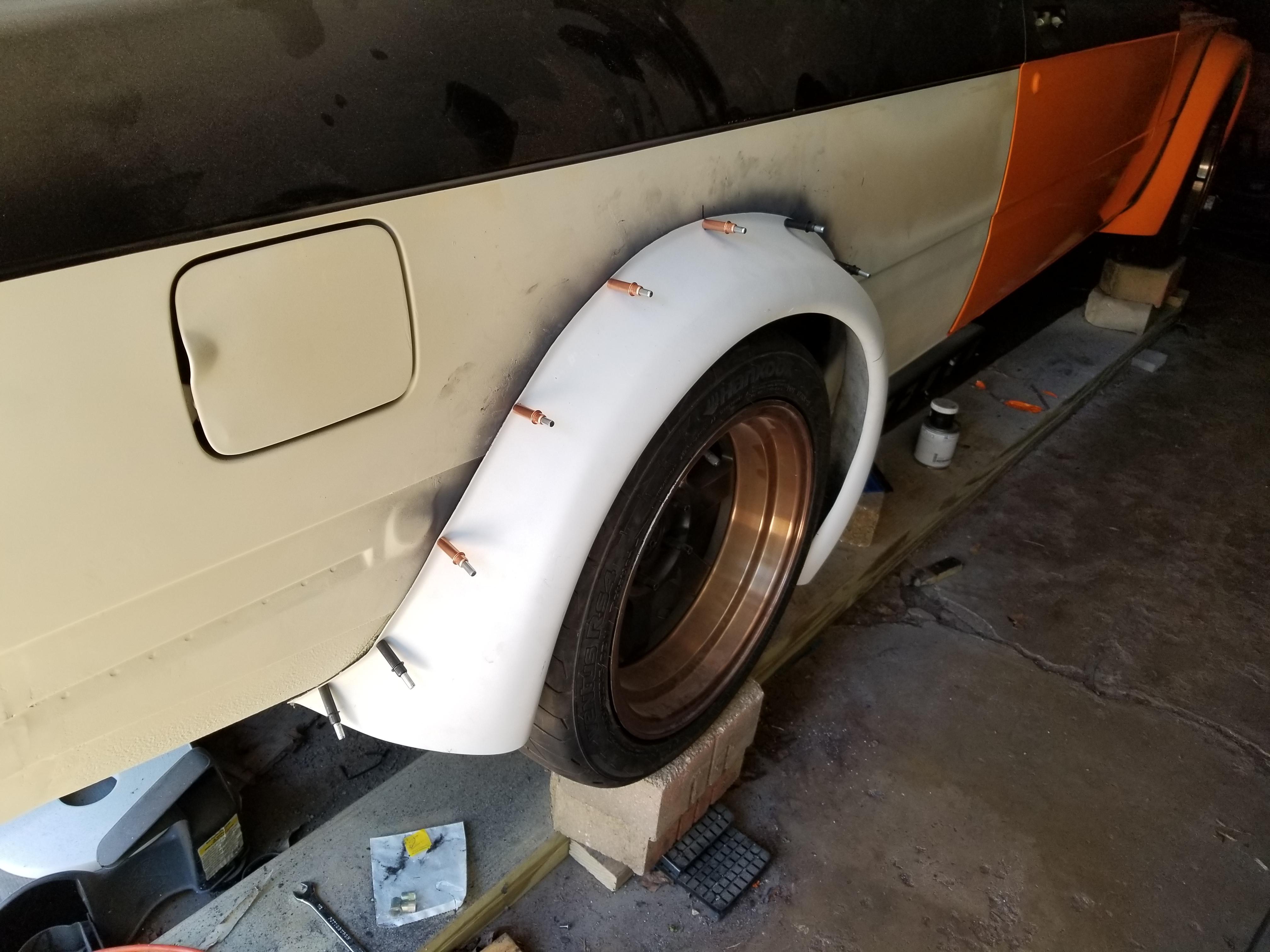

                      Rear flares fitted. Time to figure out how to finish this wrap in the cold weather. 🤔

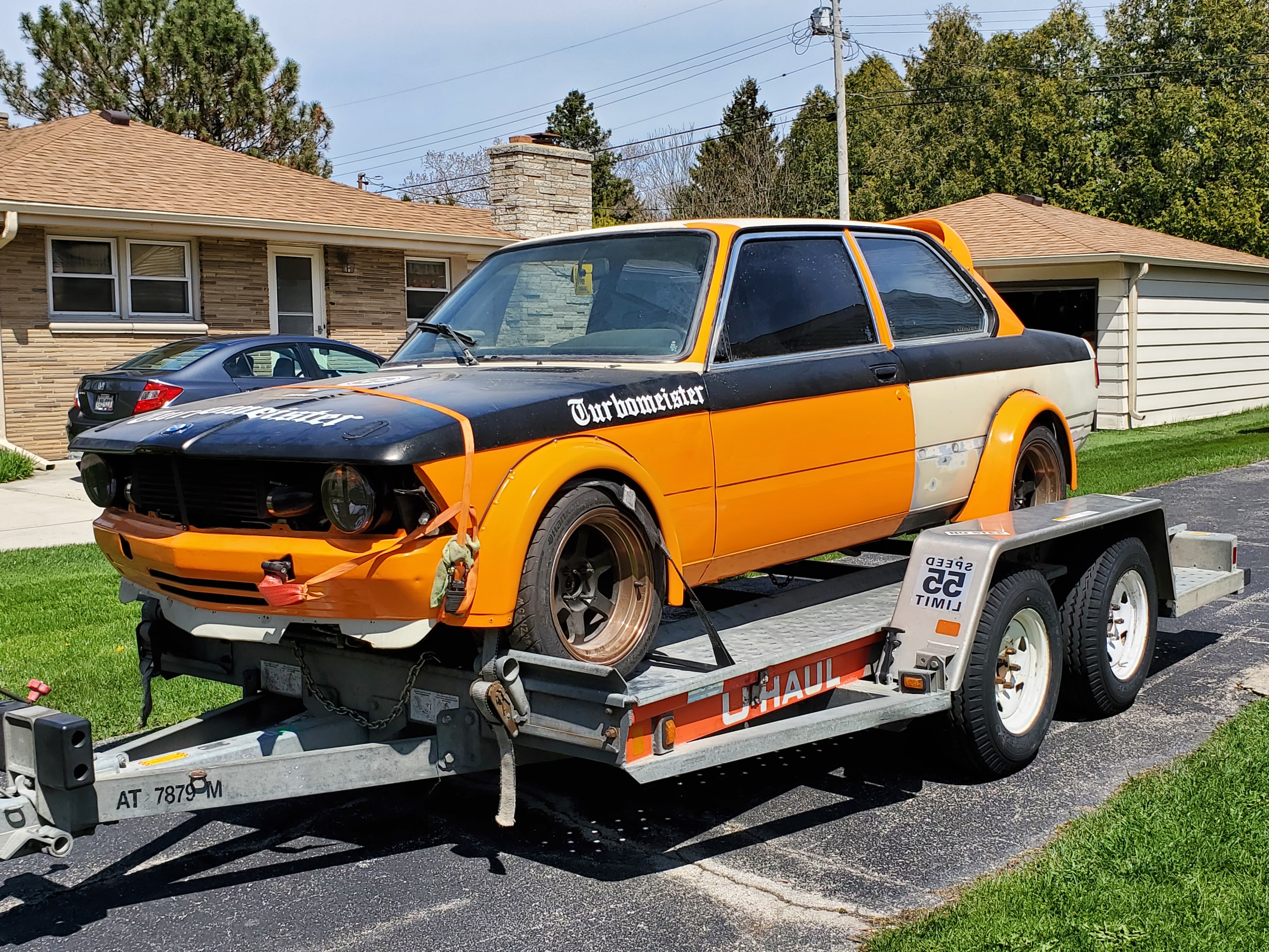

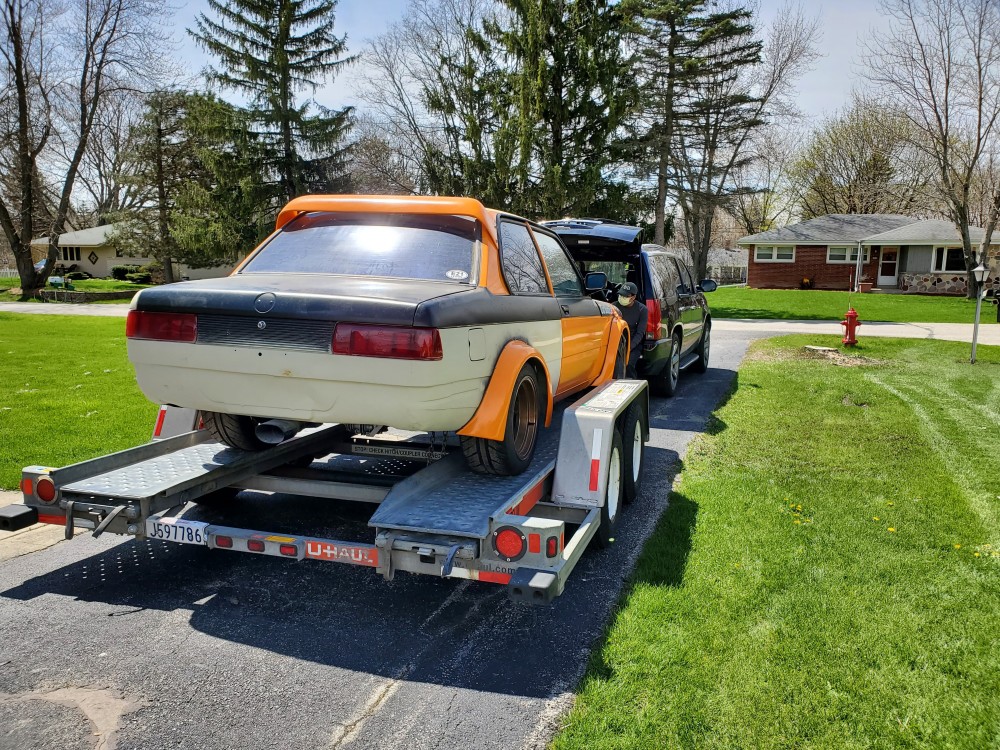

                                    The end of an era....
                                    20200501_141115.mp4
                                    • RekpointR
                                      RekpointR
                                      Rekpoint
                                      #806
                                      He nearly took out that fire hydrant. YOU TOLD ME IT WASN'T FOR-SALE ANYMORE
                                        #807
                                        Lol, yeah he did. Better the hydrant than my e46 touring on the other side. I wasn't actively selling it anymore, but got an offer that worked for both parties. It's bittersweet for sure, but I'm excited for what's to come.
                                          #808
                                          Sad but totally understandable, gotta have the fire to keep a project going for sure. Staying around locally?
