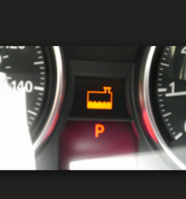

                                        what light came on?
                                        post-3533-0-06479700-1417703468thumb.jp
                                        this one?^ means low coolant

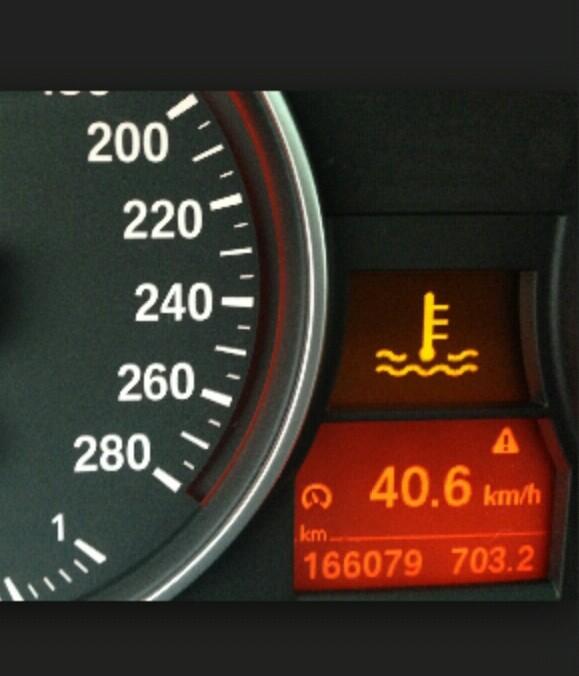

                                        or
                                        post-3533-0-46459700-1417703496thumb.jp
                                        this one?^ means overheating

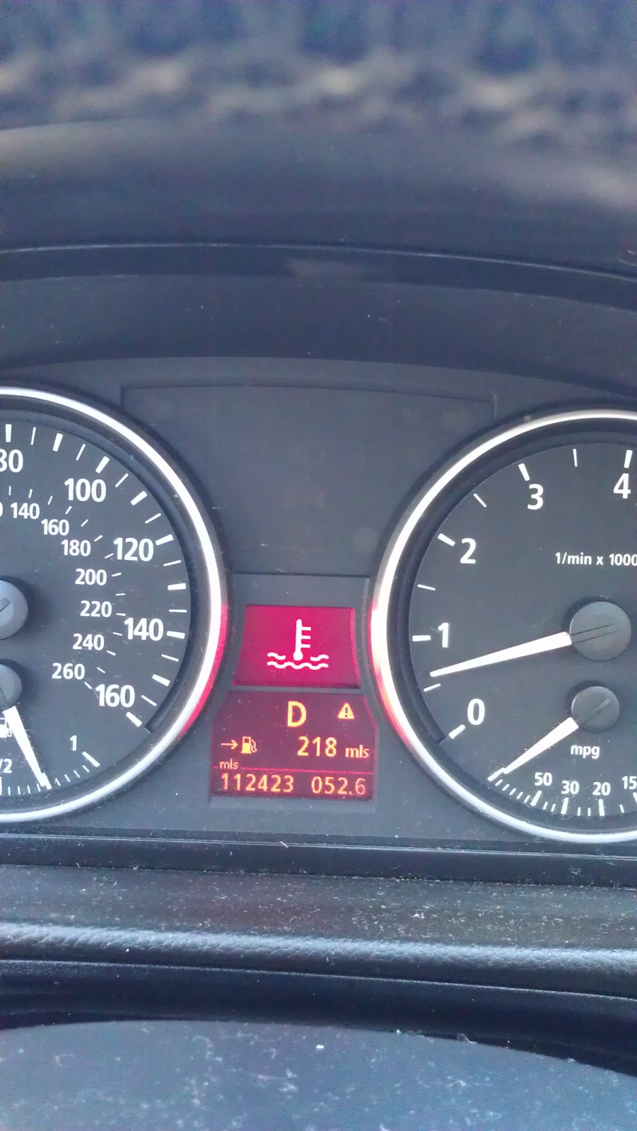

                                        post-3533-0-85641400-1417703915thumb.jp
                                        ^(red color of this light means way overheated)
                                        that could be a water pump on its way out.(all to common on the n5x motors..)

                                          The coolant light and after it first came on I checked the level in the expansion tank (engine was cold-car had been in garage 24hrs prior). The bobber's top ball was not quite level with the top of the opening of the expansion tank (indicating that it was not quite at the minimum level that it should be). So I added 50/50 up to the max indicator (where the lower ball on the bobber is level with the top of the opening of the expansion tank opening). Then I started it and it was a rough cold start and everything was fine for a few days. I went to start it after it had been in the garage for 24hrs and was even more rough and no sooner than I was 40ft away from the garage the coolant light came on and it was barely idling and stalled. So I got it back to the driveway, which was difficult and it was barely idling. Since the engine was cold I checked the coolant level in the expansion tank and it was at the max. The coolant was still on. There was no visible leak on the garage floor or anywhere under the hood all around the expansion tank and hoses..etc.
