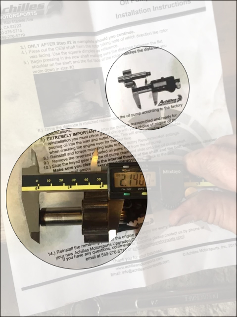

    Not sure if this is a test to see if we are actually paying attention, or you really don't like following the rules.
      #112
      To be fair, the method shown in the instructions is a pretty inaccurate way to use calipers.
        #113
        Measuring off the back face of the rotor made it easier for me to be square and consistent in measuring. +10 internets for catching that though
          I'm pretty sure that that is about as accurate as a tape measure.
