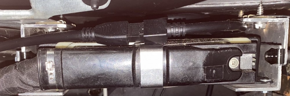

        Car has been pretty solid since the last update, I did end up making a (crude) mount for the  MS3 to get it out of the way in the glovebox 7EA705C7-0969-433D-A237-154339EDA257.jpeg

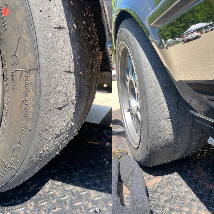

                                Forgot to post this, 3/4 RTs had normal wear after the HPDE - 1 got smoked after the lapping day. Unfortunately, not uncommon with the RT. Luckily I have 3 decent condition take offs that I kept (2020) so was able to get it swapped out before the dells autox 8F2F4B34-FDFA-4A6B-A384-851D77D9080C.jpeg
