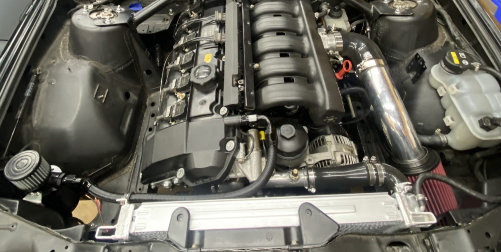

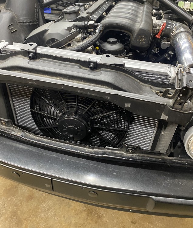

              New CSF rad is in, re-did the foam in between the rad and the core support to seal up air gaps, replaced the tstat, replaced the ecu temp sender in the head, re routed the catch can line, got a new fan harness/relay that is wired as a ground switched setup - future MS3 triggering perhaps
              earlier I mentioned I thought the fan was bad, but I think the mounts shifted and caused some binding between the shroud/fan. I tested the fan out of the car and all seems well (it’s a 2 year old SPAL pusher) just remounted a few brackets and gave it a touch more stand off from the radiator (1/4-3/8” standoff in case stuff moves around).
              currently have the glovebox and center console stuff out of the car to get some of the wiring cleaned up. Once it’s back together it will be more dialing in The tune/car
                #485
                Used the install of the new fan wiring as an excuse to Clean up a bunch of wiring for the MS3, gauge wiring, and other stuff I had been putting off as I hate removing all the interior stuff. Got it all buttoned back up last night. Tonight going to rebleed the coolant after putting in the new radiator.
                eventually I should probably have it aligned, but next up is making a mount for the MS3 as it’s just hanging out in the glovebox & making some type of heat shield to go in between the filter/engine Bay Area along the frame rail

                                  Car has been pretty solid since the last update, I did end up making a (crude) mount for the  MS3 to get it out of the way in the glovebox 7EA705C7-0969-433D-A237-154339EDA257.jpeg
