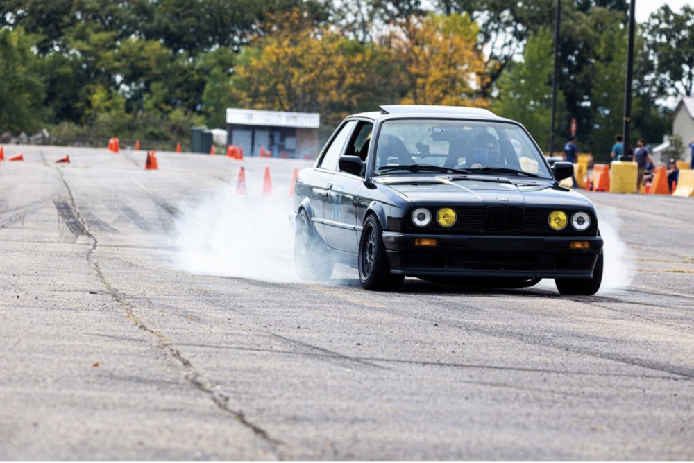

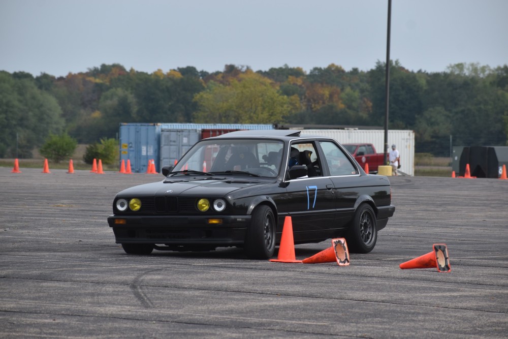

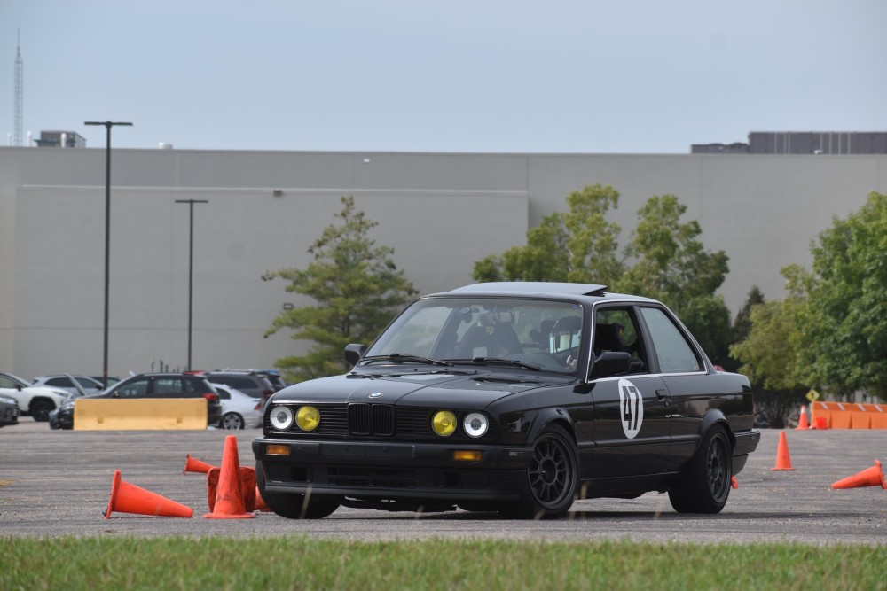

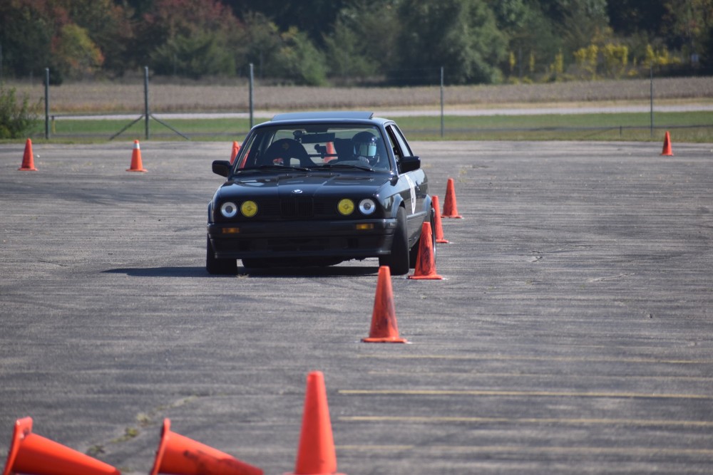

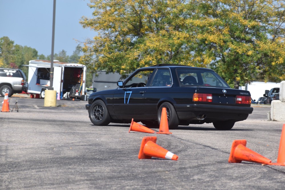

                Dells autox went well, 2 day event. Gf and I codrove the car both days. I took 1st/4 in XSB (7/84 raw) and she took 2nd/4 (14/84 raw) in XSB on day 1. Day 2 I took 1st/5 in XSB (5/92 raw) and she took 2nd/5 in XSB (15/92 raw). The 3 year old RT was in the rear and held its own too ha.
                the lot was extremely bumpy so it was 2 days worth of lockups with no abs, adjusted the bias as much as I felt comfortable with, but just took it as an opportunity to get better at not blowing the fronts off over the large cracks/bumps37C8FD43-753A-453D-ACF4-7A17CBBDD27E.jpeg
                ^the finish on day 1s course was sketchy, in 3rd gear across the line and trying to stop after basically a straight, before the parking lot ended494E65F5-199B-4ED1-B3CD-26F16AA6E244.jpeg20D4E408-7CE4-4B66-957C-A8259448C1C4.jpeg7BDC7E51-51B9-4DE9-BB36-E5CEFFA3C68B.jpeg4CA71BB2-BD96-420F-BBF2-A27F4A4D210C.jpeg
