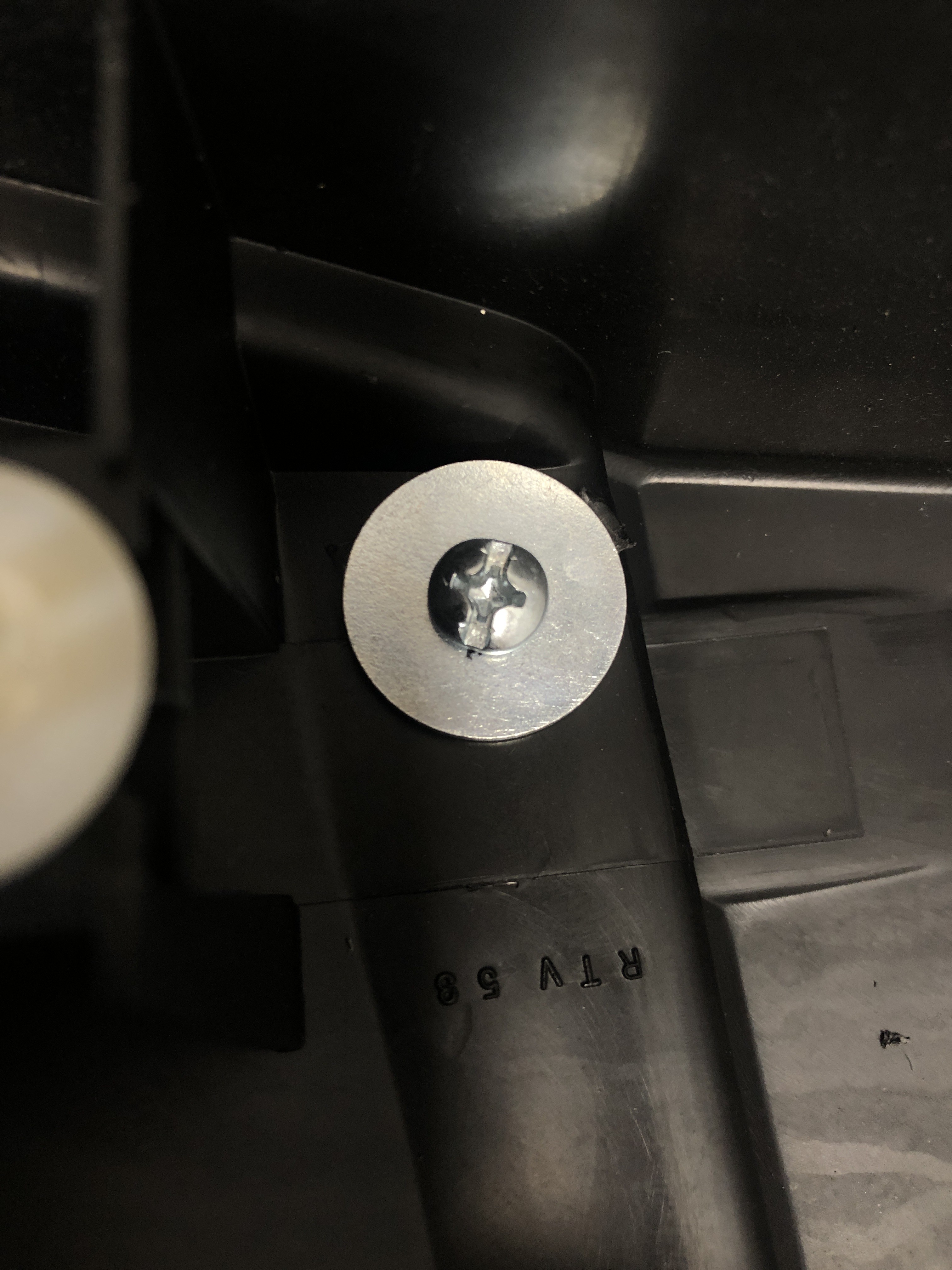

  • 2002 E46 M3 // Build Thread
    pynaclP pynacl
    Members BMWs

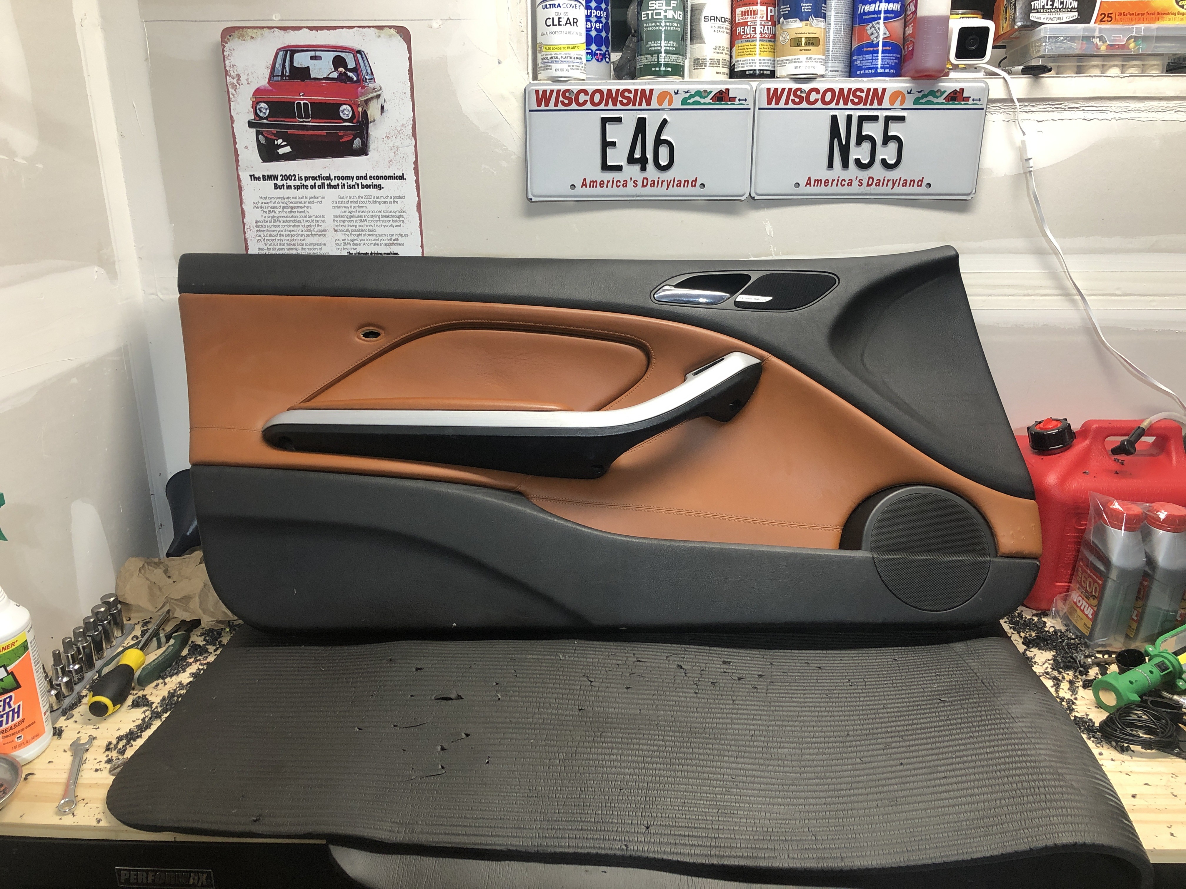

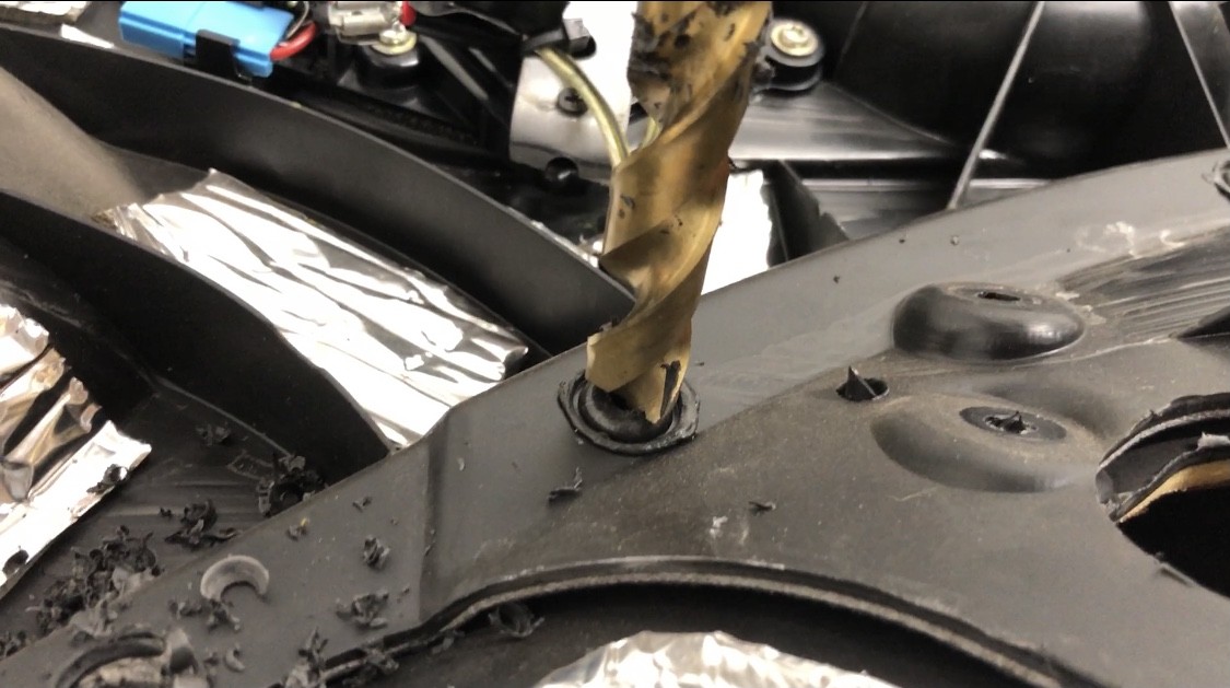

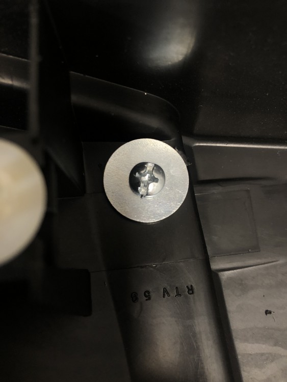

    Finished drilling out like a million plastic rivetĀ headsĀ and reassembled the inserts into my door cards! Probably not the best solution but I resecuredĀ them using short self tappers (3/4ā€) and fender washers (20mm). Fit and finish is perfect, super jazzed how the swap turned out.

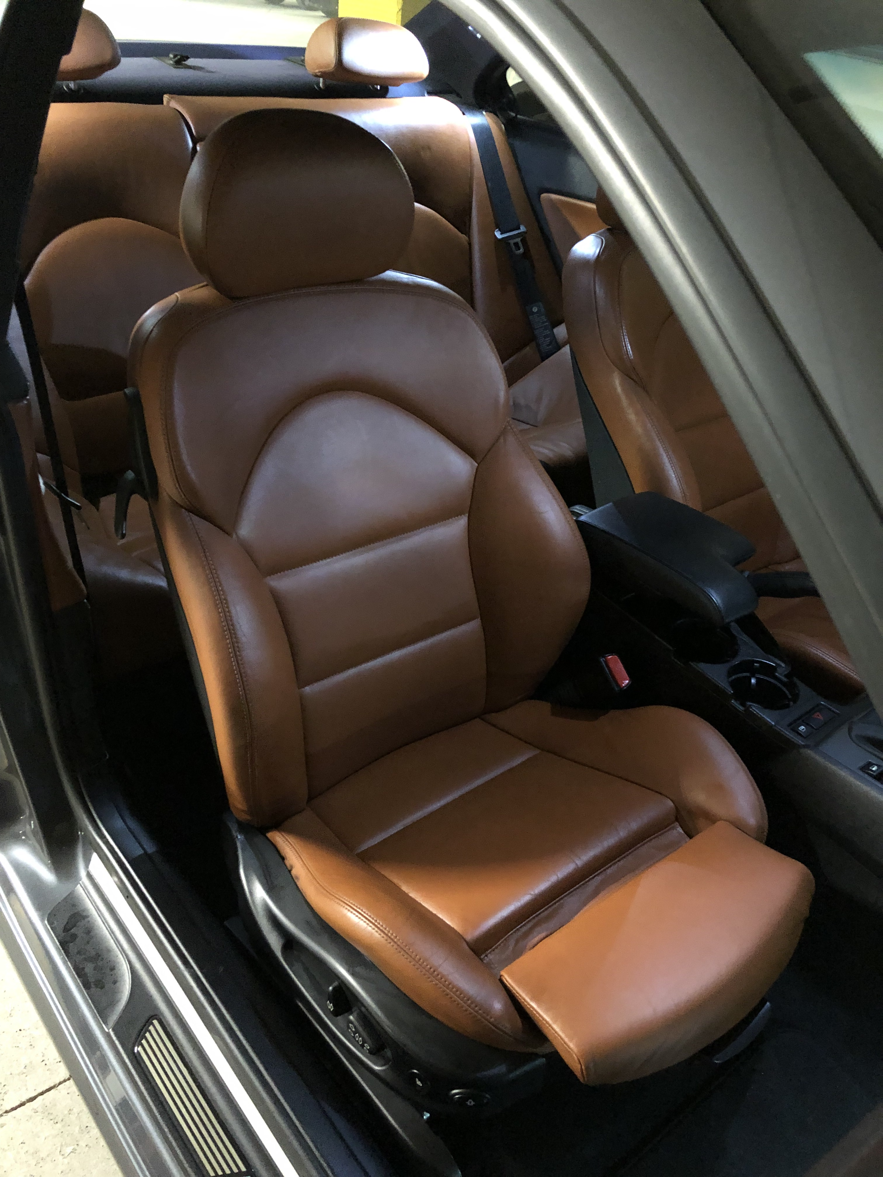

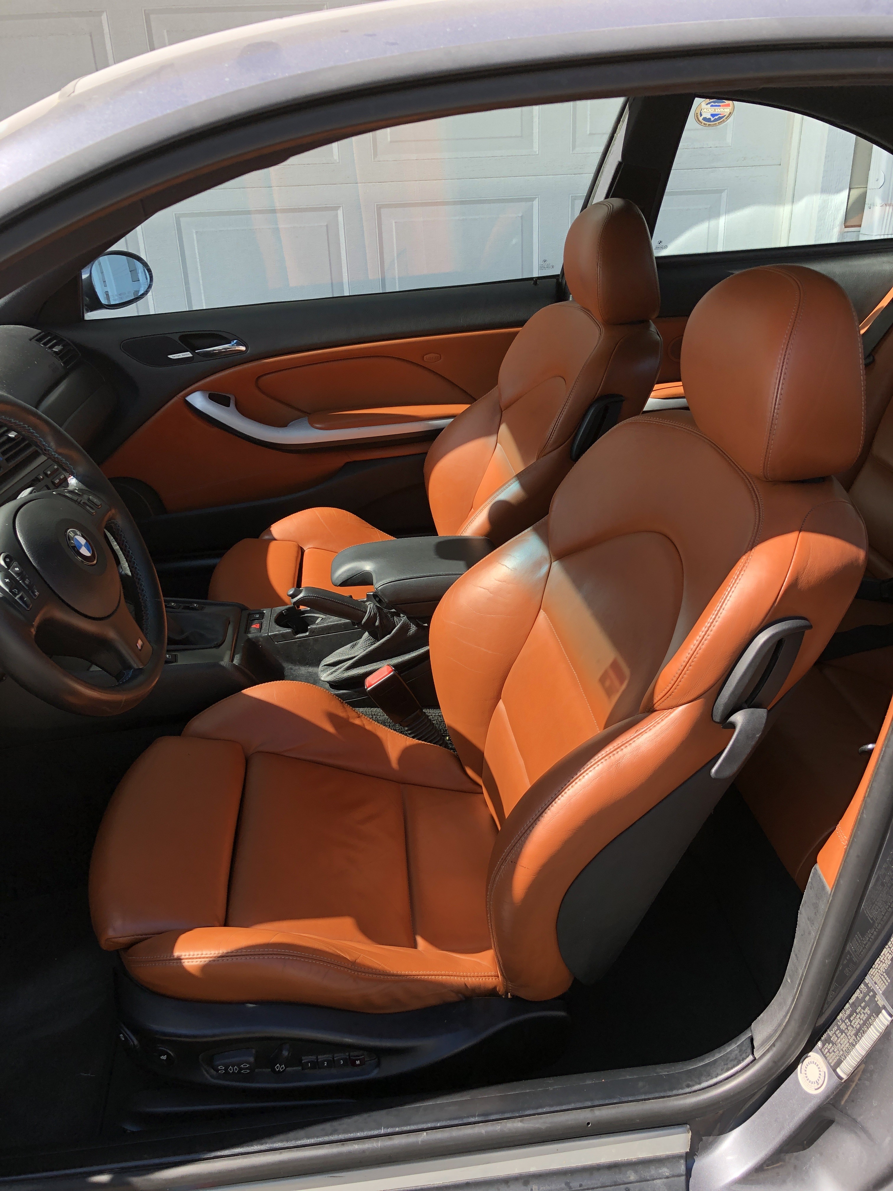

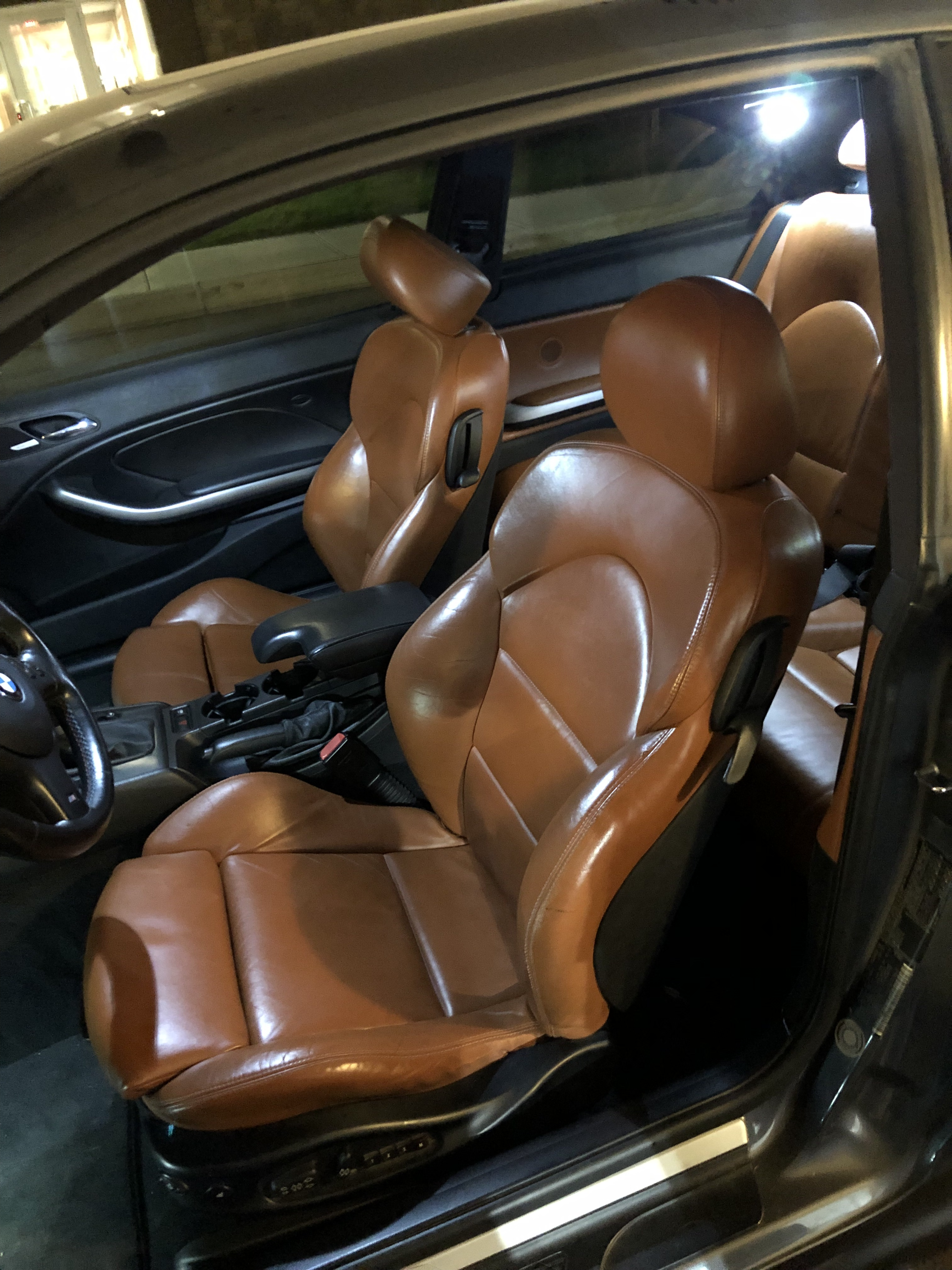

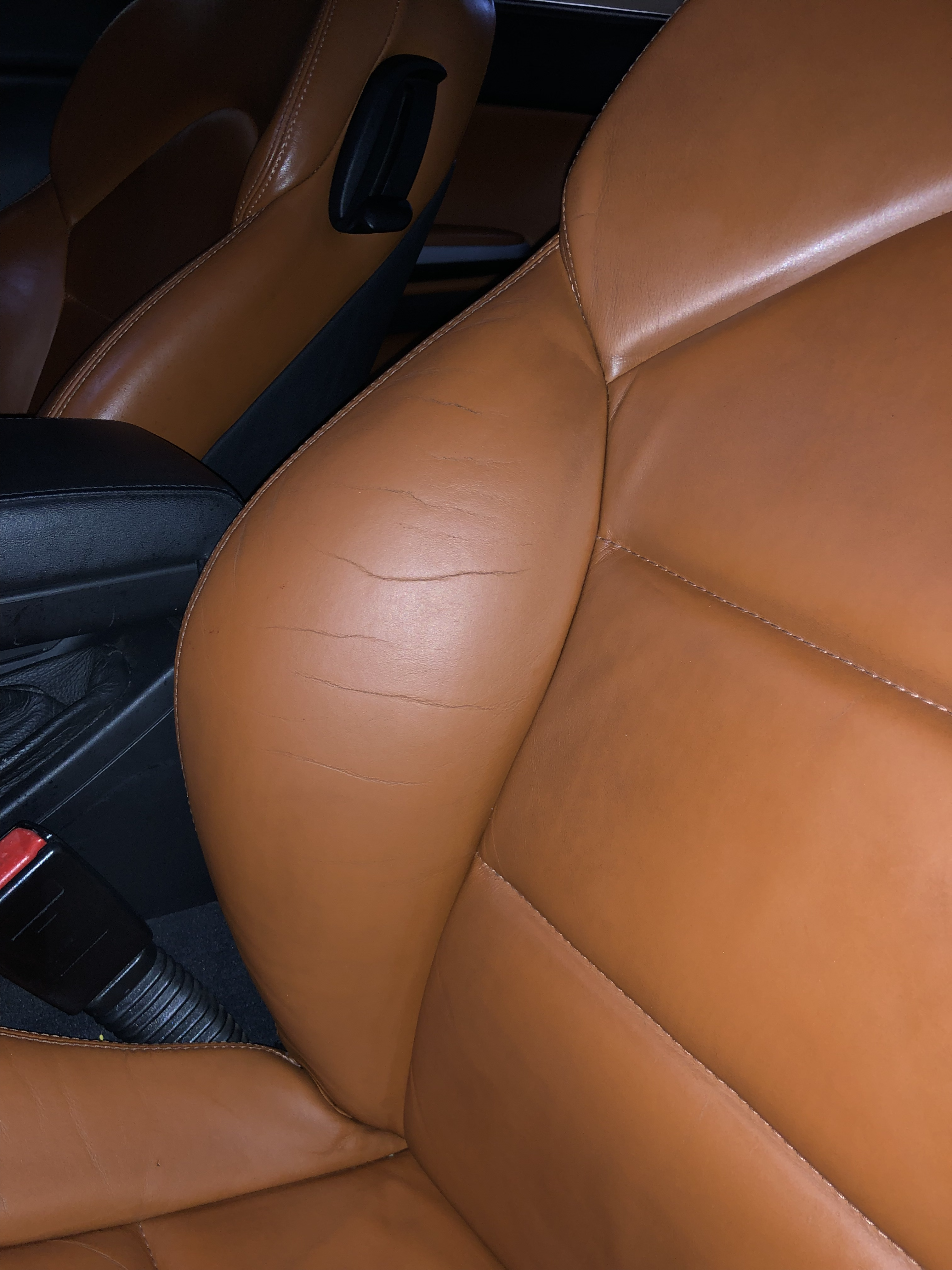

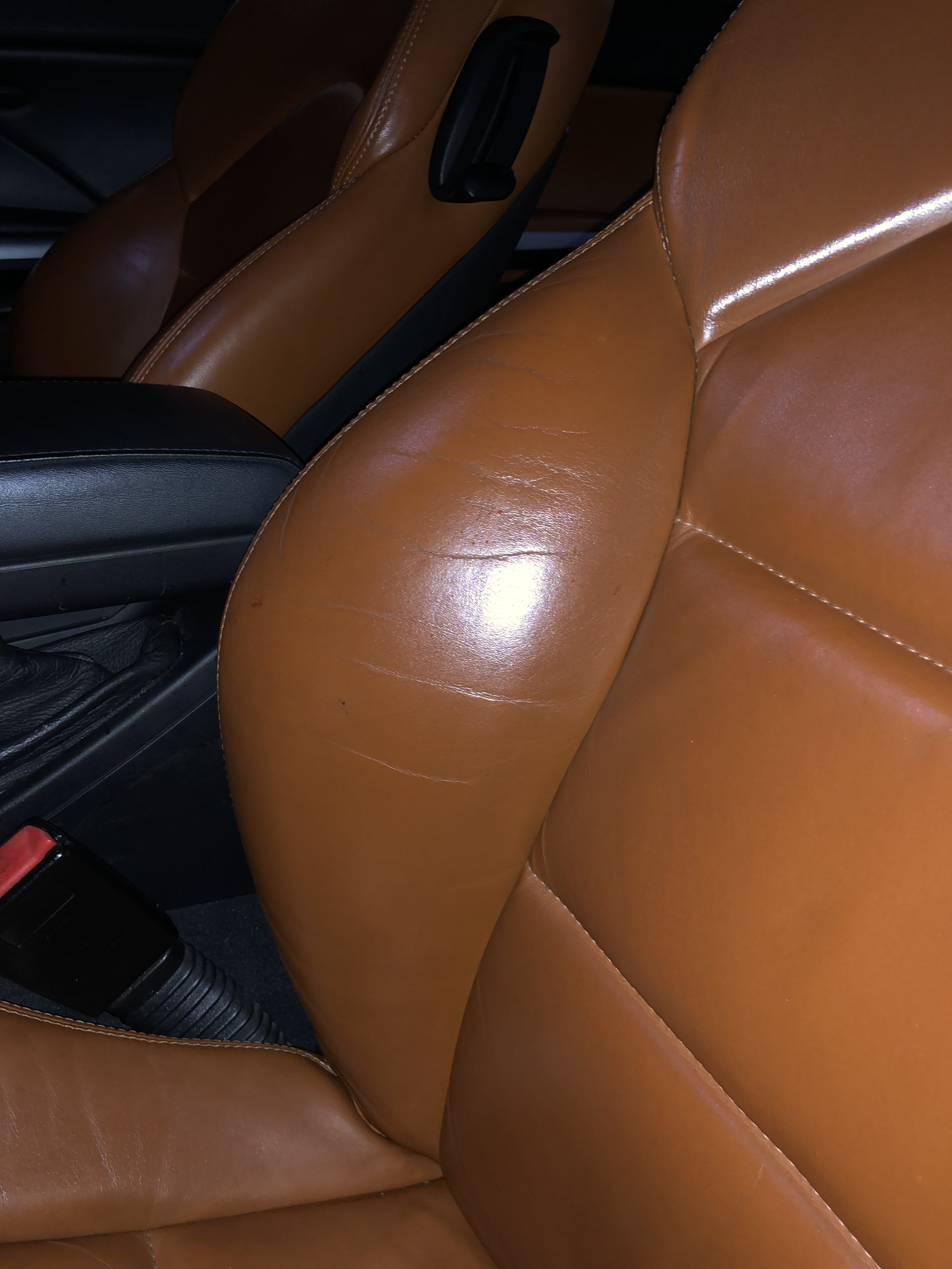

    The seats were REAL shiny. I tried hitting them with some Lexol leather cleaner and a microfiber and it didn't put a dent in it. I know it's a sin, but I VERY carefully used a magic eraser (with zero pressure applied) and Adam's interior detail as lubricant. I was careful to only buff off the oils/grease and not damage the protective "clear coat" layer. Hard to tell from photos, but they look night and day different.
    edit: still need to swap the front door cards, just haven't had time yet
    Before:
    After:

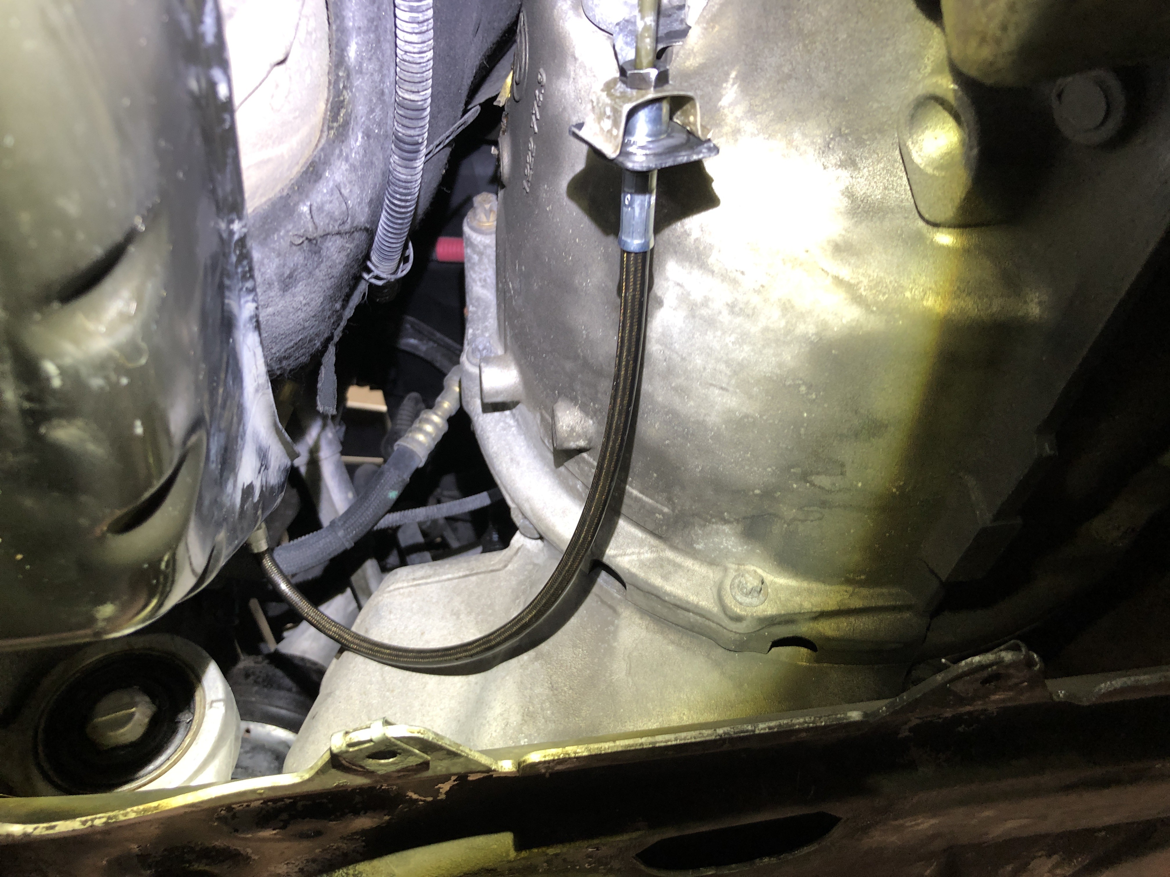

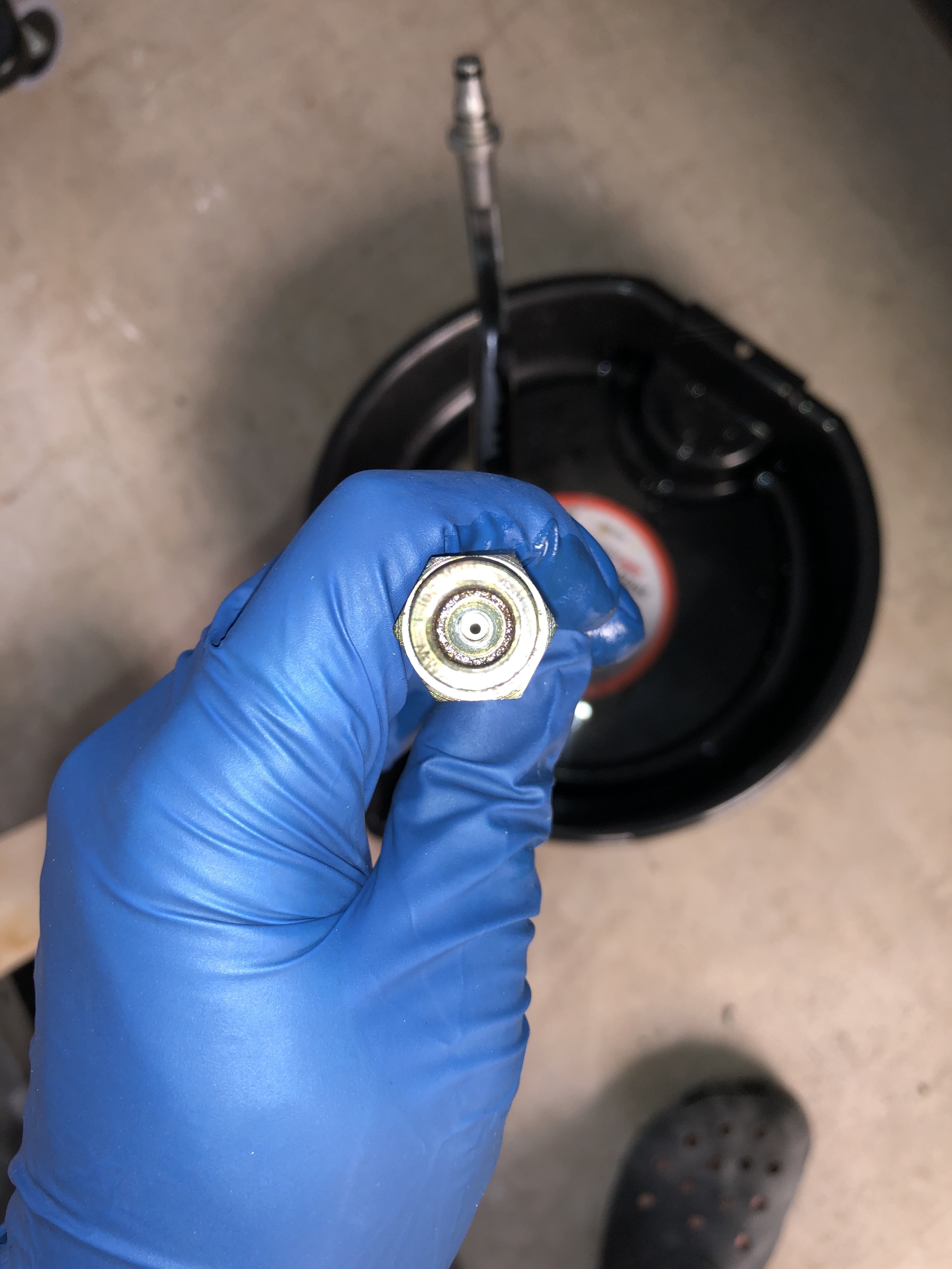

    pynaclP pynacl
    Members BMWs

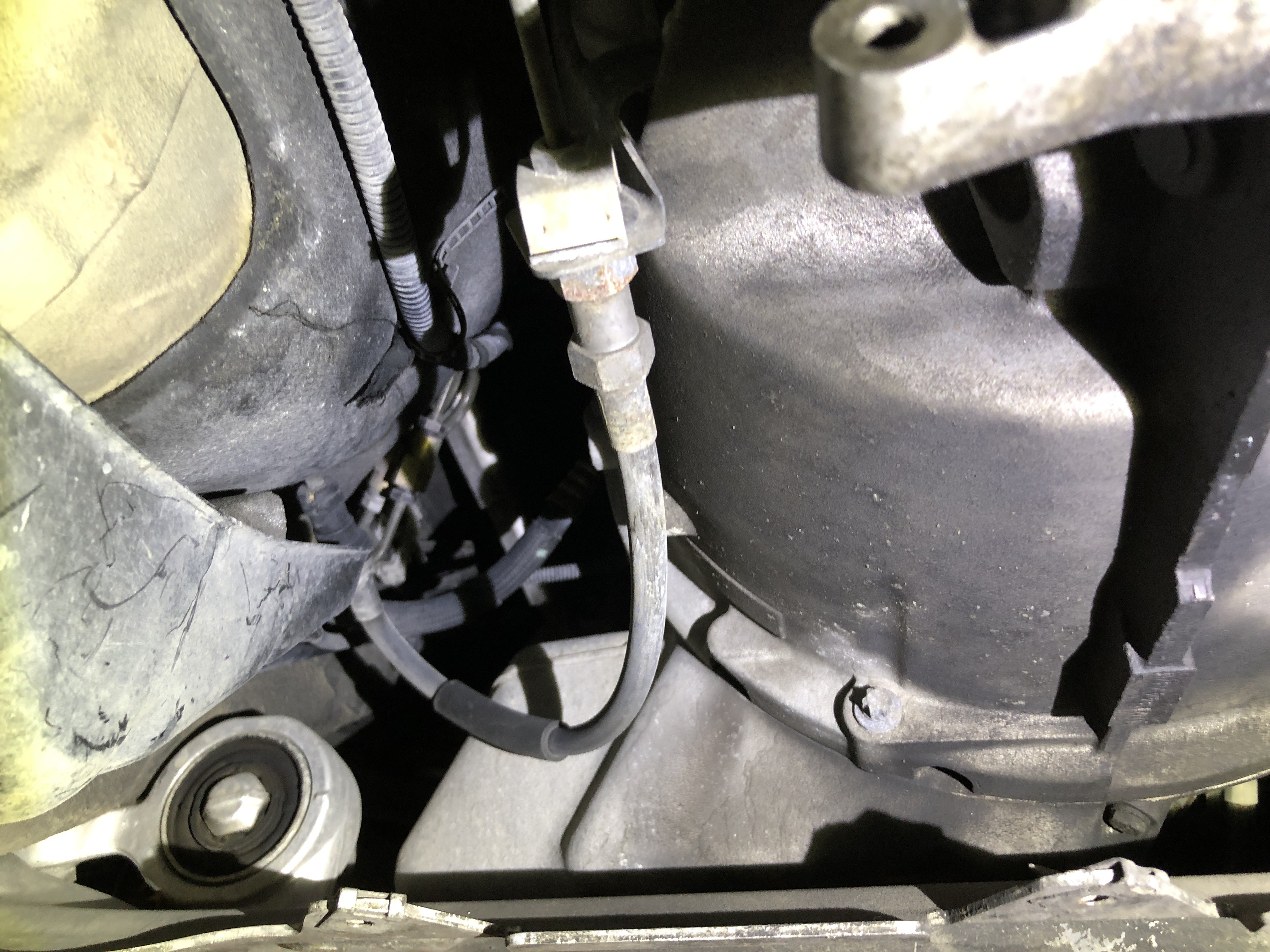

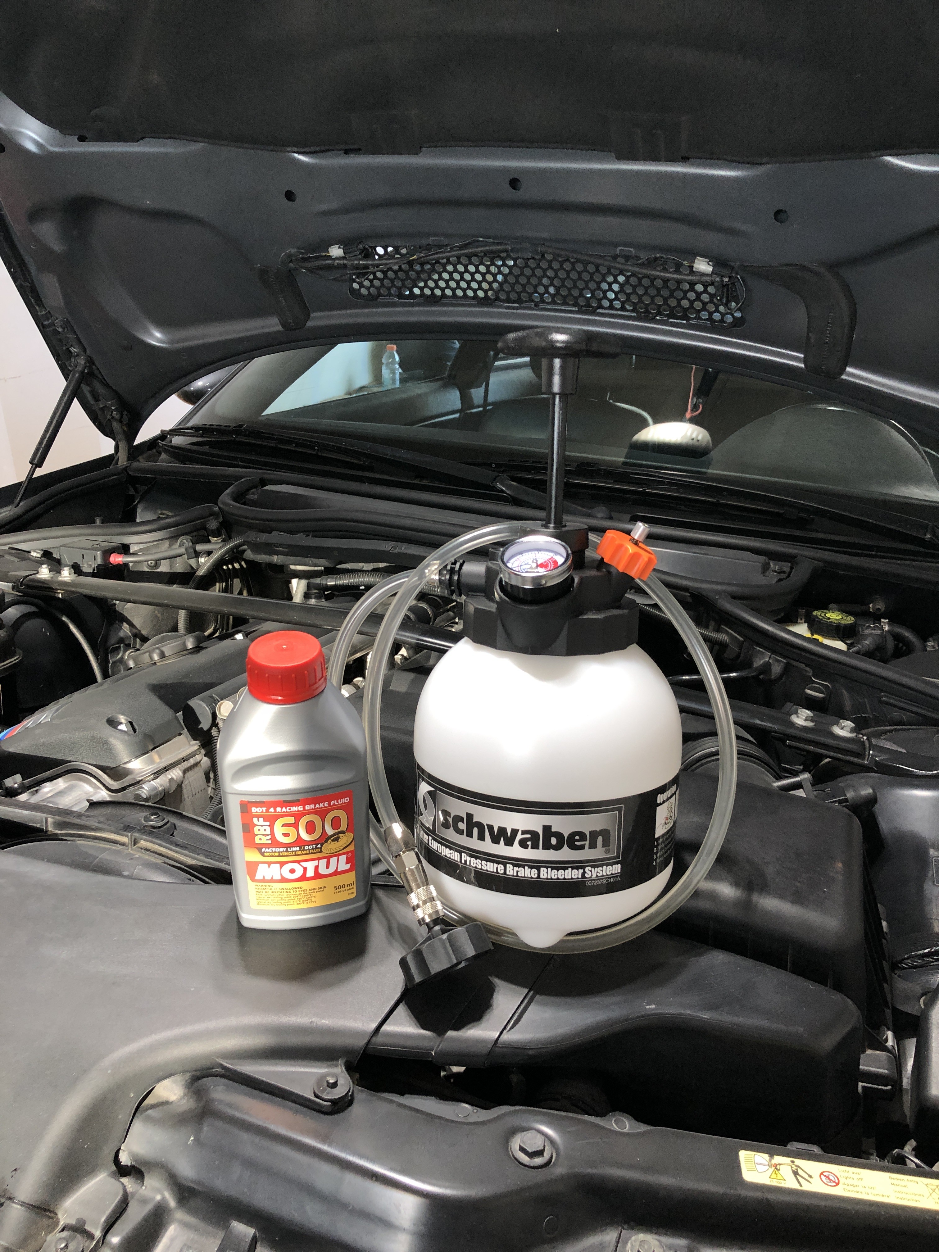

    Finally installed the Rogue Engineering stainless clutch line I've had on the shelf for months. Mainly did this to remove the clutch delay valve for a more responsive clutch feel. Job was messy as all hell but a power bleeder made the bleeding process a breeze. Took it for a test drive and it definitely feels more responsive. Not a night and day difference per say, but totally worth it. Frig I love this car
