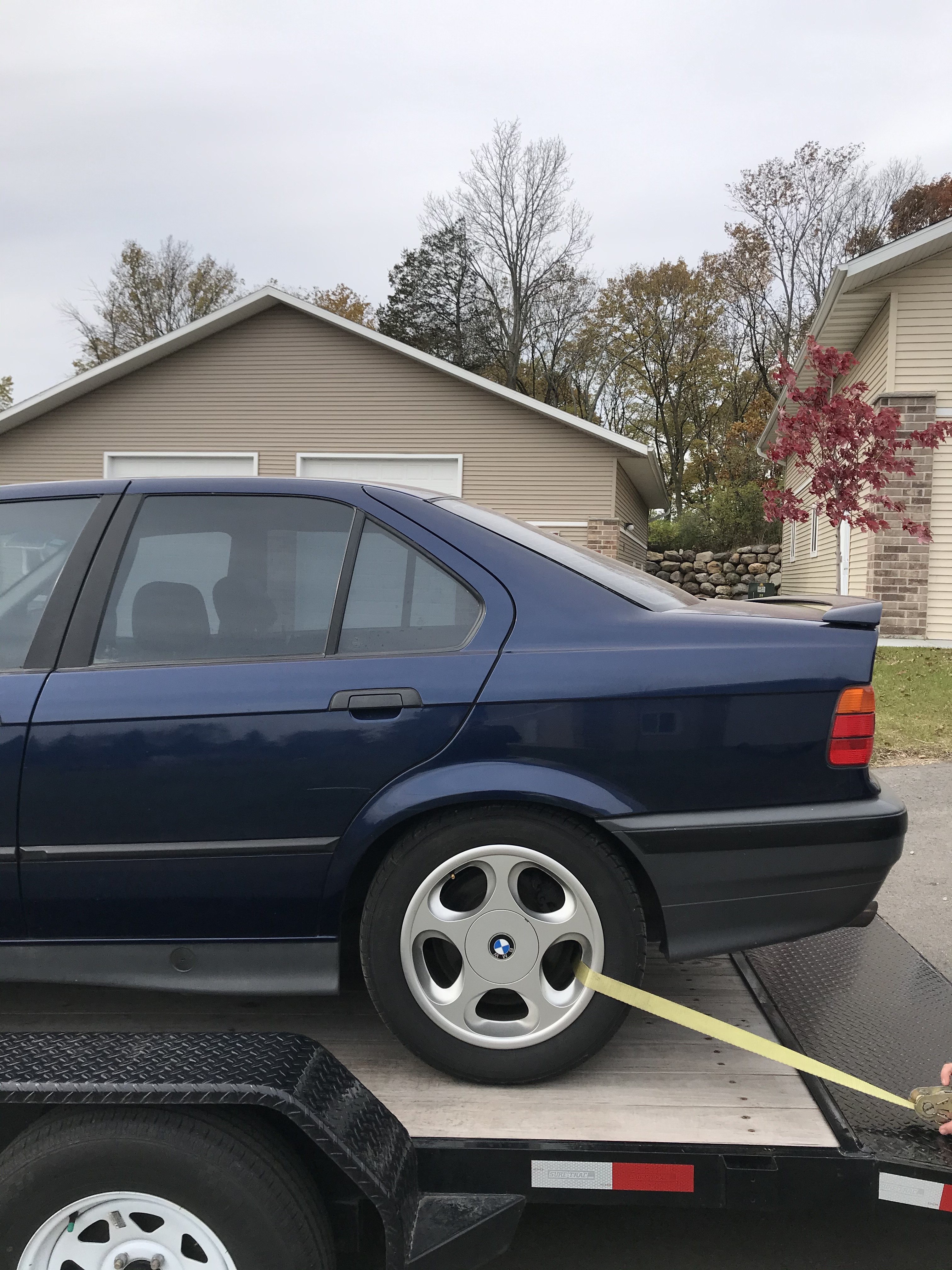

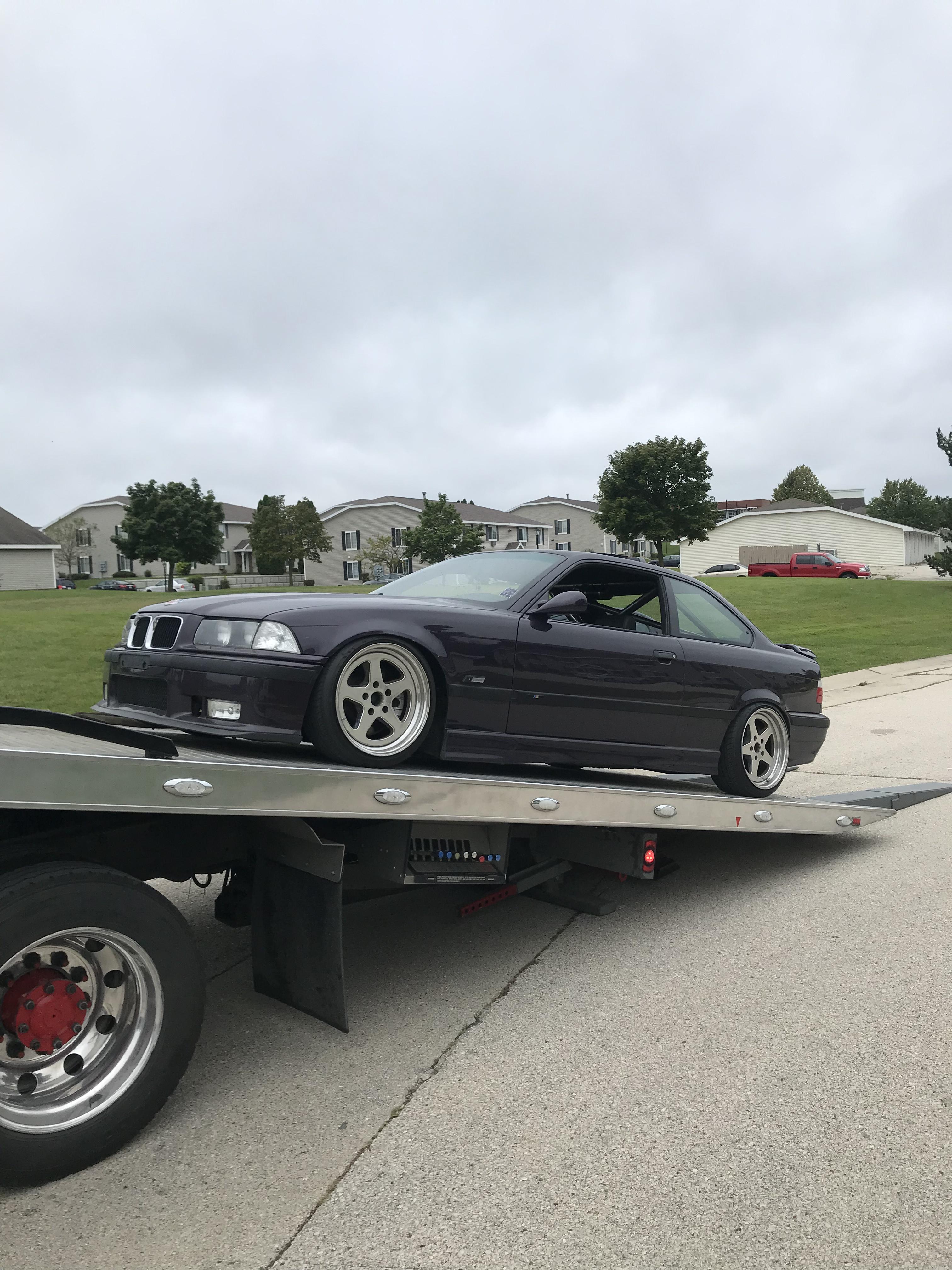

      BMW on a trailer, name a more iconic duo.
      I kid, but welcome to the club of those with clutch issues here this year.
      Might as well replace all the easy stuff in the trans while you’ve got it out.
      • PartiallypurpleP
        PartiallypurpleP
        Partiallypurple
        This ones only 50% bmw and I still have to have to have the tow truck on speed dial
          99% Sure it's that pivot pin.
          Am I the only one that finds it odd that the 50% BMW is causing issues and not the 50% Toyota?

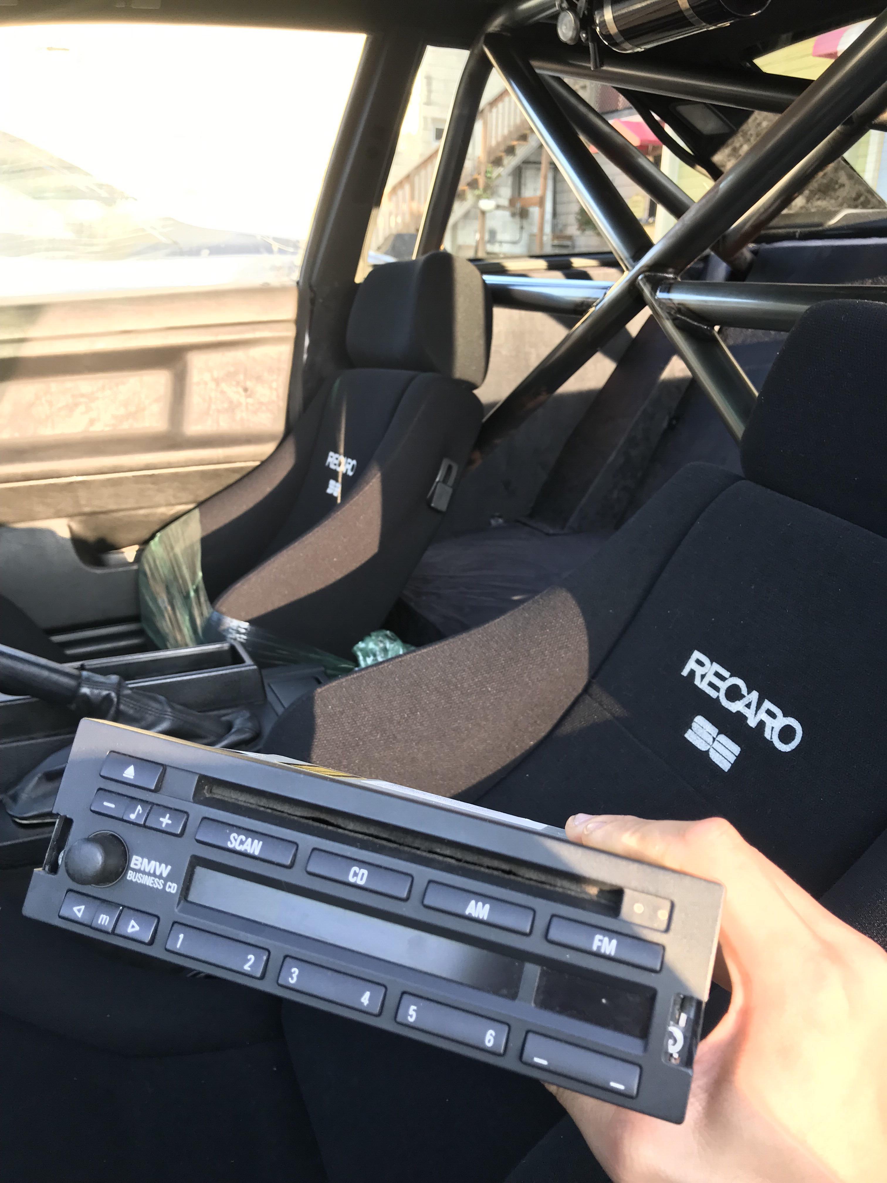

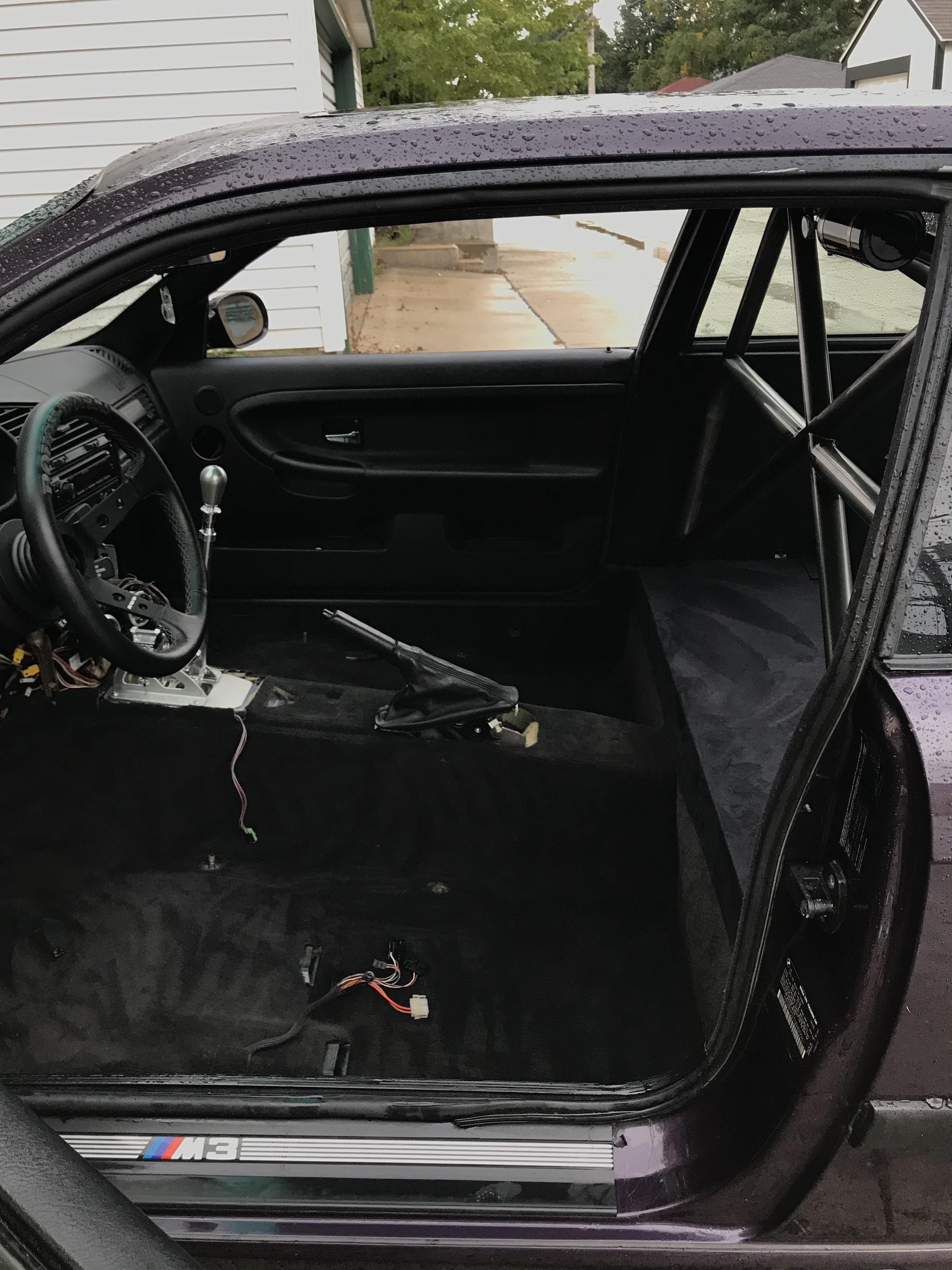

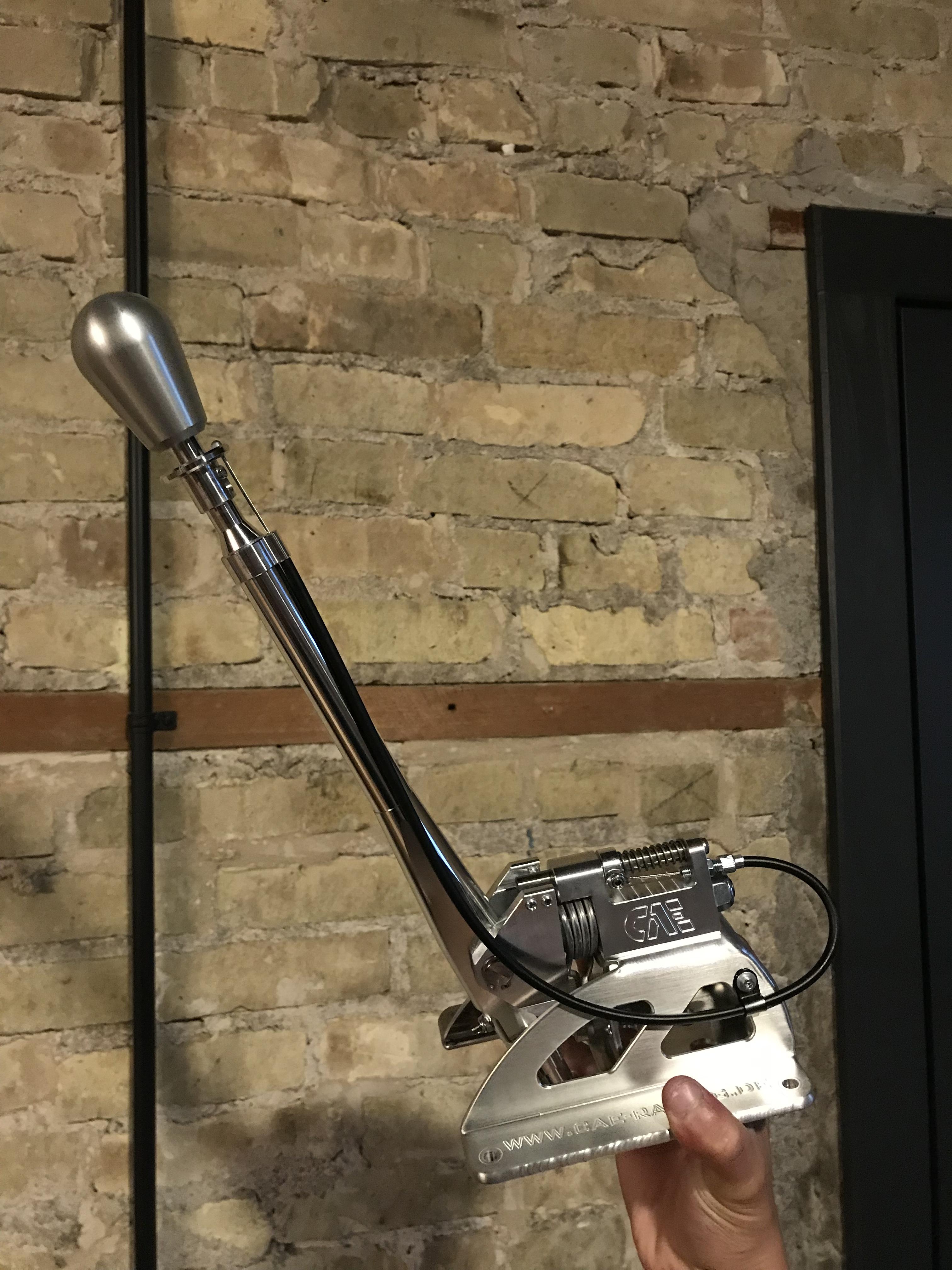

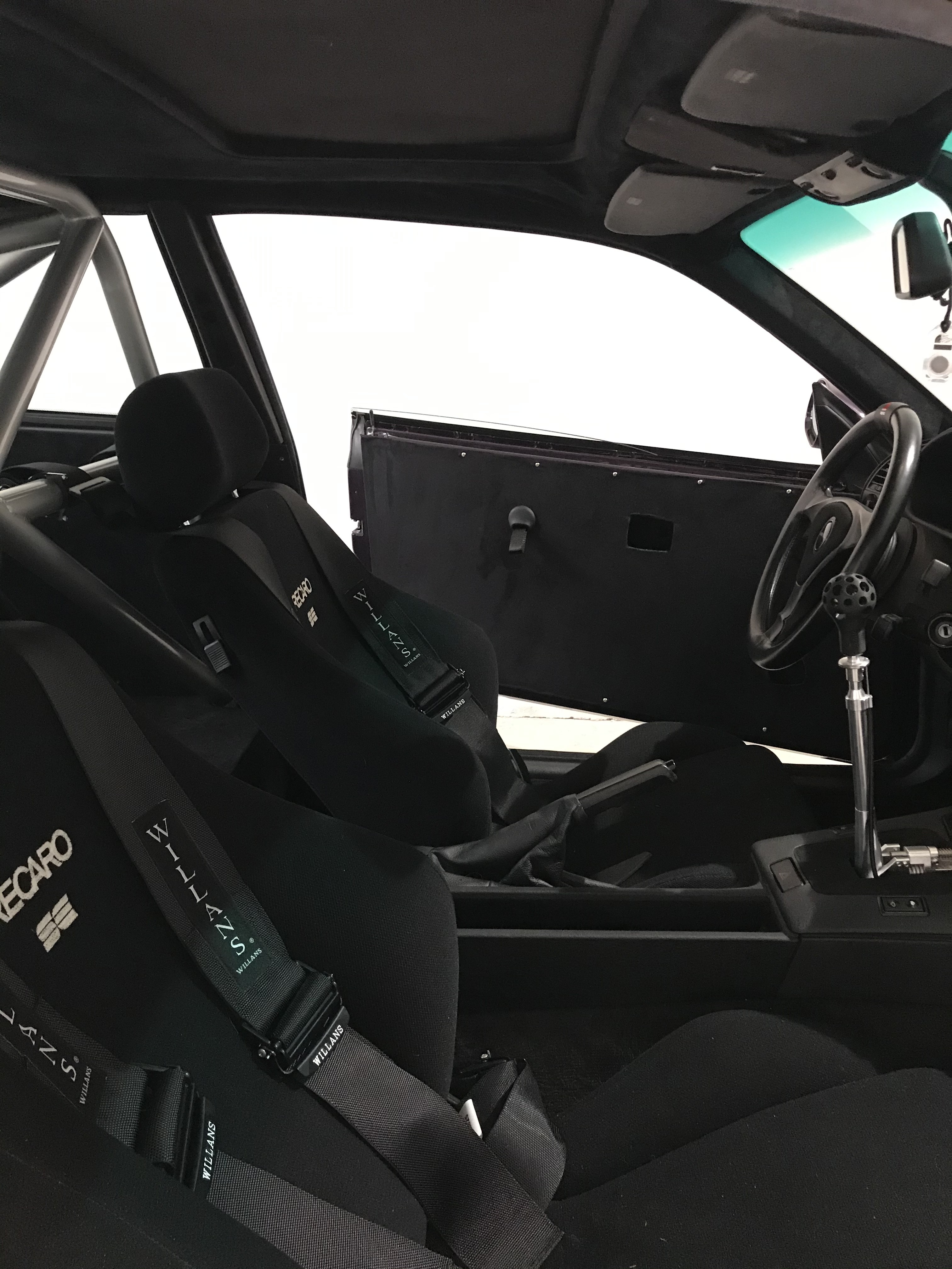

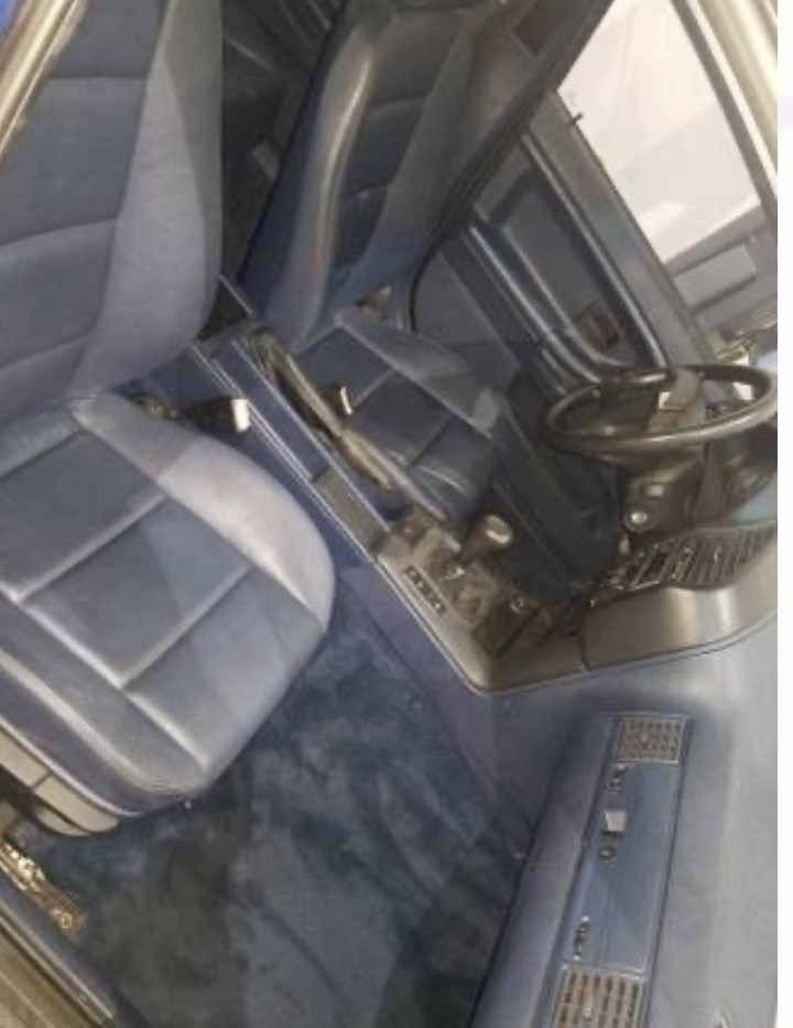

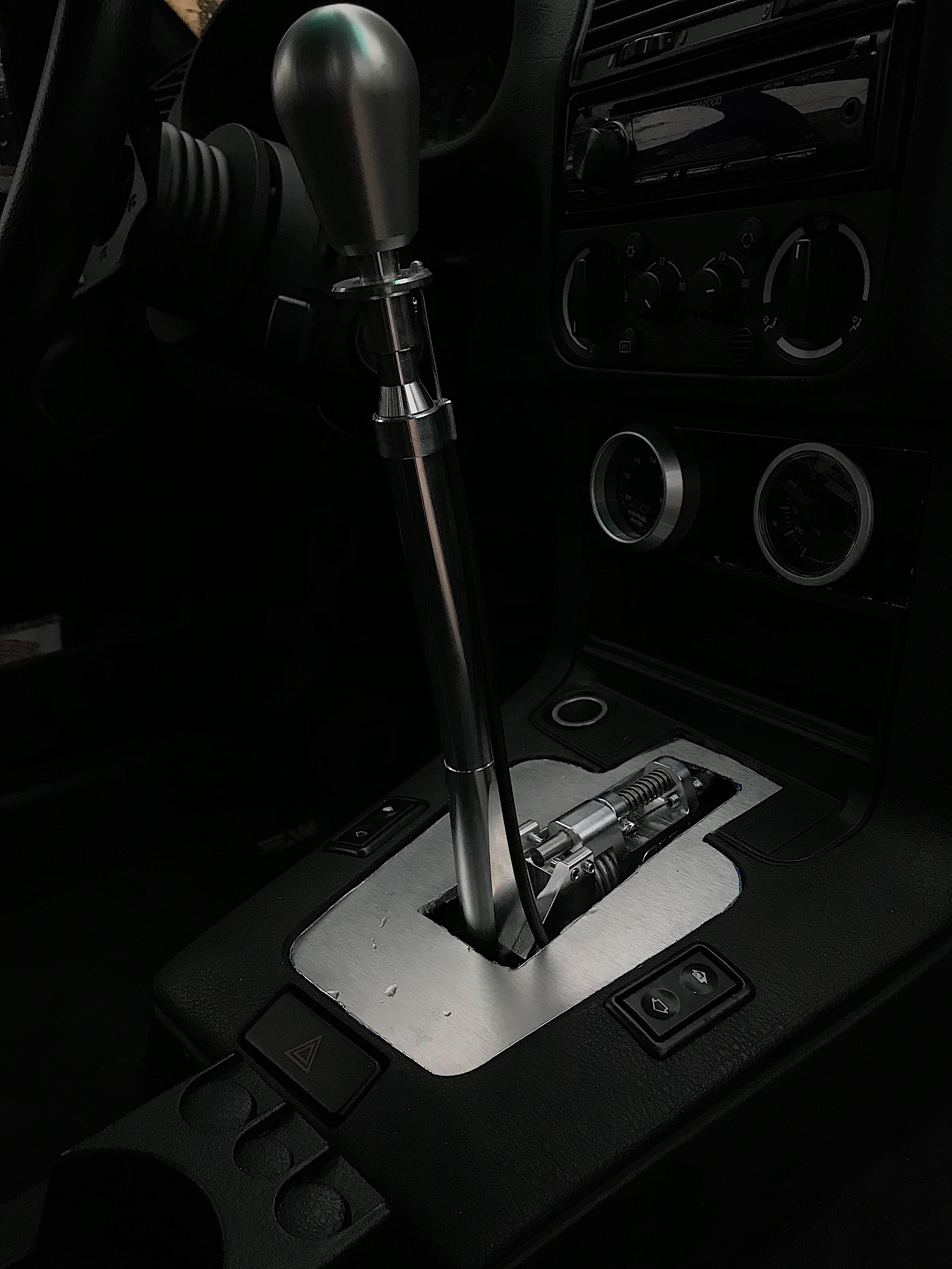

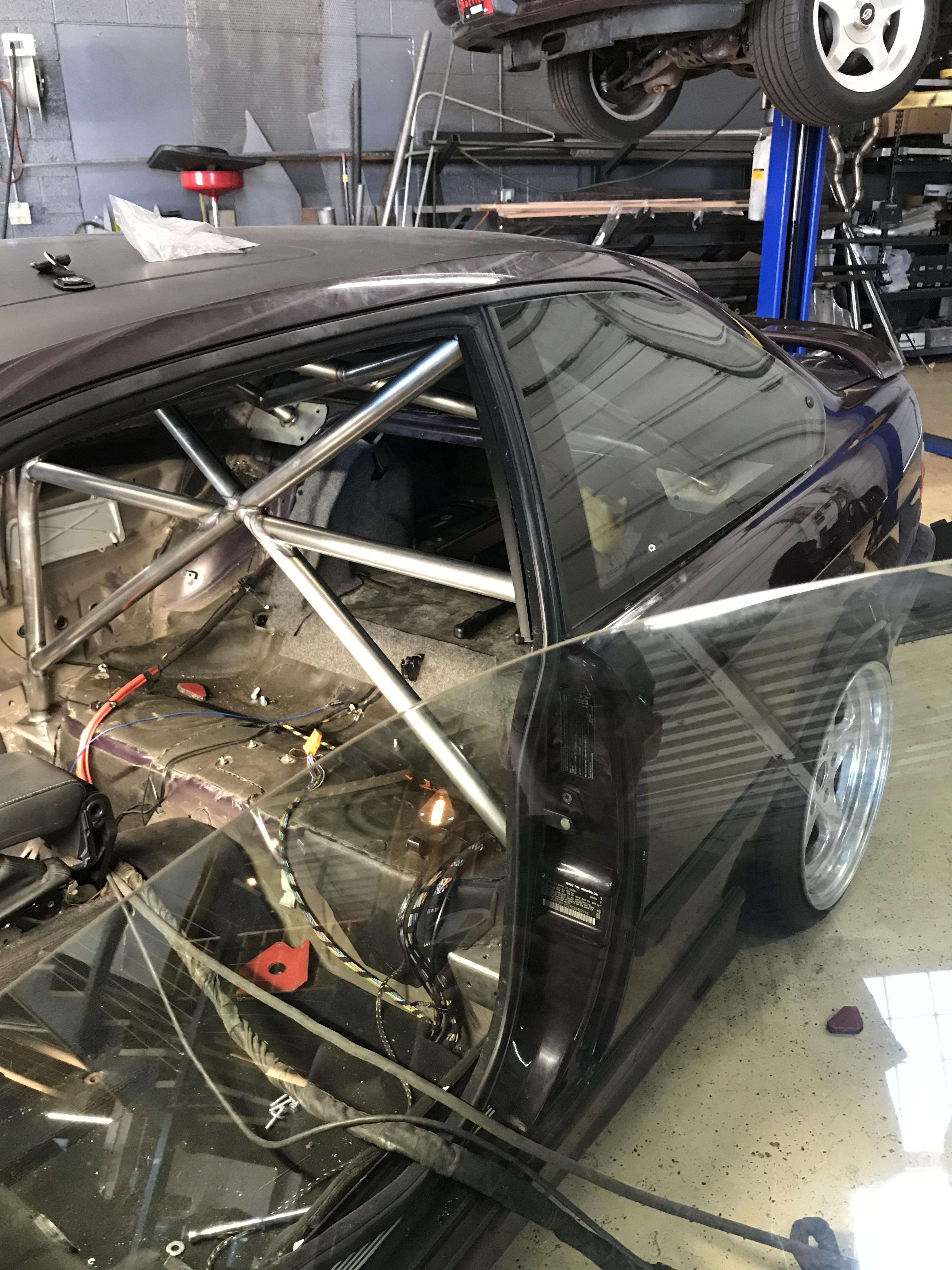

            Well this thing is beautiful.... Cannot wait to money shift and blow my motor. Jk, super excited. Quality is amazing, I’ve been wanting one of these for a very long time.

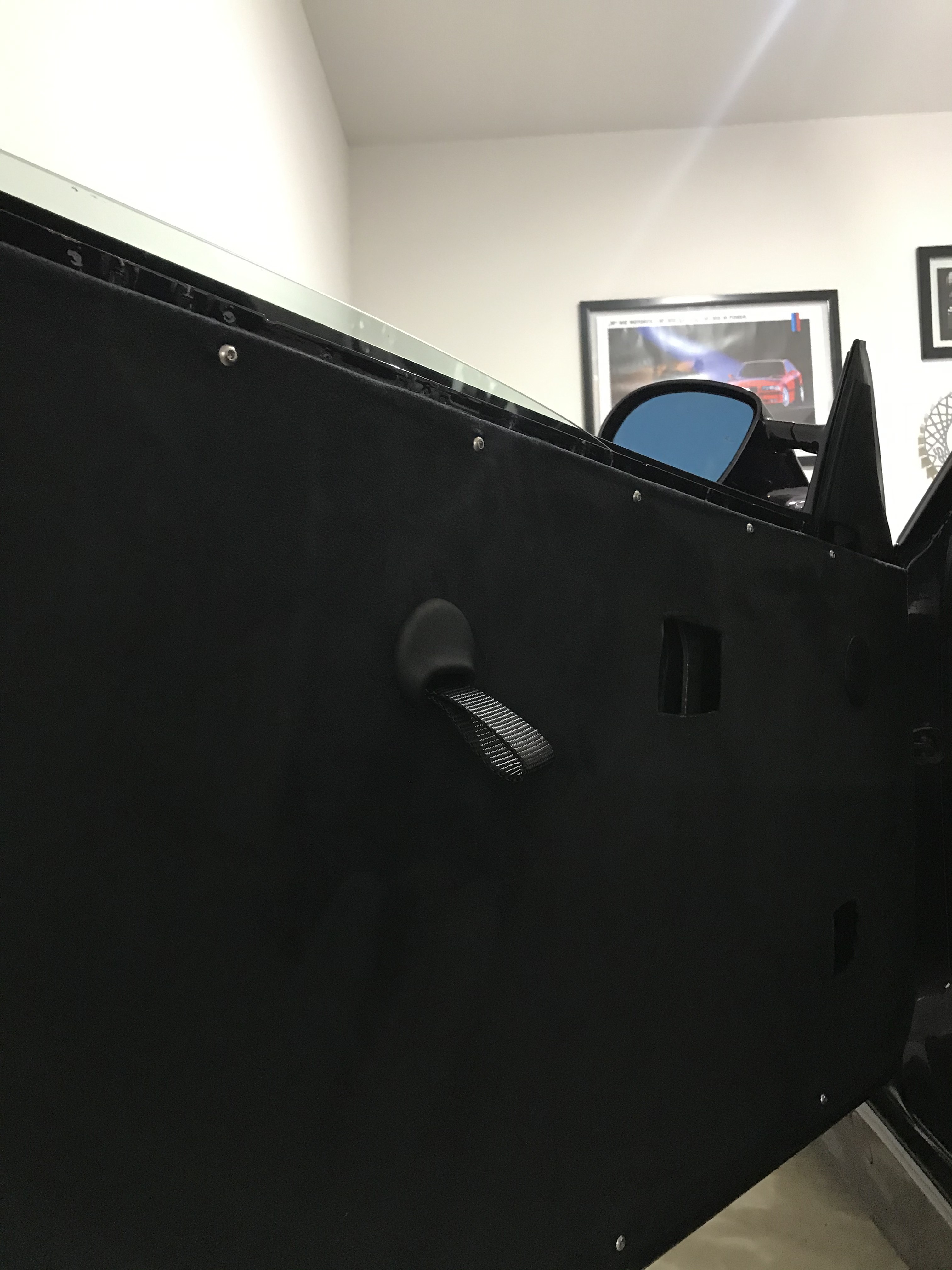

            I’m really trying to not cut any corners in this interior. The cockpit of the car is where you spend all of your time, and it’s very important that it’s done right. It’s all about the driving experience! I feel that so many people overlook the interior of a car and only focus on the exterior. I want to love driving my car as much as I love looking at it 😄

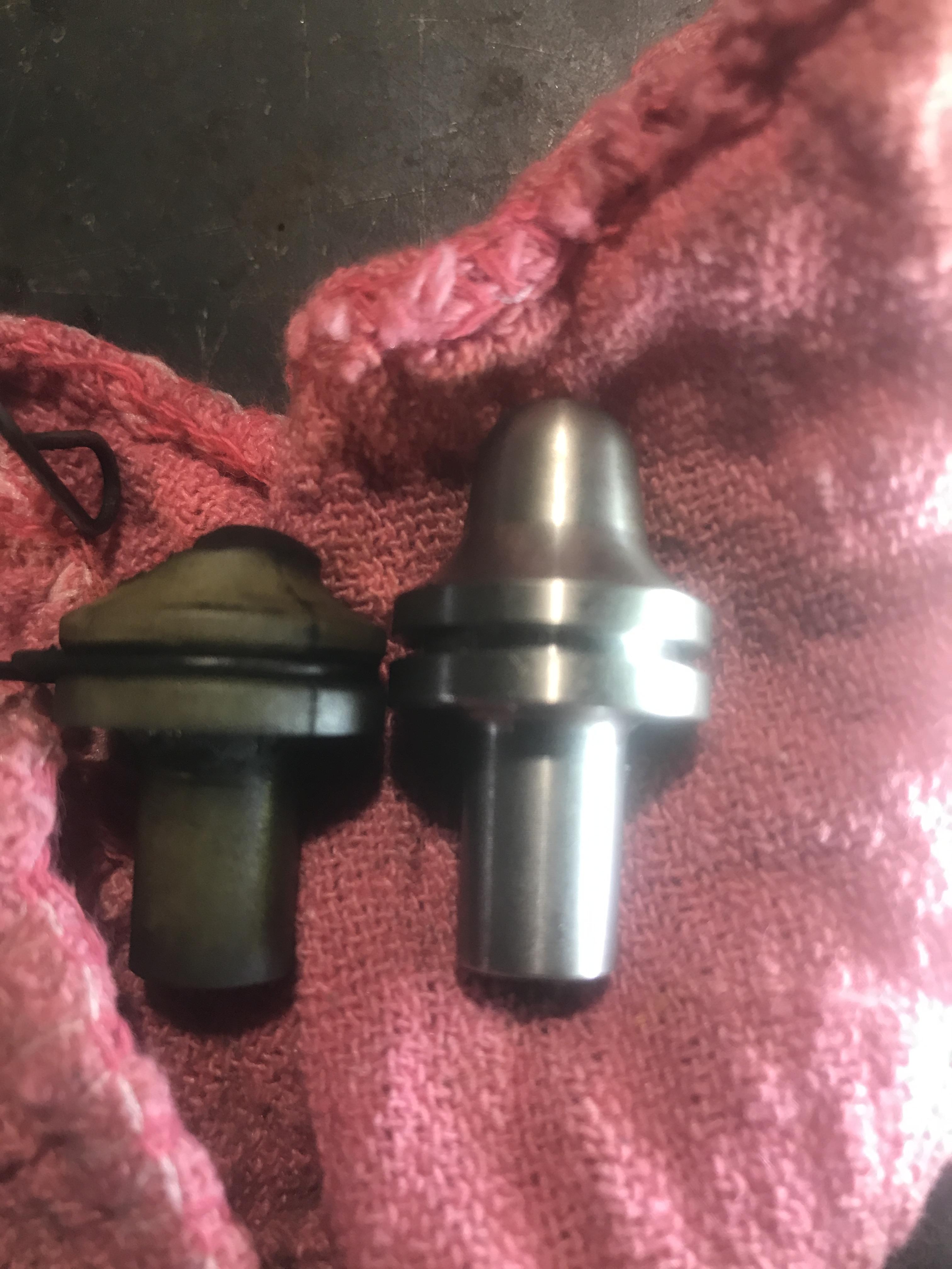

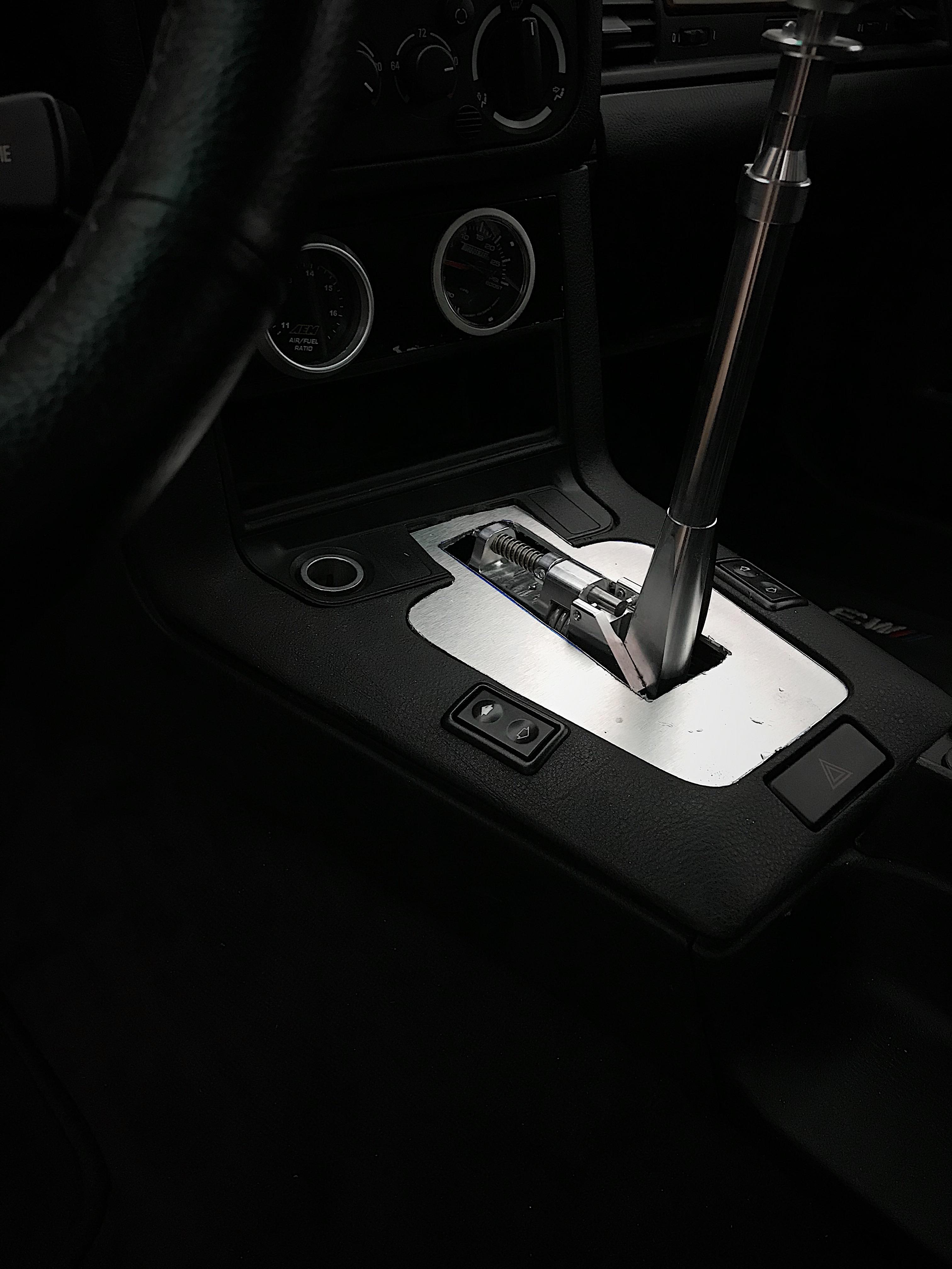

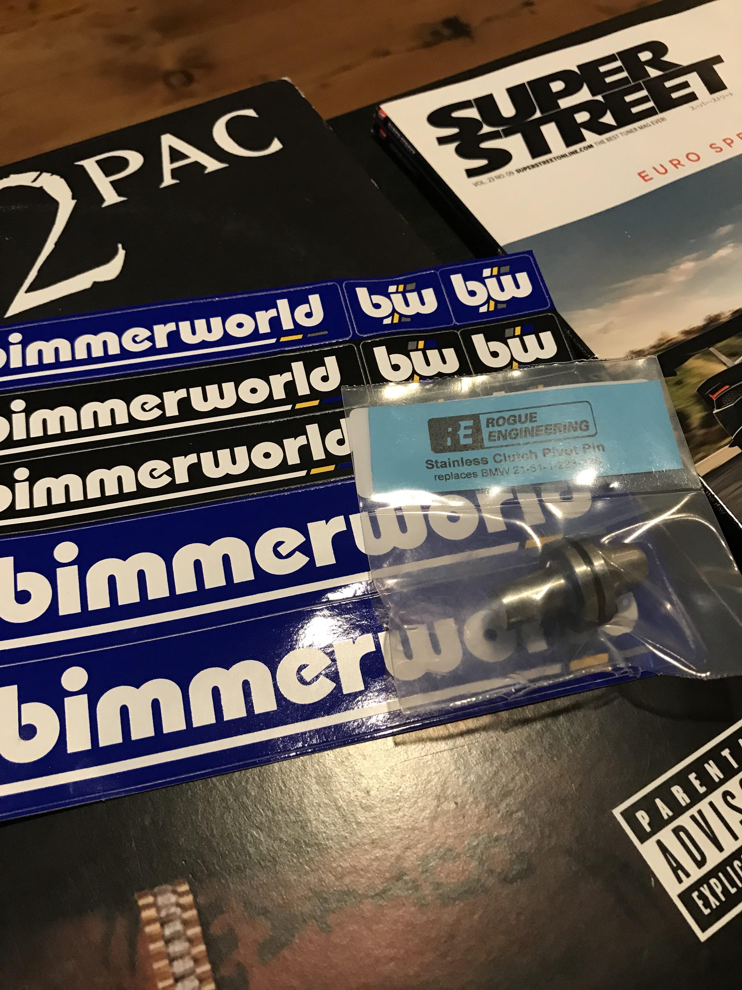

              Also I guess it’s important that the car moves too. Stainless pivot pin came as well today. Trans coming out Saturday and hopefully it will be ready to hit the road with the shifter installed and all my clutch issues fixed by Sunday night
                fuuuuuuuuuuu
                After feeling a self centering shifter, I need one.

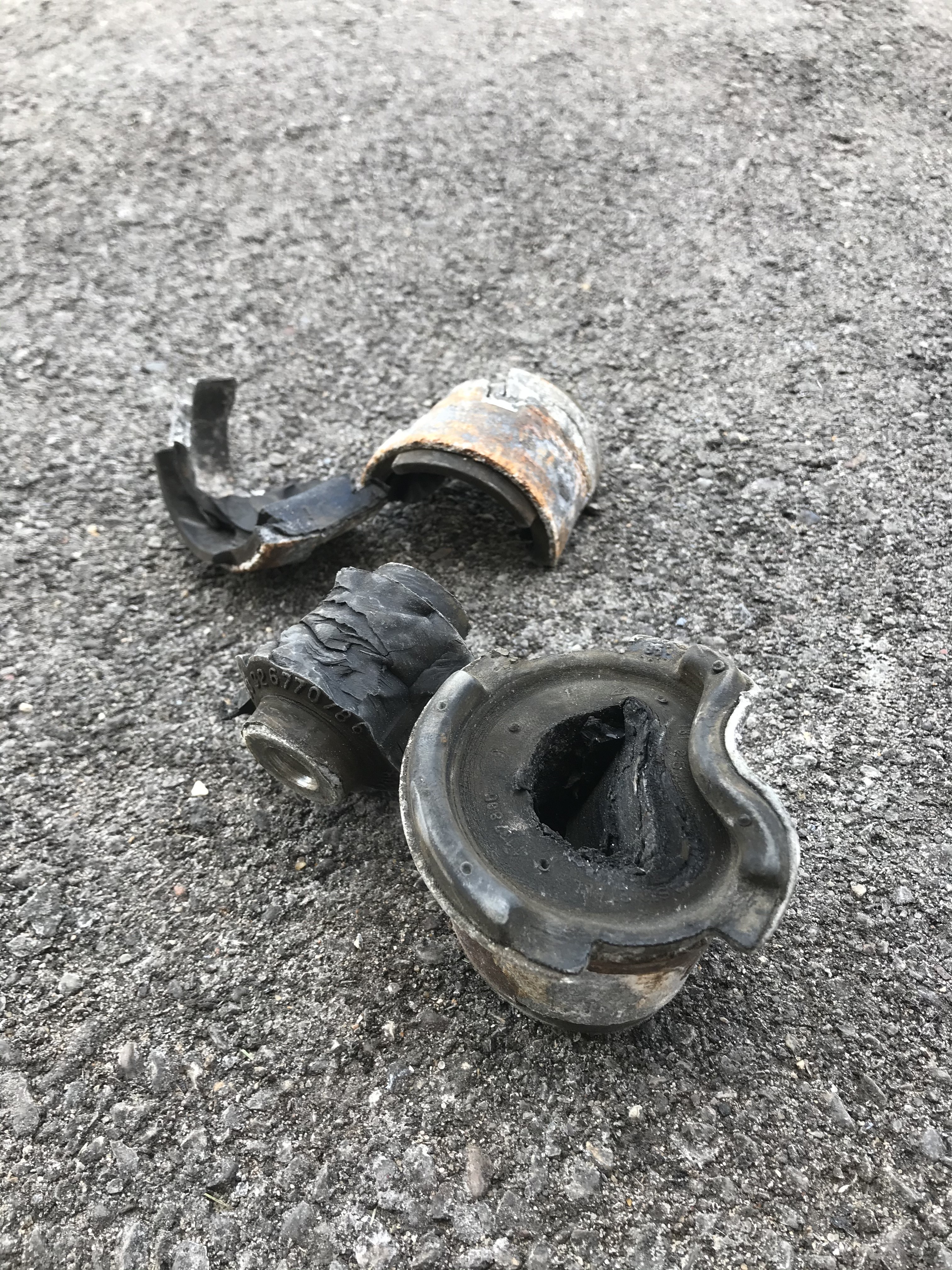

                  So went to remove trans yesterday. Had a hell of a time with the 1JZ starter. Was not fun to reach. Got it off and the problem was just what I expected. A worn pivot pin. After spending all day in the rain removing the trans and putting it back in I was nearing completion.. installing the slave ready to be done. Pressed the clutch and the slave blew it’s been piston and rod into the trans. Had to take it off and put it back on again. Hopefully today the slave will decide to line up properly
                    Welcome to the club lol I’d love to know what the reason for this happening is. Too much air in the line?
                      Nice job guessing the culprit
                        Are you back in business now?
                          #26
                          If the slave cylinder is installed right it can't just randomly blow the pin out.  The pin only comes out if you press the clutch pedal without the slave installed to the transmission.
                            #27
                            did you use a new clip?
                            make sure the fork was aligned properly? and make sure it wasnt worn through?
                            insert the clutch slave into the bellhousing at a straight angle? (that's what she said)
                            use the correct TOB?
                              #28
                              Type Of Buttocks?

                                  #30
                                  New clip, didn’t make sure the fork was aligned properly to be honest. Kind of stupid of myself. Didn’t have any problems with the last slave on my other e36 so I figure it was as easy as screwing on and making sure it’s tight. Going to make sure everything is perfect before I even look at that clutch pedal this time
                                    #31
                                    you can also test fit the slave before installing the transmission
                                      #32
                                      Correct me if I'm wrong, and I could be given this is a 1J, but when the fork is lined up correctly, the slave should sit off the bell housing a little as the dowel is pressing into the arm.
                                        #33
                                        Correct, it takes some pushing to get the slave to sit flush on the back of the trans

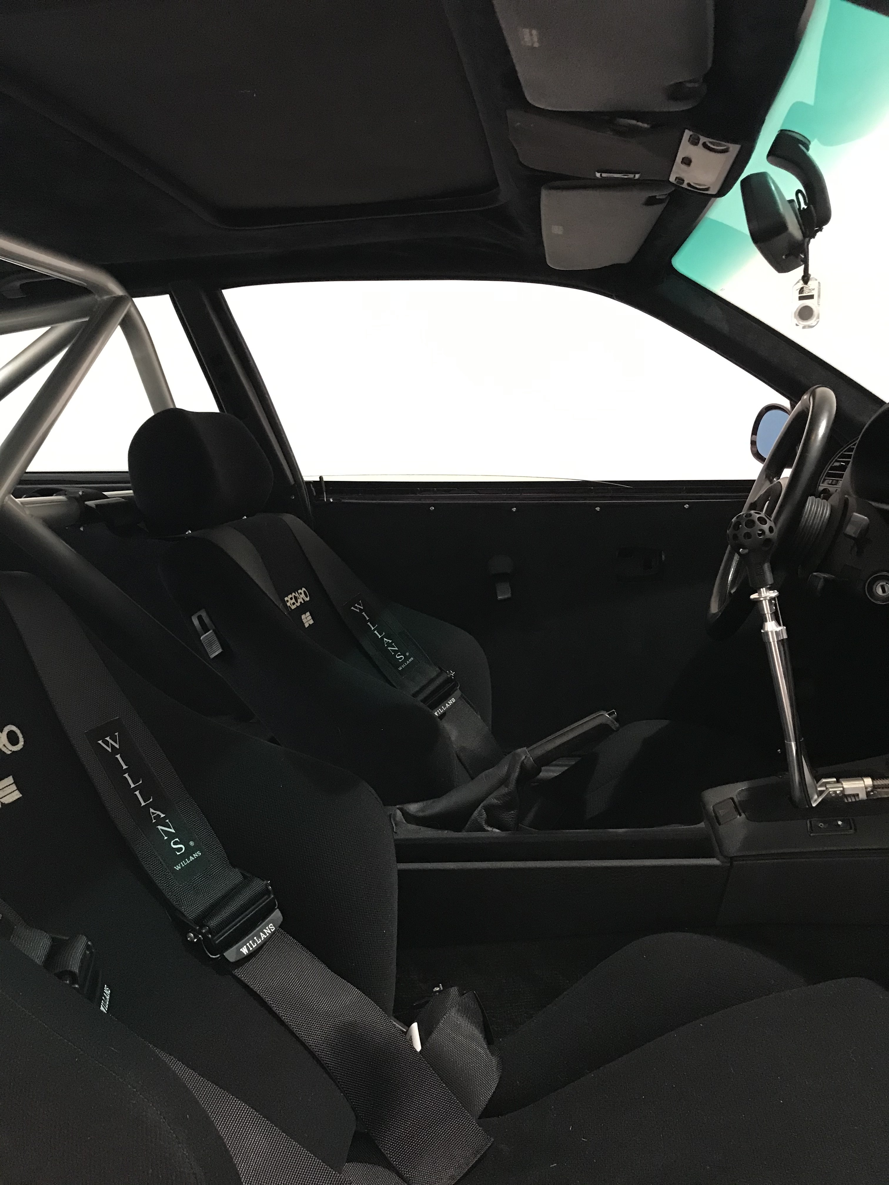

                                          #34

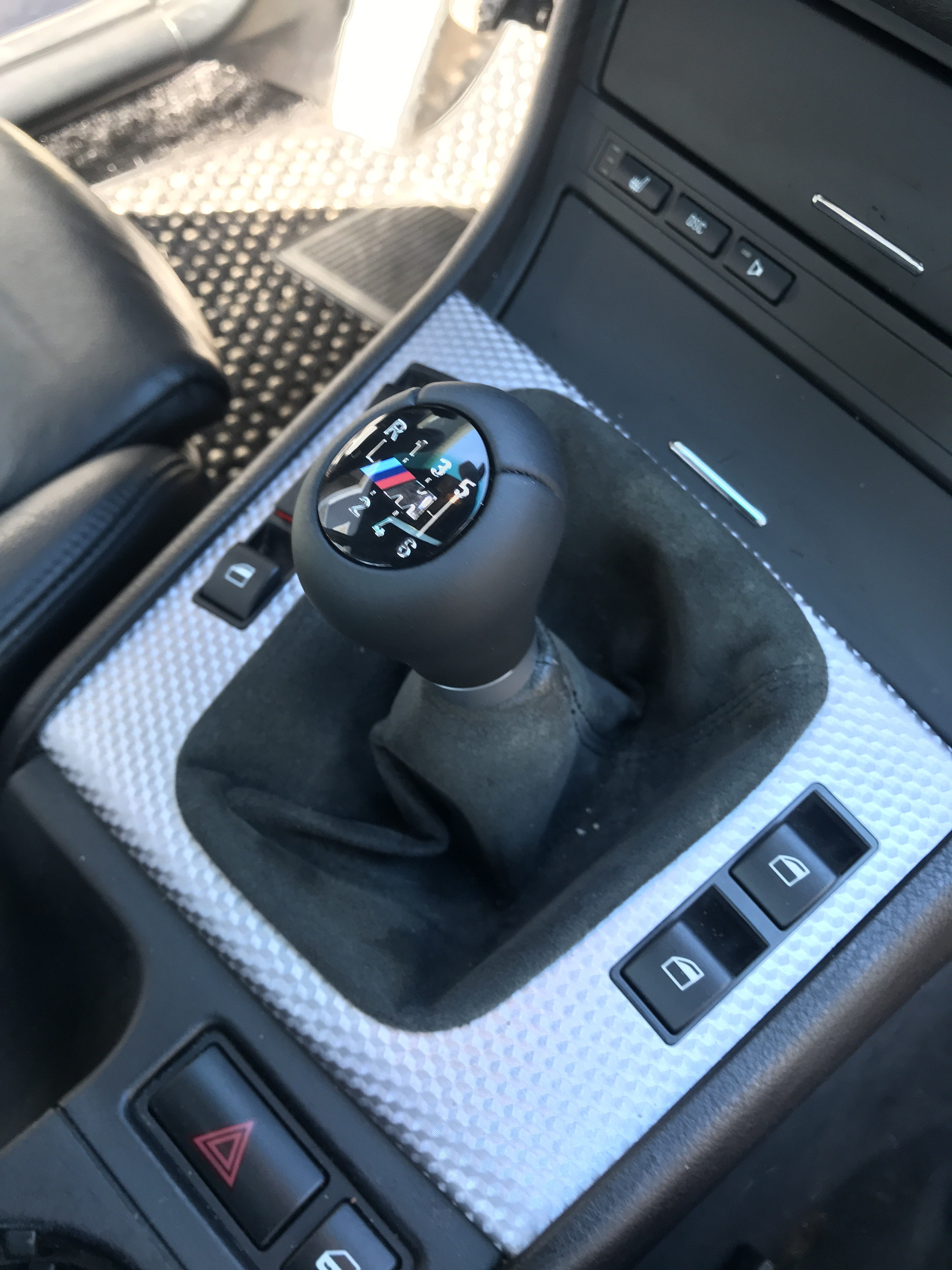

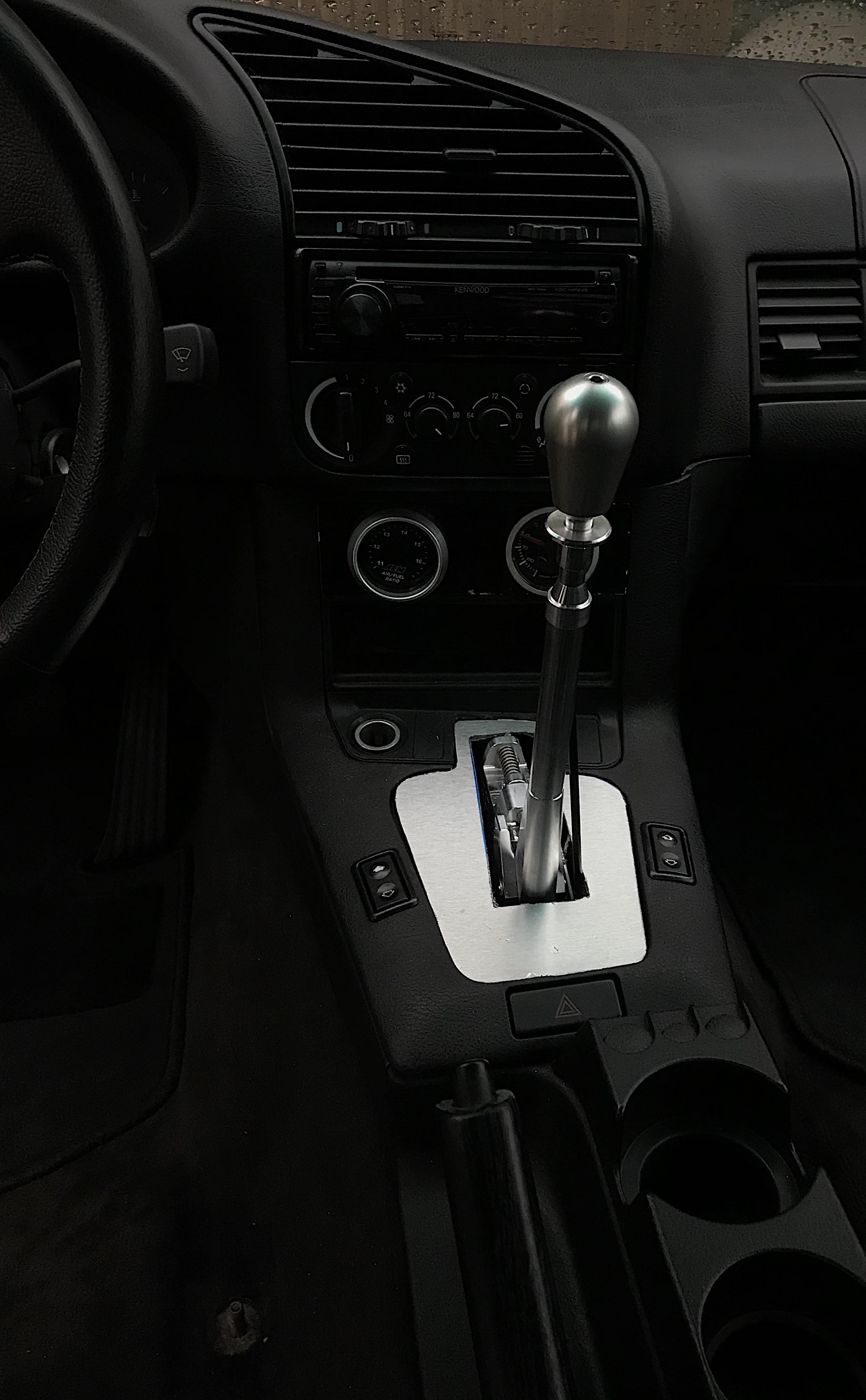

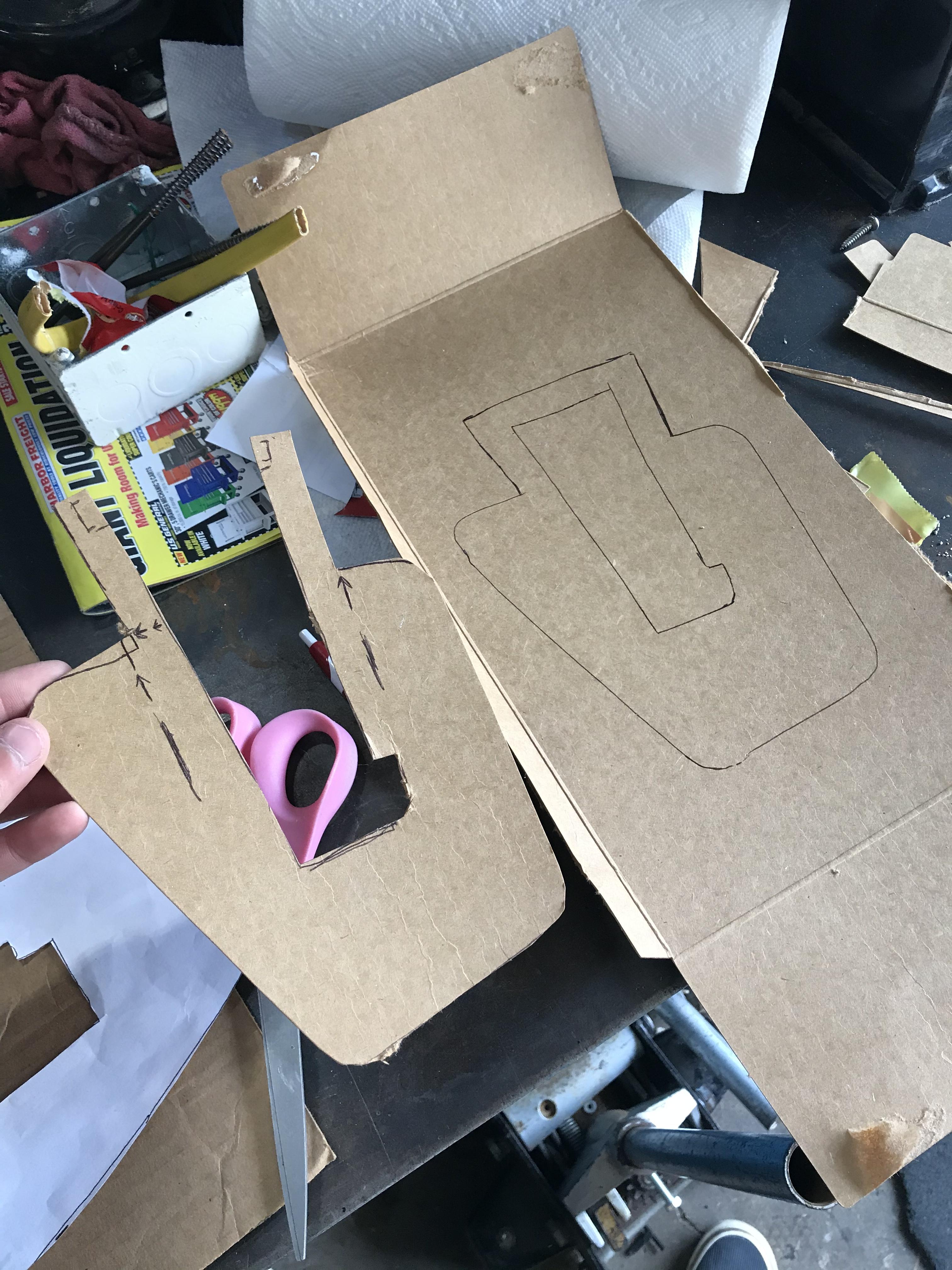

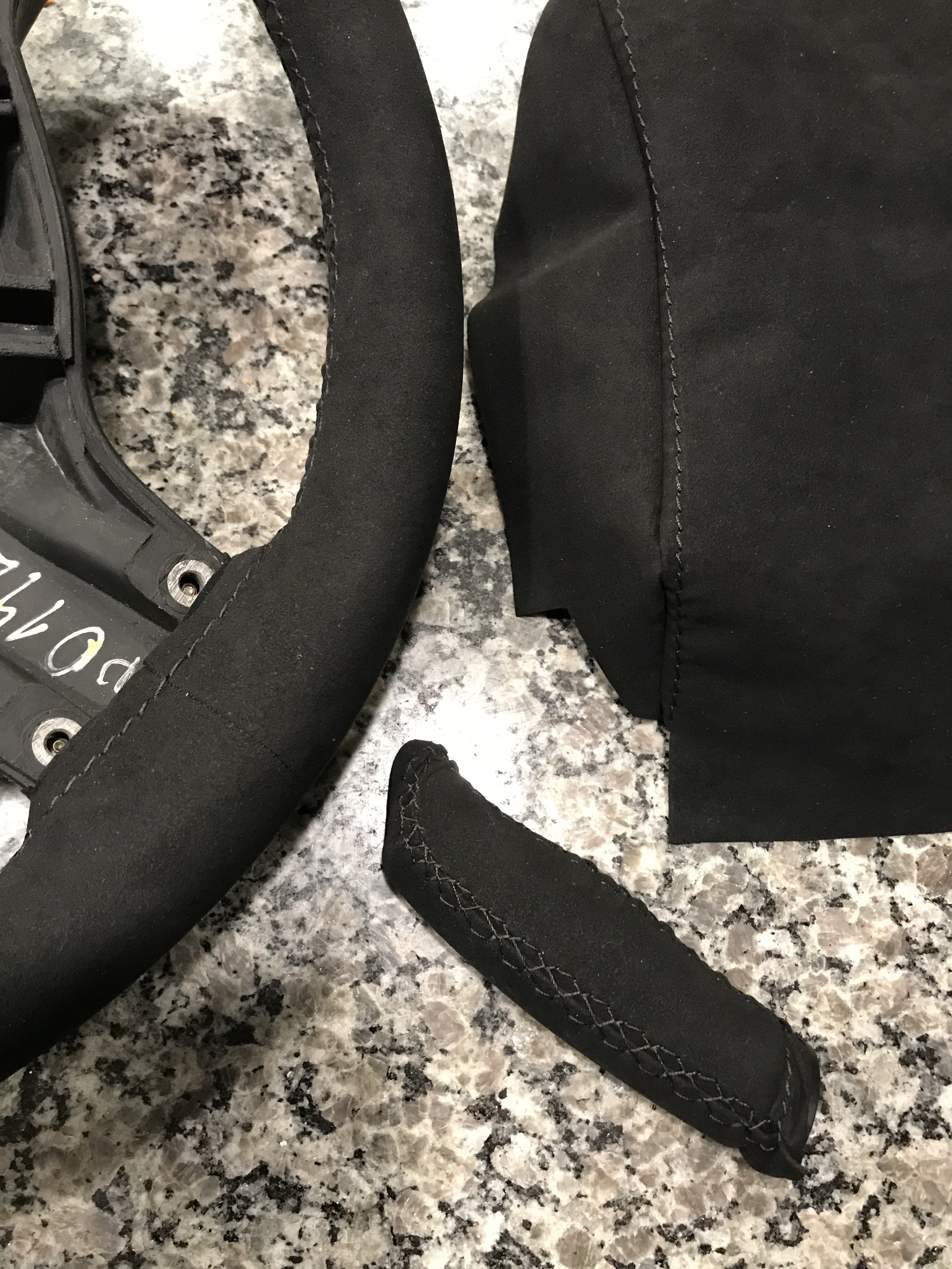

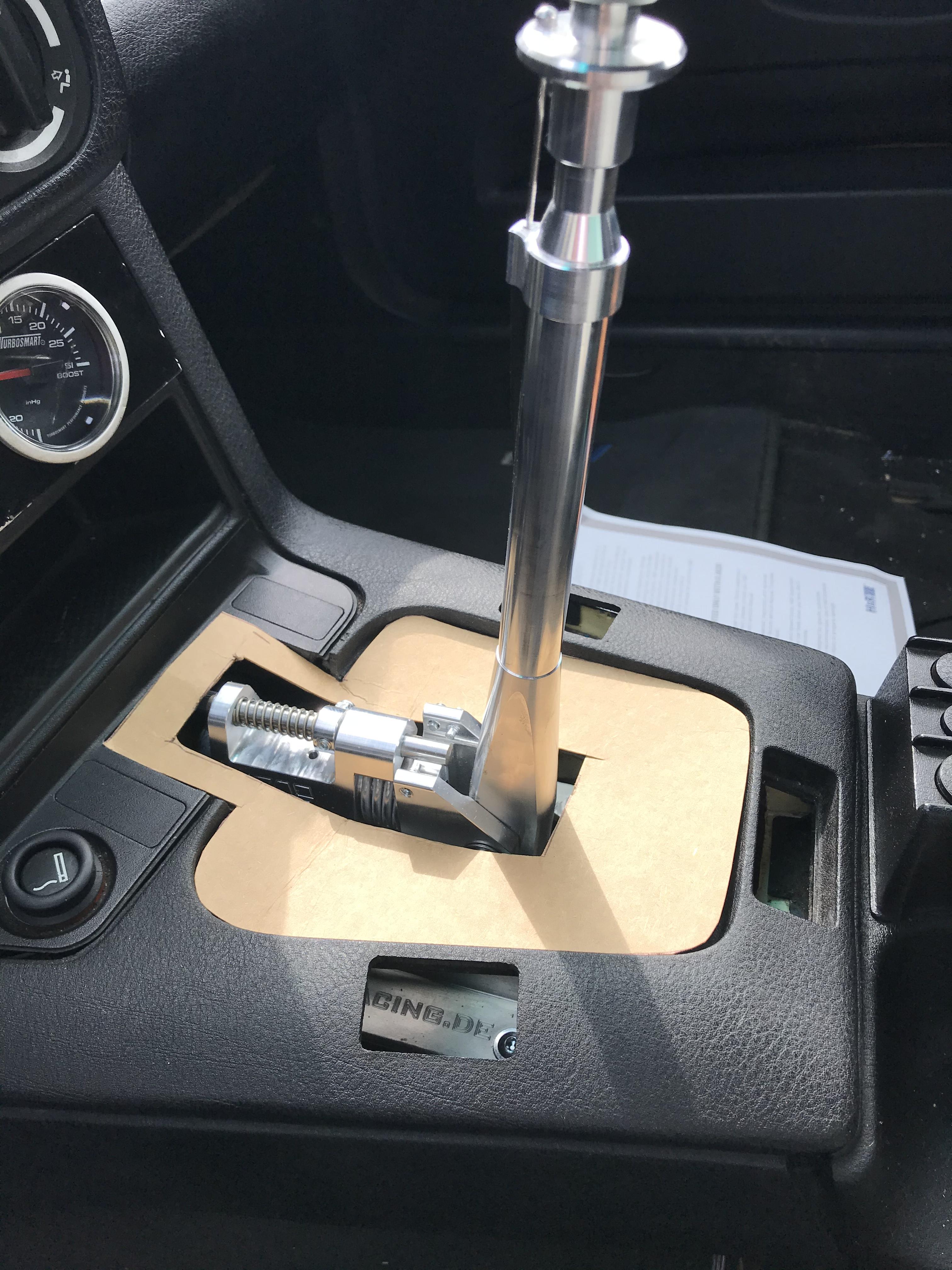

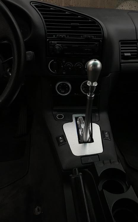

                                          Well a whole new clutch setup later and throwout bearing and we are finally back up and running! Spent the day deep cleaning all the interior panels, deciding what was good enough to keep and what had to go! Also made a shift boot/cage for the CAE. Going to wrap it in alcanatara suede but the brushed aluminum isn’t bad till I park the car for winter soon.
