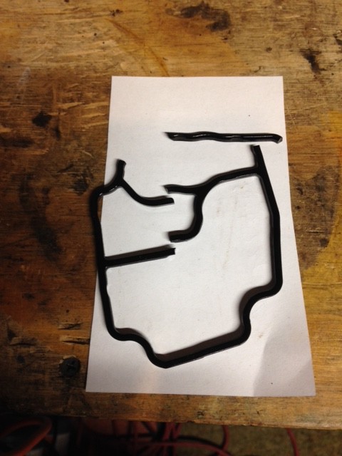

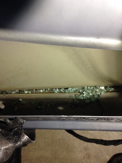

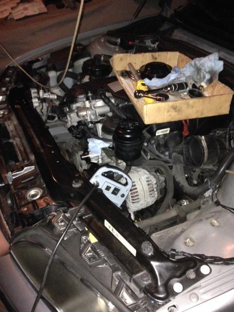

                          Figured out my oil leak

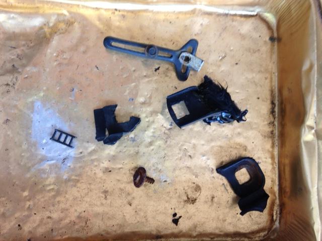

                          Replaced the passenger front window regulator and found leftovers from someone's earlier work in the bottom of the door
                            #46
                            appears to be some sort of healing/energy crystals. I’d keep em.
                            Anecdotal evidence makes me feel like BMWs are more prone to oil leaks than a lot of cars. At least they are usually worth repairing oil leaks on

                              Oil leaks corollary: no matter how much you clean up remnants from the old leak and removing the ofh old oil will be caught up in the metal undertray and will drip on floor the day after car is off jack stands making you think new gasket is leaking...when it isn't.

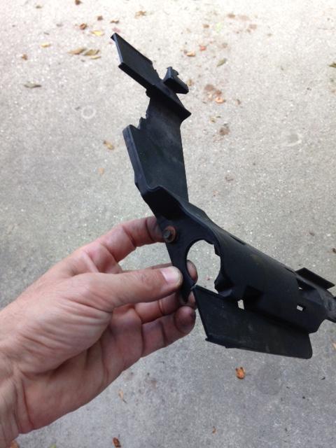

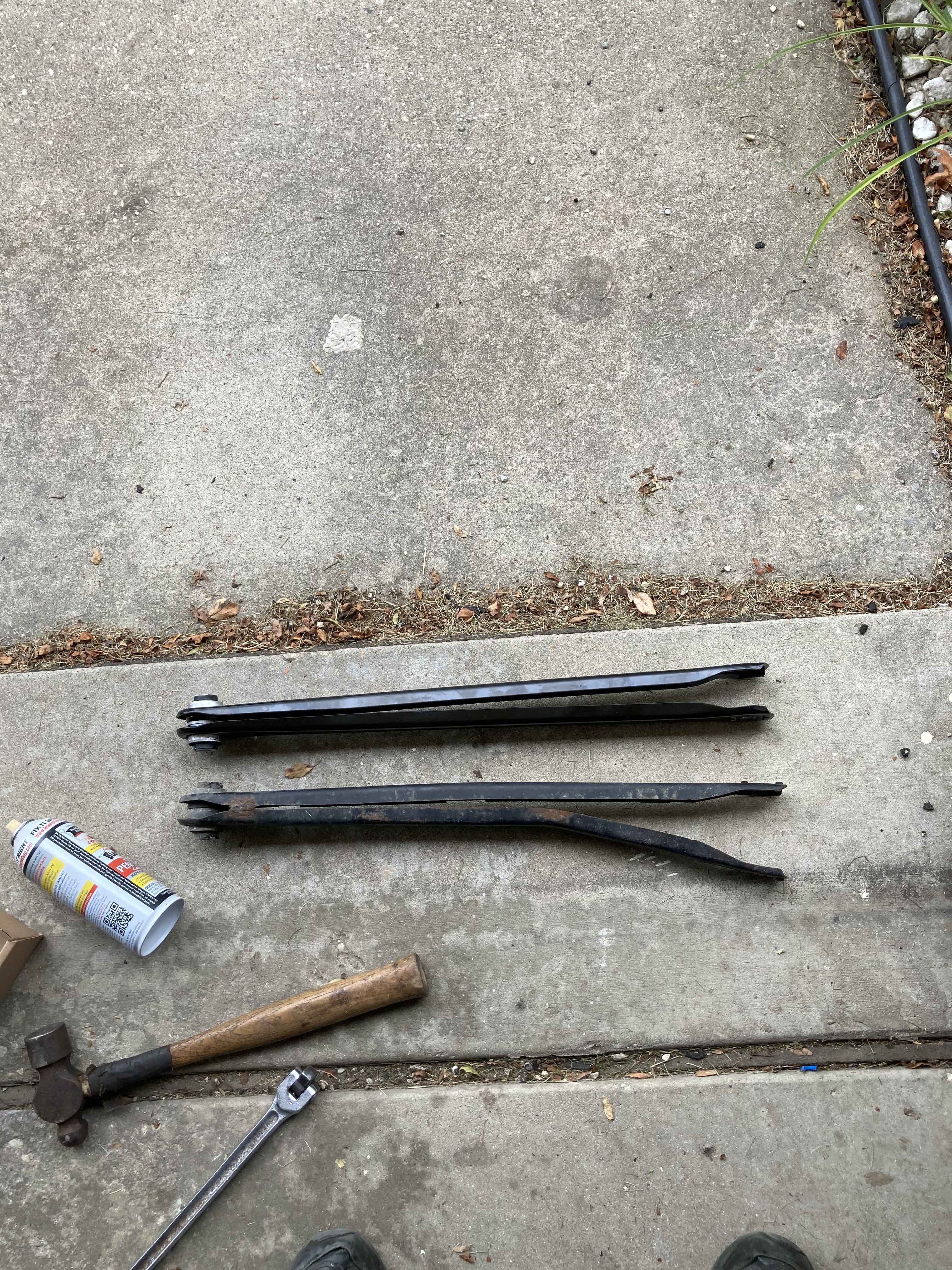

                                        Able to get back to wrenching on the ZHP this weekend. We found a little surprise at the alignment last fall. Drivers side lower trailing arm was a wee bit bent. New versus old in the picture.
                                        Replaced both sides. Access to the inner bolt on drivers side is certainly a pain. Joys of unbolting and shifting the diff to get to it. Passenger side is easy.

                                          Boris3 said:
                                          wee bit bent
                                          Nothing a little hammer couldn't fix.
