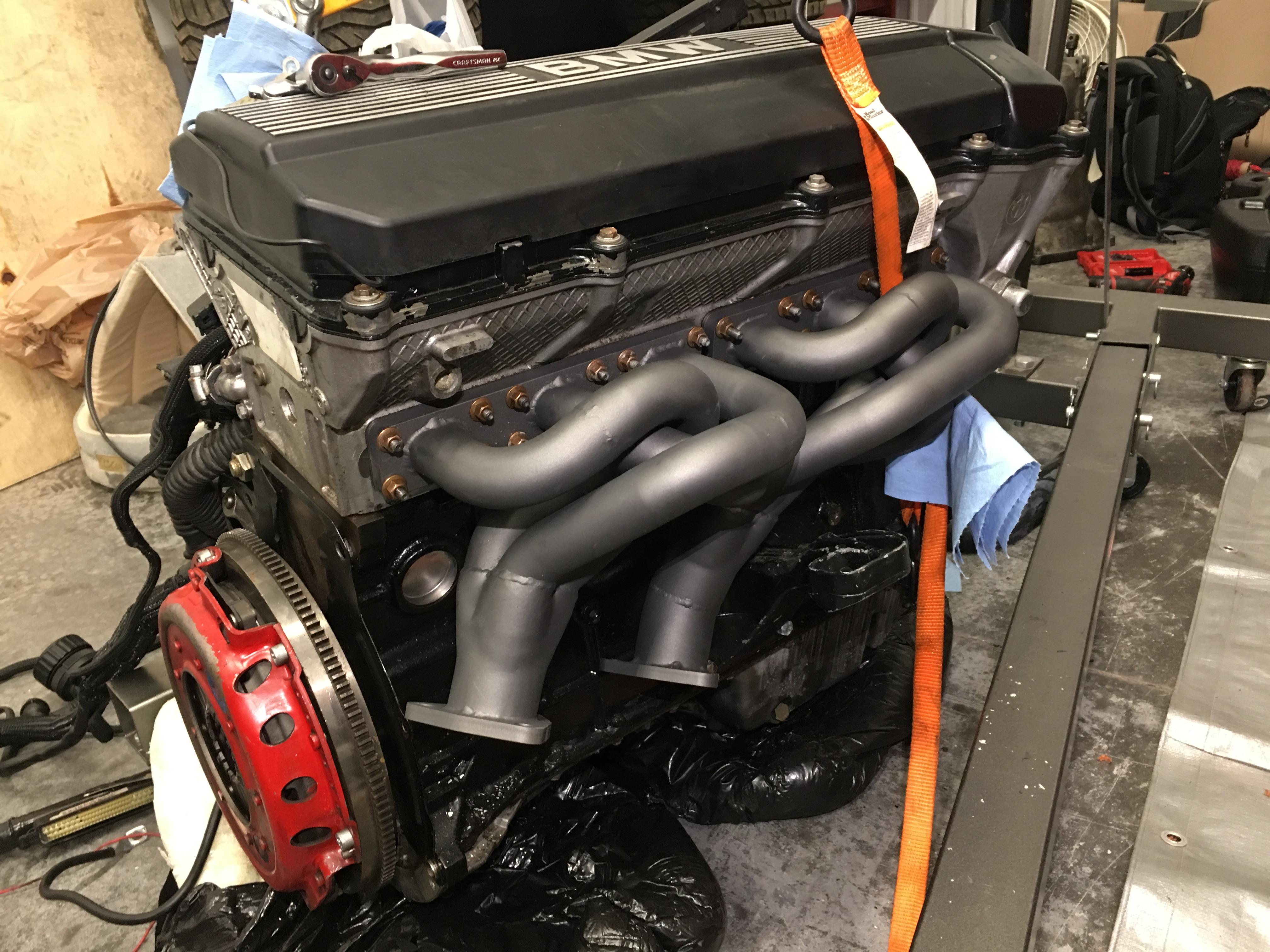

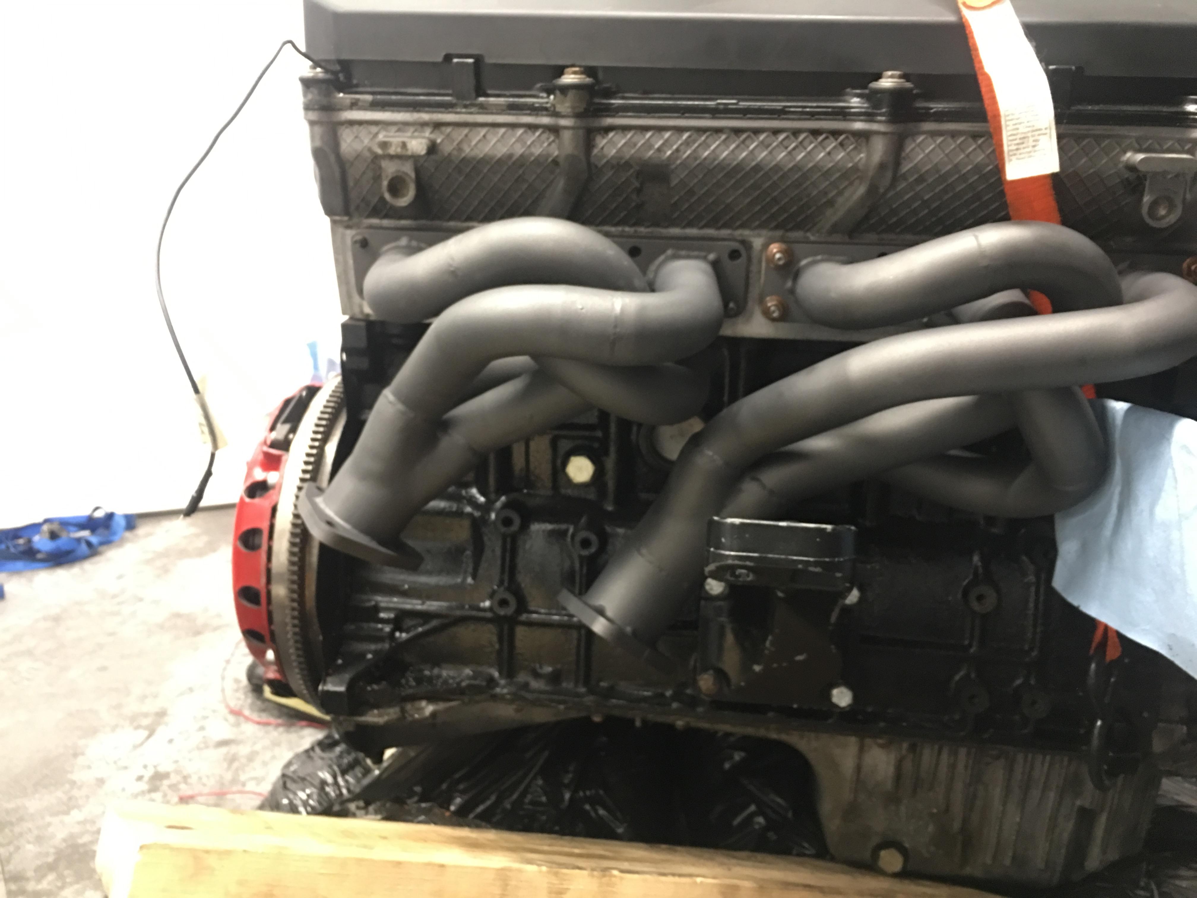

                          Headers are on
                          By far the easiest set of aftermarket headers I’ve ever installed on these motors. Room to get to every nut/stud from the top side

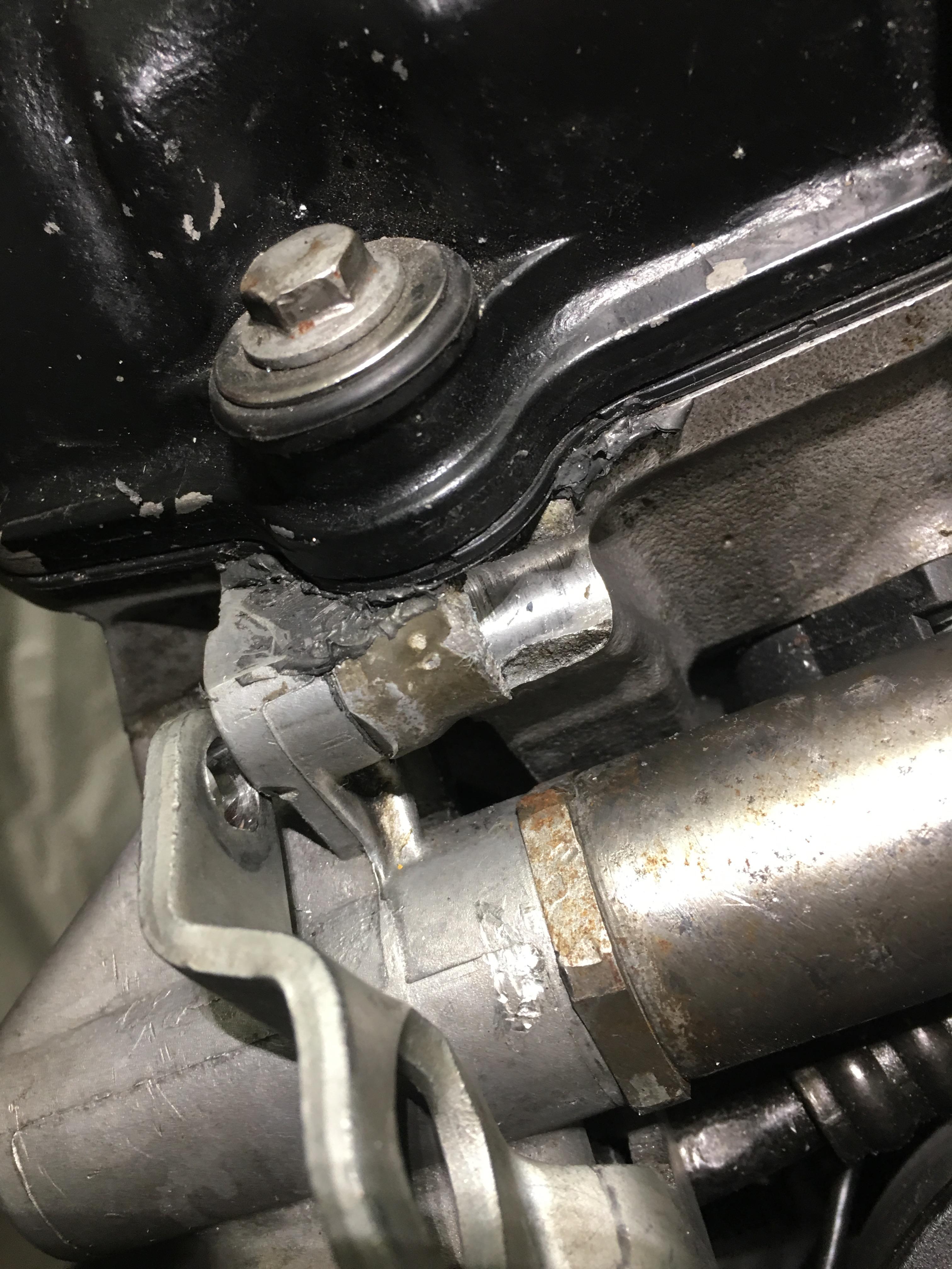

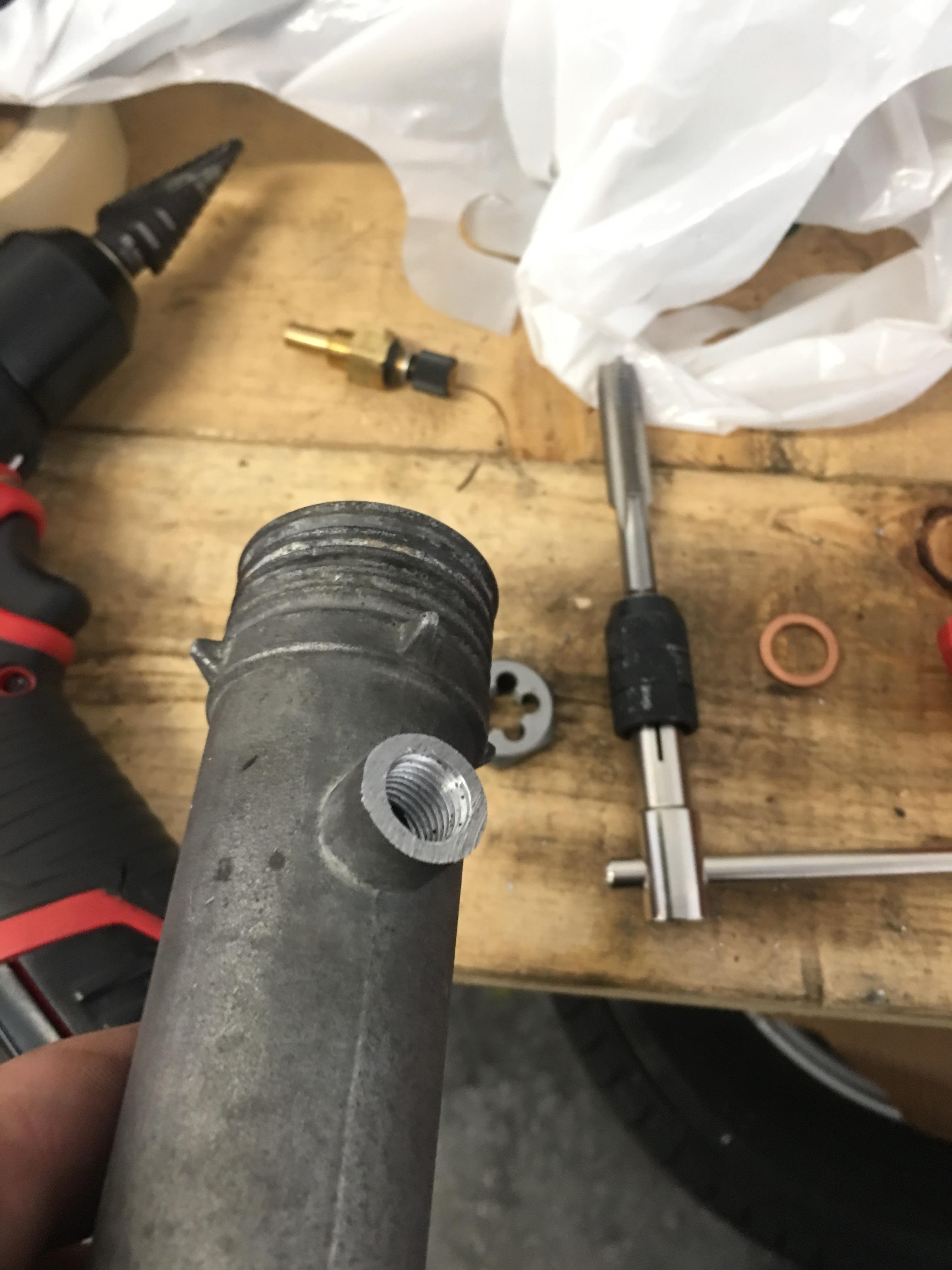

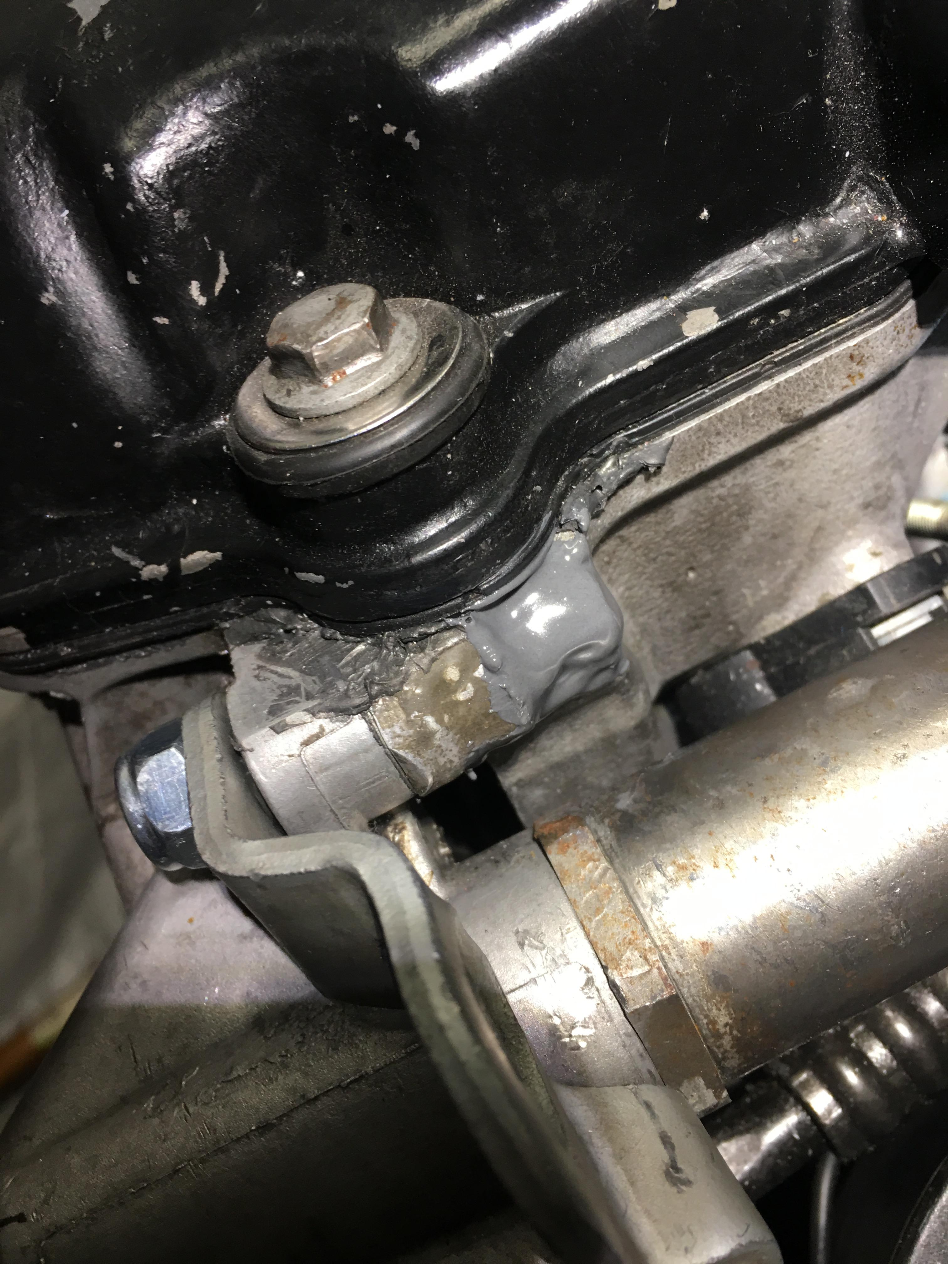

                            Also needed to fix the lift point. The top most bolt hole for the lift bracket was all blown apart. I wanted to just re tap the remaining area, but I Was not able to get a tap through whatever material that threaded portion was. Could barely drill it out to the right size.
                            Decided to buy a stud and just jb weld the cock sucker in because it only needs to work one more time anyways. Had to re tap that lower lifting bracket bolt hole as well because the threads were junk.

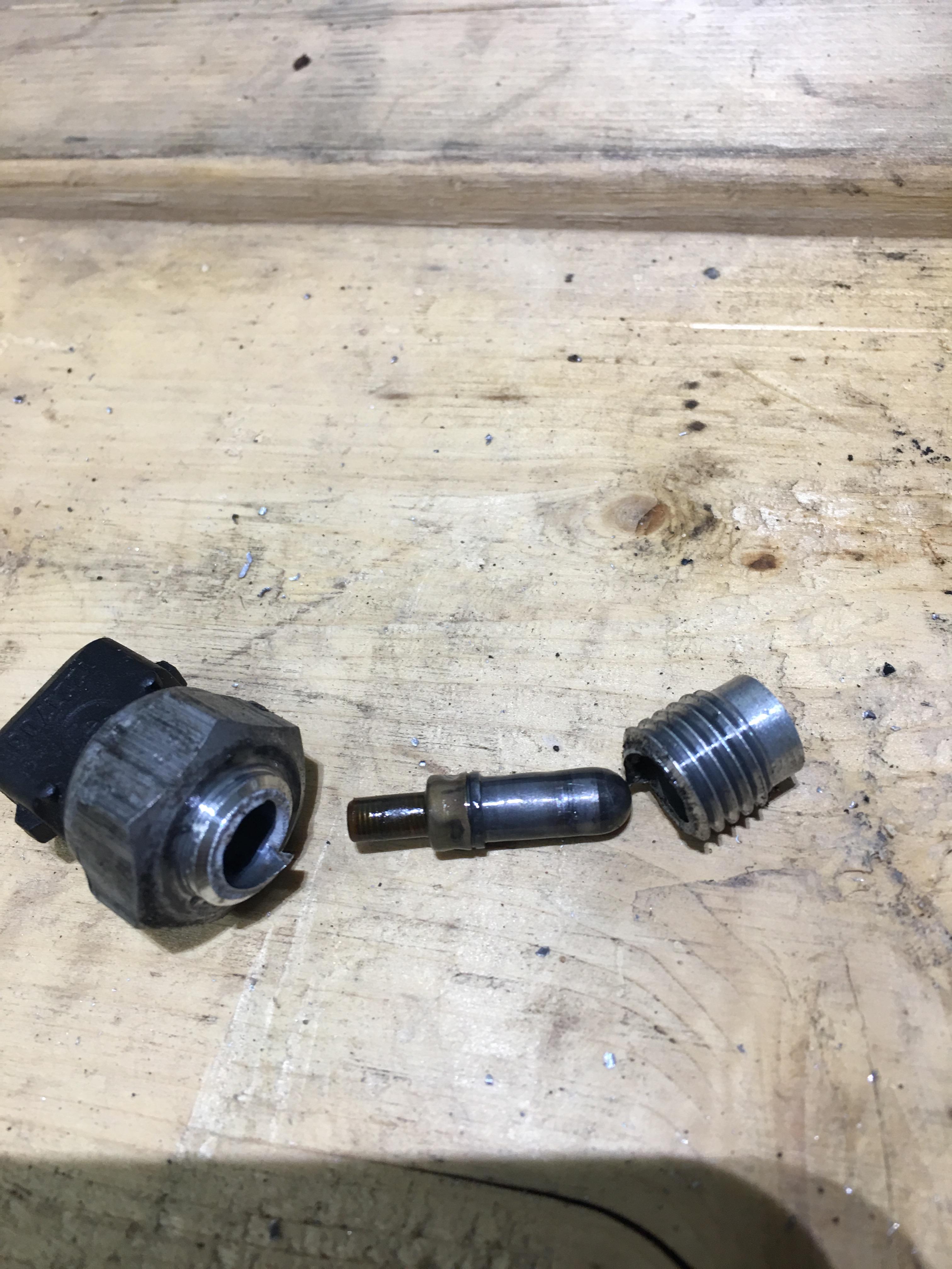

                            Also got a rethreaded brown temp sensor so the dash temp gauge will work. Had to chase those threads as well. I’m getting very familiar with my tap set lately.

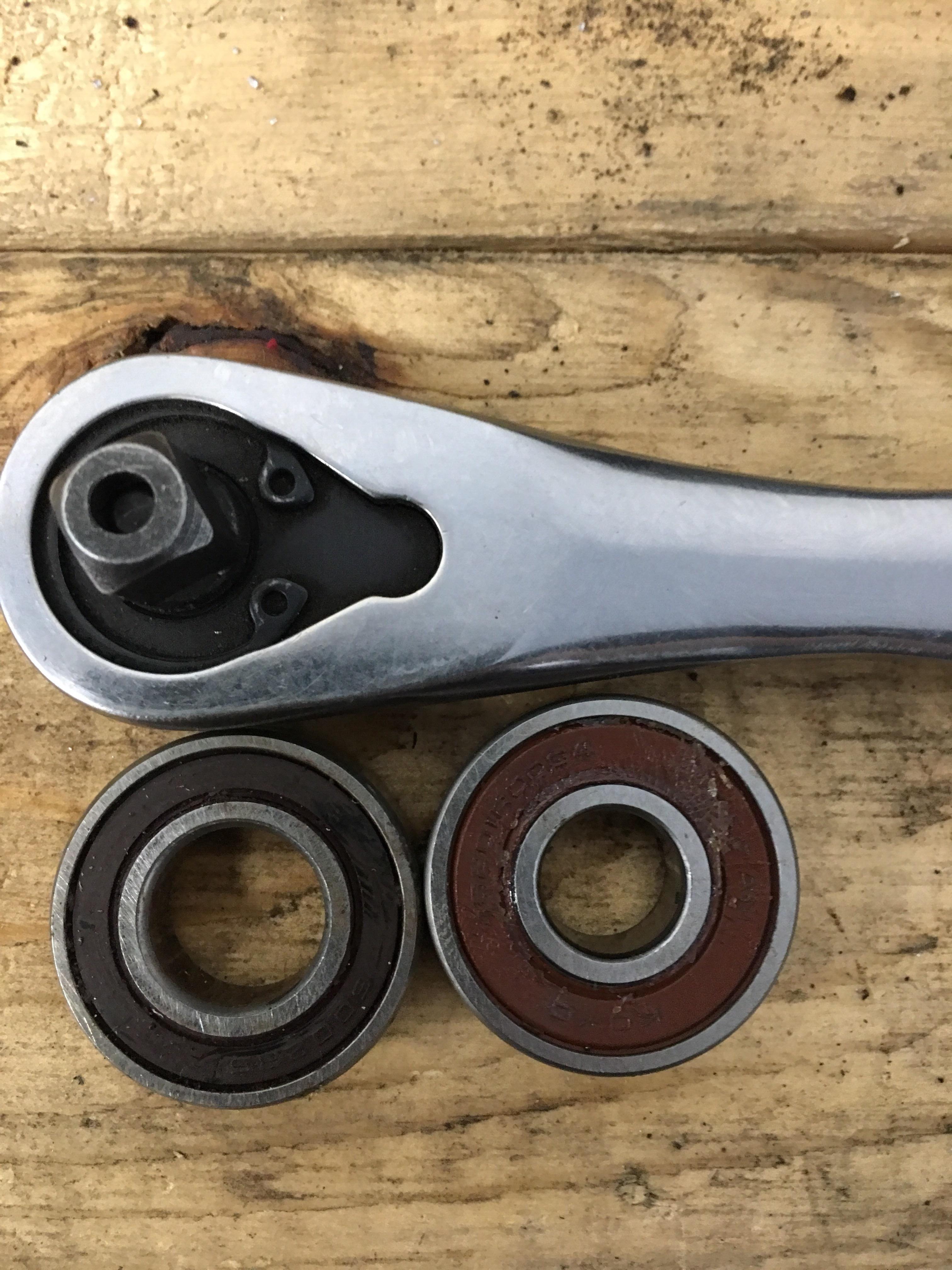

                              Oh and swapped out the pilot bearings for the larger one to accommodate the zf. In case anyone is curious about your shaft size I have included a pic of the difference
                              side note: 20ftlbs always seems like next to nothing for the pressure plate bolts

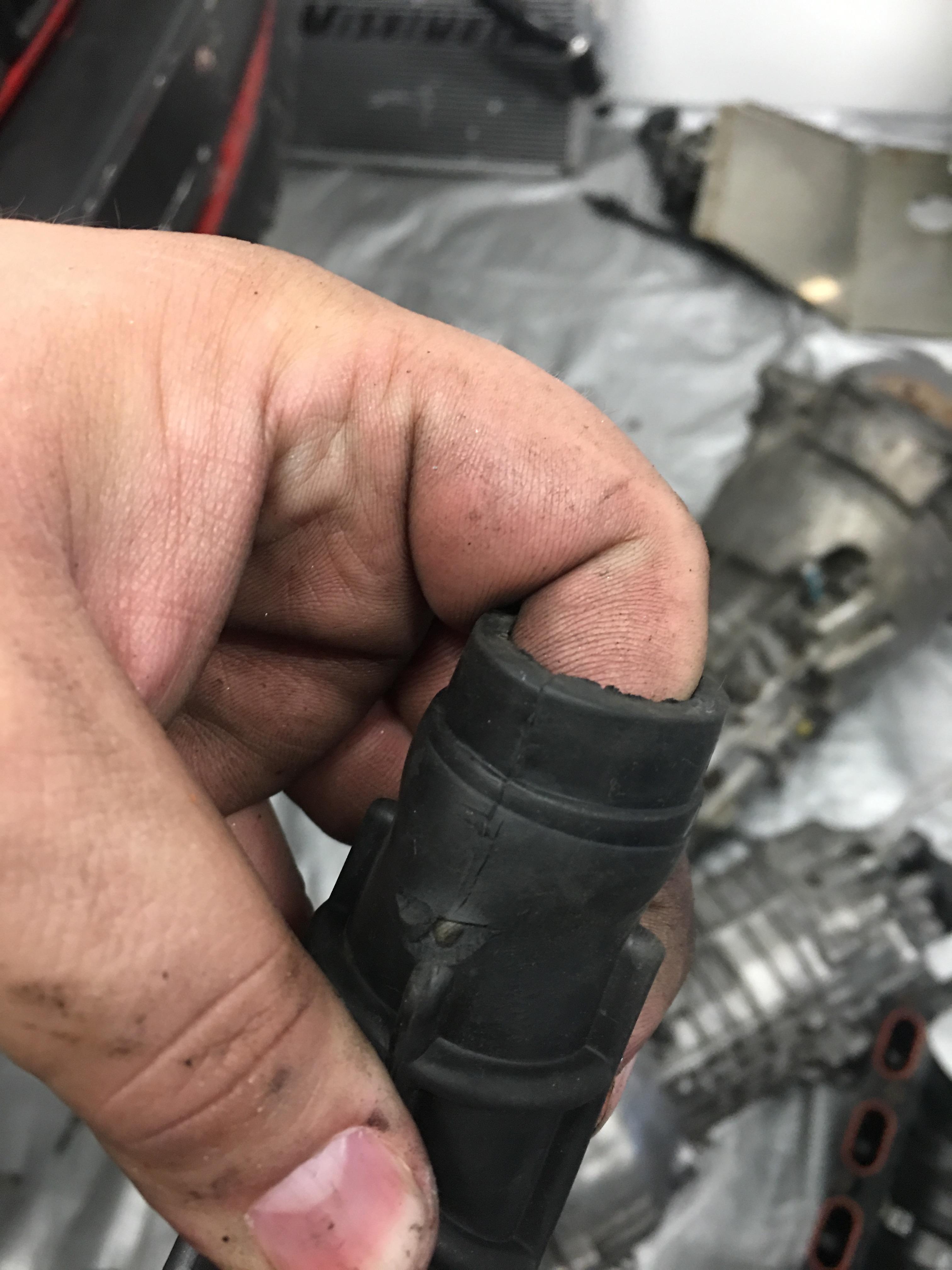

                                  lol at spider hose. Should just lift it from the ICV hoses. Those things never break either 👀
                                    #97
                                    I’ll get a comparison shot of the regular zf tob vs the 323TOB. Should be a difference of 4or5mm. Which should make up for the difference of dualmass/non dualmass flywheel. I want the clutch to engage not directly off the floor
