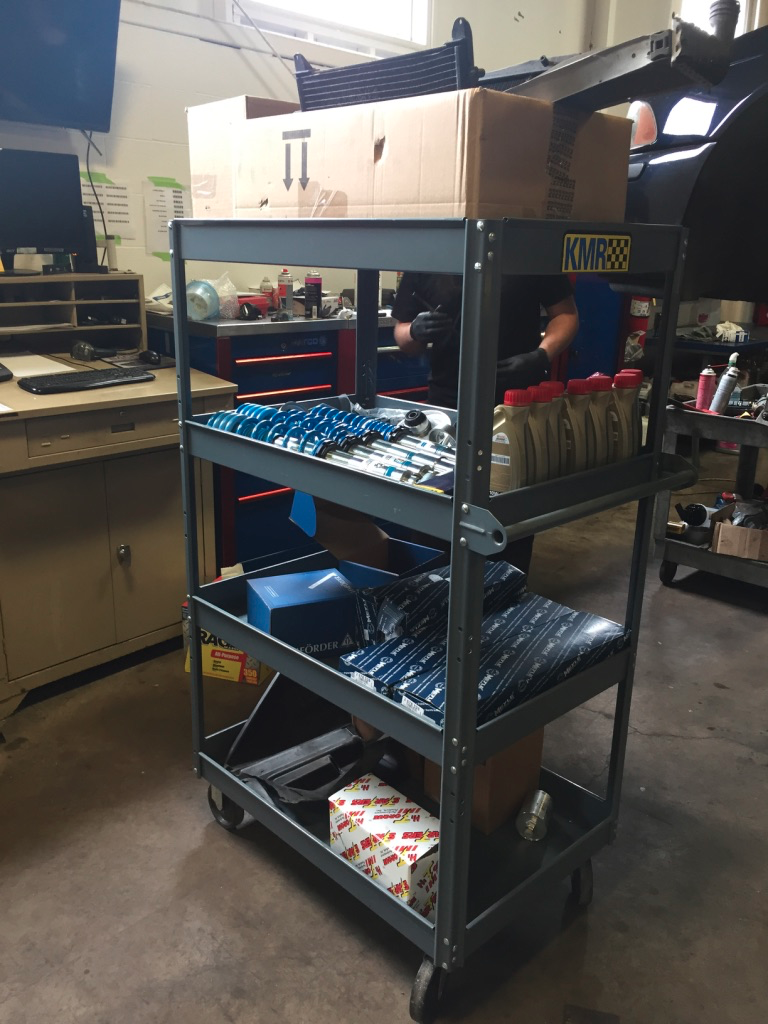

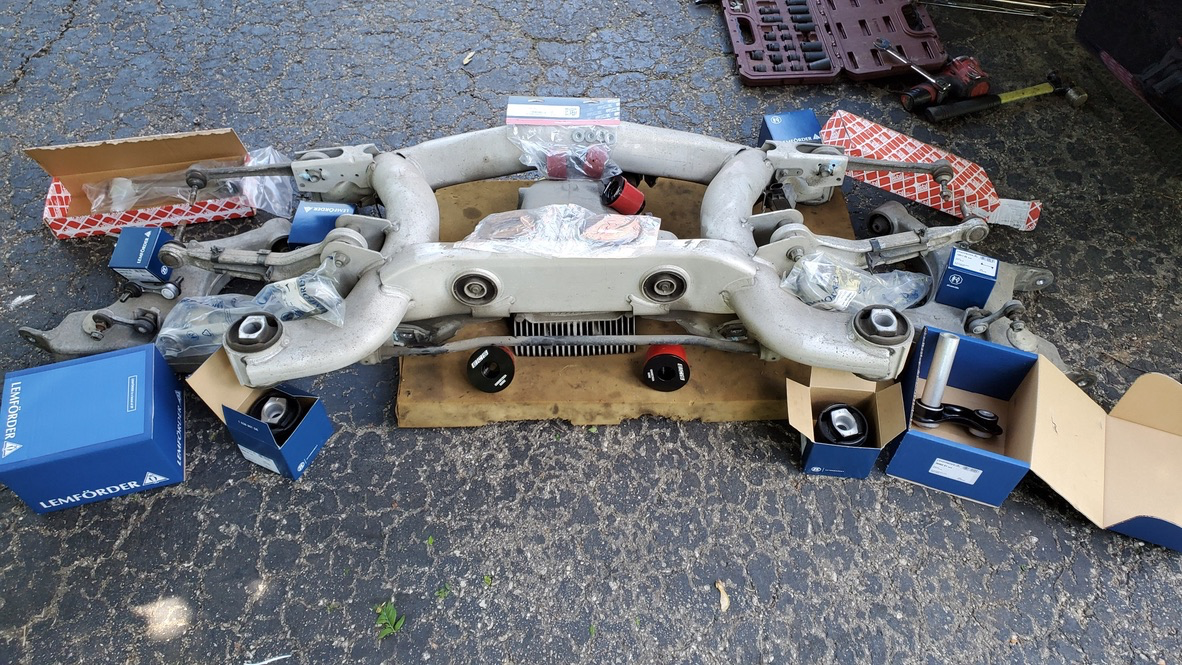

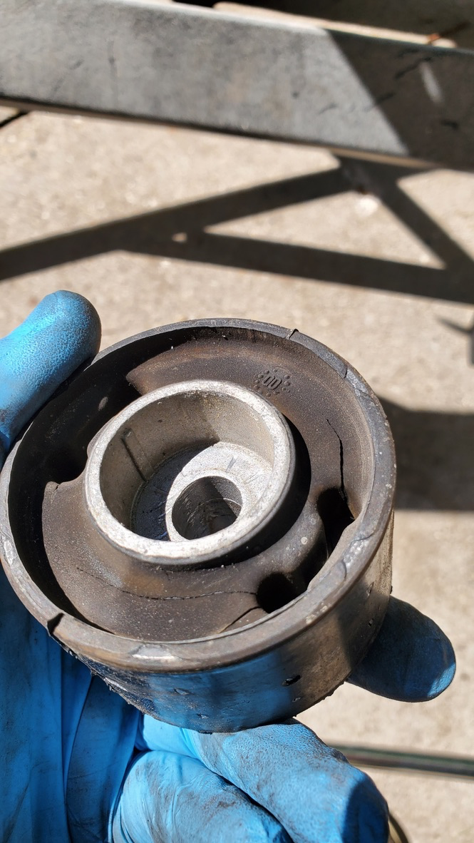

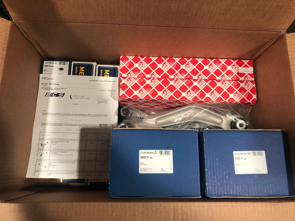

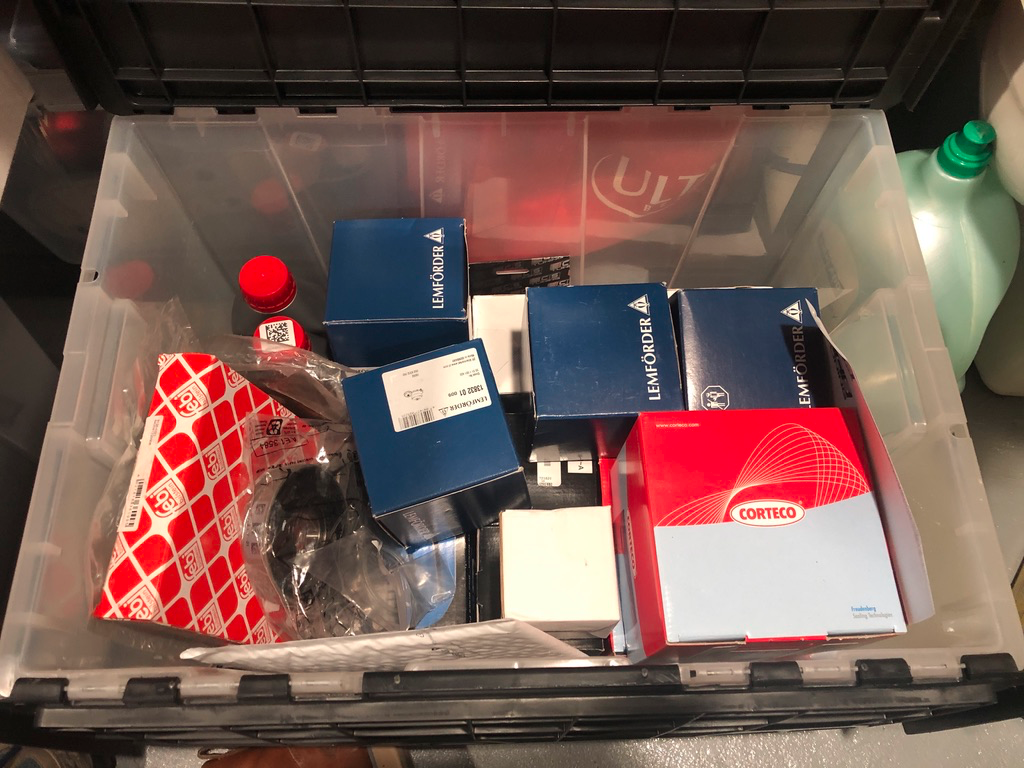

    Its time for the next big project on the M5 due to a loose rear end which is likely caused by bad bushings given that some of them have 100k on them.
    Plan:
    • Center support bearing
    • Drive axle minor refresh including guibo
    • Engine mounts
    • Transmission mounts
    • Differential bushings
    • Rear subframe bushings

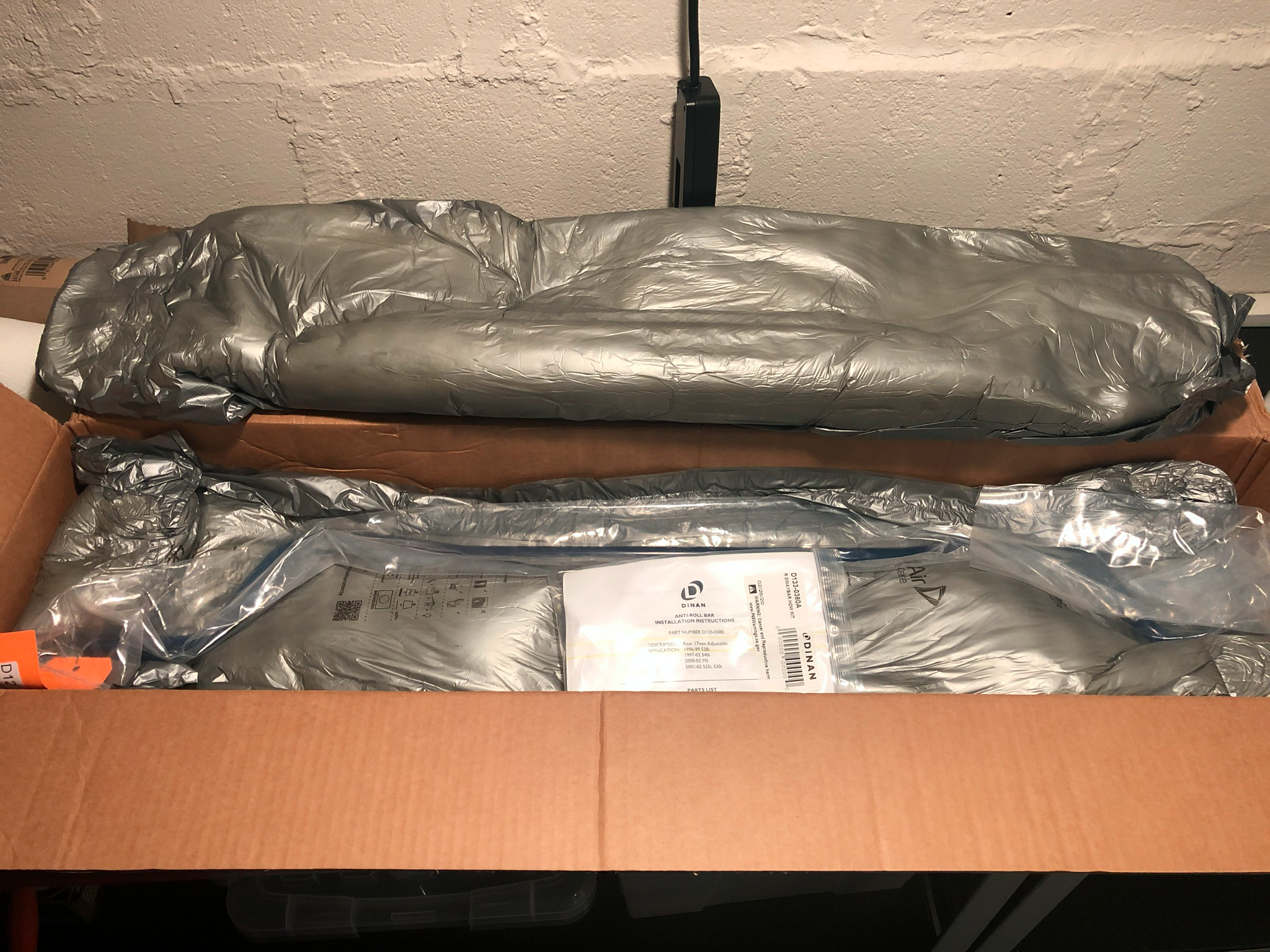

    • Dinan rear sway bar
    • All rear control arms and integral links
    • Center exhaust hanger
    • Rear ball joints
    • Hawk HPS and 5.0 brake pads
    • High temp brake fluid
    • Oil change
    Big thanks to @patsbimmer1for helping me source the parts and @jcw0101 for making it happen.
      #36
      Are rear subframe bushings for these as terrible as they seemed to be in every other car?

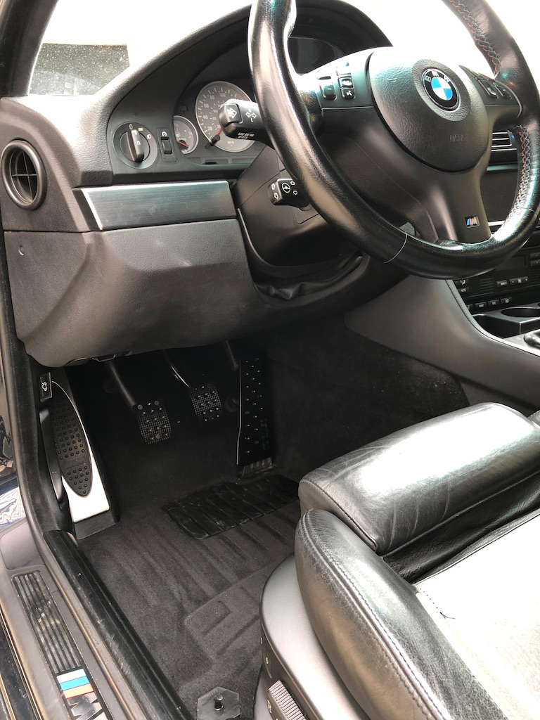

        How are you liking that Turner pedal set? I am thinking of acquiring some for myself.

          vbhargava
          #38
          I hope not but probably
            I love them. I really wanted a low key look and some added traction / surface area and these fit the build perfectly... especially in black. Contact @patsbimmer1 for help sourcing.

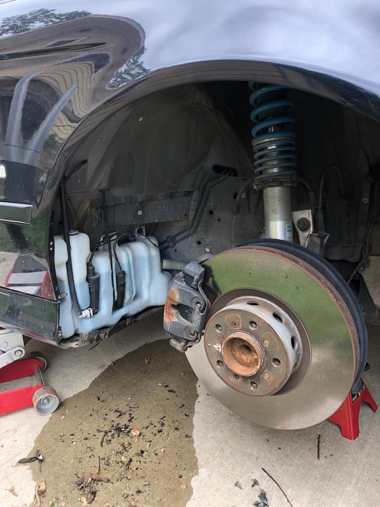

              #40

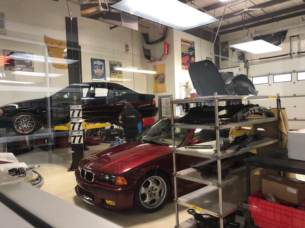

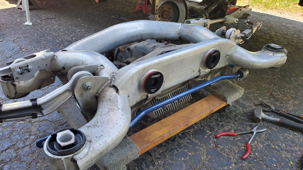

              Work in progress by @jcw0101 but its coming together!

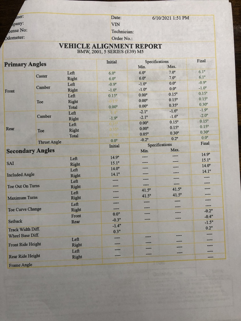

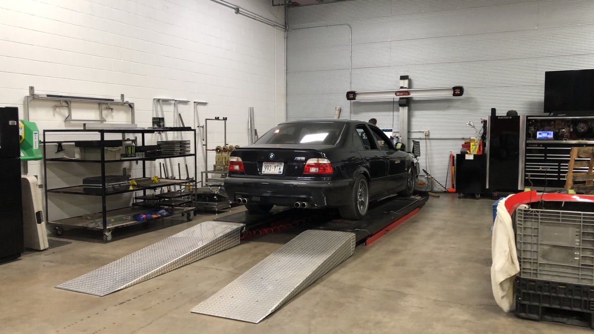

                      #44
                      After all the work last summer the car needed an alignment and KMR did a great job. Looking forward to getting out and testing it on the backroads soon.

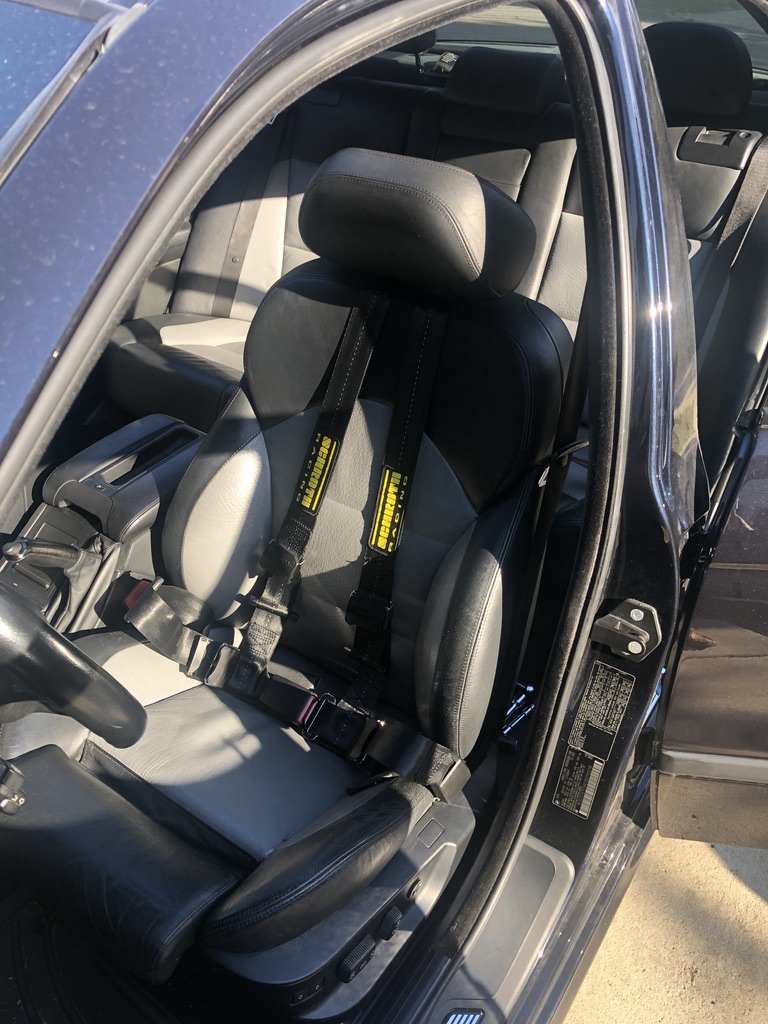

                        A little something something to hold me in the seat better on backroads.
                          #46
                          I need reviews!
                            #47
                            I need reviews!
                            I second this motion
                            • V
                              V
                              vbhargava
                              #48
                              @YoungCR @patsbimmer1
                              Installation: Super easy. Took 10 min.
                              Pros:
                              • Planted in the seat - I didnt realize how much of a difference this makes on backroads. Normally you are constantly compensating for lean with your body and arms, freeing yourself up from that lets you focus on car control and other inputs
                              • Easy for daily use - Takes 30 seconds to go from 3 point seat belt --> 4 point harness
                              • Airbag remains intact - not all harness setups allow for this
                              • Bolt-in Install - This was really important to me since E39 M5s are appreciating and I didnt want to drill anything out
                              • Harness Grips - recommend purchasing. Soo much easier tighten the harness
                              Cons:
                              • Wasnt expecting the shoulder pain. Makes sense why they make harness pads
                              Overall: 10/10 - wish I had done this sooner

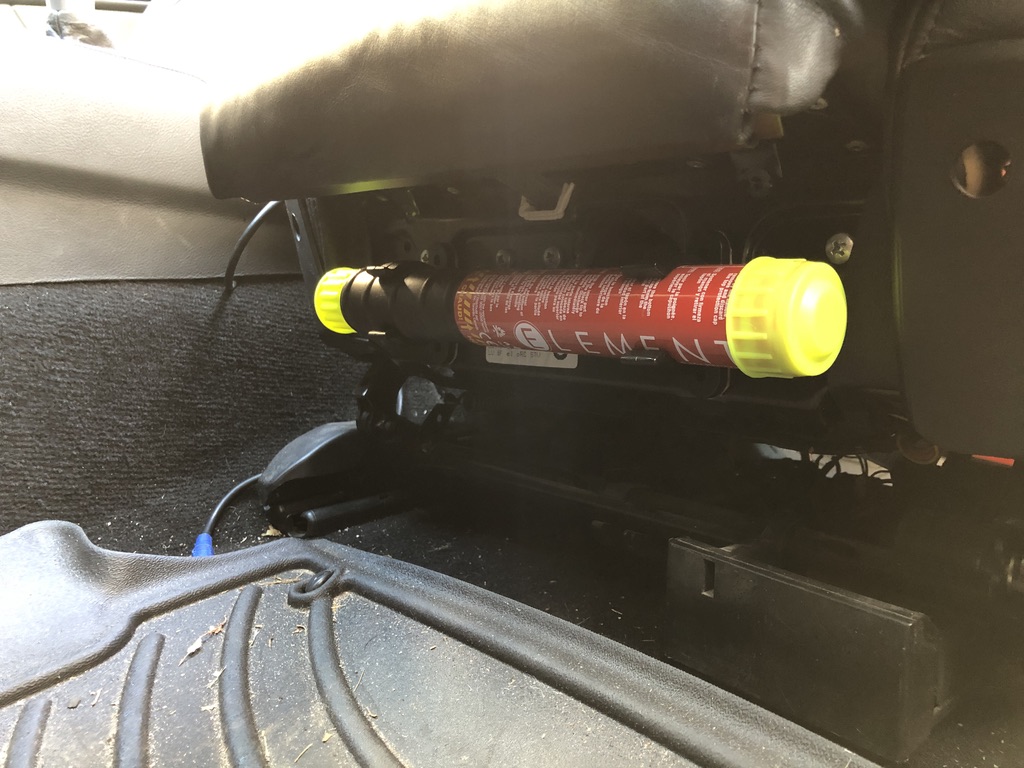

                                  Minor safety upgrade:

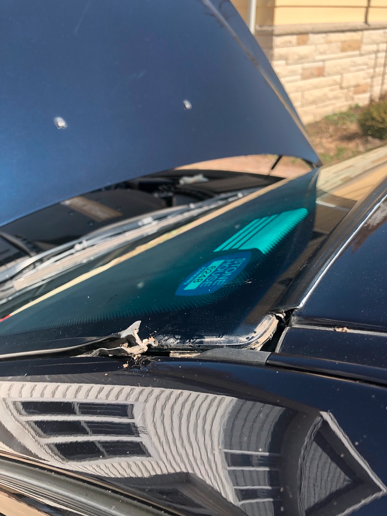

                                        Hoping to get back into project mode w/the M5 next month. This summer the focus has been on my new daily.
                                        Couple of immediate tasks:
                                        • DSP Amp replacement + reinstall BlueBus
                                        • PDR on hood - highway debris
                                        • Power steering lines
                                        • Aesthetic refresh due to backroads driving (conflicted about this one)
                                          • Front and rear bumper replacement
                                          • Headlight replacement
