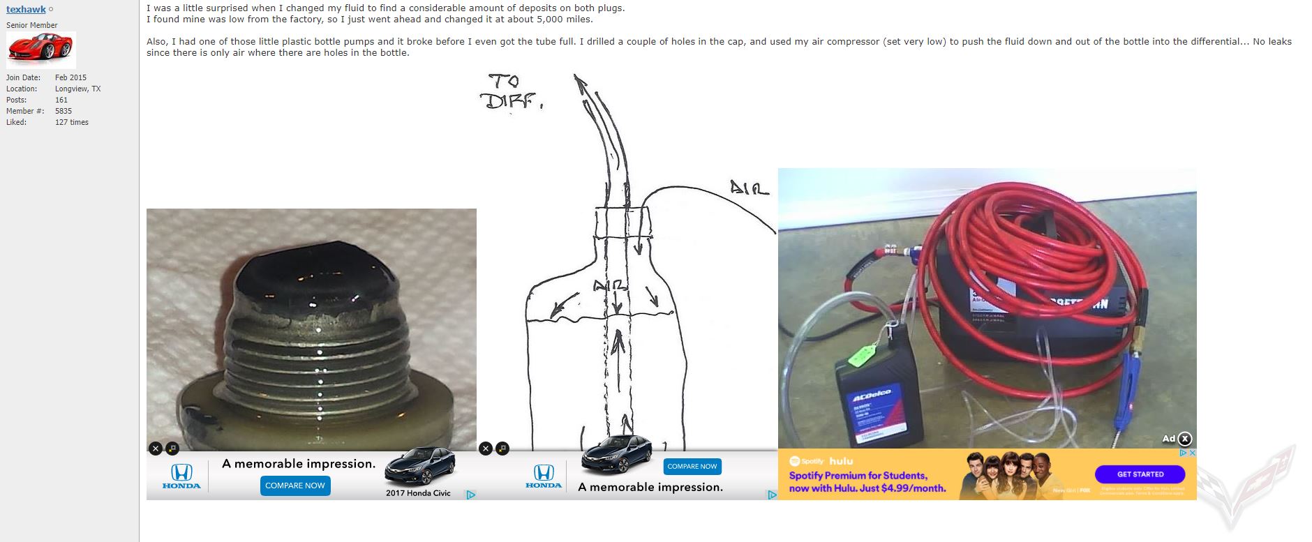

              Do you have an air compressor?
              1. If so, connect a hose to the top of the fluid bottle, In your case "Redline" and hose clamp it on tight.
              2. Lay the bottle on its side and poke a small hole in the side or bottom area of the bottle
              3. Insert the hose into the diff making sure there is some what of a gap around the hose to allow air out at the diff end
              4. take a blow gun and SLOWLY SLOWLY SLOWLY blow into the hole adding pressure behind the fluid and pushing it into the diff.
              This works well with thicker fluids and additives like syncromeshes and such.

                I can guarantee, without a doubt, that I would make a massive mess with this process lol. That being said, never heard it before but it's a great idea.
                  It may, or it may not. Depends on how barbaric you are with the air hose. I have used this method before on transmissions. I got the idea when working at CS and saw a pump device for transferring fluid from containers. Use an air coupler and a hose and it basically does the work for you.
                  Also, I am not alone in thinking this way.. This corvette guy has a similar idea, but its not linear like I was thinking.
                    Yeah, in the realm of possible and I do have the compressor...but I'd like to try it out in someone else's garage first. Mine's an attached to the house and the potential carnage has me cautious.
