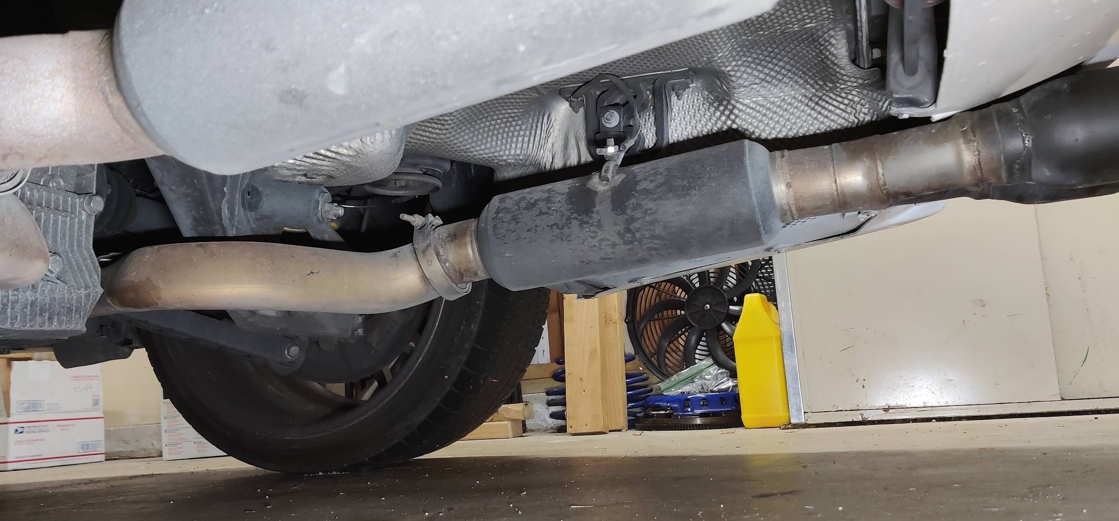

    Exhaust drone from 1800-3000 rpm is a bit.. strong.
    Found a stock muffler for $20 right near my house, so I went and picked it up. Installed it, started it, rolled back under the car and took it out, way too quiet. Will be cracking it open and replacing one of the perforated tubes in each side to get some volume out of it.
    Current exhaust is interesting, and done well. At this point those cans are completely empty though. I will be grabbing some mufflers to replace them with as well and see how that goes. $50 for some cherry bombs cant be worse than it is haha.
    All to avoid spending $700 on the muffler I truly want.

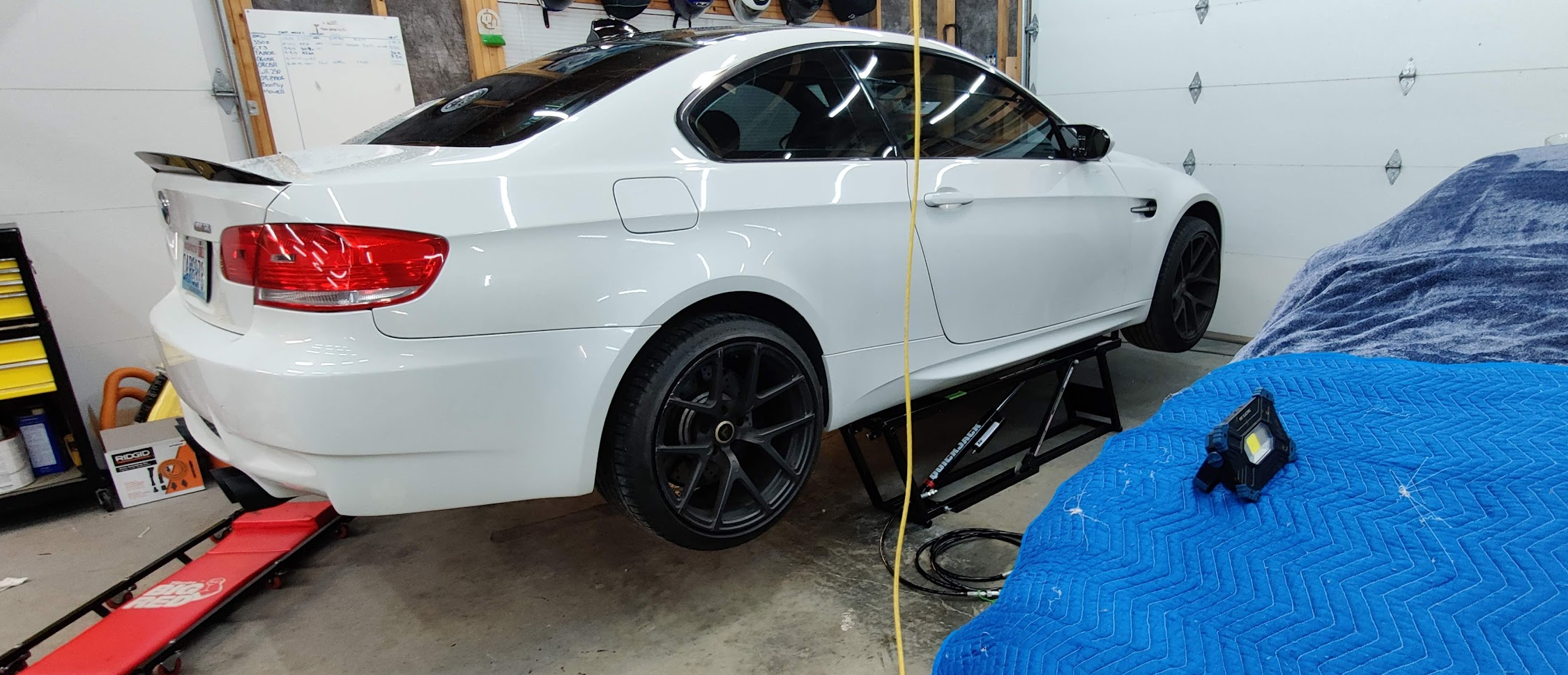

    A friend has a set of quick jacks, these things are really slick, and for $1300 it is a pretty sweet option. The older I get the less I care to jack up a lowered car and put it on stands...

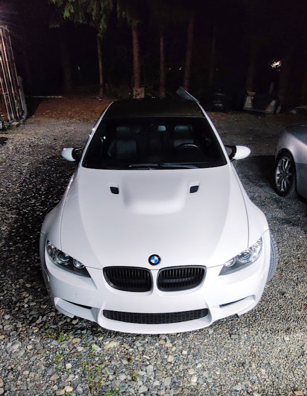

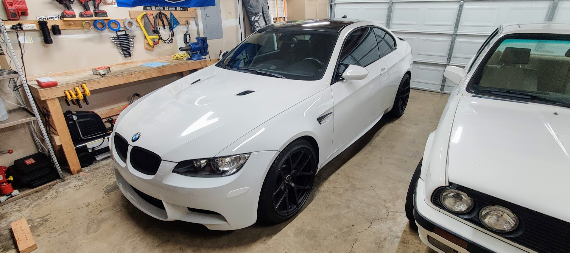

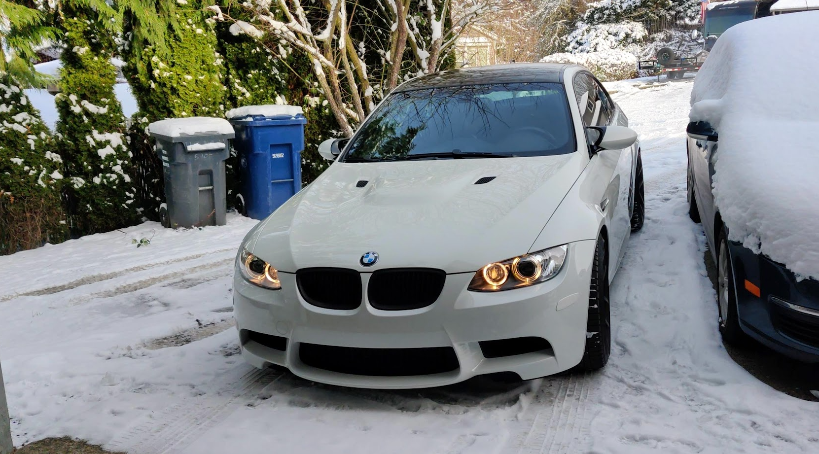

        We got a bunch of snow recently, had to move the M3 out of the garage to work on other things. She didn't like the cold.
        Ordered rod bearings, motor mounts, and exhaust gaskets.
        I really enjoy this thing. I have neglected all other vehicles since obtaining the M3... image.png

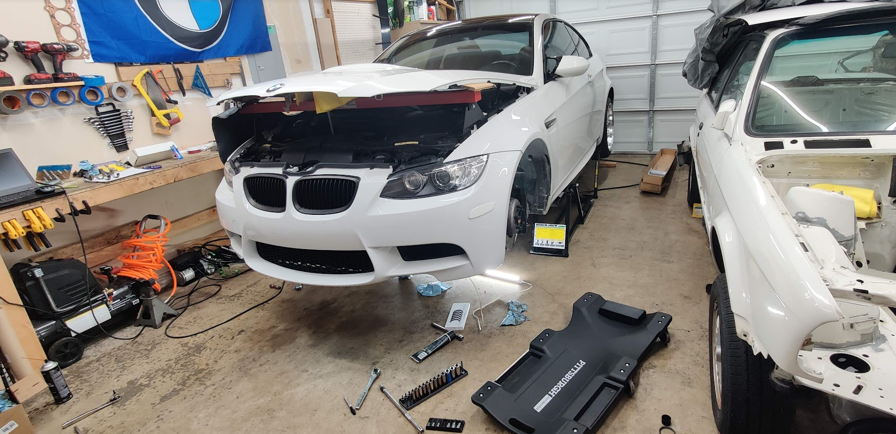

                  It was a very busy couple of days for the M3!
                  At 109k miles I did the rod bearings and bolts, motor mounts, header gaskets, trans mounts, driveshaft center support bearing, trans fluid, and engine oil.
                  The motor mount on passenger side was two pieces, and the drivers side was collapsed and the oil pan was resting on the sway bar.
                  Bearings looked acceptable for the mileage, but good to have piece of mind that they're done.
                  The motor had been replaced by the dealer at around 300 miles for a stuck injector, and it looks like they didn't do the header gaskets correctly...
                  The drive after felt great, significantly smoother with the engine not rocking around in there and being properly isolated from vibrations.

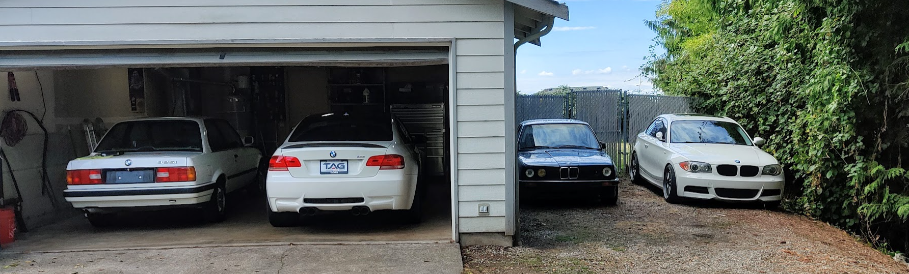

                      What's better than having 5 vehicles? Having 6!
                      A poor picture for intro, but its the only one I have right meow
                      This was a spur of the moment decision, and is planned to replace my truck and 1 series.
                      2011 x5 35d Sports package, HUD, 360 cam, premium package, pano sunroof, and a set of snow tires + to go with it
                      More details / photos later

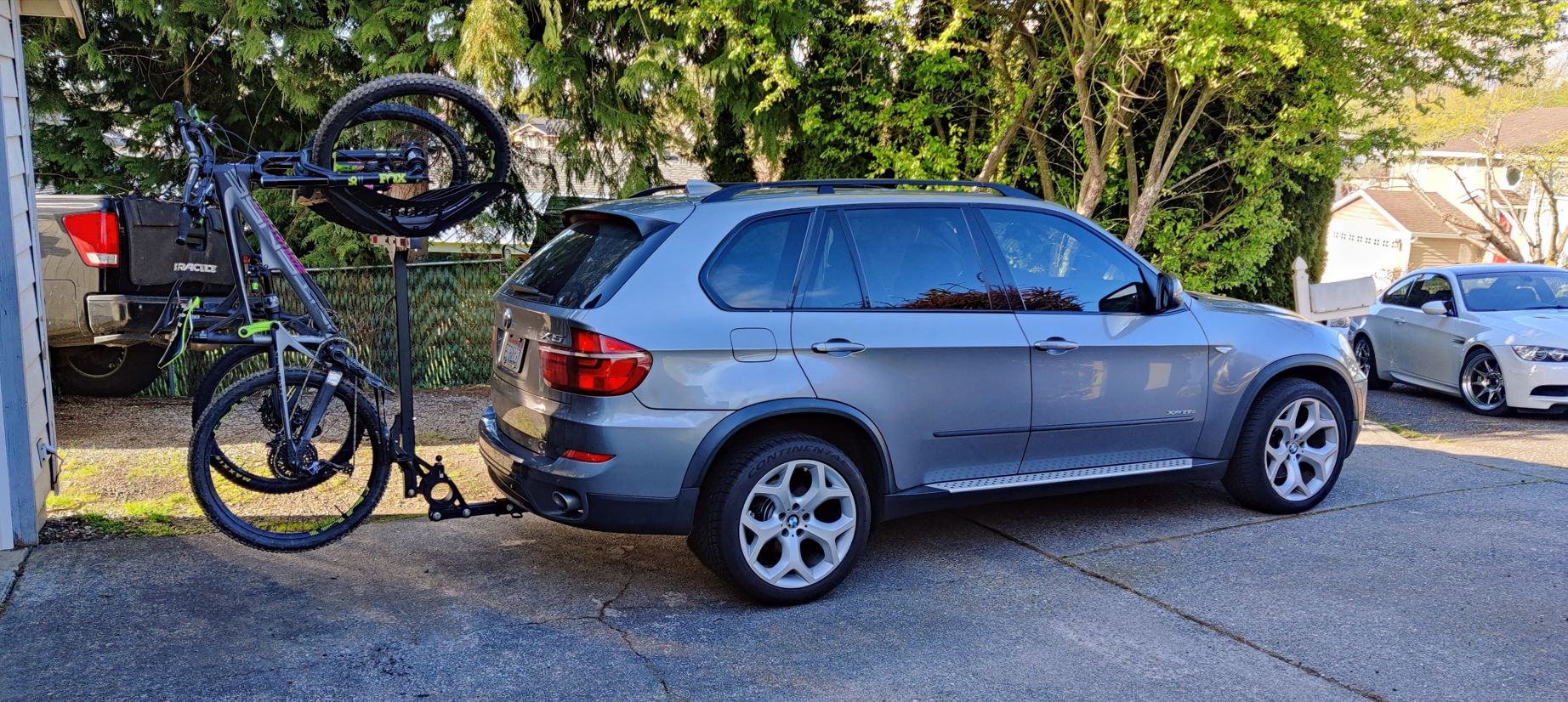

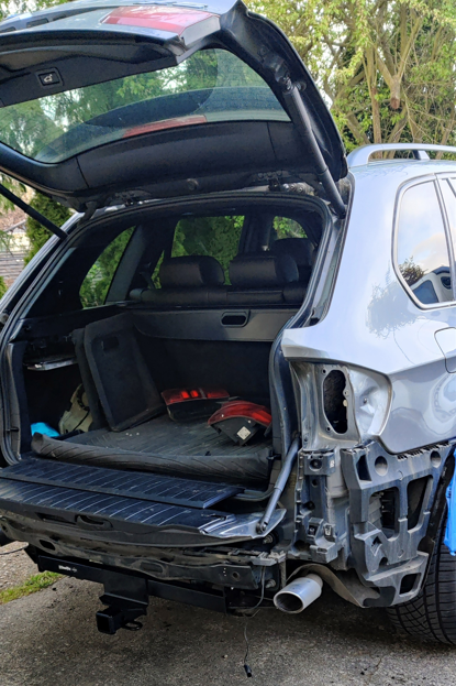

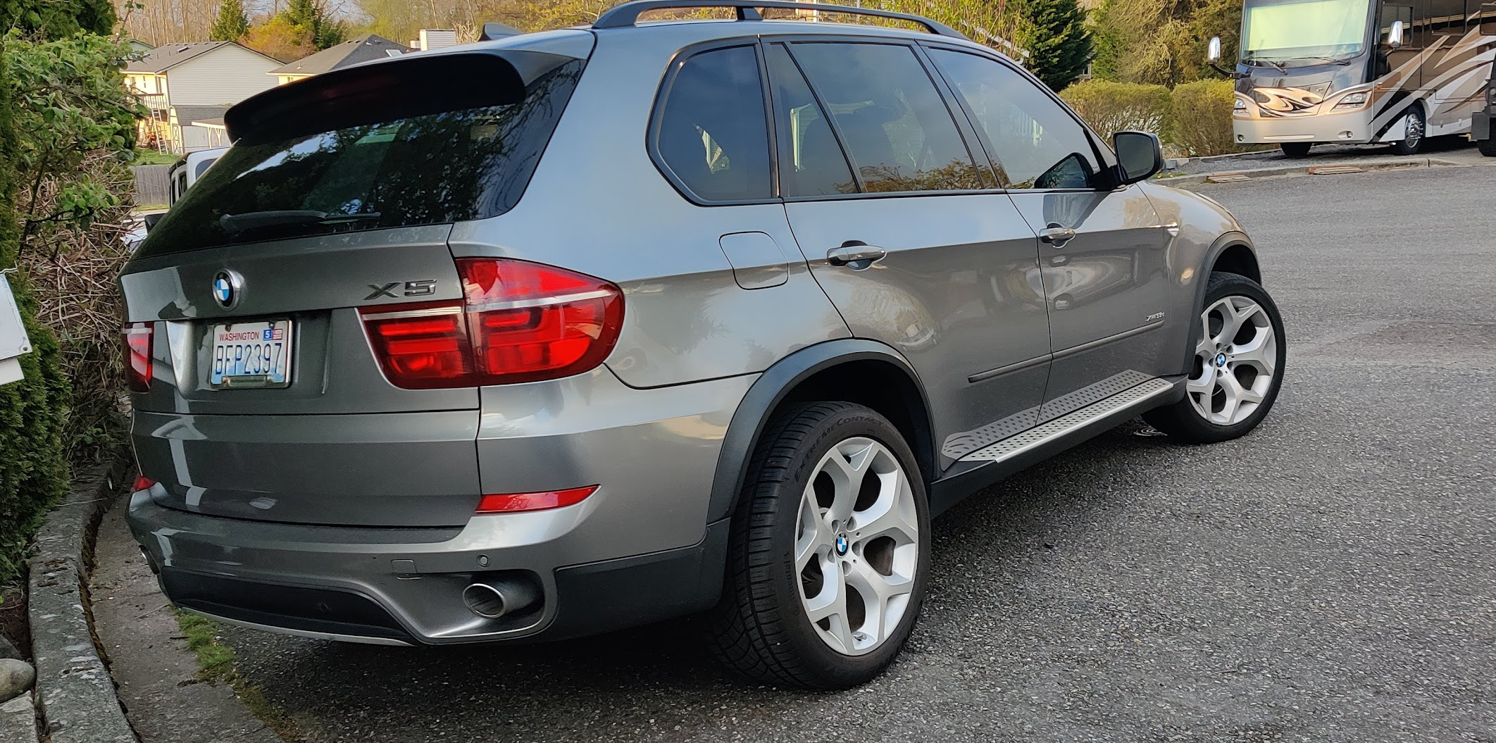

                        Hitch installed
                        Nice an easy access to get that one installed.......
                        Got a bike rack after much deliberation. Settled on a 1up Recon 5 vertical rack. 5 places for bikes, pivots out of the way of the hatch, and weighs a cool 95lbs! I've been enjoying it vs the truck

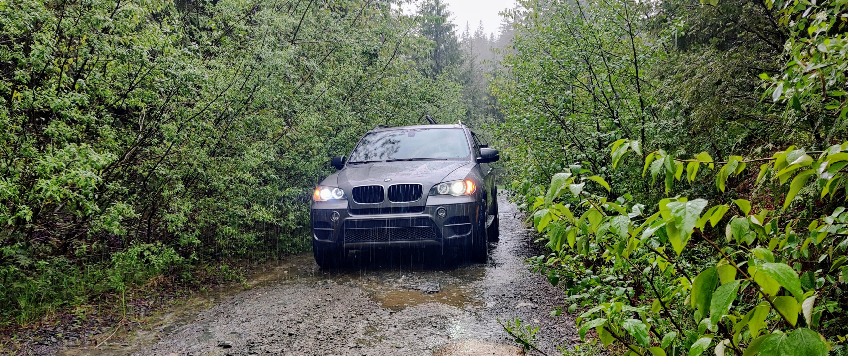

                        Did some light off-road driving in Whistler to car camp after a day of biking (full size mattress fits perfectly with the seats folded down) and found I need to get rid of the 20's as soon as possible.
                        Went up to Mazama to visit a friend, rock climb, mountain bike, and go for a hike and brought the X5.
                        On the way back got an error for oil level over max, which I thought was odd as I had checked it after purchase and the oil level was near the top, but not over. Checked on the dipstick and it was indeed over the max mark, meaning the oil level sensor was intact. The oil smelled like diesel so the hunt was on. After pulling up the coolant temp and driving around a bit I found that the thermostat is stuck open, and am trying to find when the last DPF regen was as it likely got up to temp to be able to do a regen while climbing the mountains, but then cooled down and just dumped all that extra fuel into the oil. I can't get the coolant temp to go over 150 on the highway, with 140 being the average. Running temp is to be in the 190-195 range, so I'm getting plenty of fuel past the pistons.
                        New thermostat and EGR delete on the way! Of course with an oil change in the next couple of days.

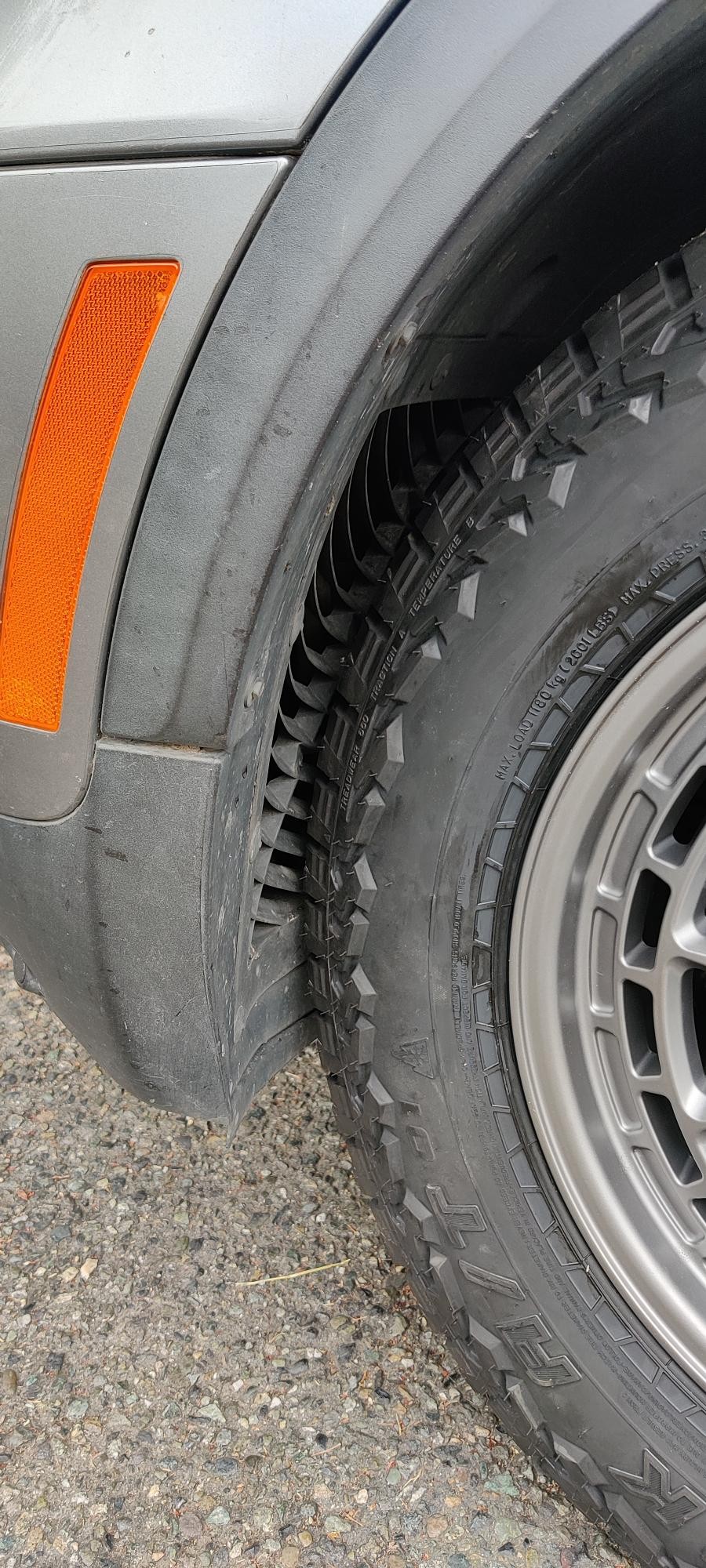

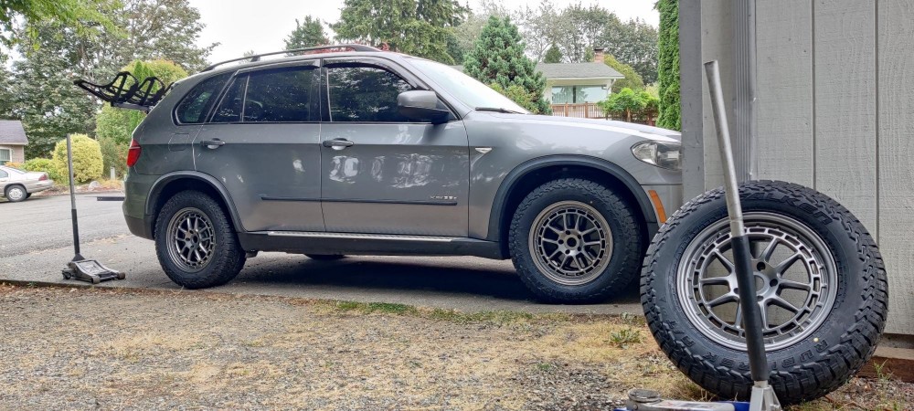

                              Fixed the offroad issue with some 18's and 31" all terrains (Falken Rubitrek)
                              I dig the look, and will enjoy it even more once I get the 20mm spacers in the rear!
                              I've got a bit of clearance work to be doing, but nothing major!](/assets/uploads/files/monthly_2022_08_image.jpeg.060fa7122d51bfe9d5fdcf76b45b41b7.jpeg)

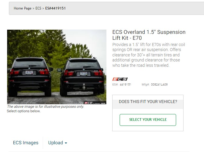

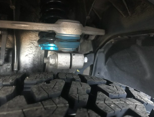

                                      I dislike the phrasing that ECS used for their lift, as there is no height issues limiting tire size. The limit to tire size is the front spindle design, the control arm ball joint mtg is over the tire instead of behind it. You are physically limited to a 31" OD tire unless you completely redesign the front suspension or run a large spacer.
                                      I;m thinking about thos Sidewalls.
                                      They're less sidewally than I wished for, but the brakes limit me to an 18" wheel, and the upper control arm / spindle limits me to a 31" tire without getting wild.
                                      I looked at the rabbit hole that was "Stuffing 33's" under it and doing what it took, but at the end of the day it's my daily driver so I should avoid that.
