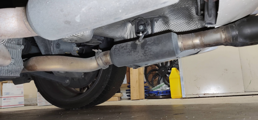

    Exhaust drone from 1800-3000 rpm is a bit.. strong.
    Found a stock muffler for $20 right near my house, so I went and picked it up. Installed it, started it, rolled back under the car and took it out, way too quiet. Will be cracking it open and replacing one of the perforated tubes in each side to get some volume out of it.
    Current exhaust is interesting, and done well. At this point those cans are completely empty though. I will be grabbing some mufflers to replace them with as well and see how that goes. $50 for some cherry bombs cant be worse than it is haha.
    All to avoid spending $700 on the muffler I truly want.

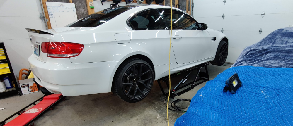

        We got a bunch of snow recently, had to move the M3 out of the garage to work on other things. She didn't like the cold.

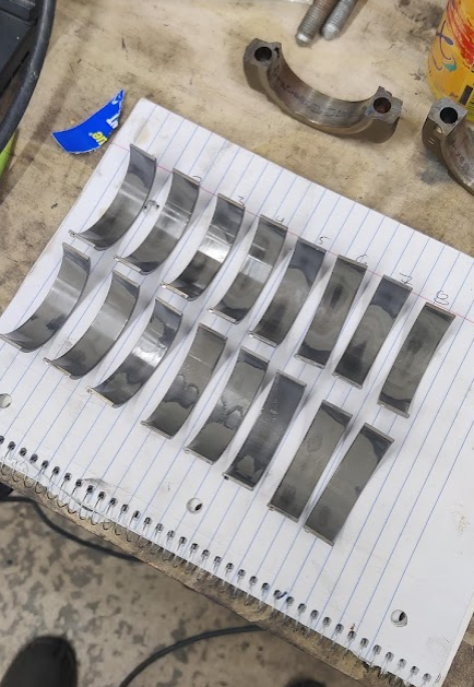

        Ordered rod bearings, motor mounts, and exhaust gaskets.
        I really enjoy this thing. I have neglected all other vehicles since obtaining the M3... image.png

          Sure the S65 is like the S54 with constant debate about which bearings are the best, coated vs non coated etc. Curious what you ended up going with?
            #186
            You are oh so correct about there being thousands of posts and debates about what is best.
            I avoided coated bearings as it seems they are typically coating stock sized bearings, which is extra not good.
            I went with BE bearings and bolts, as it seems they are the most consistent in sizing and you are basically paying for them to check and provide matched sets over something like ACL's where you want to mix shells to get extra clearance but not too much. I don't want to have to be in there twice so the extra couple dollars for QC is worth it to me.
            In looking at the journal dimensions and bearing tolerances I quickly understand why these have bearing failures, that's a damn tight clearance!

              Doing the BE bearings with the ARP install hardware is by far the best move. That peace of mind of worth the money. Best money I spent on my car.  They’re the most popular choice out there (when they’re available). I haven’t seen a single failure on the forums when they’ve been installed.

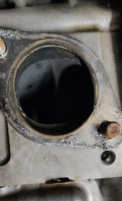

                  At 109k miles I did the rod bearings and bolts, motor mounts, header gaskets, trans mounts, driveshaft center support bearing, trans fluid, and engine oil.
                  The motor mount on passenger side was two pieces, and the drivers side was collapsed and the oil pan was resting on the sway bar.
                  Bearings looked acceptable for the mileage, but good to have piece of mind that they're done.
                  The motor had been replaced by the dealer at around 300 miles for a stuck injector, and it looks like they didn't do the header gaskets correctly...
                  The drive after felt great, significantly smoother with the engine not rocking around in there and being properly isolated from vibrations.
