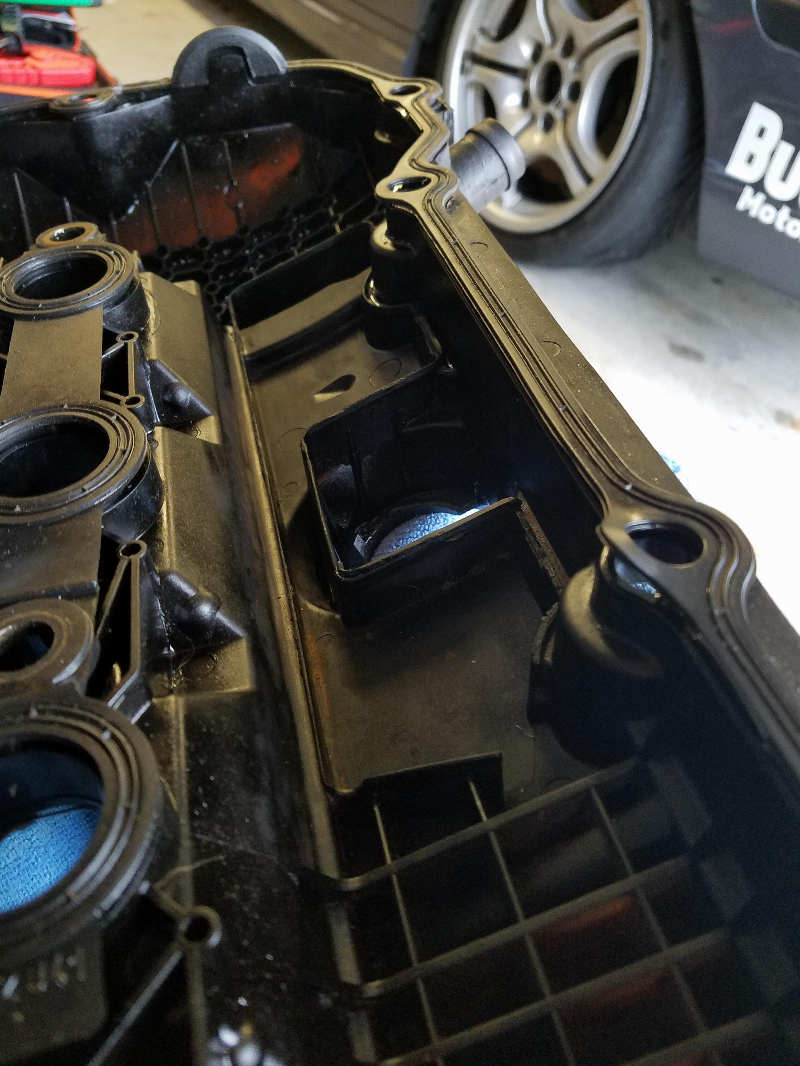

    CCV system:
    Now the CCV system is no longer installed. The previous owner added a cheaper catch can in place of the system. The outlet on the valve cover goes to the catch can and the outher inlet on the catch can is linked to the 2 CCV ports on the intake manifold. When i checked the catch can at the track there was minimal oil in it. The catch can system does NOT have a one way valve in between the intake and the can (I read a few forums that said it should?) Lastly when it comes to the CCV i had to change valve covers because the original one was cracked. The other valve cover I had was not (although it was not new) The over inside of the valve cover that seems to be a baffle before the outlet on the valve cover for the CCV has been removed. (was thinking this may be allowing crank case gasses to pass quicker through the system and into the intake to be burned possibly?)

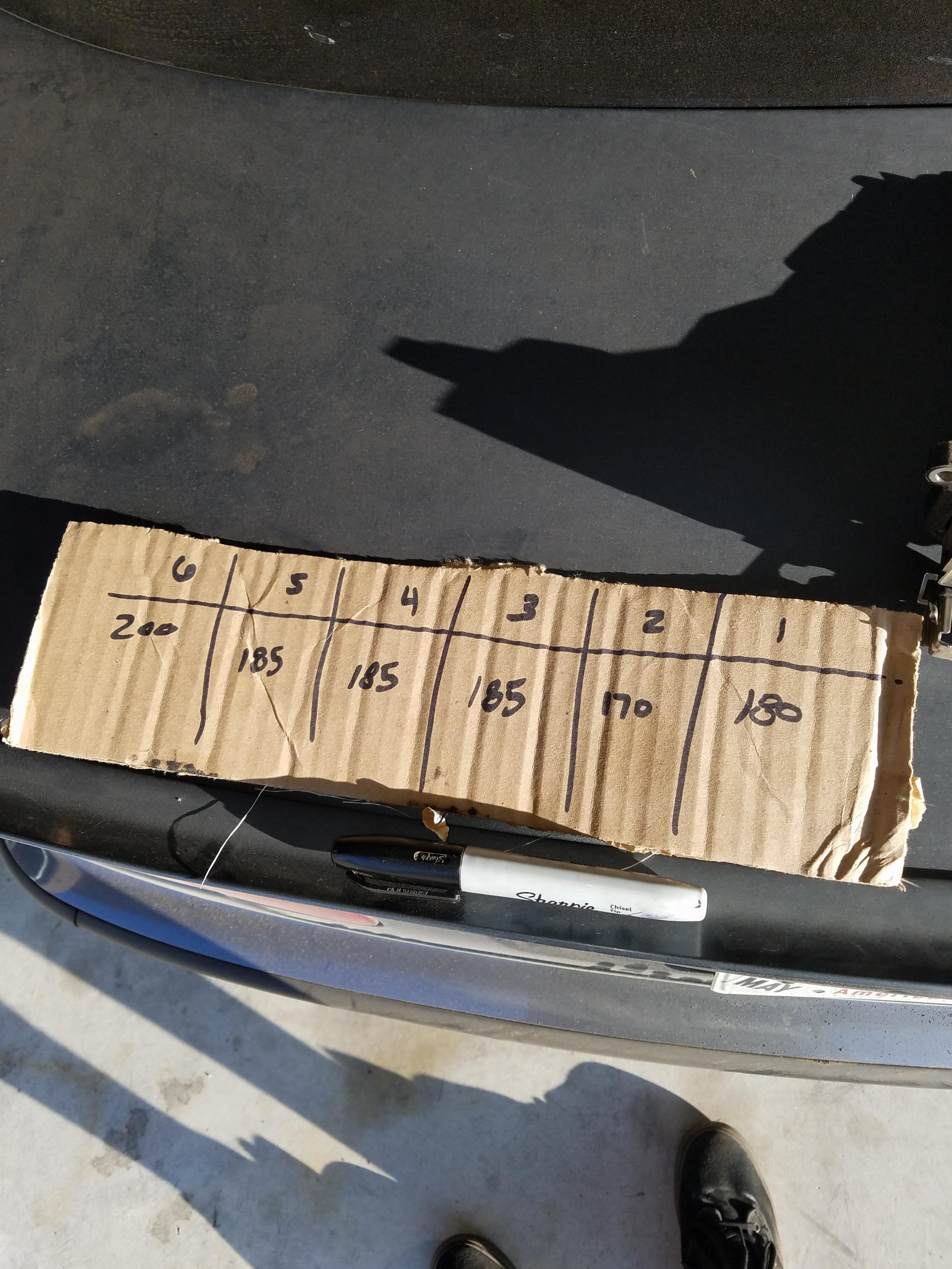

                  Here are the compression test numbers. Car ran for a little under 10 min before I performed the test.
                  Spark plugs were a little wet and it was not fuel.
                    Brave soul performing a compression test and posting it here. There's been bad juju all here regarding compression tests lately haha

                                          NOTE: while the car was running I removed the oil cap and got the hissing noise as I removed it. Meaning the crank case is under a fair amount of pressure. From research this means the CCV failed, but I have no CCV. Thoughts on that?
