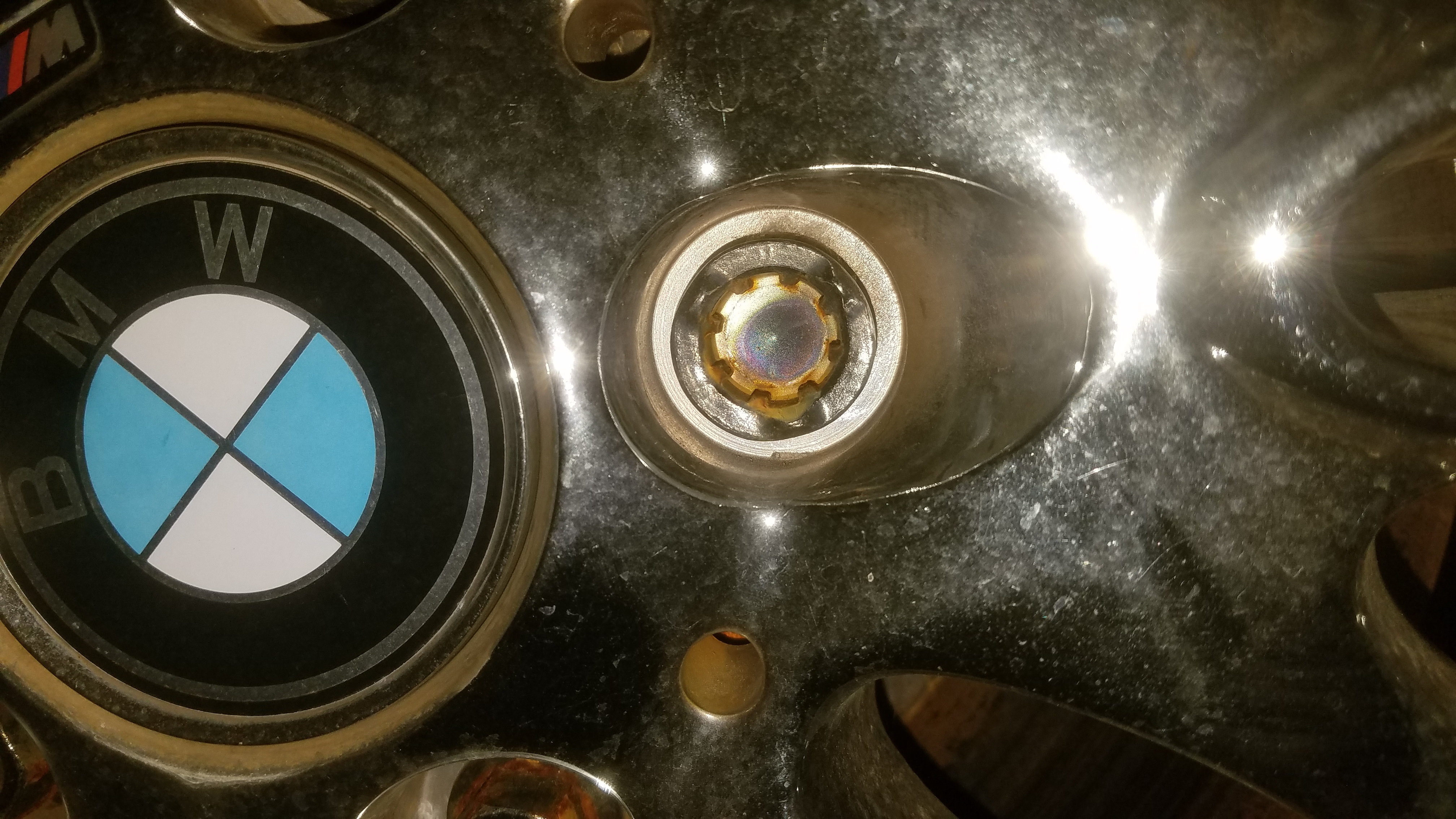

                        Anyone have the socket "key" for this stupid thing? I want to take my wheels off 😕
                          #52

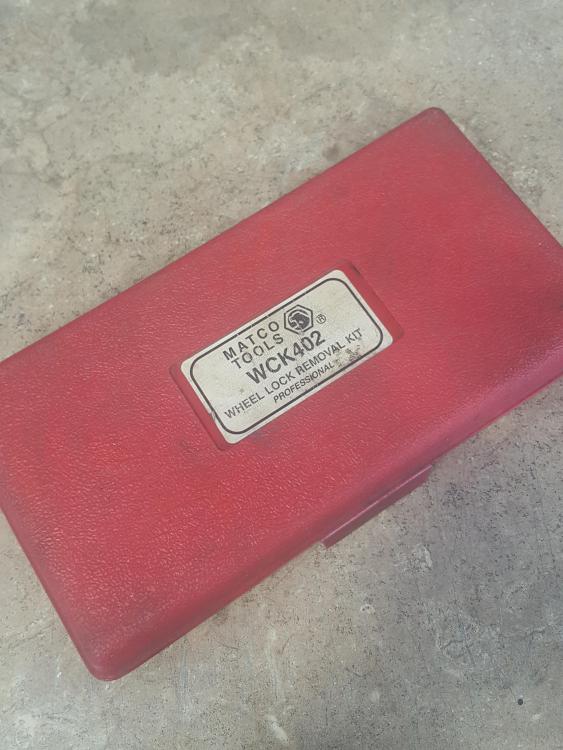

                          That's not a typical bmw wheel lock. I've got a set of wheel lock removal sockets if you need them.
                          • D
                            Daggerty
                            #53
                            I'll check my supply and see if I have one that matches.

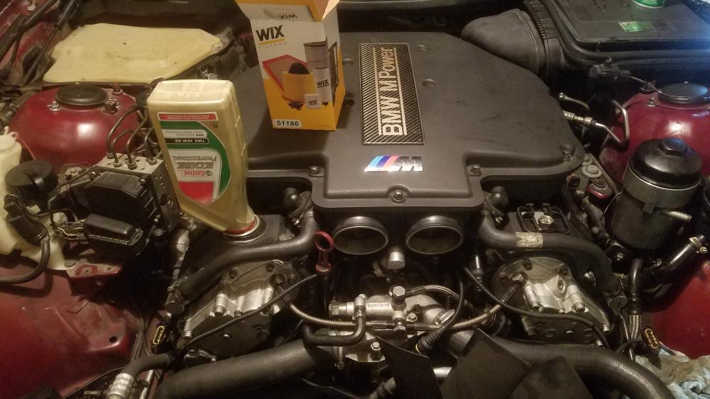

                              T-minus 20hrs until I come home from work to $84 in oil on my garage floor lol. Hood is officially down! Just need to do stupid coolant things.

                                  I'm afraid I don't have the key if the bolt size is 17mm

                                      I've got this sitting around if you want to grab it ...
