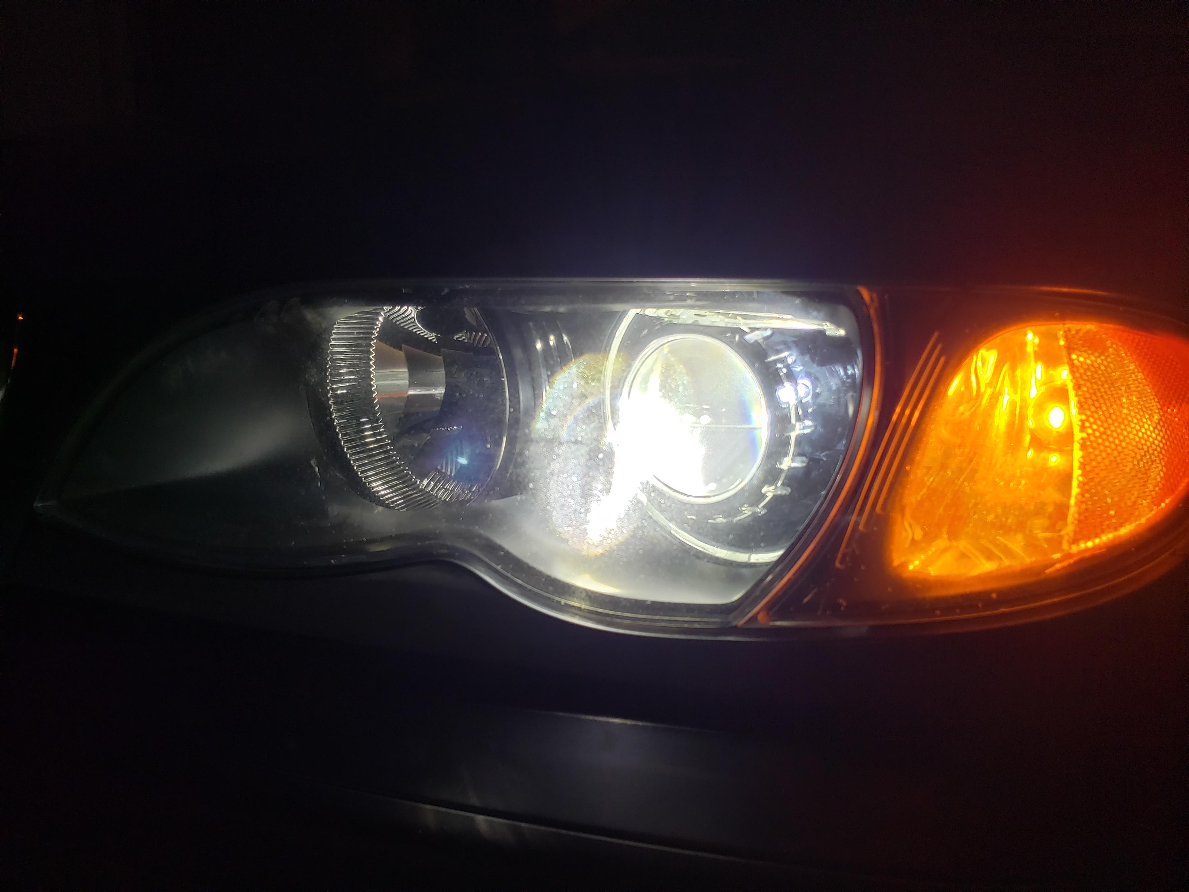

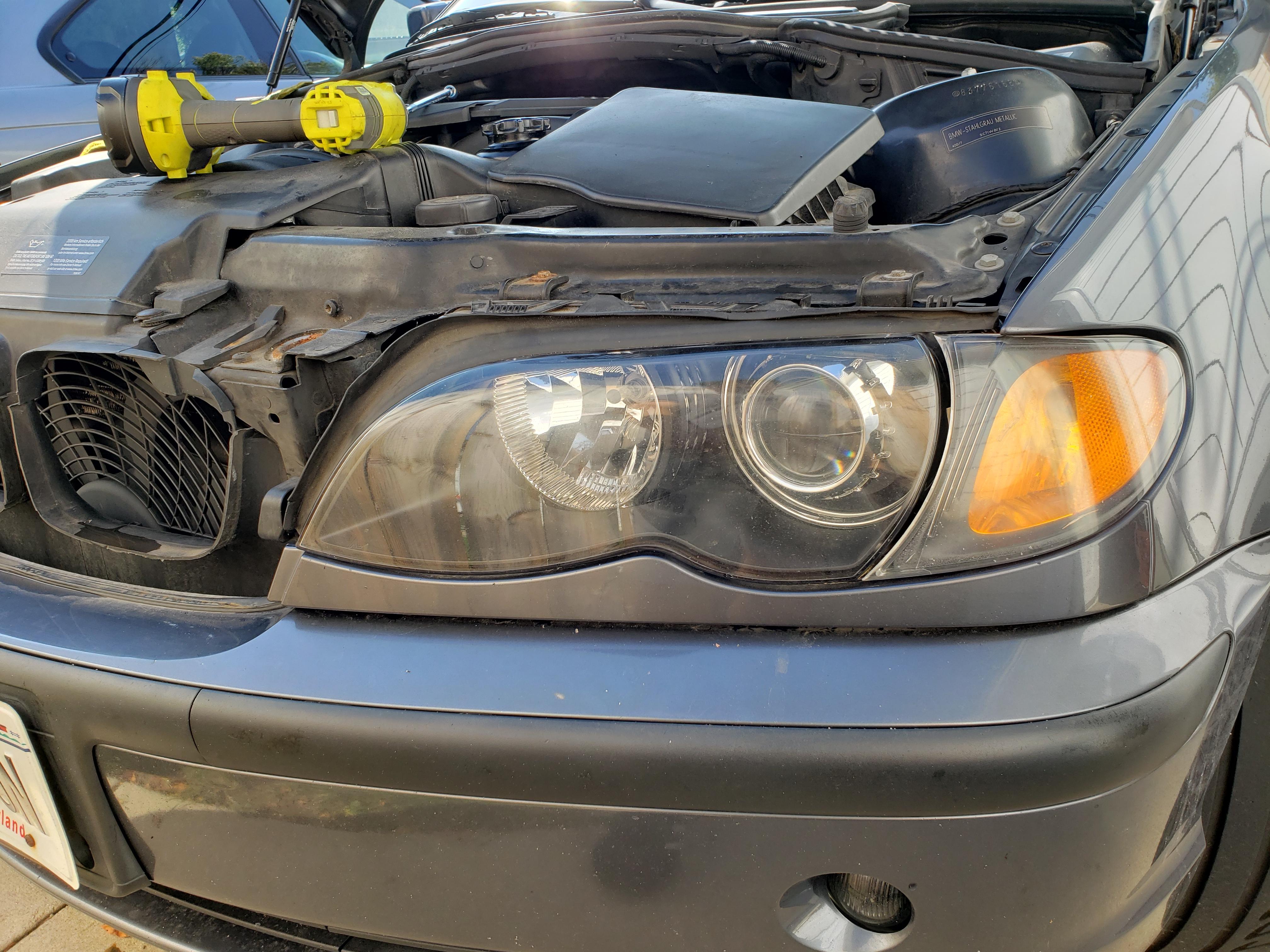

I’m going to be shopping bulbs for mine soon if you have any recommendations

I justed asked the guy to include the bulbs and he did. Lol.
Let me know what you get!

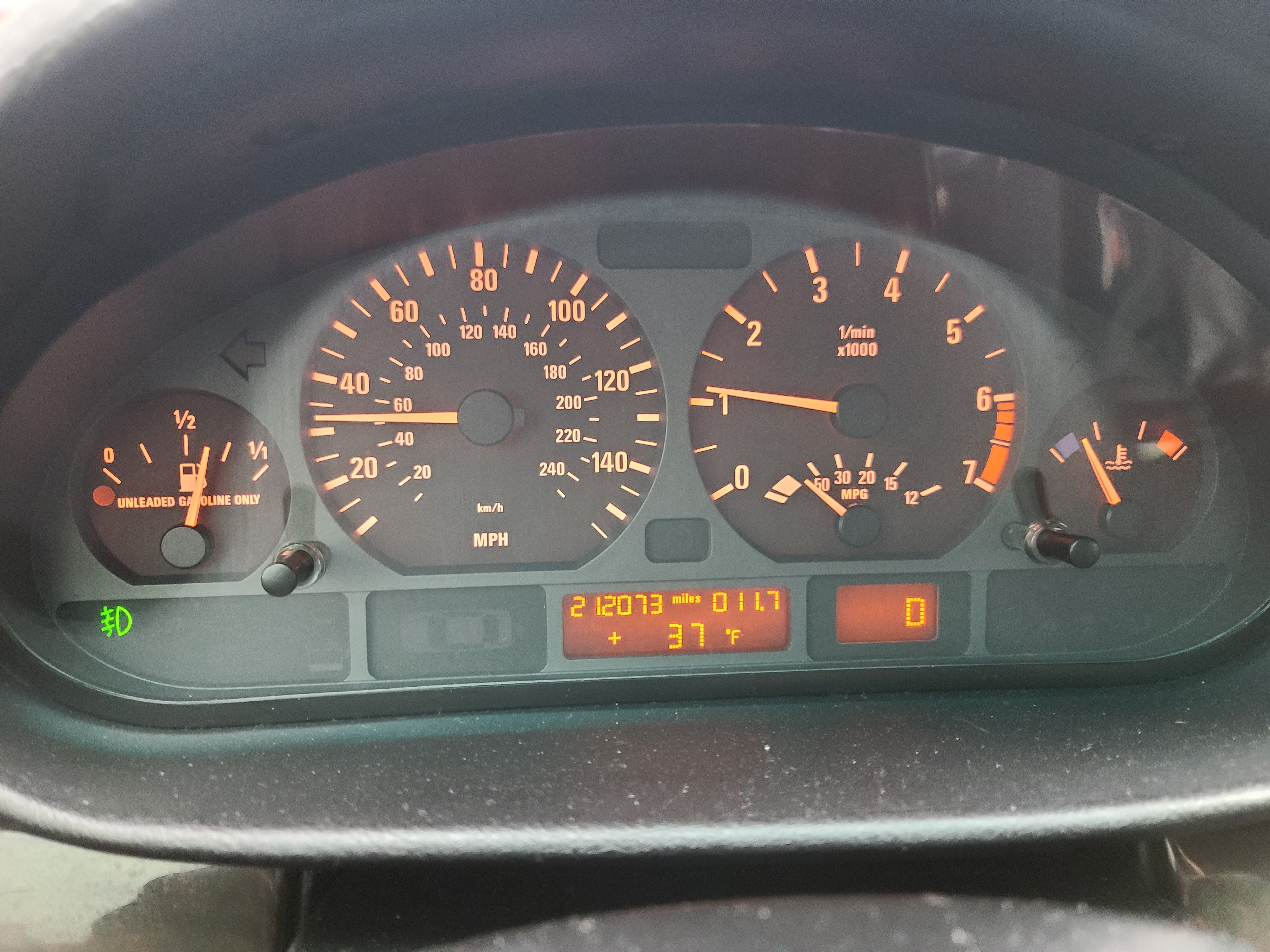

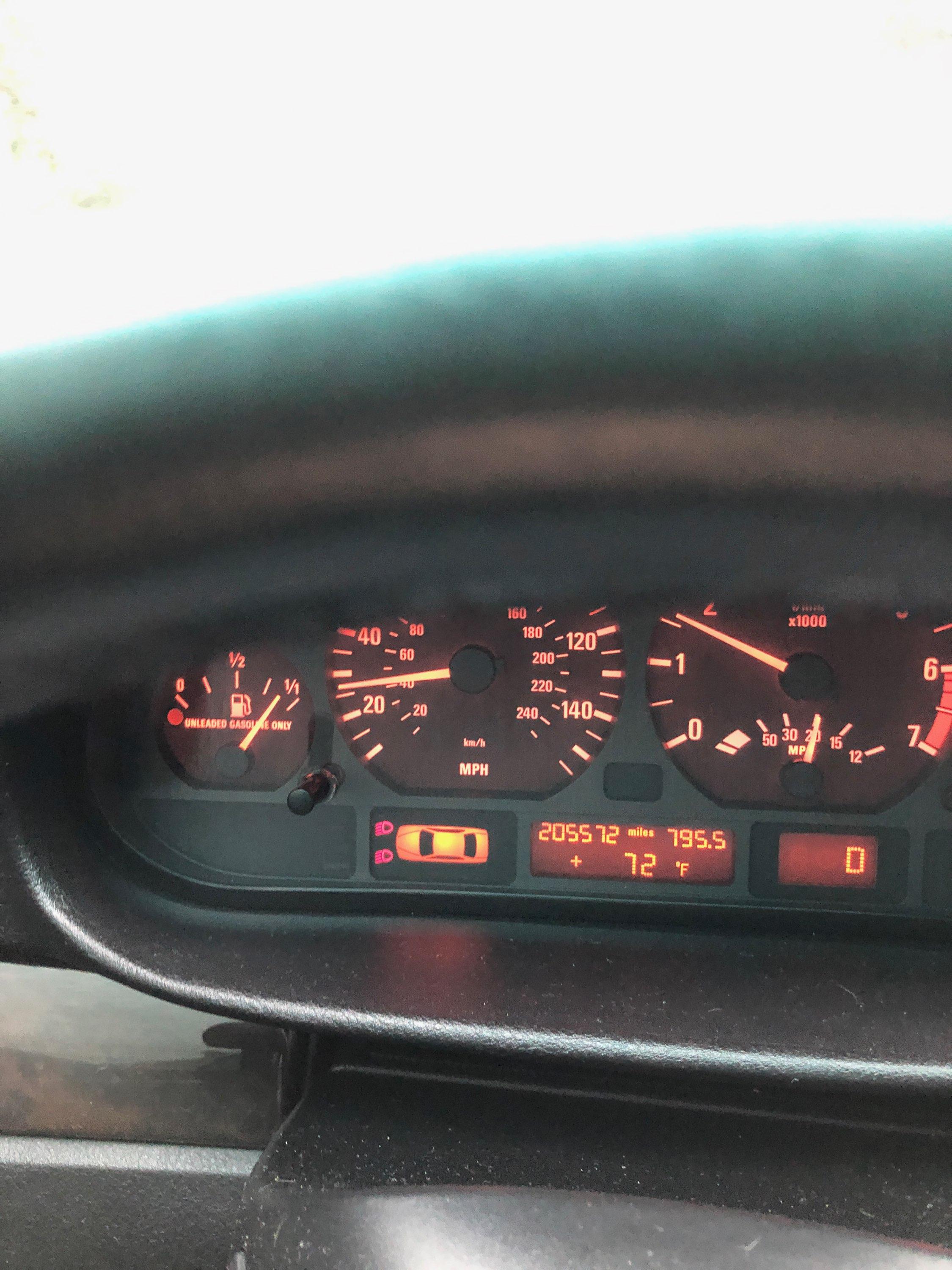

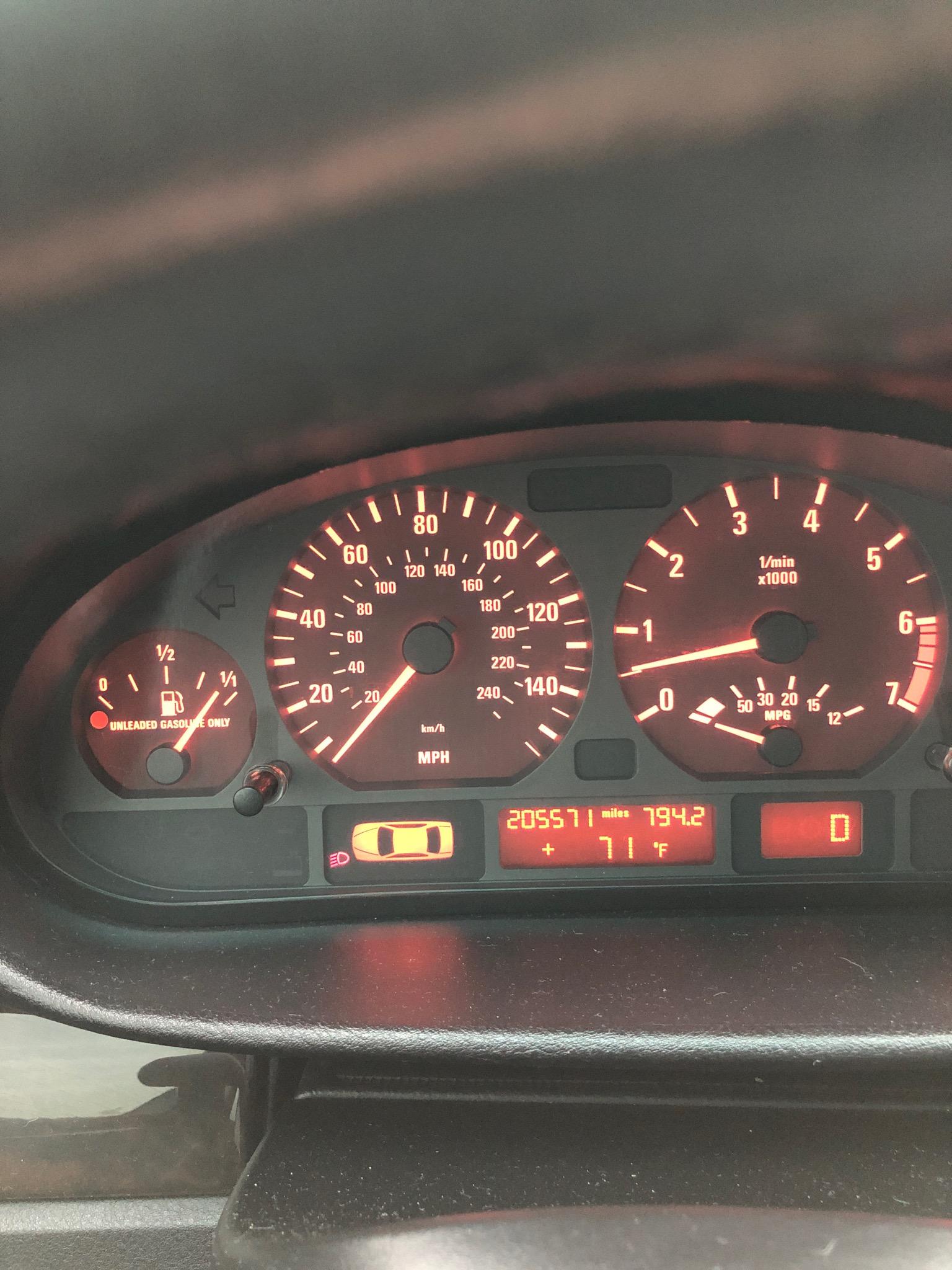

205,XXX miles:

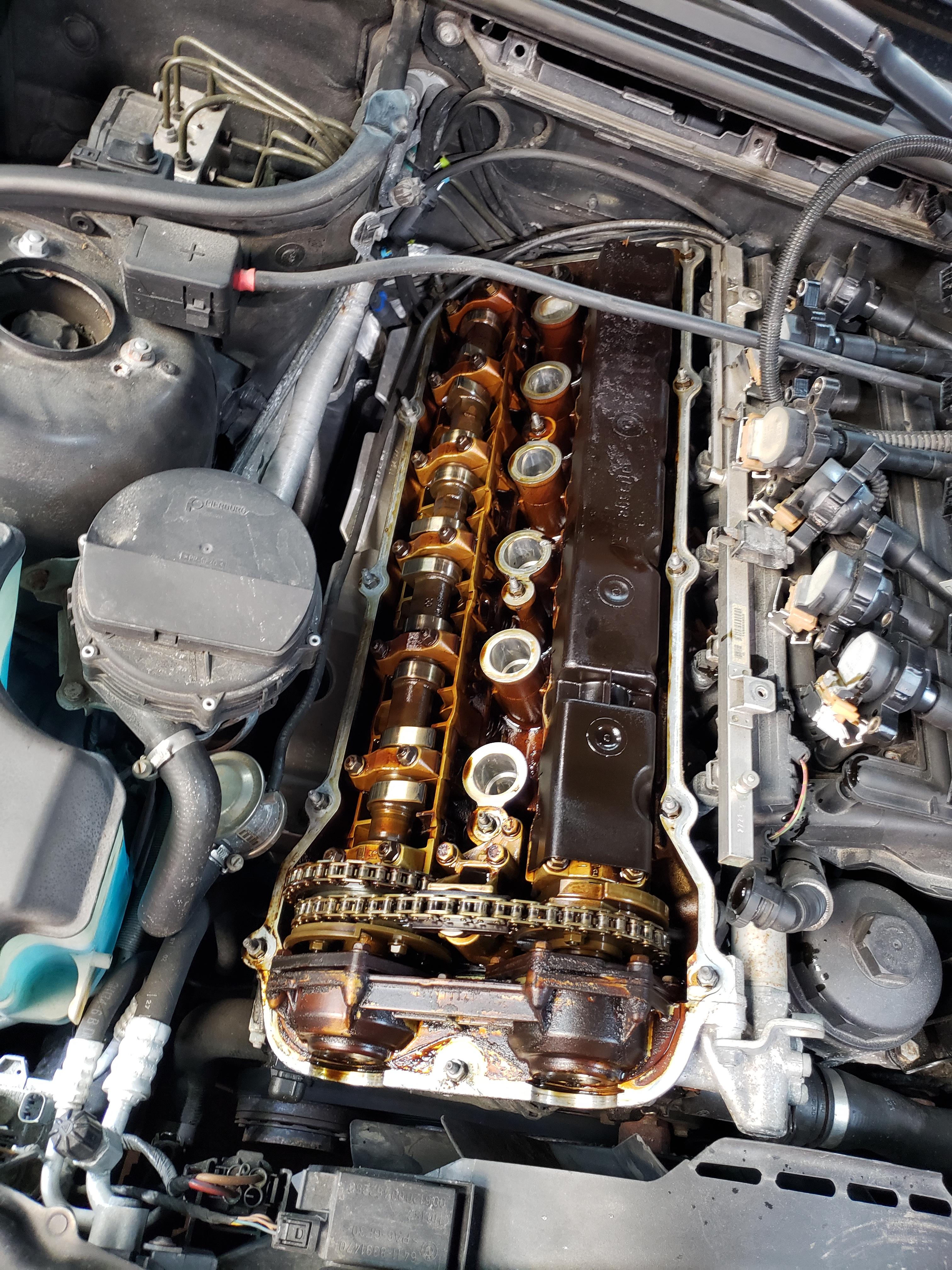

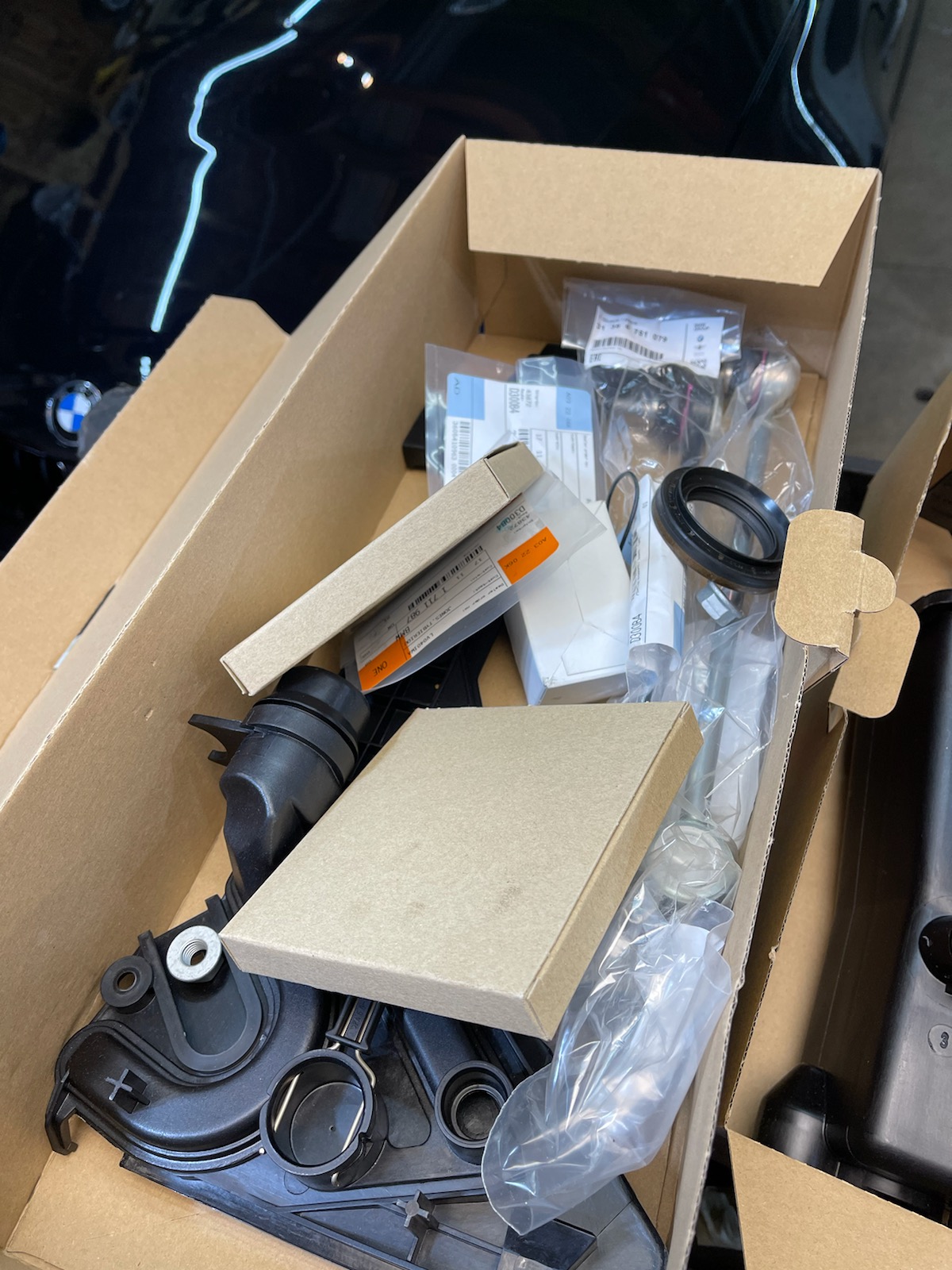

-New OEM BMW valve cover gasket. The old one wasn't bad but seeping a little on the front by the vanos.

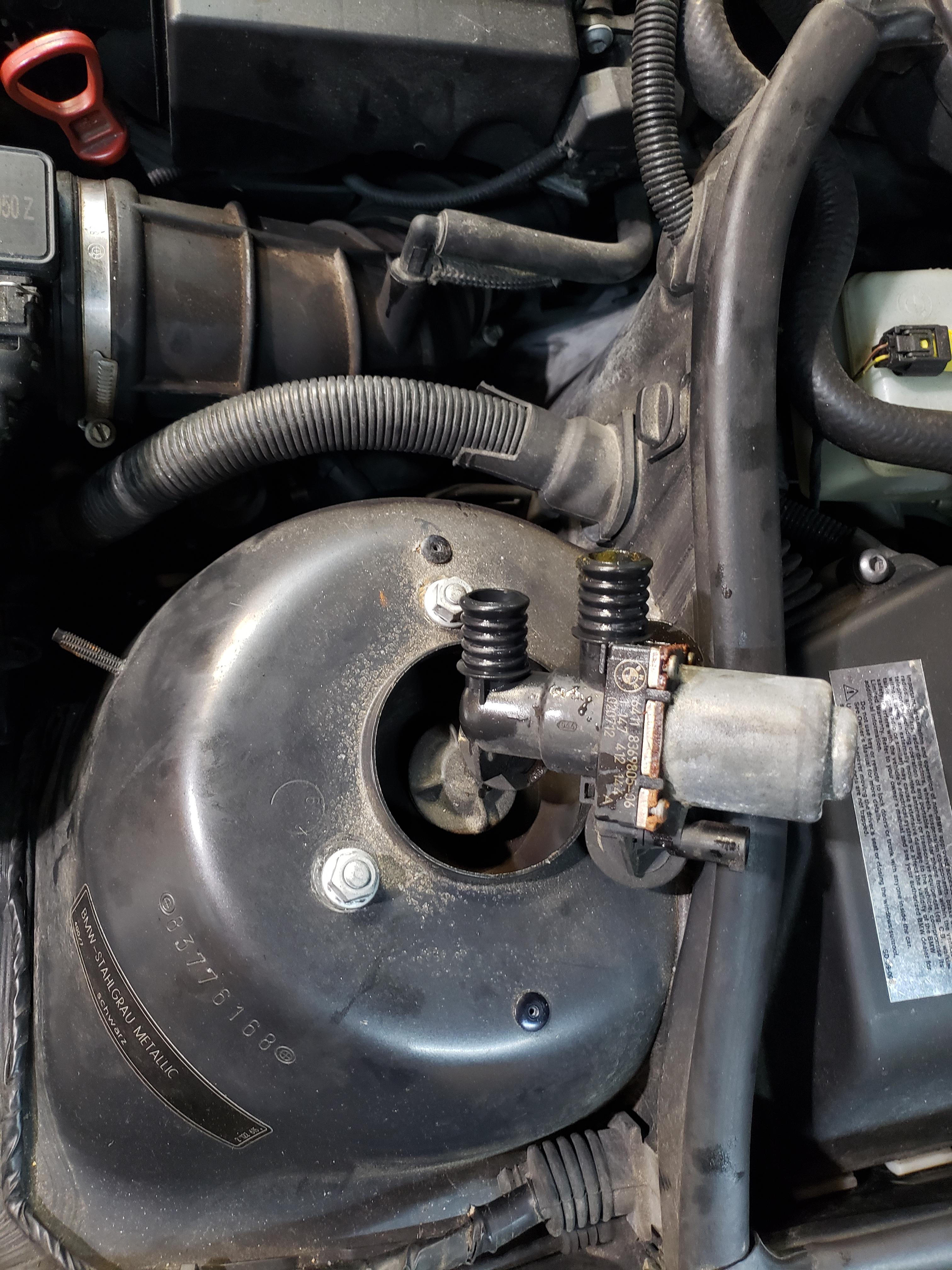

-Replaced the heater valve thingy to get the heat to work! Yay winter!

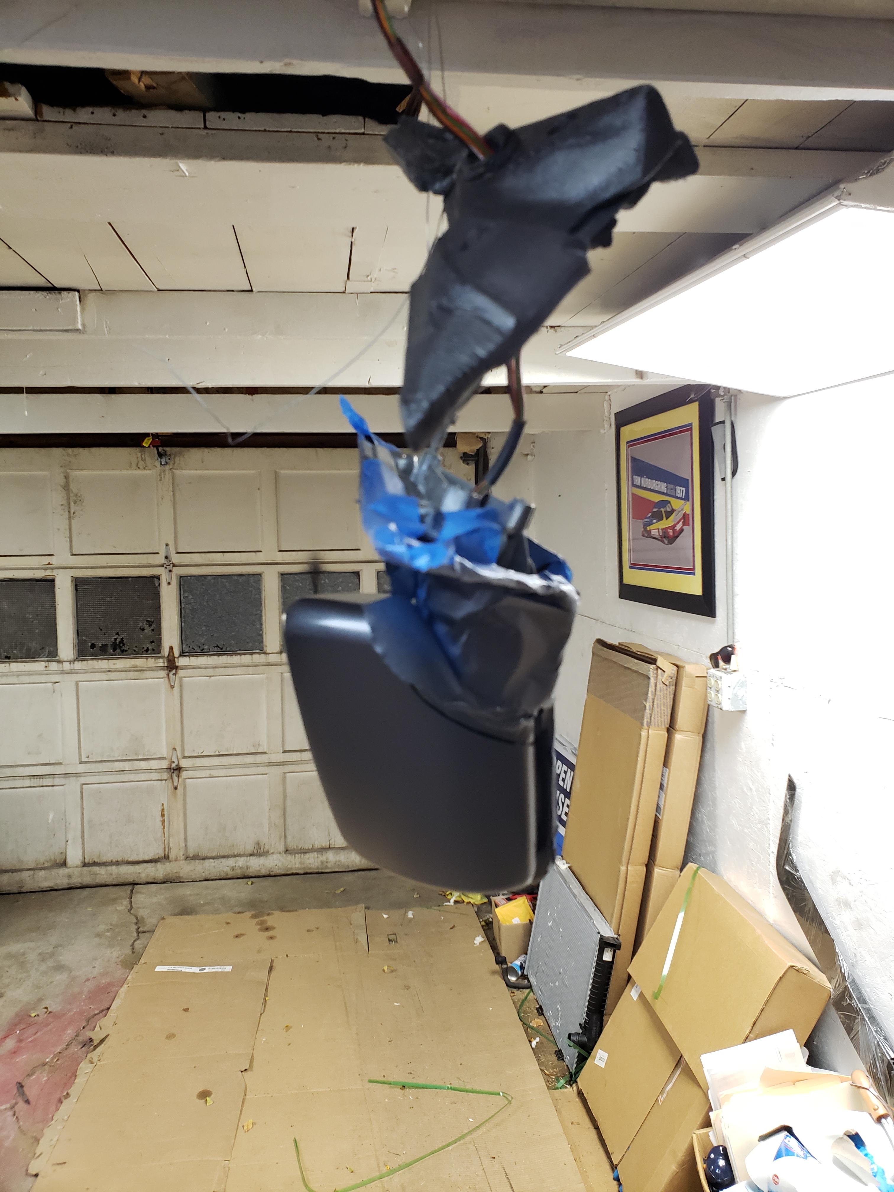

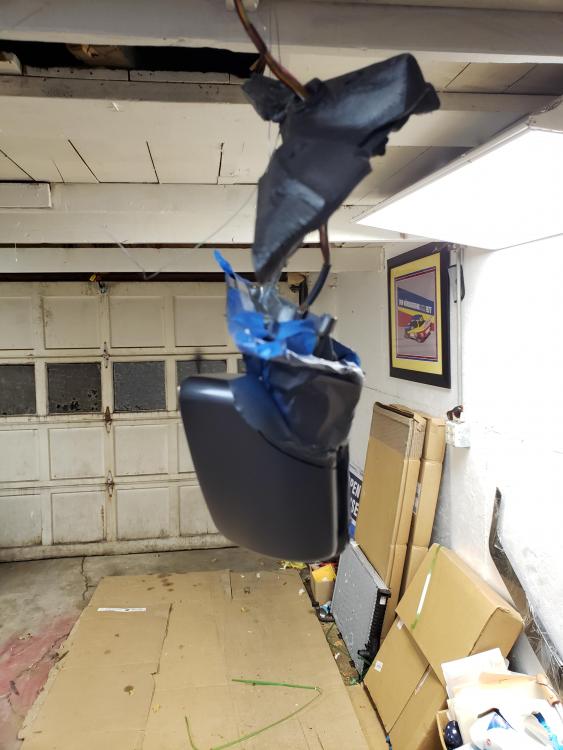

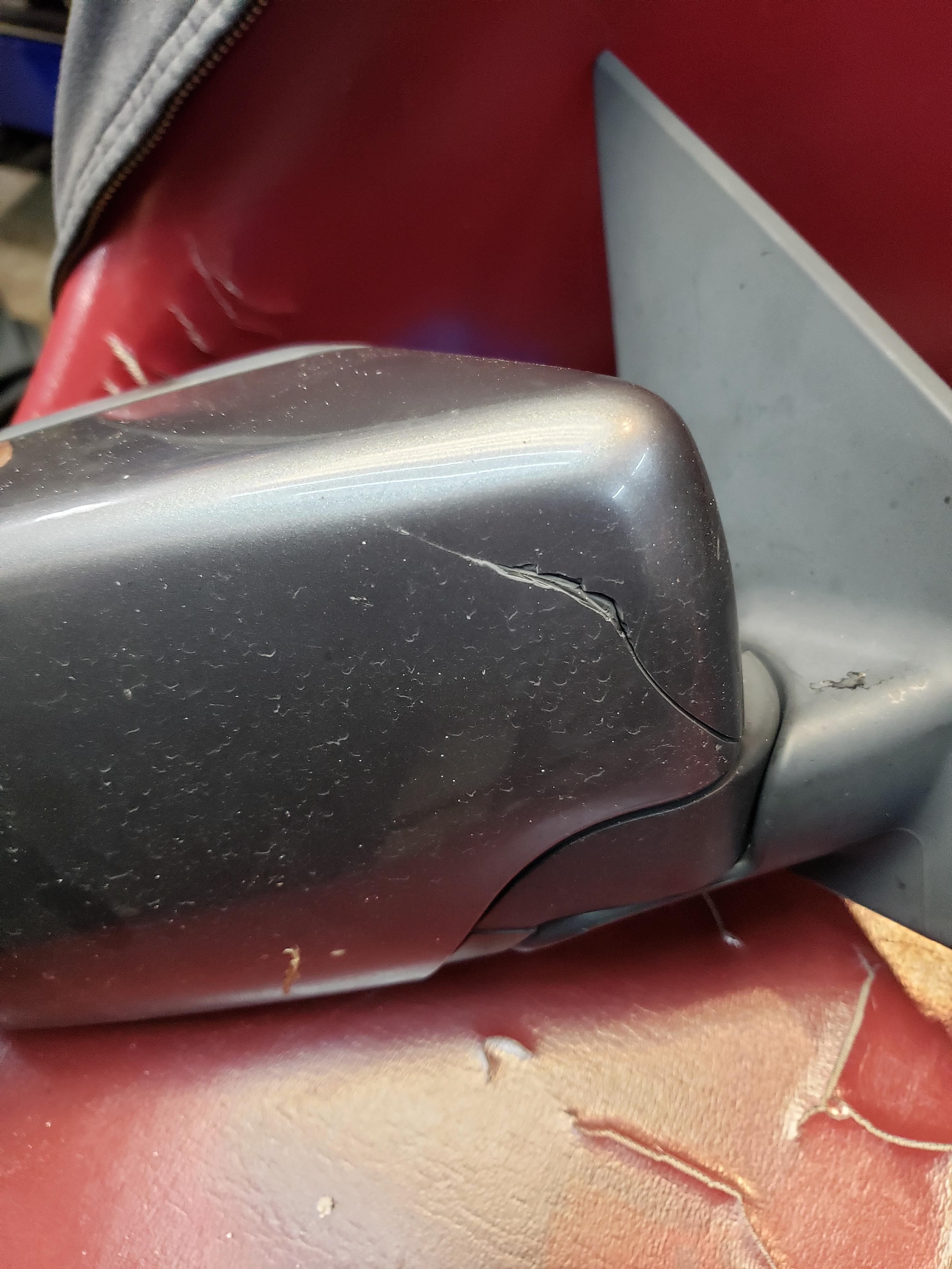

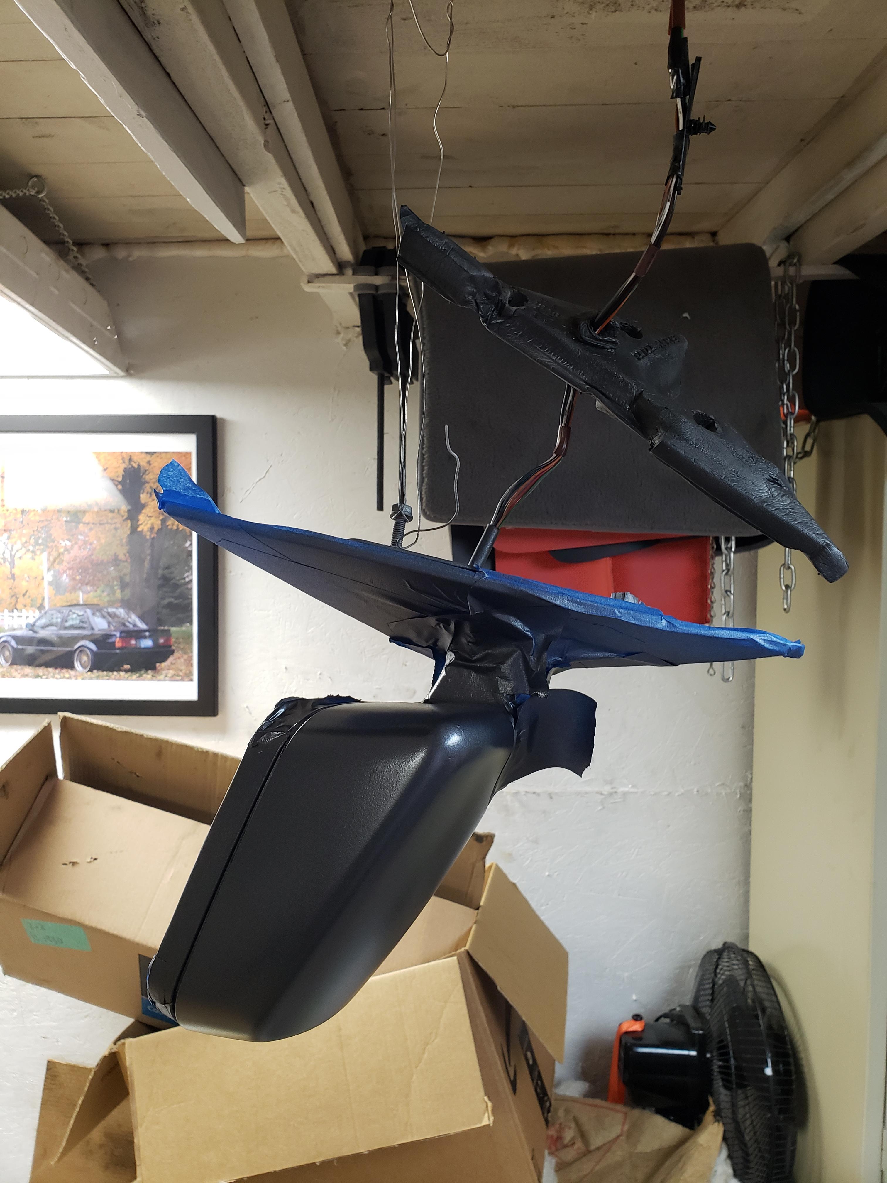

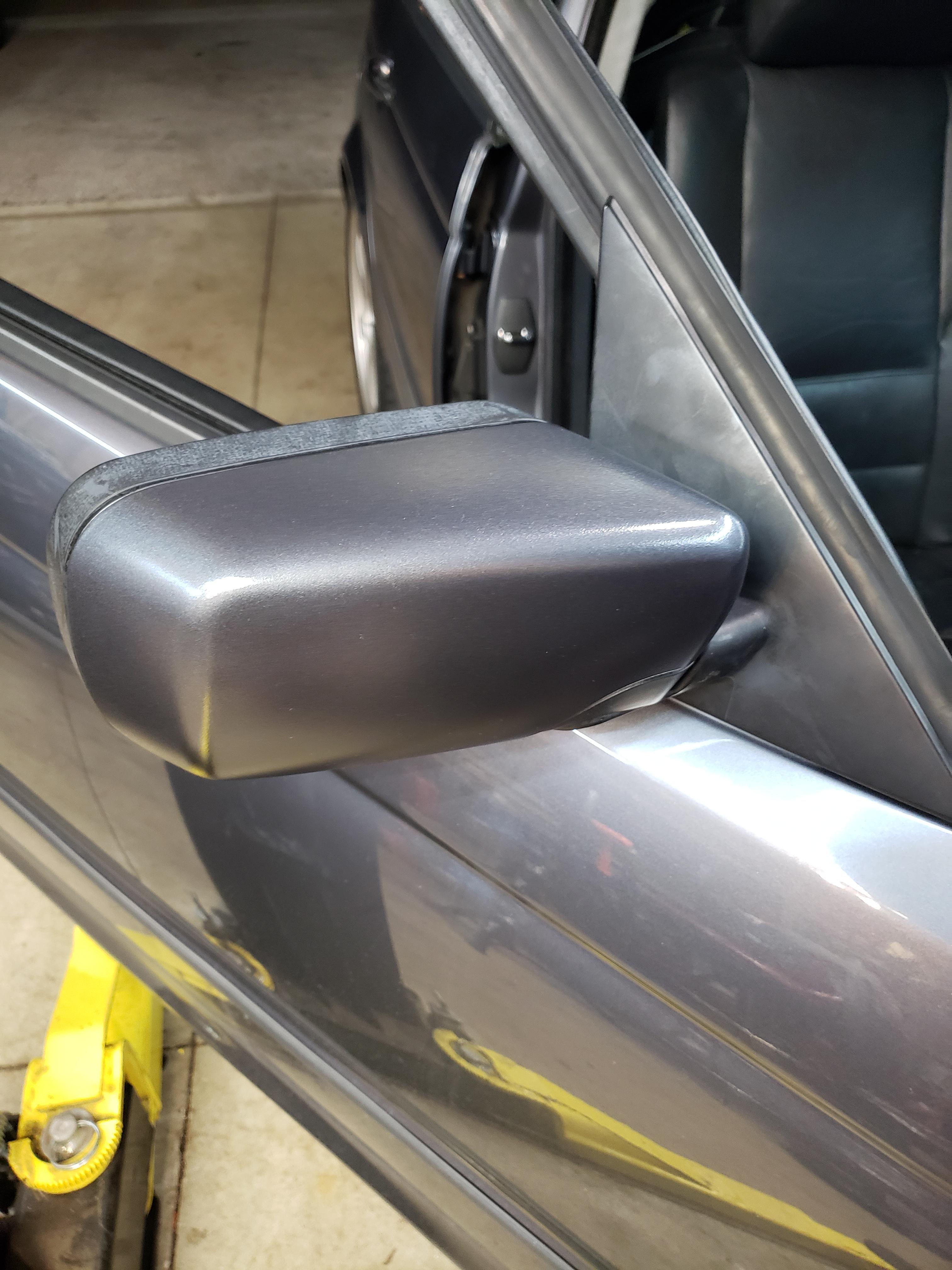

-Installed a good used condition mirror that I painted and clear coated with the Napa paint matched rattle can. Turned out okay!

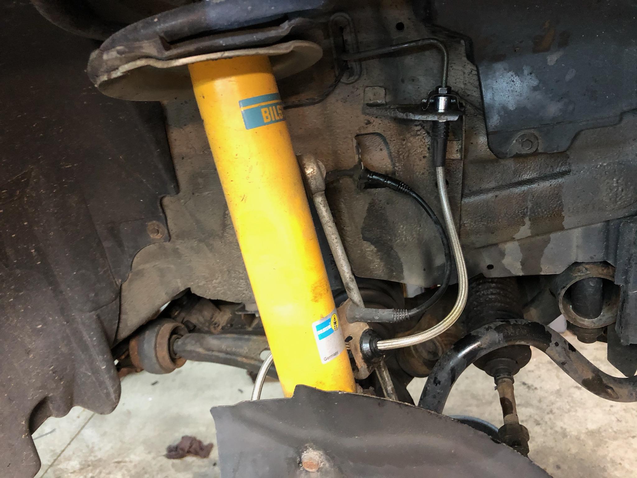

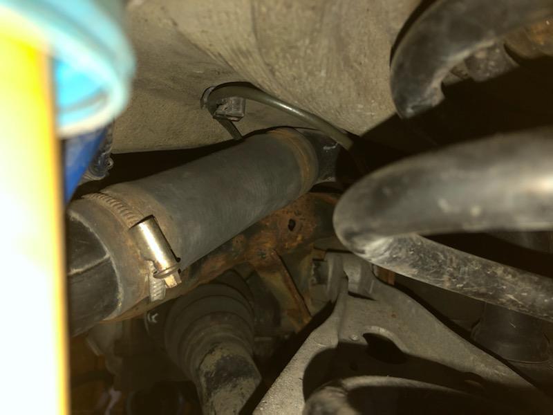

Need to get 2 new front CV boots as the ones I feel like I just replaced are leaking from the clamp cutting into the rubber. Also need to install braided brake lines and fix the airbag seatbelt tensioner to get the warning light off.

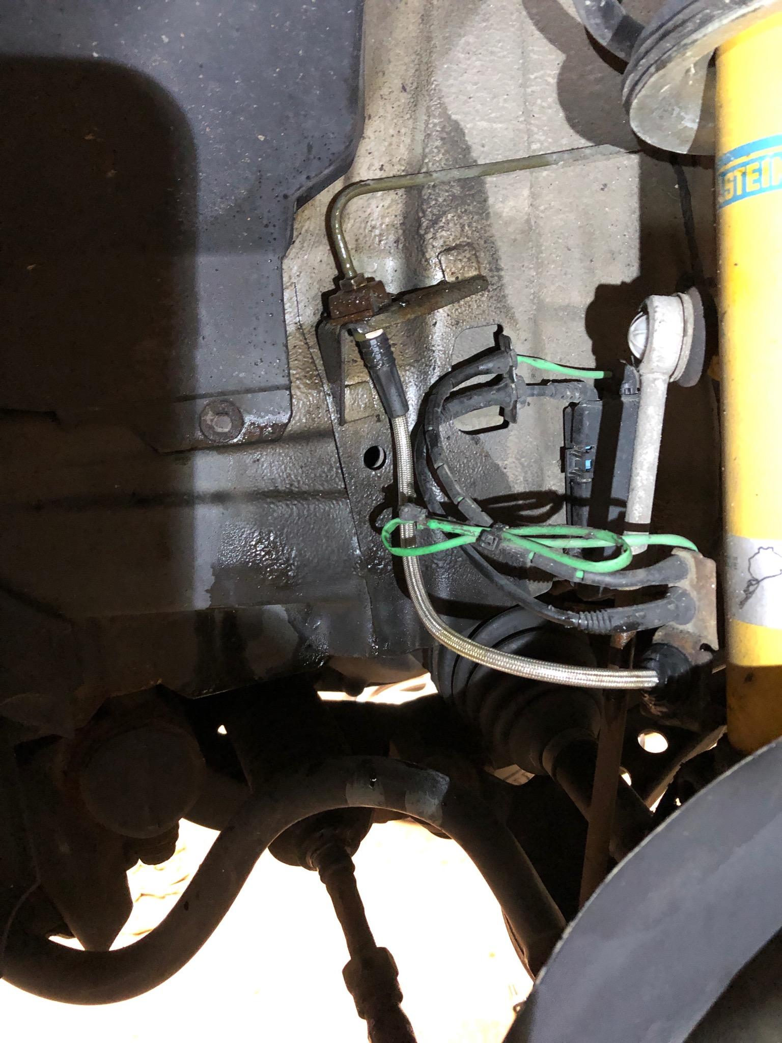

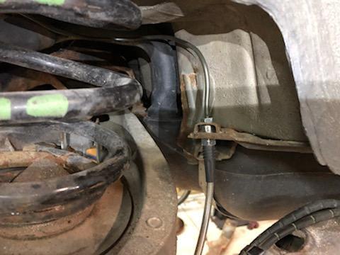

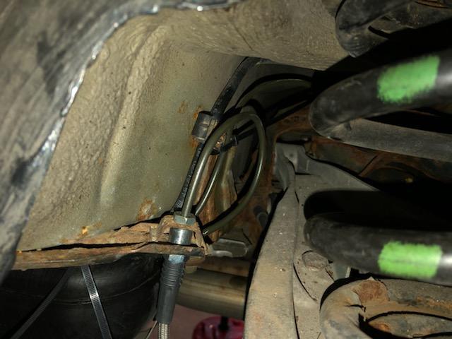

Took the "Four Door" back to Mike's to have him pop on some braided brake lines, fix the pass. side seat belt tensioner that is throwing an airbag light and install the ebrake hardware that I forgot to get. Needed the 330i shoes.

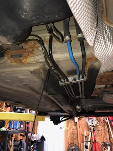

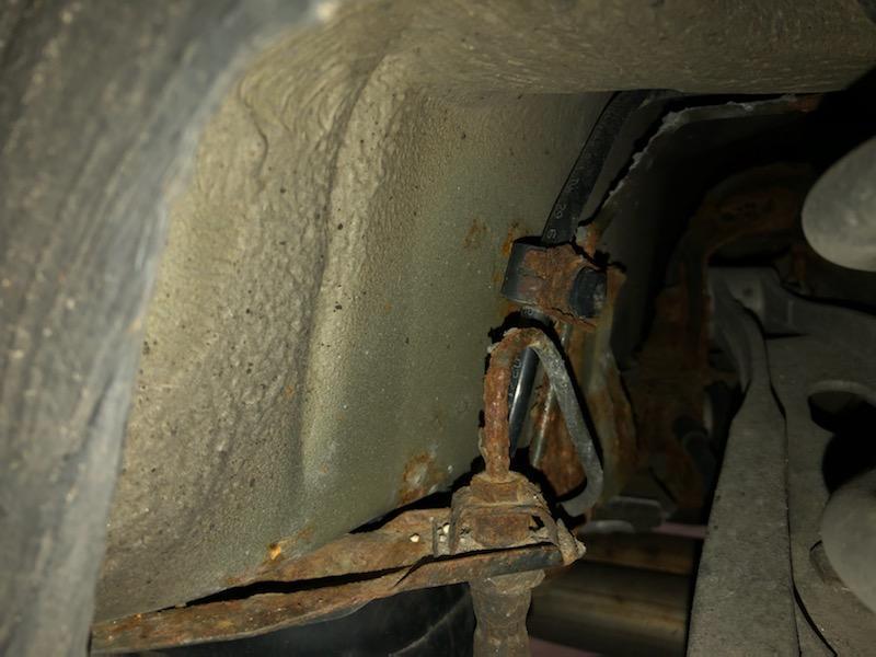

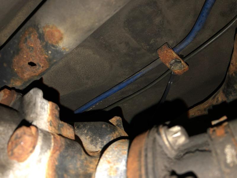

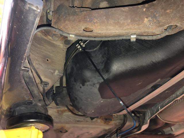

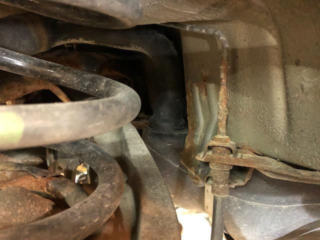

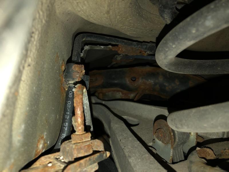

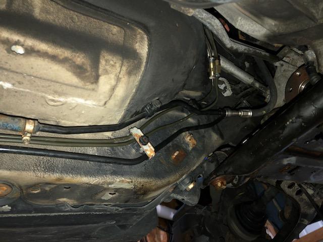

We both forgot that the hardliners for the brakes were pretty rusty. Almost all hardlines replaced! He went around the fuel tank, with my blessing, to cut the labor time in half. (The wagon will get the tank out line replacement soon!)

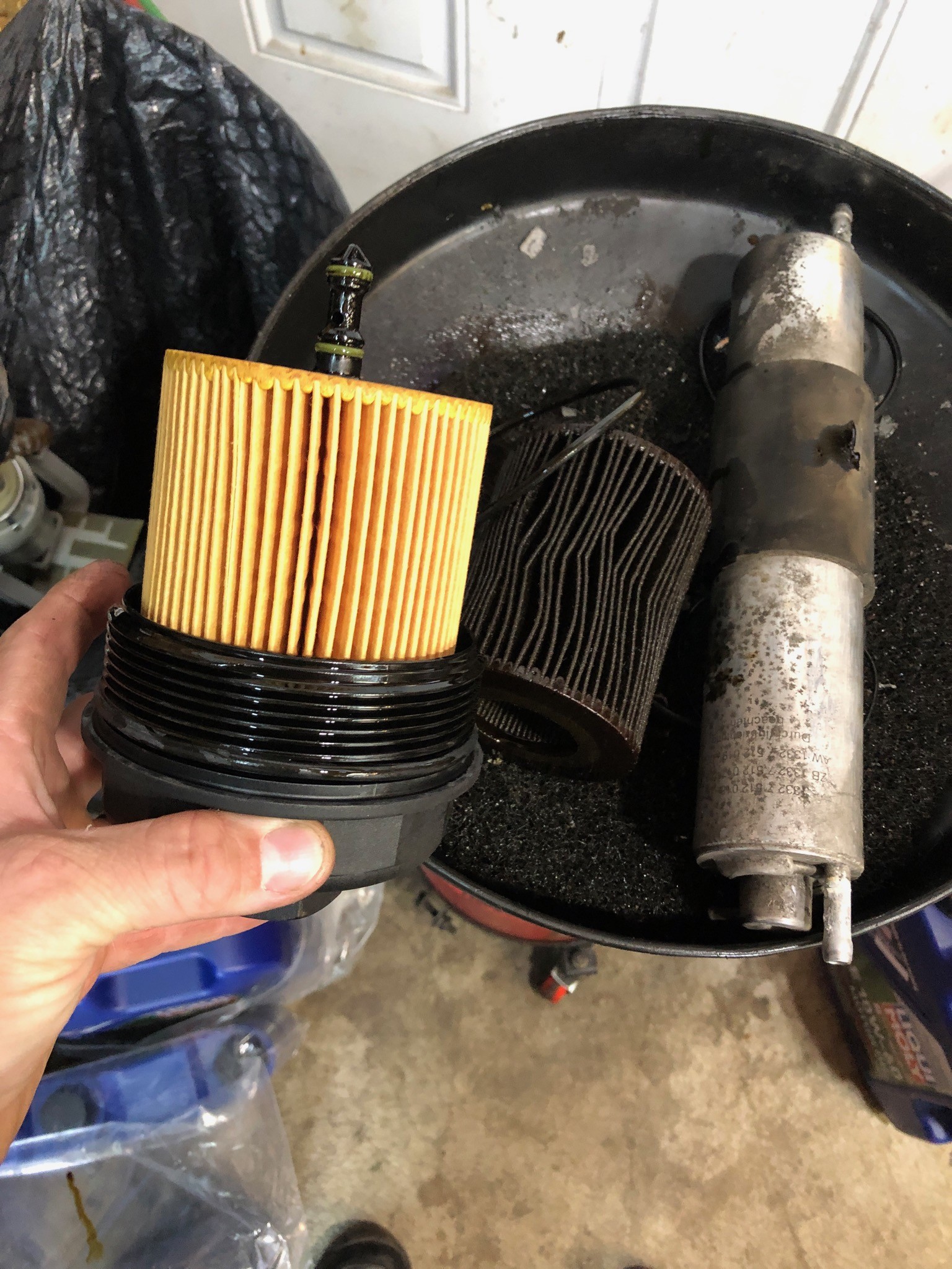

He also found the vacuum line on the fuel filter was rotted off. Better MPGs here I come!
