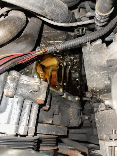

      -New OEM BMW valve cover gasket.  The old one wasn't bad but seeping a little on the front by the vanos.

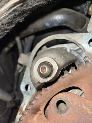

                                      The rack doctor steering rack we replaced in 2018 blew its seals and was leaking badly. Utilized their lifetime warranty and got a new one.
                                      Did an oil and filter change as well as a fuel pump; fuel filter and regulator.  Added e46 M3 RTABs also. All OEM BMW.

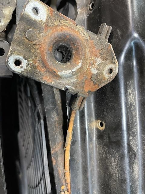

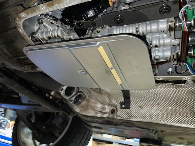

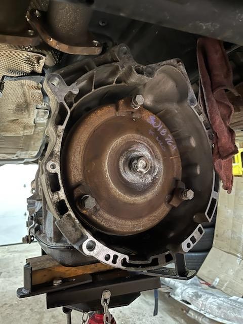

                                        Trans started slipping so got it replaced with a 94k mile trans out of a 325xi. Got the starter rebuilt, new trans filter/gasket. Tensioner & idler pullies replaced.  New oil filter housing gasket and hood latches.
                                        Mike also made the rust dissappear by the rear wheel arches.  Not bad for a napa rattle can!
                                        Now we just need some snow!
                                        All work done at 212k miles.
