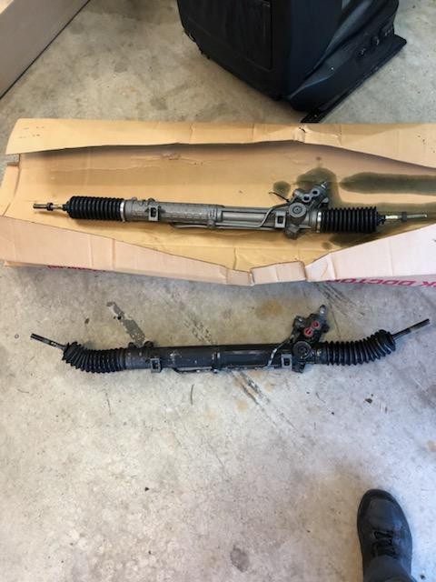

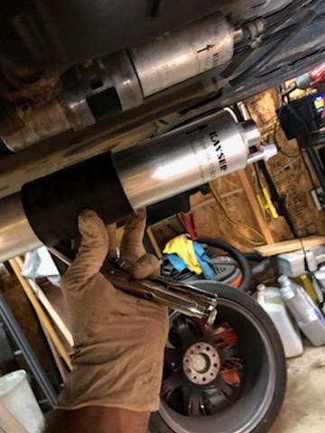

                                          #102
                                          The rack doctor steering rack we replaced in 2018 blew its seals and was leaking badly. Utilized their lifetime warranty and got a new one.
                                          Did an oil and filter change as well as a fuel pump; fuel filter and regulator.  Added e46 M3 RTABs also. All OEM BMW.
