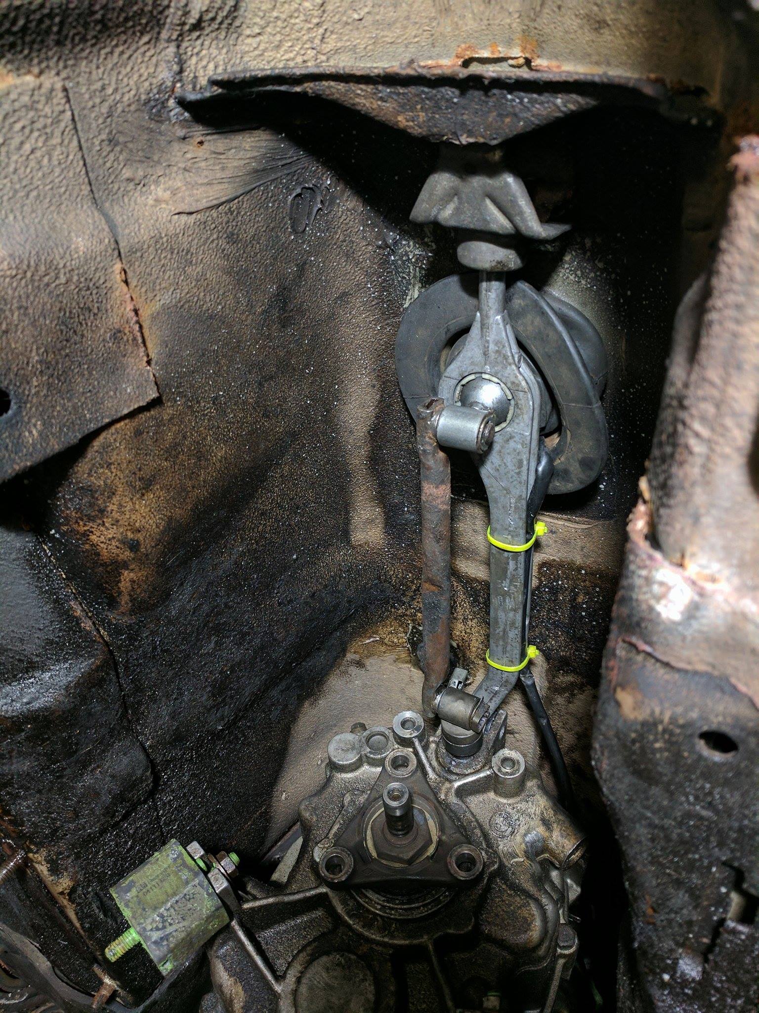

    It probably doesn't help too much because I don't have a rubber steering dampener thing. Just aluminum sleeves
    unfortunetly this was true. The rubber flex disc had crimped studs going through it. Ended up undoing the slip joint under the kneel panel and pulled it out.
    So we dropped the subframe, pulled that, then dropped the motor on the floor. Raised the car up as high as the 3ton jack went and slid the motor out from underneath with just enough clearance.

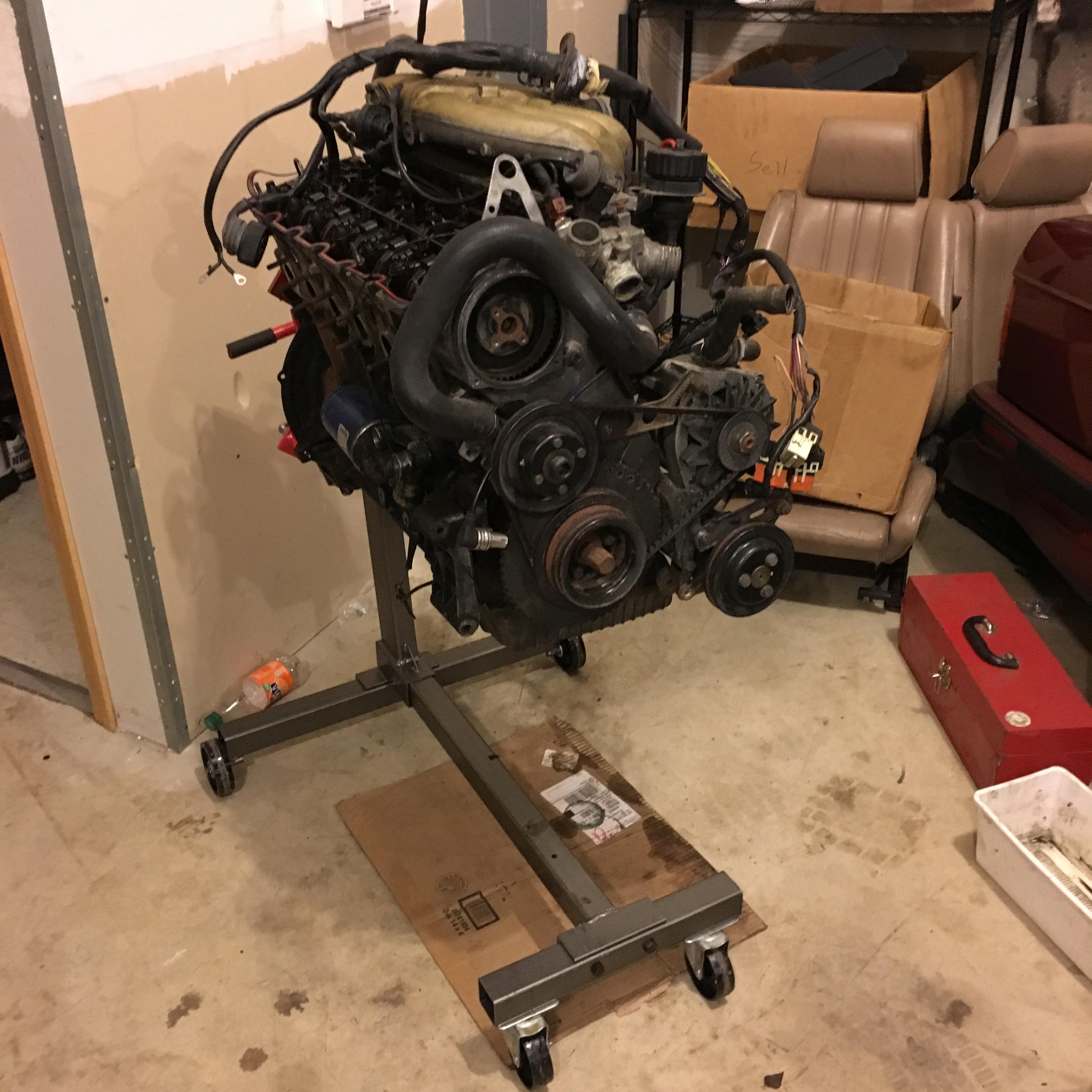

    Discconnected the trans and removed the clutch and flywheel. I've never mounted a engine on a stand before but the stock bell housing bolts weren't long enough to fit through the mounts unless I have it set up wrong. Suggestions?

      I went and bought some bolts from Ace that matched the thread pitch of the trans bolts and used those. Make sure they are rated accordingly ;)
      Edit. I was able to use 2 of my existing bolts (maybe because 24v)

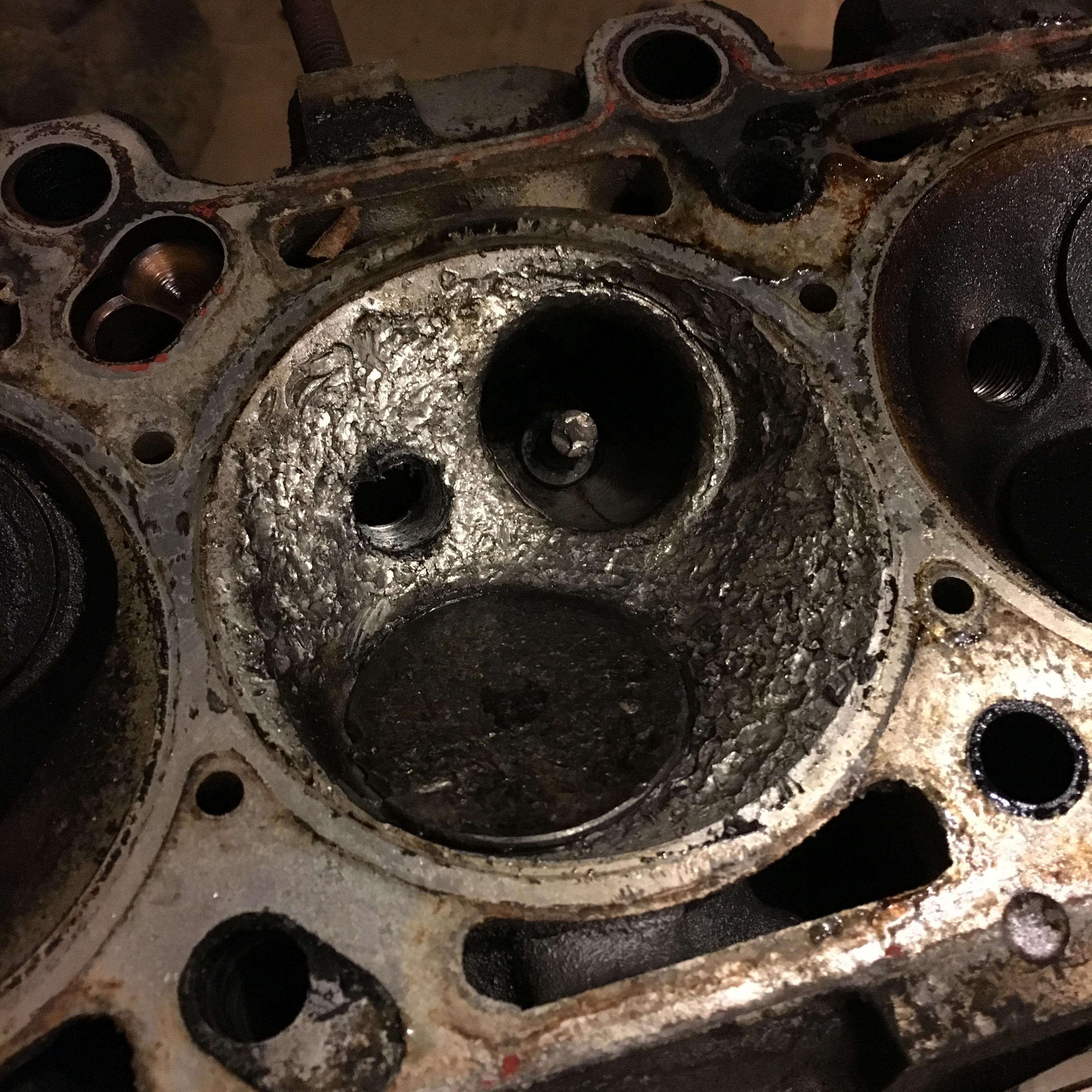

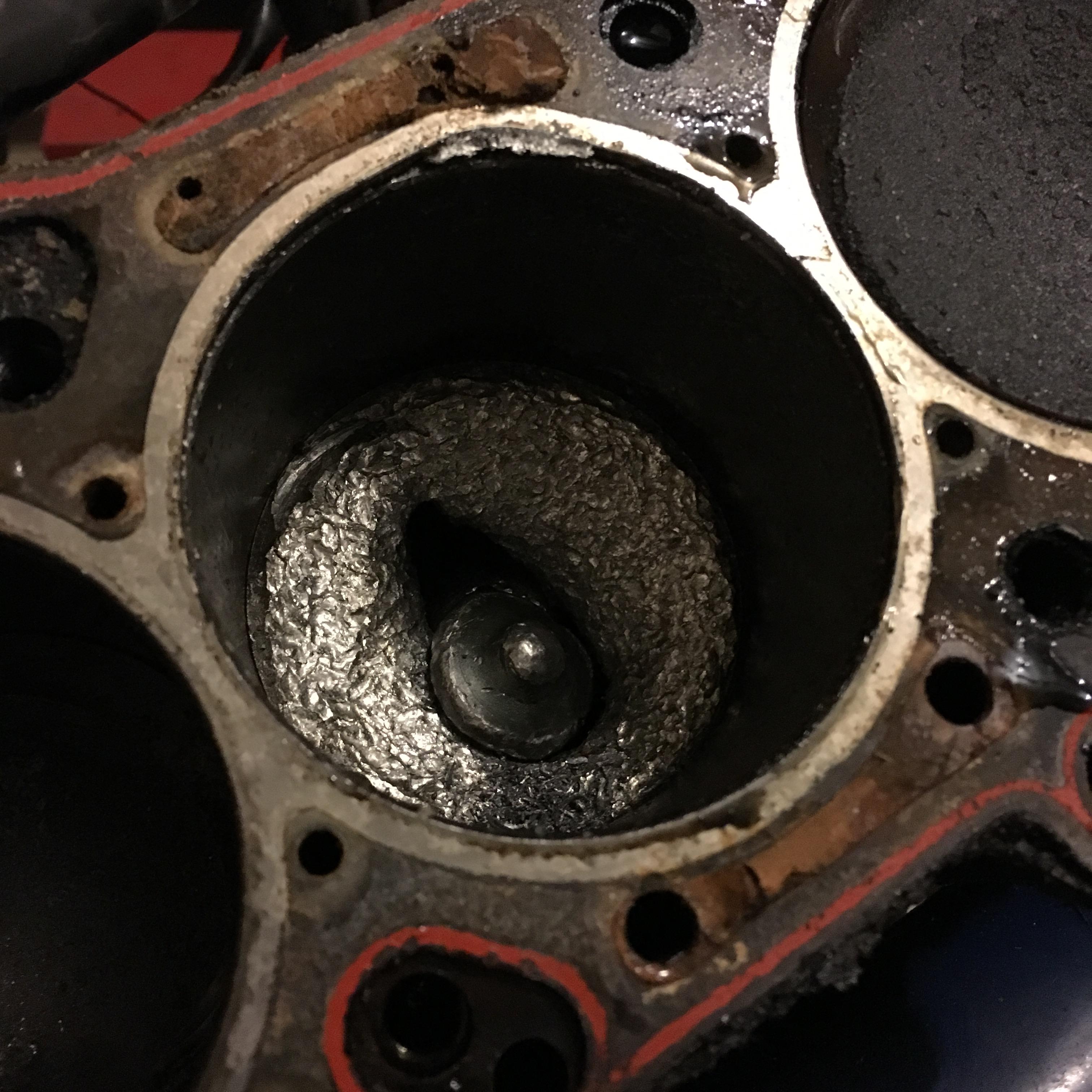

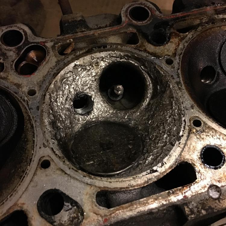

            Removed the head to find the intake valve had broke in cyl 3 as guessed.
            image.thumb.jpeg.48f11e4a99161b189d6a6ac
            Still in there! Basically a hole through the center of the piston.

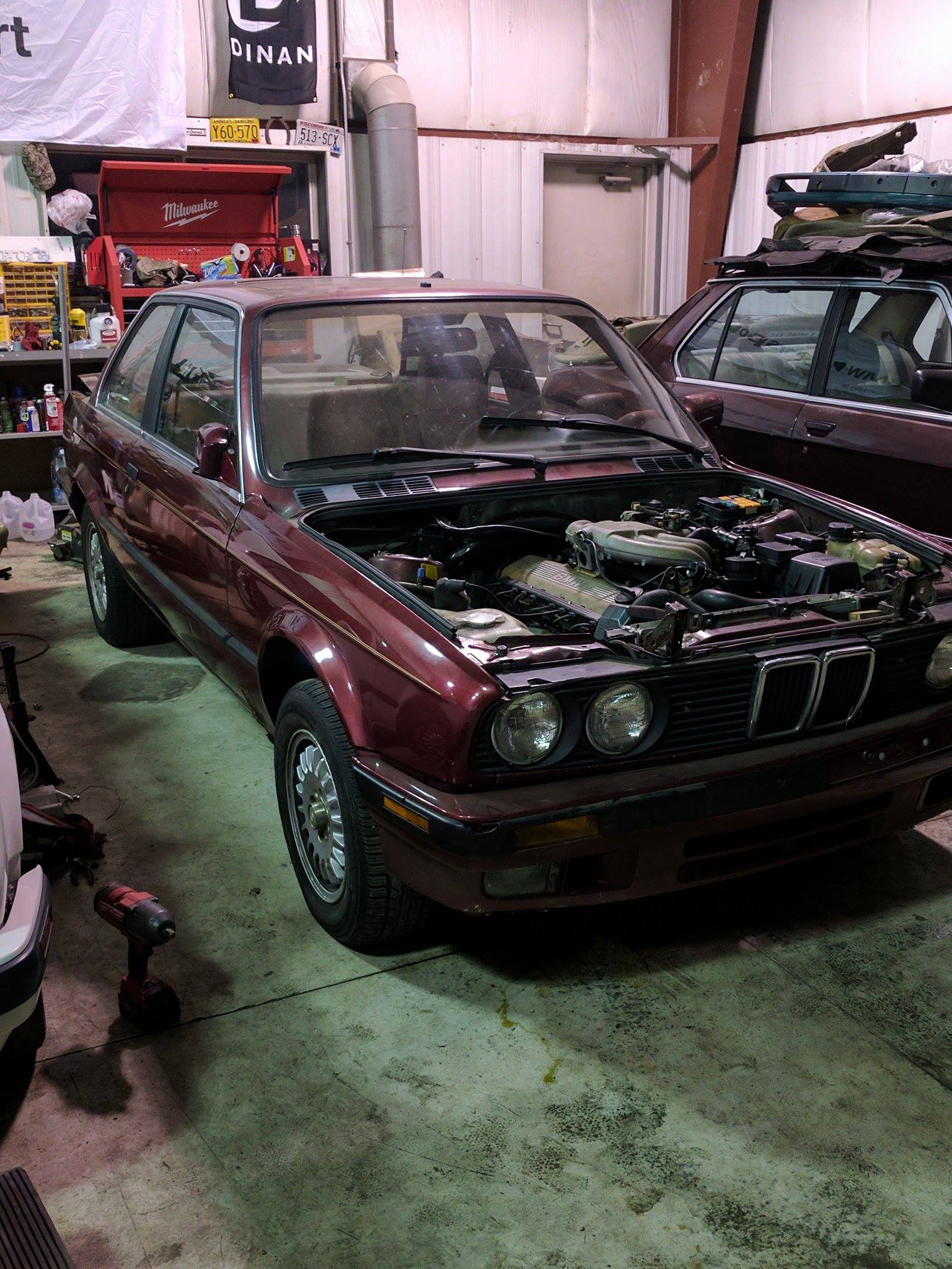

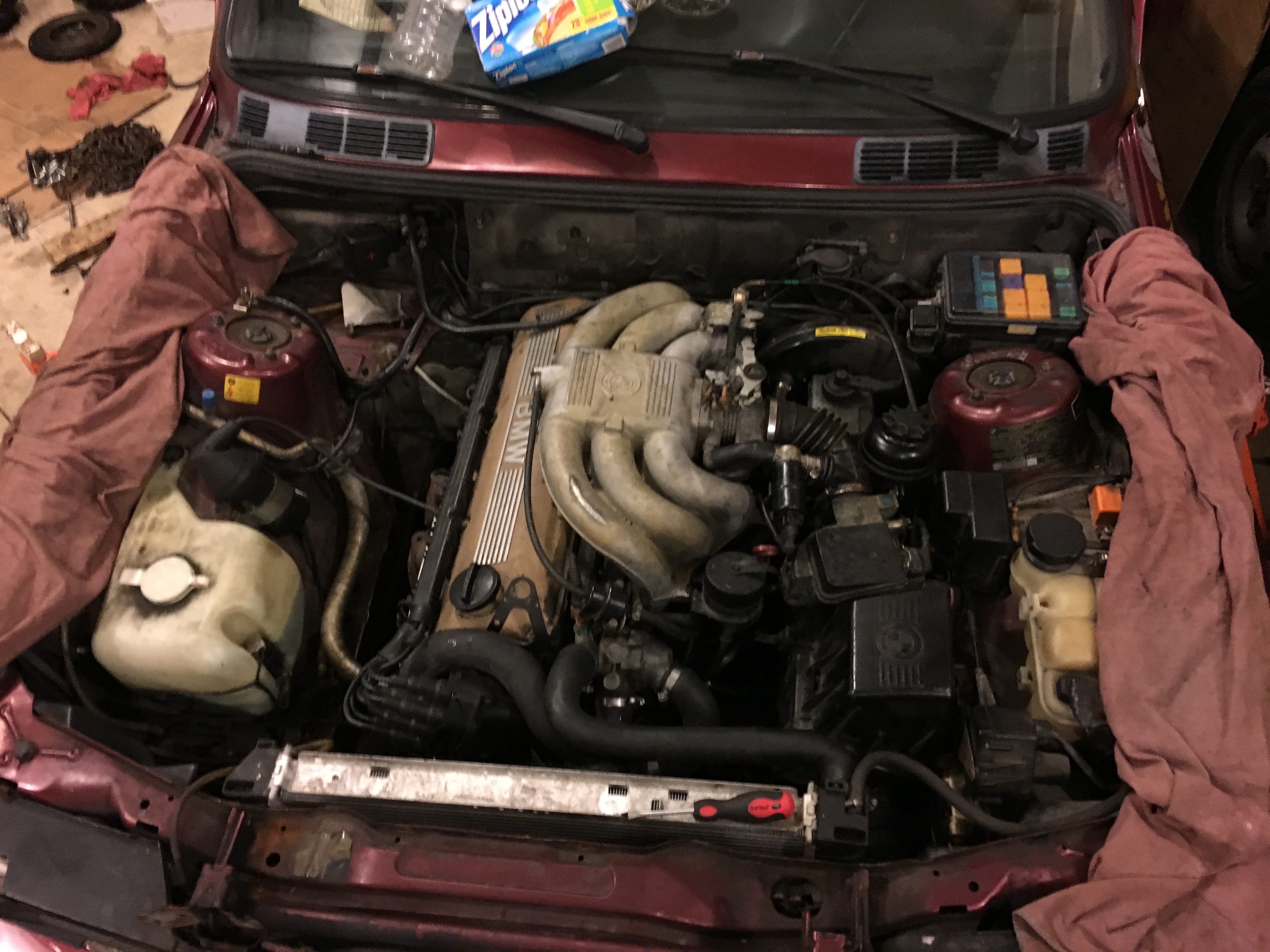

                    Update time!
                    So I'm taking a job for the summer where I'll be out of state and so we decided instead of rebuilding the car as planed that we would just put the new motor in and get the car driving instead of sitting in the shop till next winter.
                    Picked up the motor Monday afternoon and we installed it last night. Bought the motor and trans from Jdesign's vert with ~140k. It's really clean but of course leaks a little oil like any m20.
                    It was an all night affair getting the motor in as I wasn't organized as we changed directions of the build plan 180*, mostly just had to find/remember what hardware went where. Ended up doing the reverse of how we removed the old motor: slid motor/trans under, lifted, then installed front sub frame.
                    image.thumb.jpeg.3b55e71bd9b4de604070e02
                    A big thanks to Jason for getting the motor to us earlier than planned and being a huge help on installing the motor too.
                    The car cranks but no fuel at the moment, fuel pump isn't priming so next step is to diagnose that. Matt ordered a csb and garagistic 80a rear subframe bushings as the only other maintenance items needed.

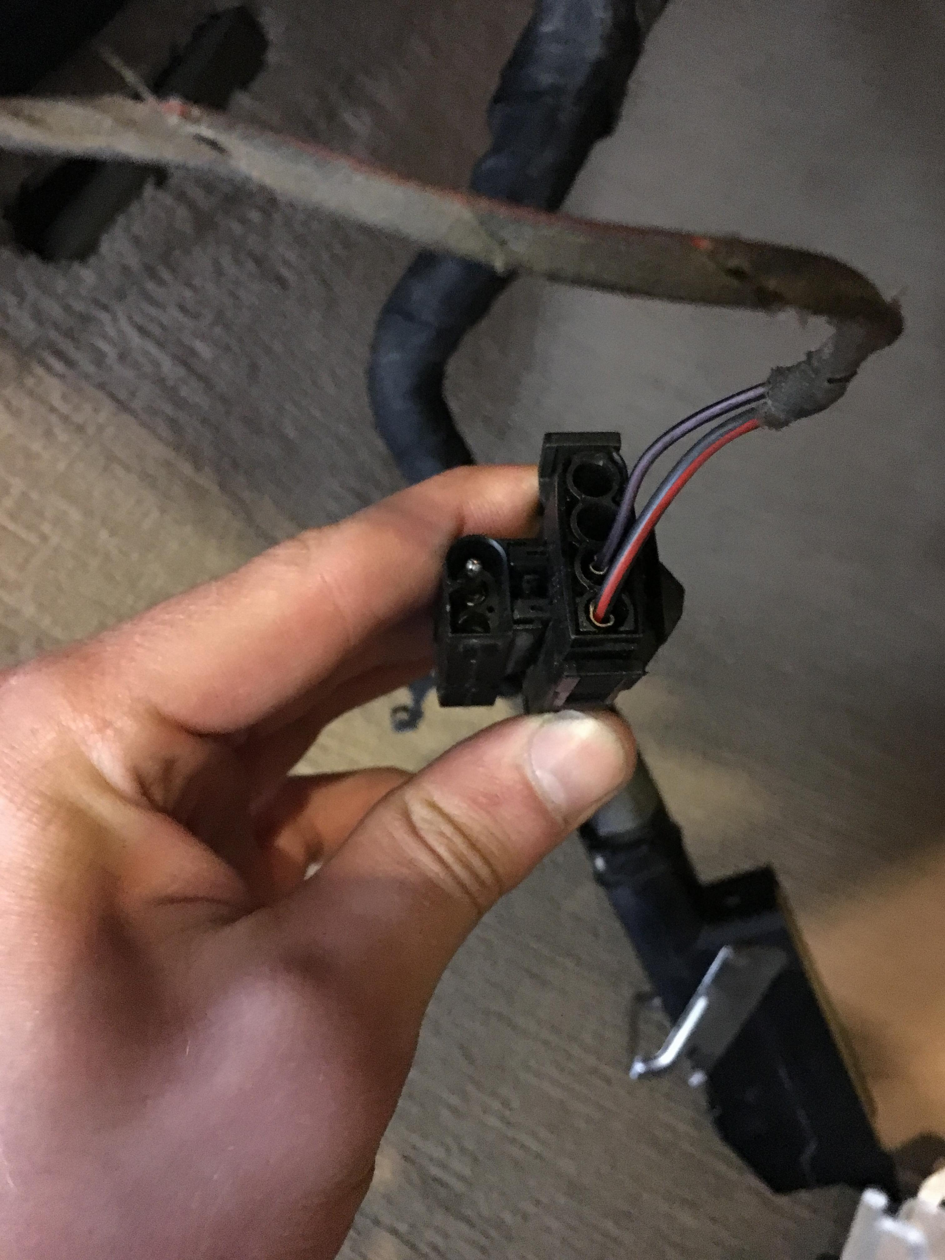

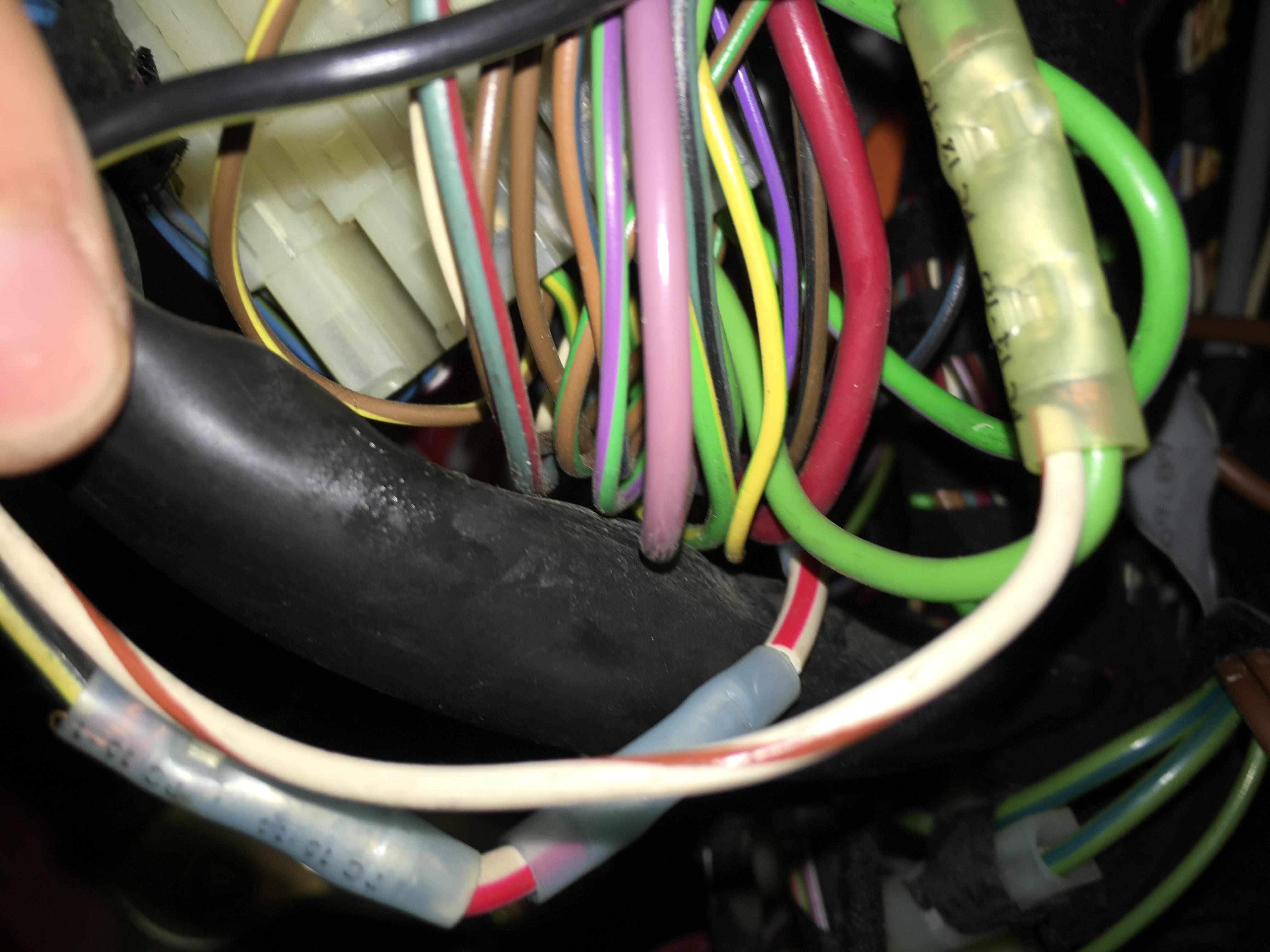

                                      Alright guys I'm stumped. Engine cranks with fuel and spark but still doesn't fire. Brand new VDO fuel pump, new temp sensors, all cyls have spark, injectors have power, fuel and main relay have power, jumping main relay turns on icv, swapped 3 dme's in with no luck.
                                      I have something wired wrong though as I can crank the car from the ignition switch but I can't from the diagnostic port.
                                      Although I didn't modify/touch these I did notice some wire hacking under the column. The black/yellow wire was spliced and reconnected twice and the green wire was spliced with a extra wire joined in but not connected to anything. Is this the green wire that goes to the coil?
                                      image.thumb.jpeg.27554d11c5a9ecc42fc3867
                                      Also the two prong connector off the engine harness by the dme is for the OBC correct? This car doesn't have a 13 button and I can't find any wire that would plug into this.
                                      image.thumb.jpeg.c6b88fa31ef286242698817
                                        #55
                                        Issue I ran into with a friends e30 was the green wire and a bad immobilizer connection. Either make sure things are plugged in or bypassed.
                                        Same symptoms: fuel, spark, good Dme, and no start.
                                        Can't tell from your pics if this is the issue. See green wire section here:
                                        http://www.e30zone.net/e30zonewiki/index.php/Engines_Troubleshoot
                                          #56
                                          Yes, those connectors go to the obc.
                                          Its very strange that there is fuel and spark yet no start.
                                          Is the idle control valve working/buzzing? With the ignition on?
                                          Can you hear the injectors firing while cranking ?(rubber hose as a stethoscope works here)
                                          Can you do a stomp test ?(as a quick easy check of the functionality of the TPS)
                                          Its not uncommon to mix up the TPS and ICV connectors as well as the cylinder ID and crank sensor connectors under the diagnostic connector.
                                          Was this car originally an automatic? And does it have any aftermarket alarm system?
