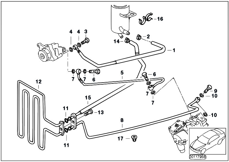

                              I'm a little confused on the power steering routing...
                              Basically the routing for me will be:
                              reservoire -> power steering pump  -> rack  -> cooler -> reservoire
                              The smaller bolt on the E30 power steering rack. Is this the pressurized fluid going in or the fluid coming out?
                              Excursion 7.3
                              E30 LS1
                                #215
                                your routing is correct. not sure if you really need the cooler, though, not all e30s had them. its not particularly hot around here...
                                from realoem, it looks like
                                M16 (larger) banjo bolt is on the supply line from the res to the pump
                                M14 (smaller) banjo bolt (both ends)  goes from the pump to the rack
                                then
                                M16 (larger) banjo bolt returns from the rack to the res. with the cooler in there for cars that came with it.

                                  Well I don't NEED the cooler, but the return end of the reservoir has a fitting that goes directly into the cooler so its free to have one and it would cost me to not so I figured why not.

                                    I found the in vs out on the reservoir and I think I have it figured out now. I may have to get some high pressure banjo lines made (any suggestions on where?)
                                    This shows the cooler ends I was referring to:
