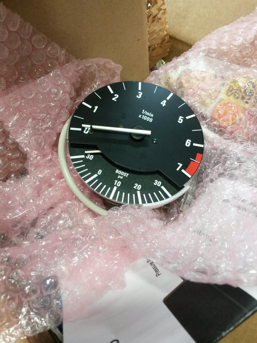

                                        Still haven't decided what to do about the head, but this came in the mail on Saturday. I freaking love it.
                                        post-3378-0-09254700-1431365461thumb.jp
                                          #106
                                          Awesome. This is the new mod E28 guys are doing. Not sure if this could be worked into a e30 cluster too.
                                          http://www.mye28.com/viewtopic.php?p=1308304
