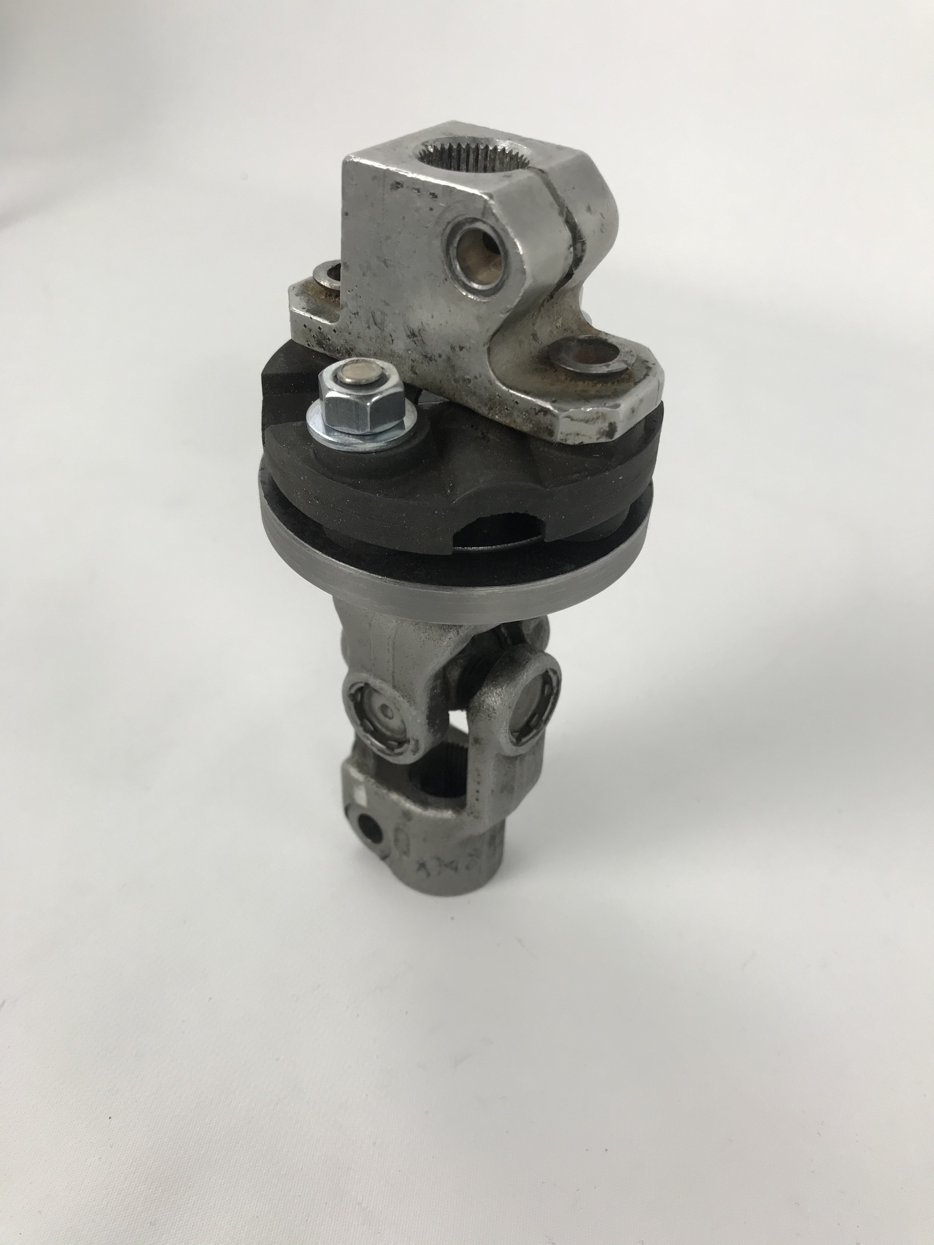

Here is a close up of the two couplers. As you will notice that the one is aluminum and one is steel. Because of this I can not simply just weld the correct ends together.

Flaming river makes a dampening universal joint but they are not cheap. I have to make sure they have it available in the correct splines/dia for my application and I won't need to make any custom parts. They look like this:

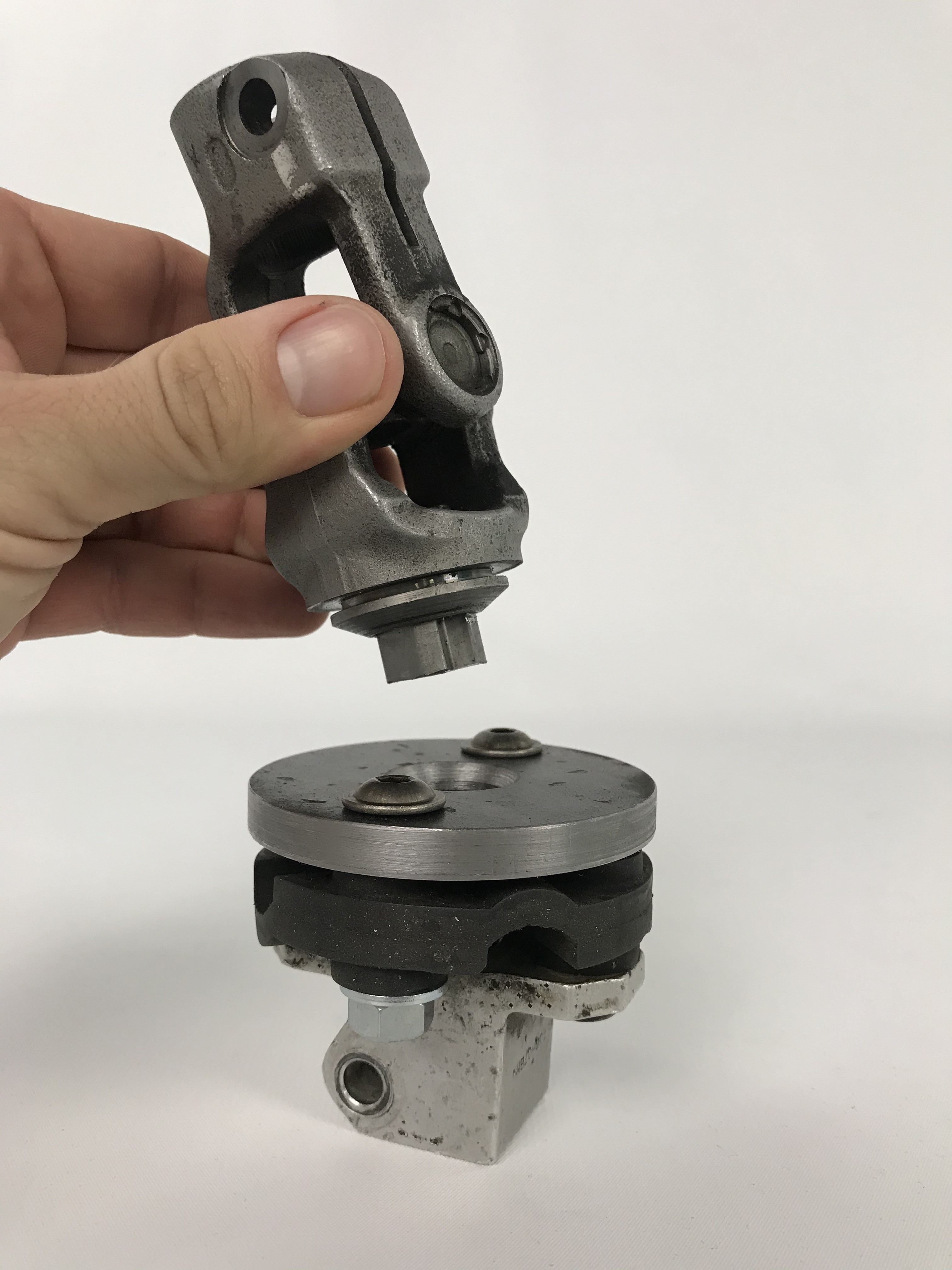

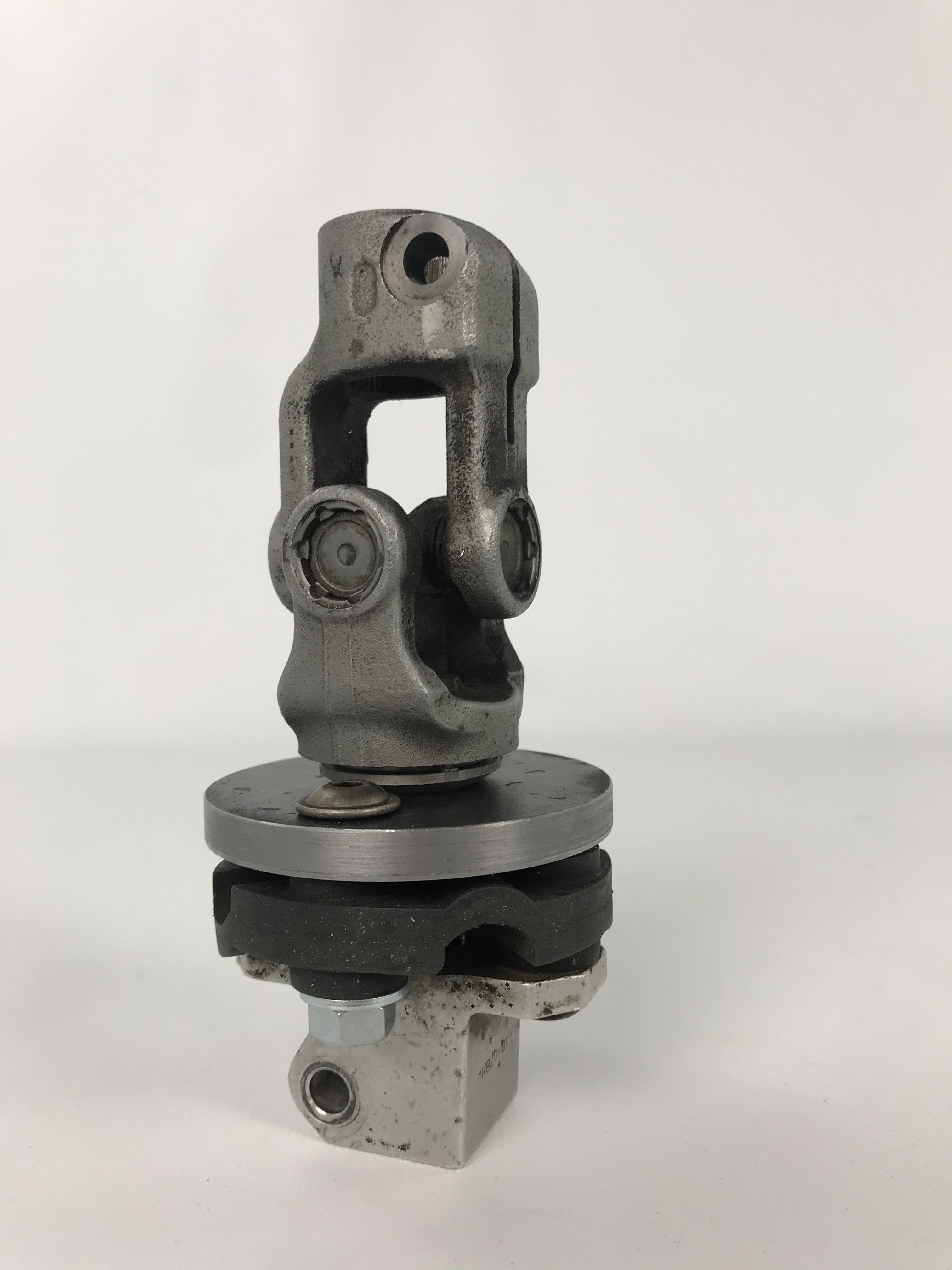

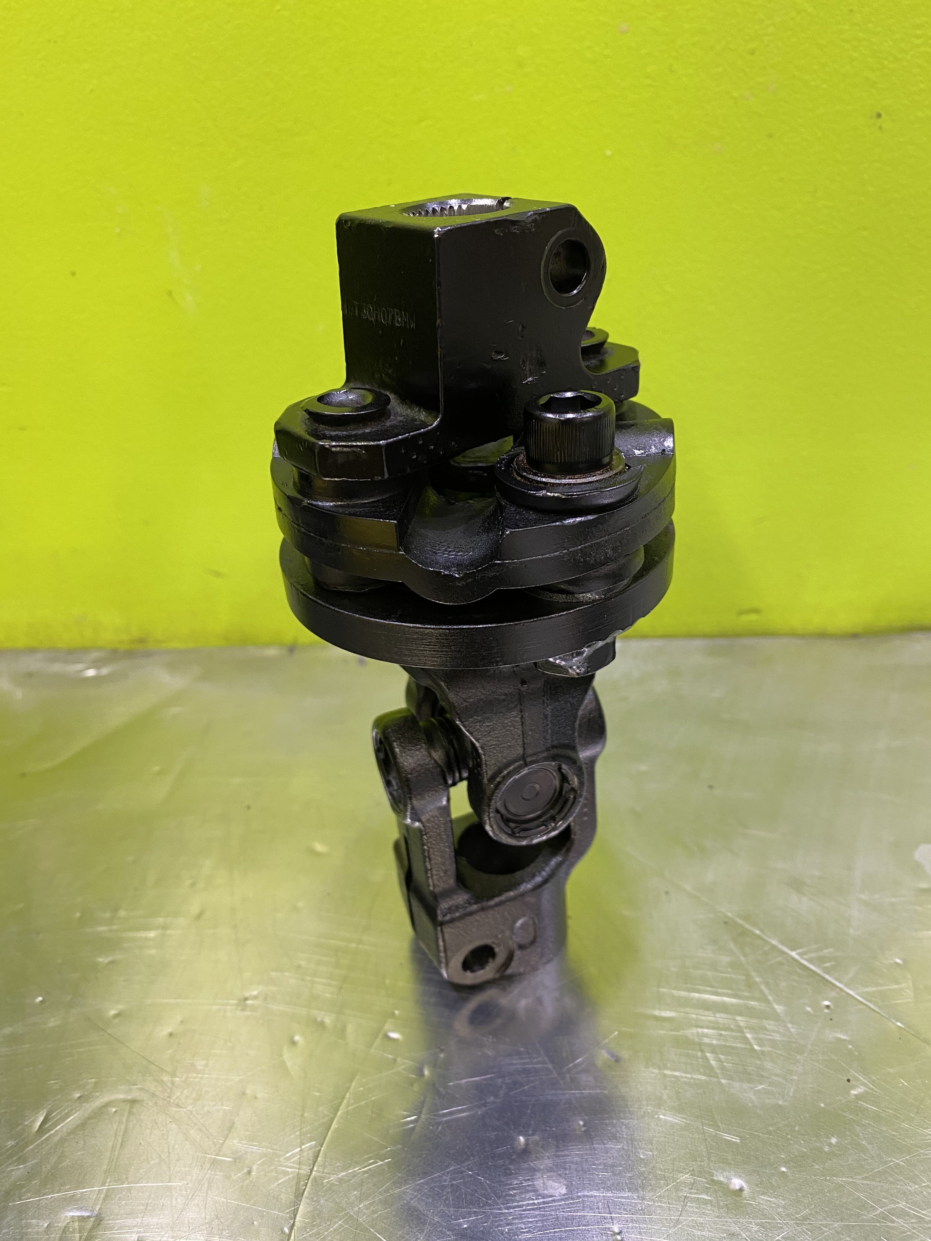

Made an adapter last night and it came out pretty good. I still need to weld it all together but Im thinking this might be temporary though. I need to prove out that there is no binding with a single joint, otherwise I will take the dimensions and still go with the anti-vibe flaming river joint.
(images wont attach. I will try again later)
I have yet to weld this as I realized that I will not be able to remove the hardware once I do so. I rather not tap threads into the plate but that might be my only option.
what will the assembly process be? Are the two adapter bolts the last parts to be installed to bolt the column to the rack, or can everything be preassembled? can you just weld the screws into the adapter plate holes on the z4 joint side so you don't have to put a wrench on that side after final welding? or just weld a nut on that side and flip the fastener to avoid having to tap the adapter plate? i'm not sure what your main goal is here - professional fit/finish, ease of maintenance, or ease of fabrication, etc.
It can be preassembled due to the telescoping airbag steering column. I could weld the nuts or bolts to the adapter and call it done. I need to get the right diameter shanked bolts first to see if I’m happy with it. It seems like once it’s all tight, the flex disc deflects and the bolts will just push the material out of the way.
If that’s the case, this might just be a mock up for a flaming river joint. ¯\_(ツ)_/¯
Successful weekend.
I completed the steering joint and installed it, bolted in new inner and outer tie rods, and I was able to make a pair of E36M3 boots stretch over the bigger bore Z4 rack by putting them in the oven and soften them.

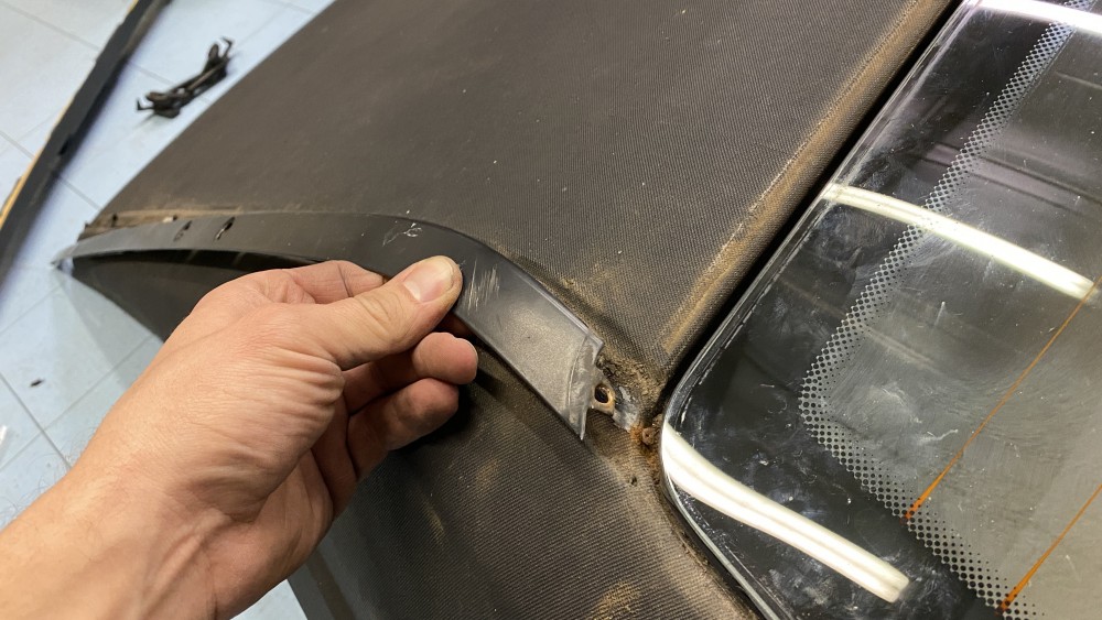

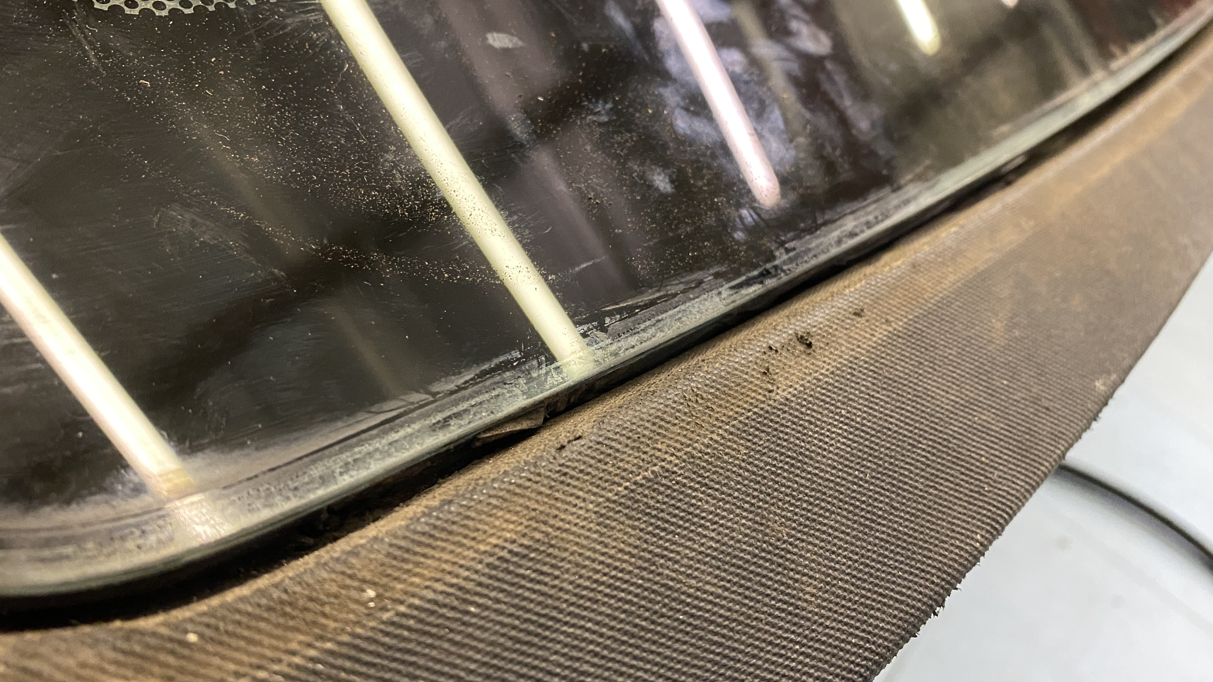

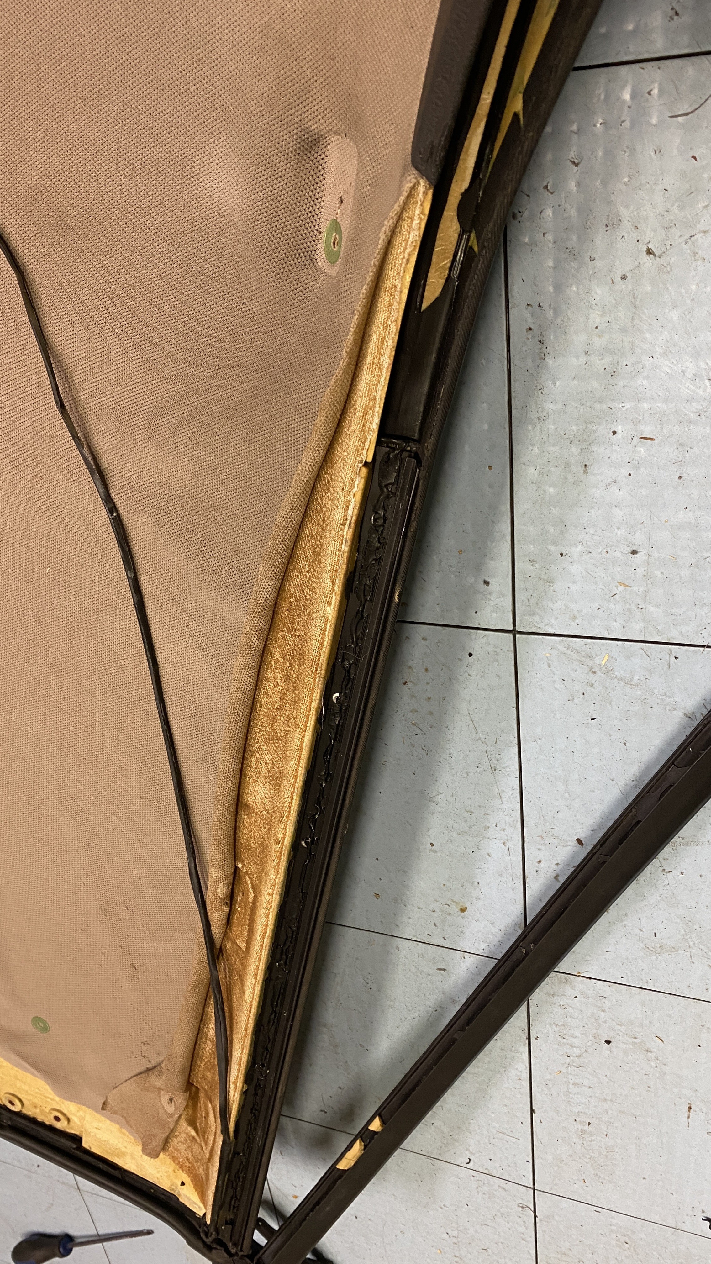

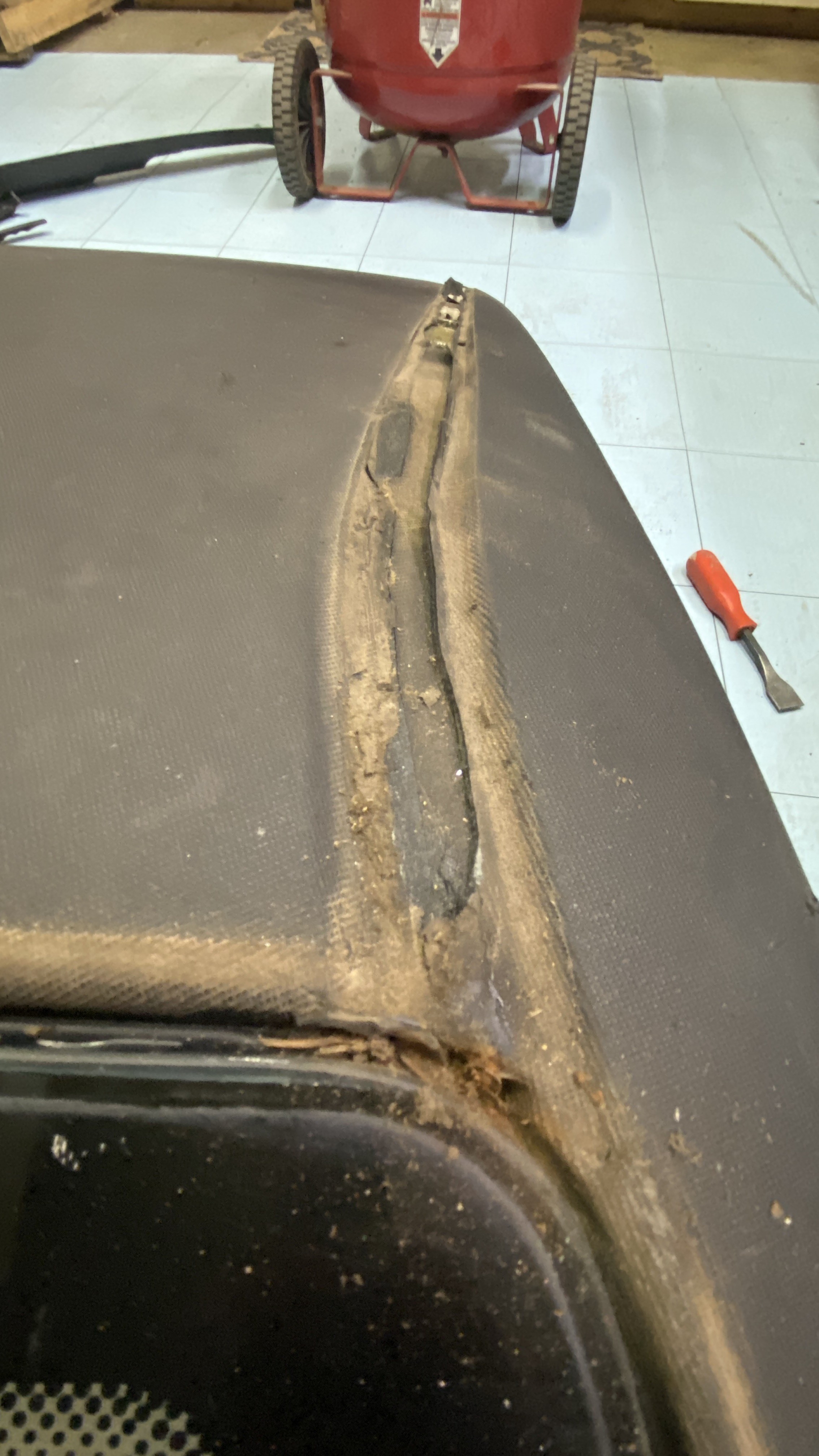

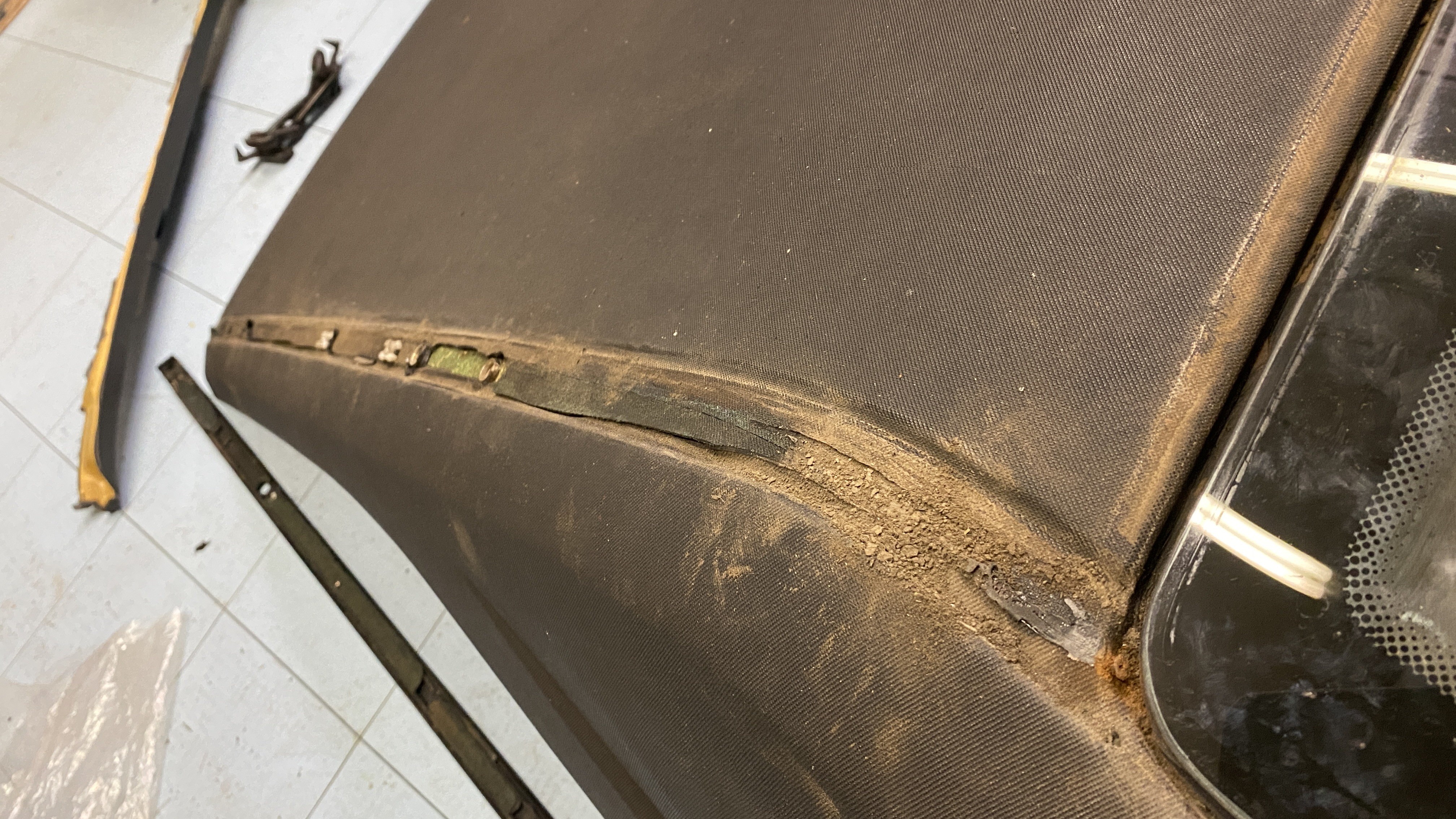

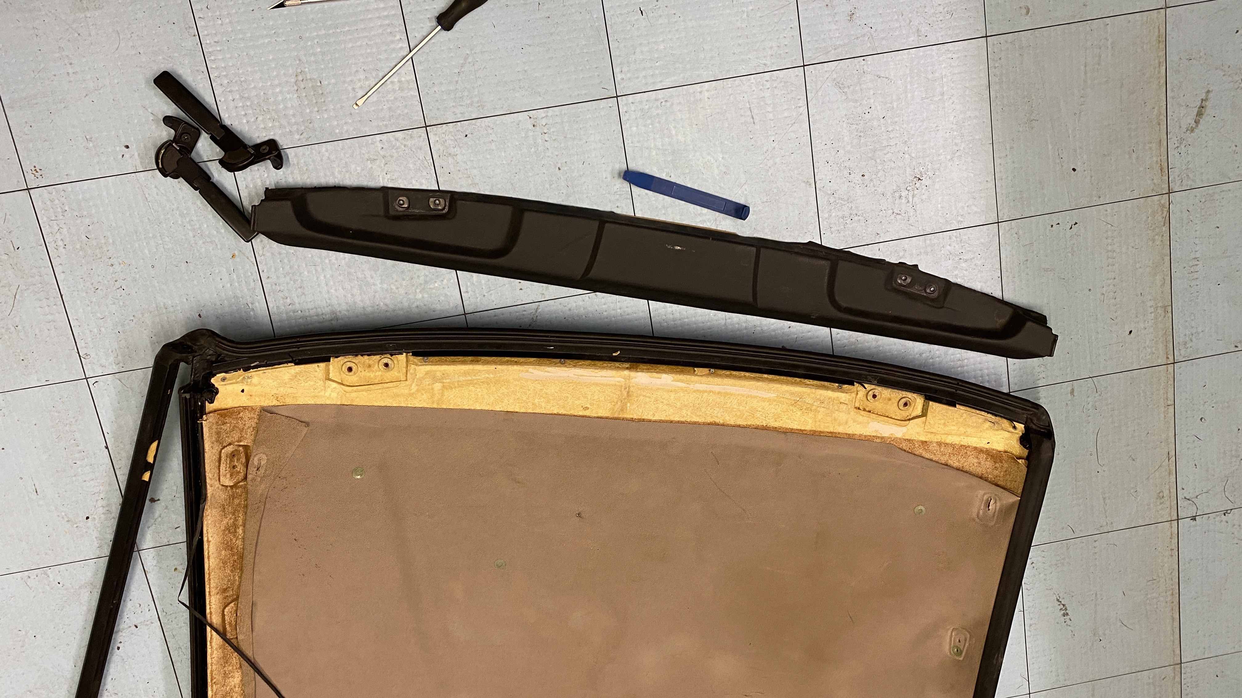

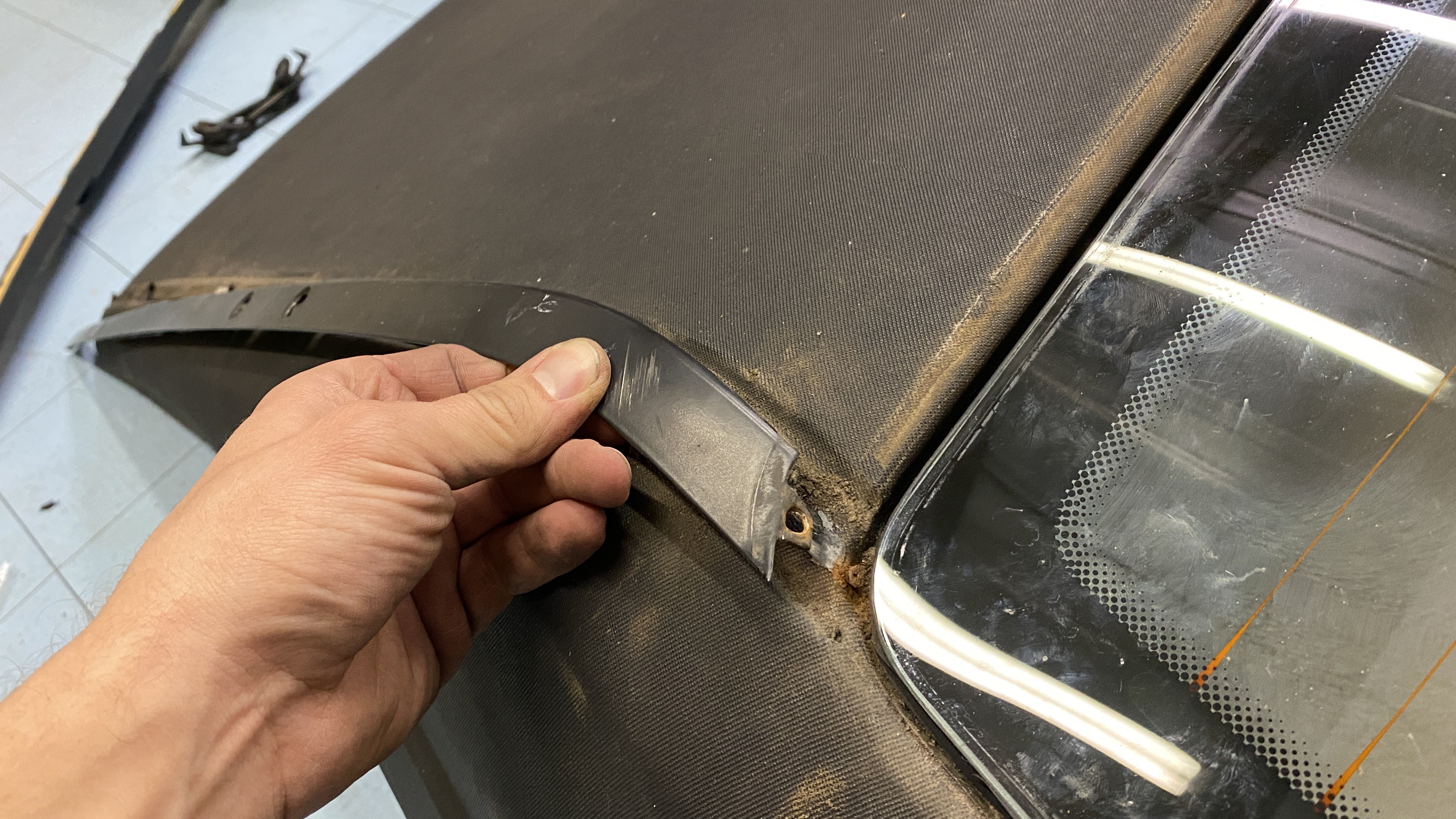

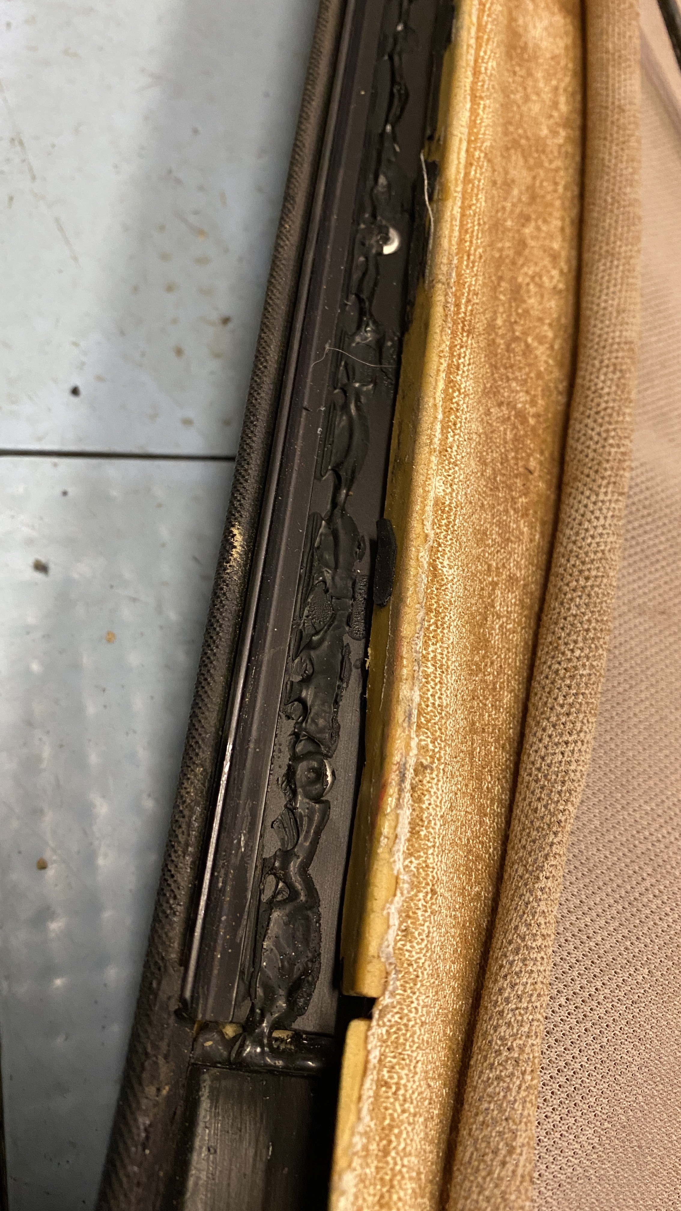

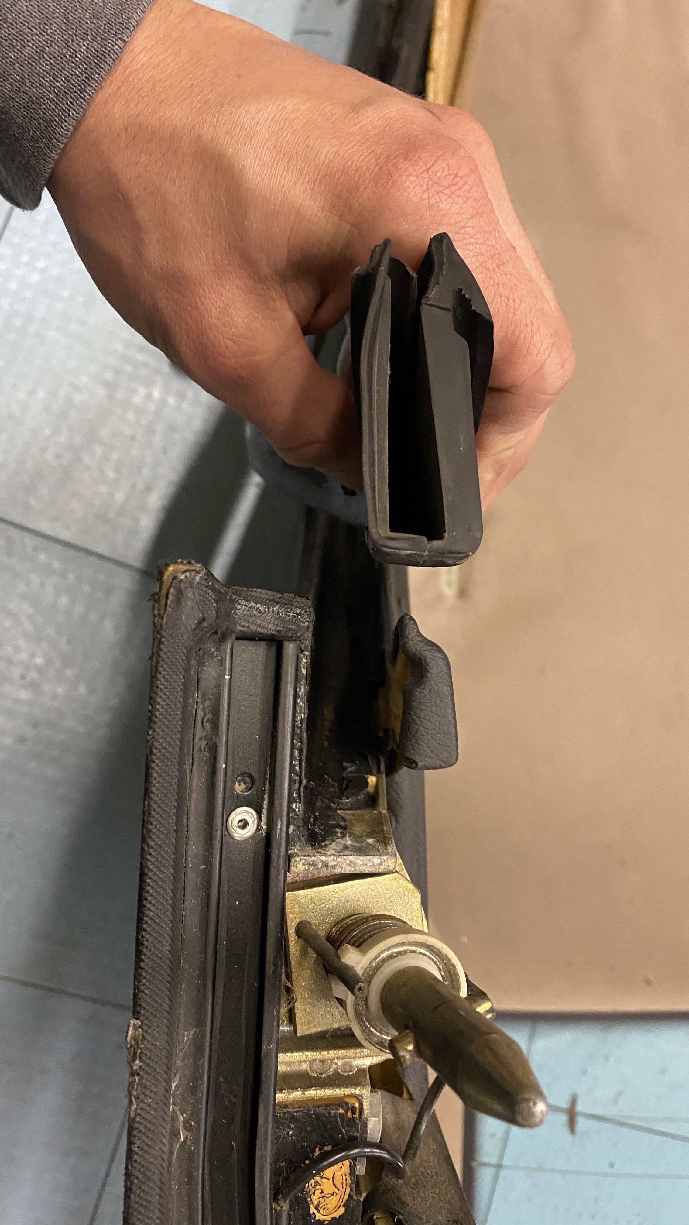

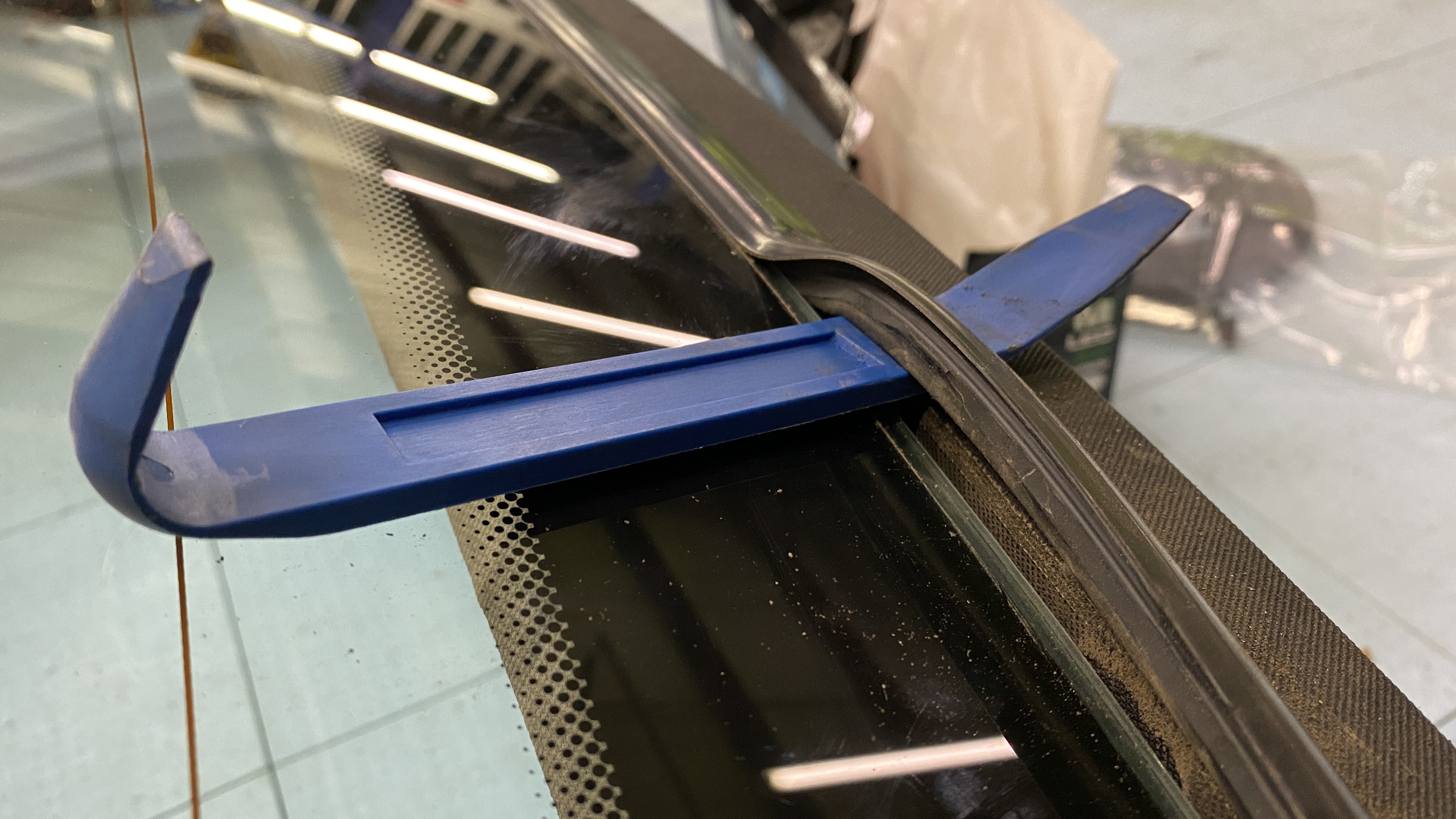

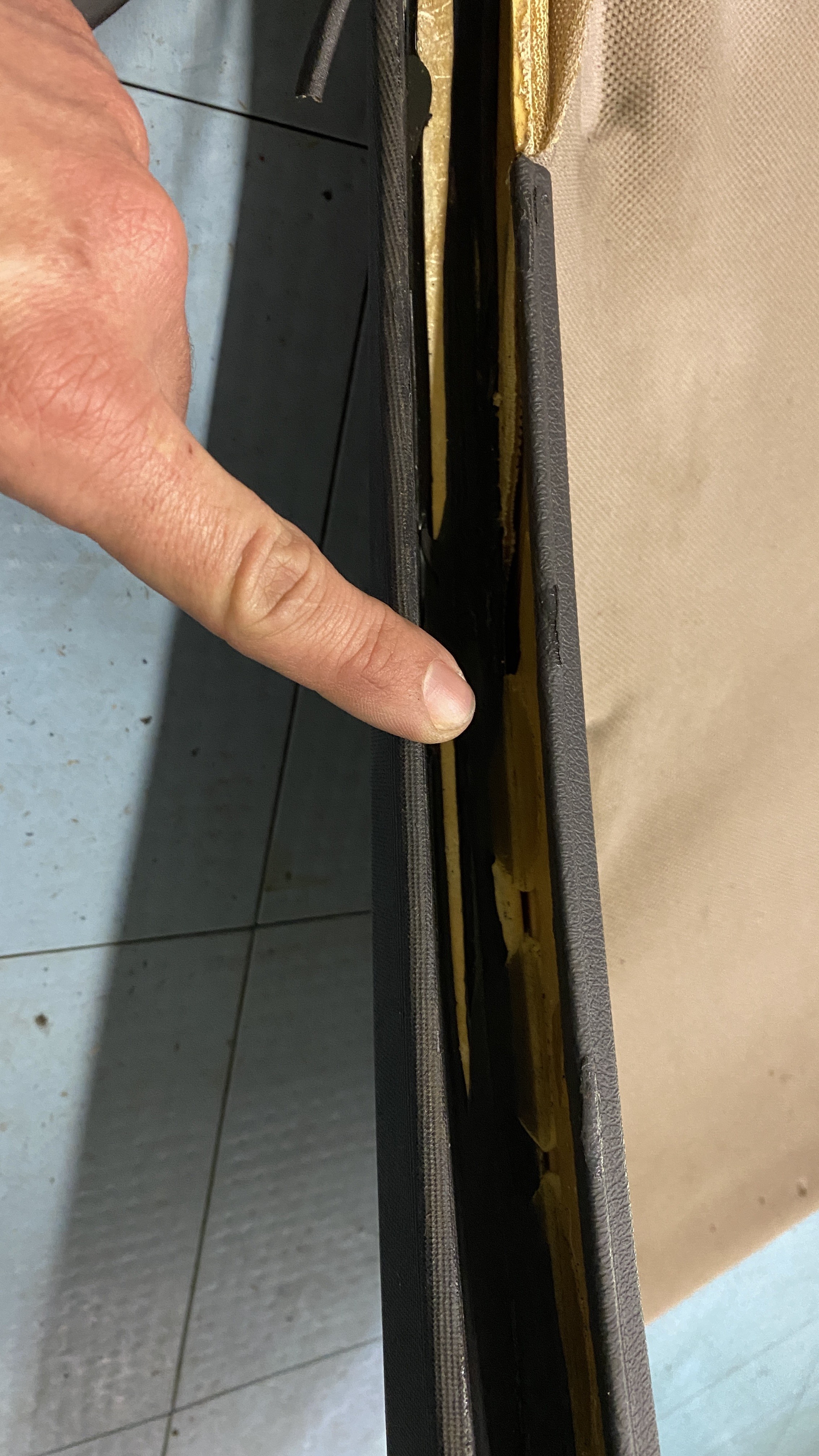

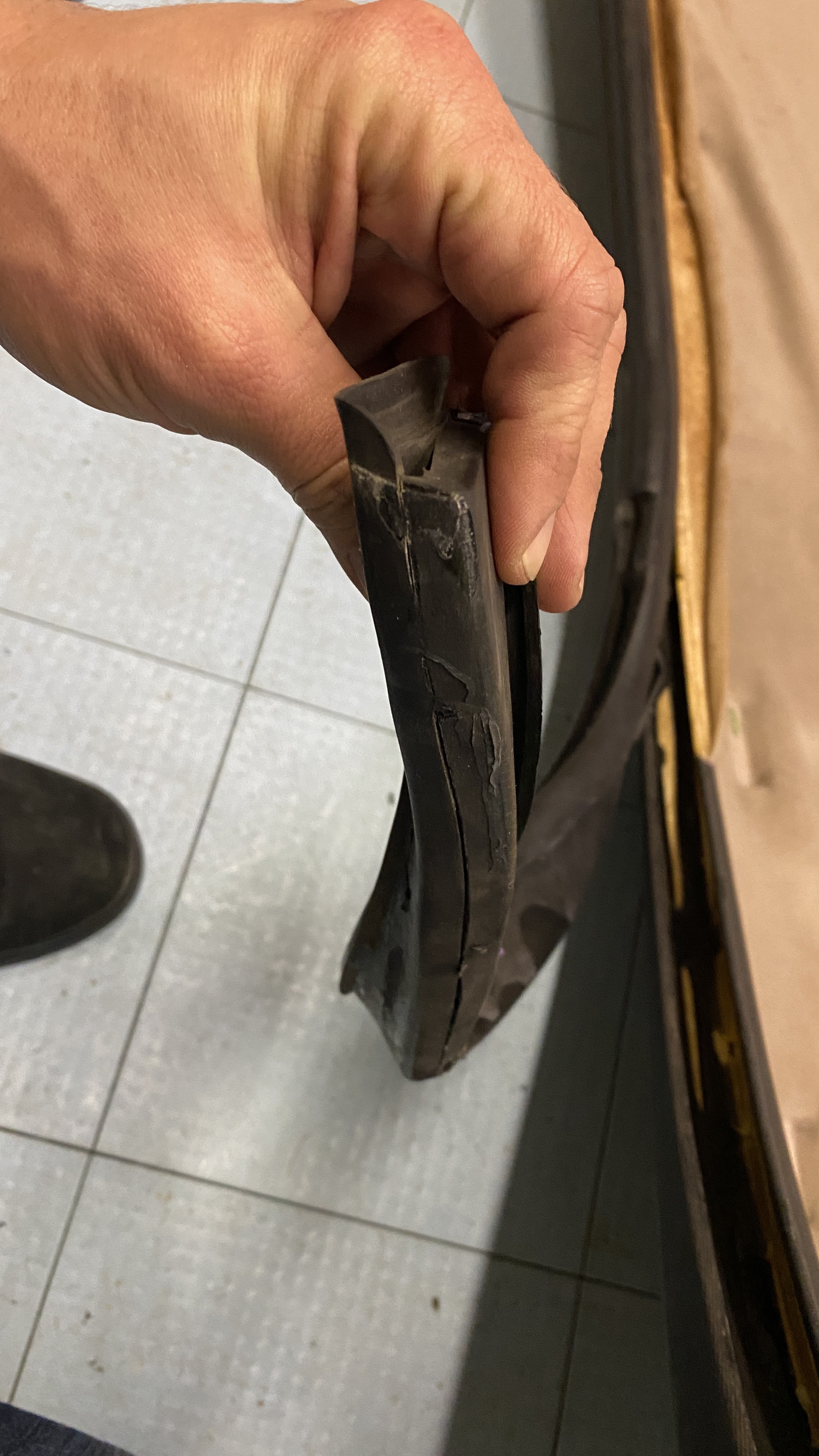

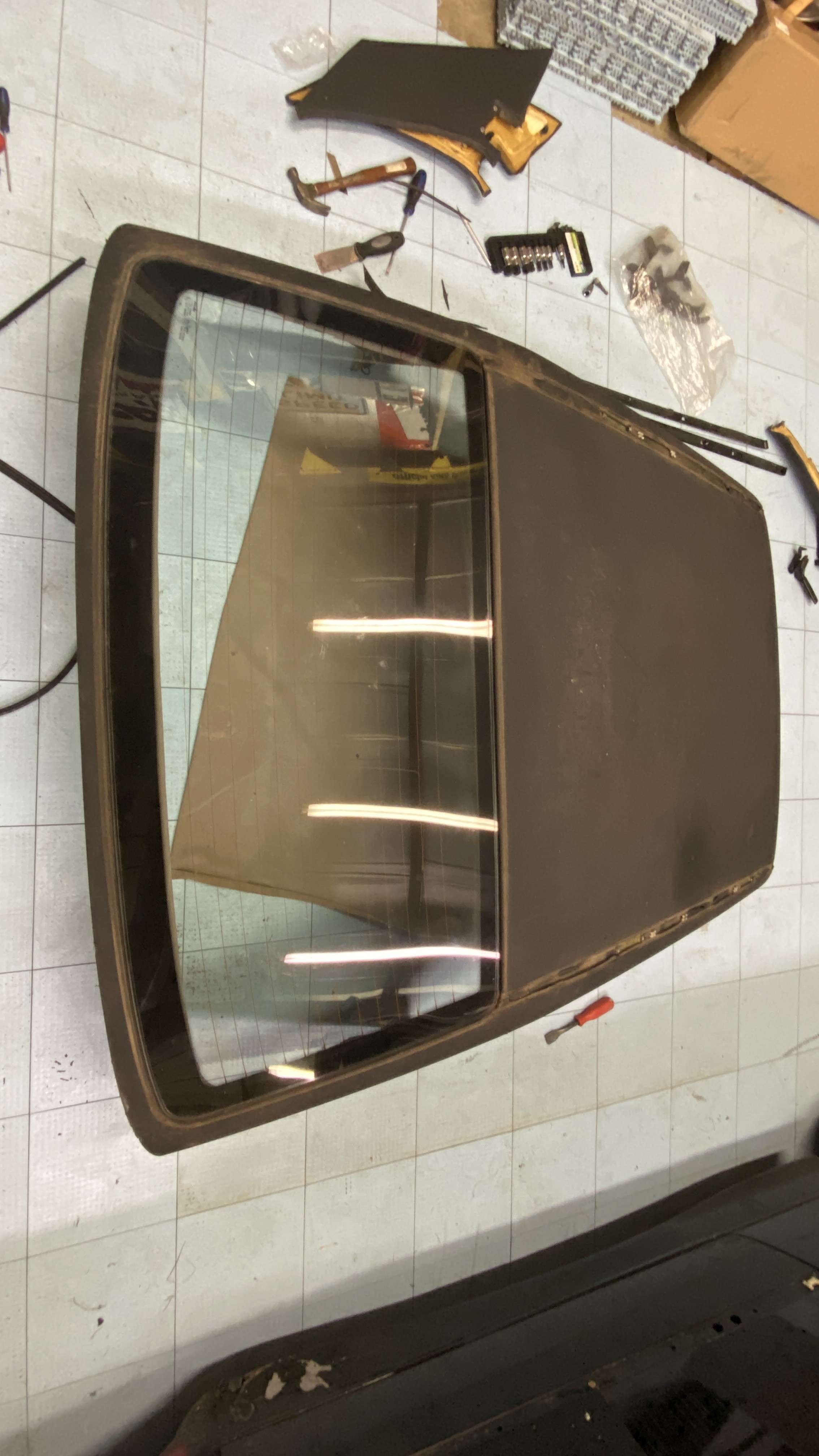

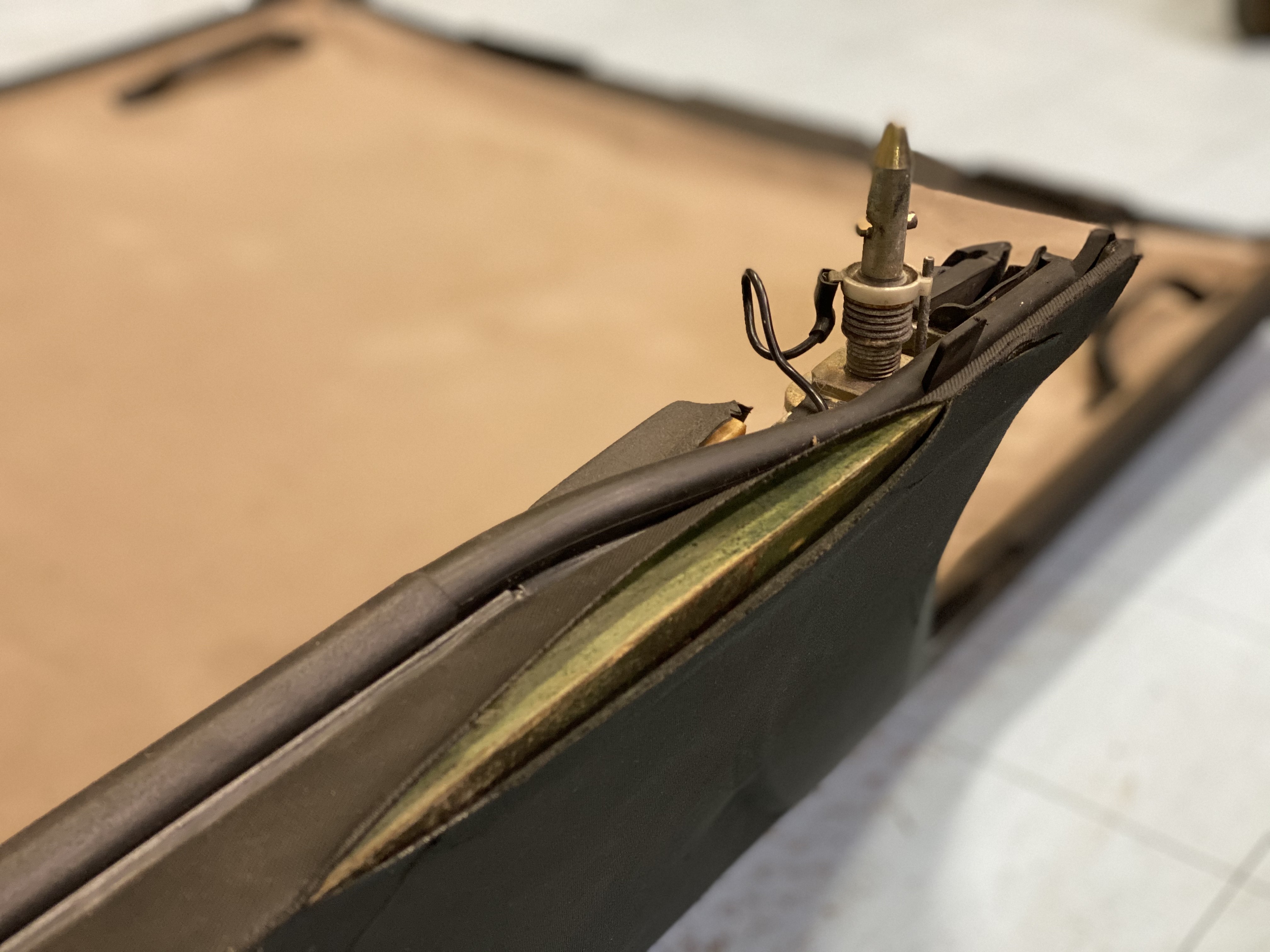

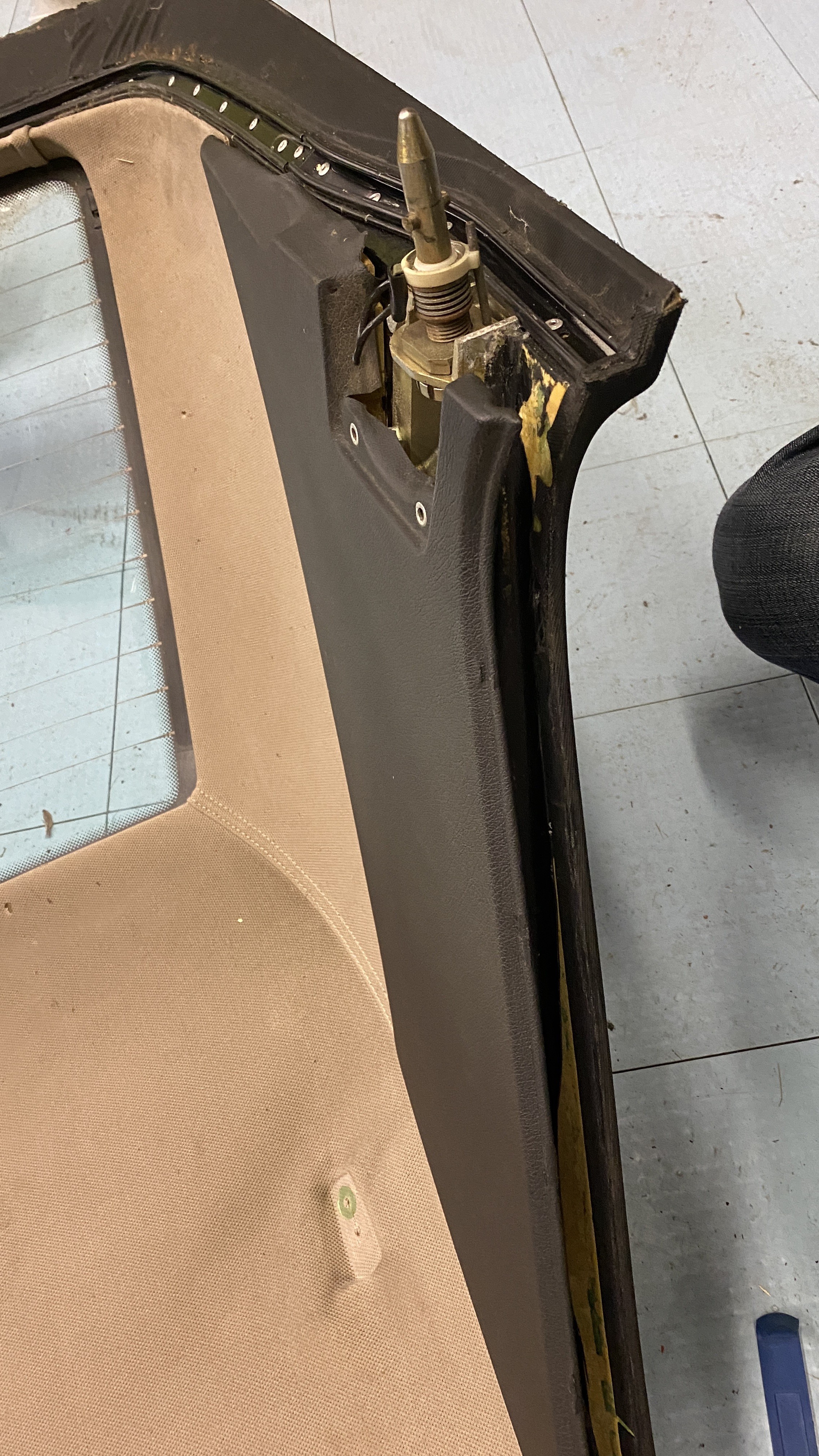

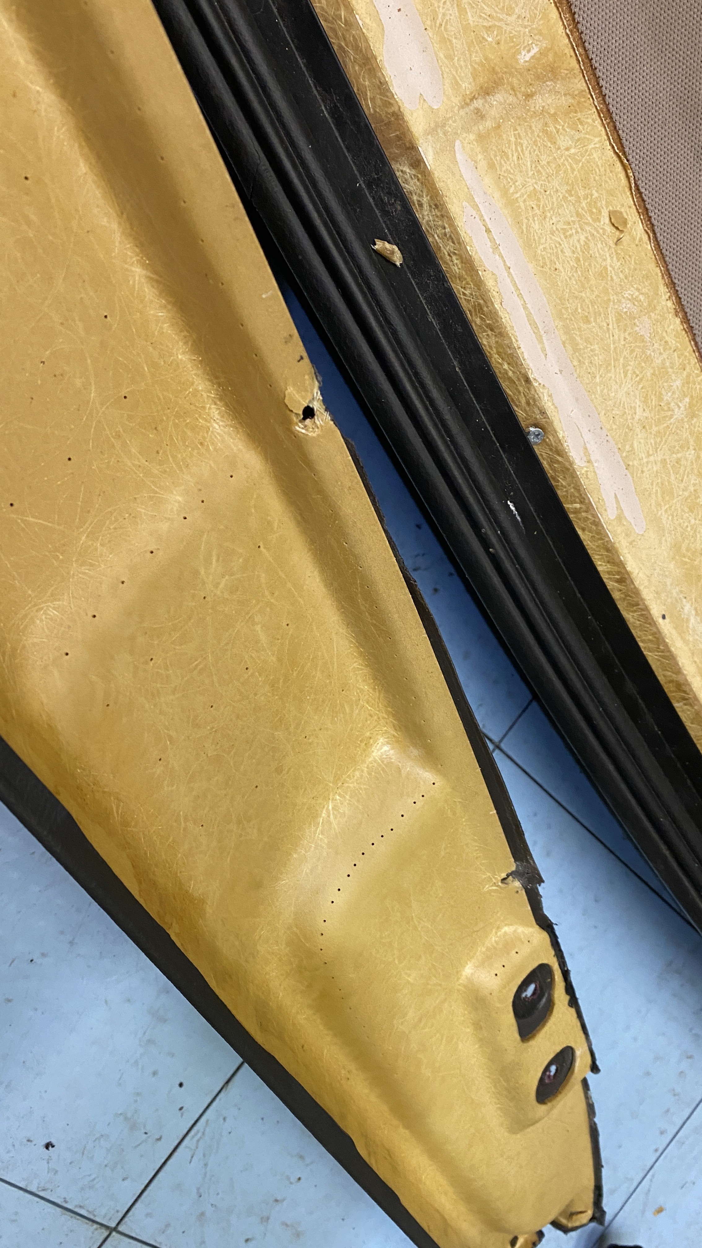

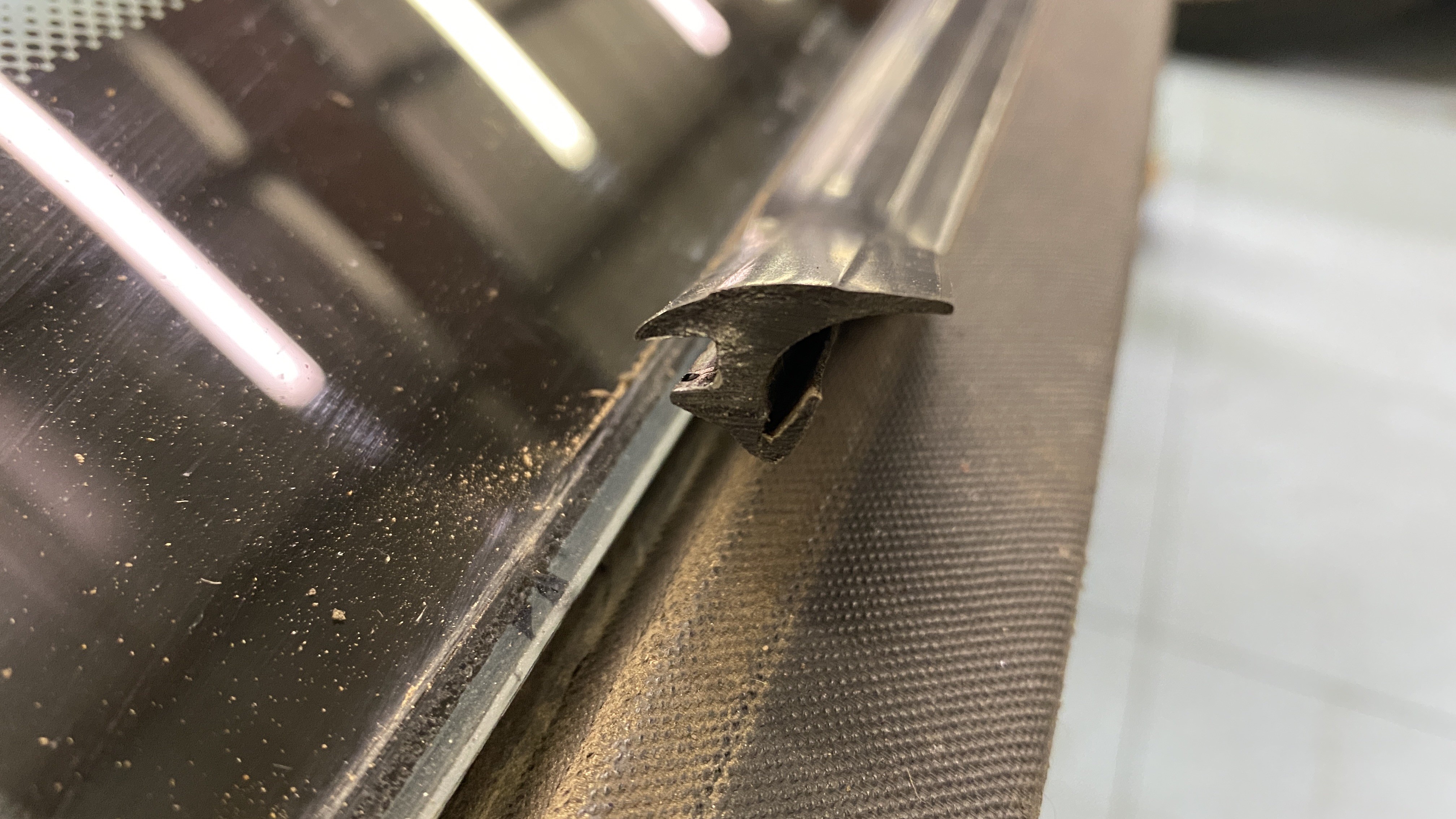

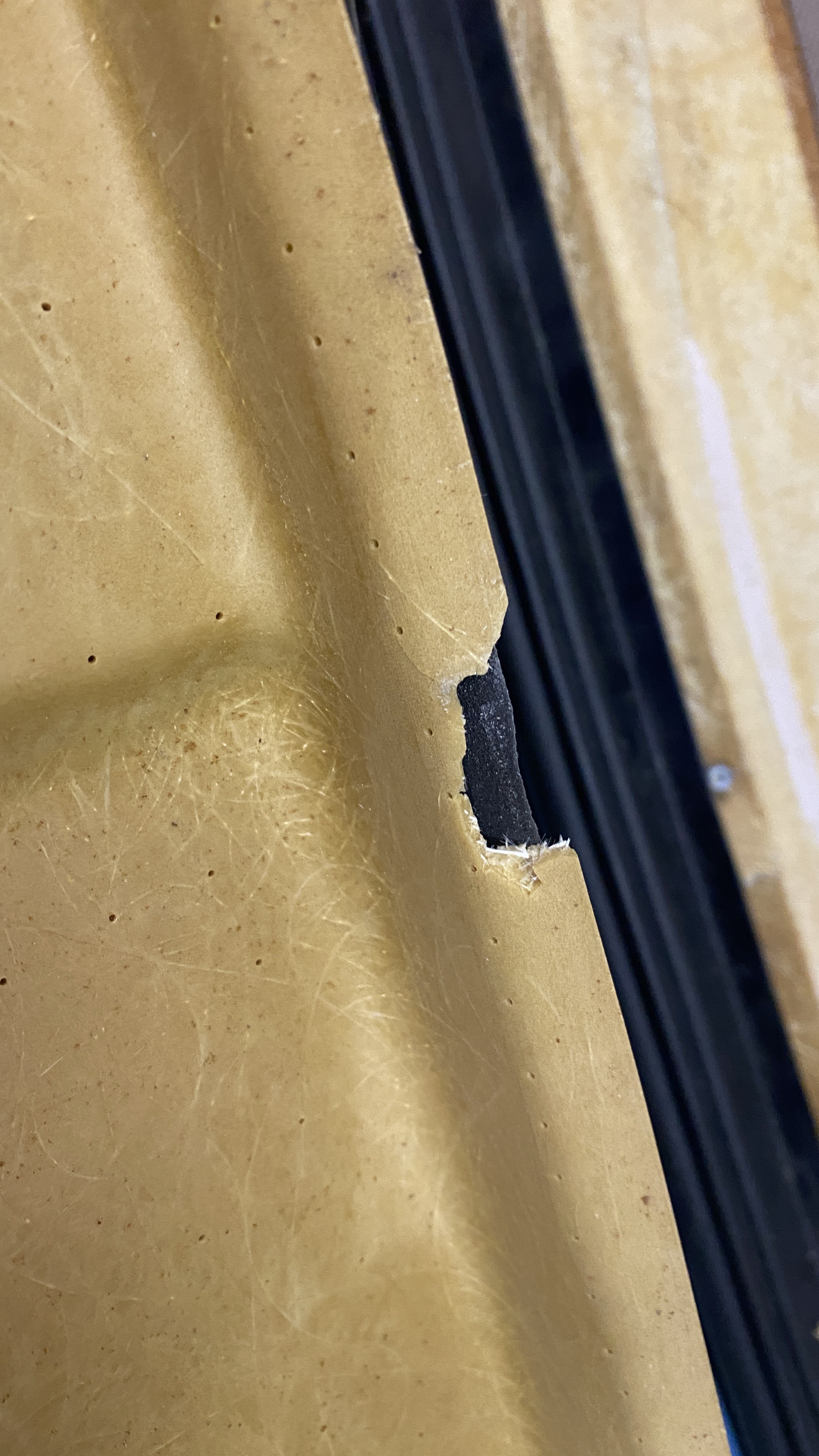

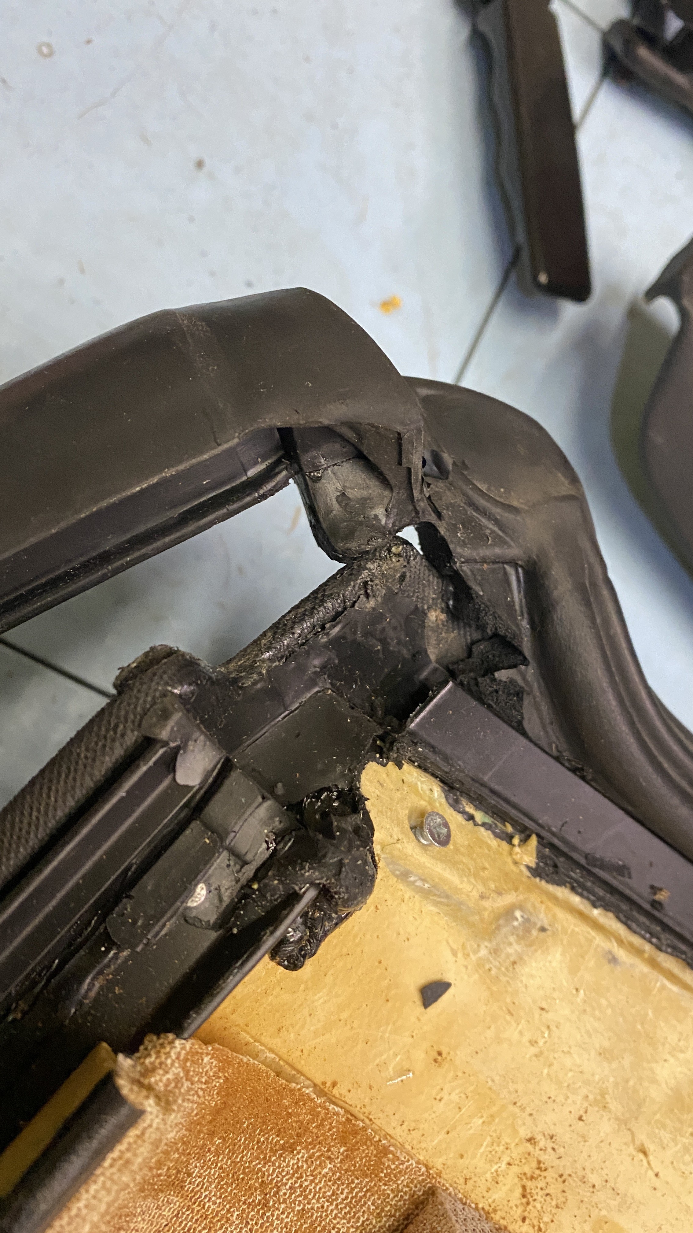

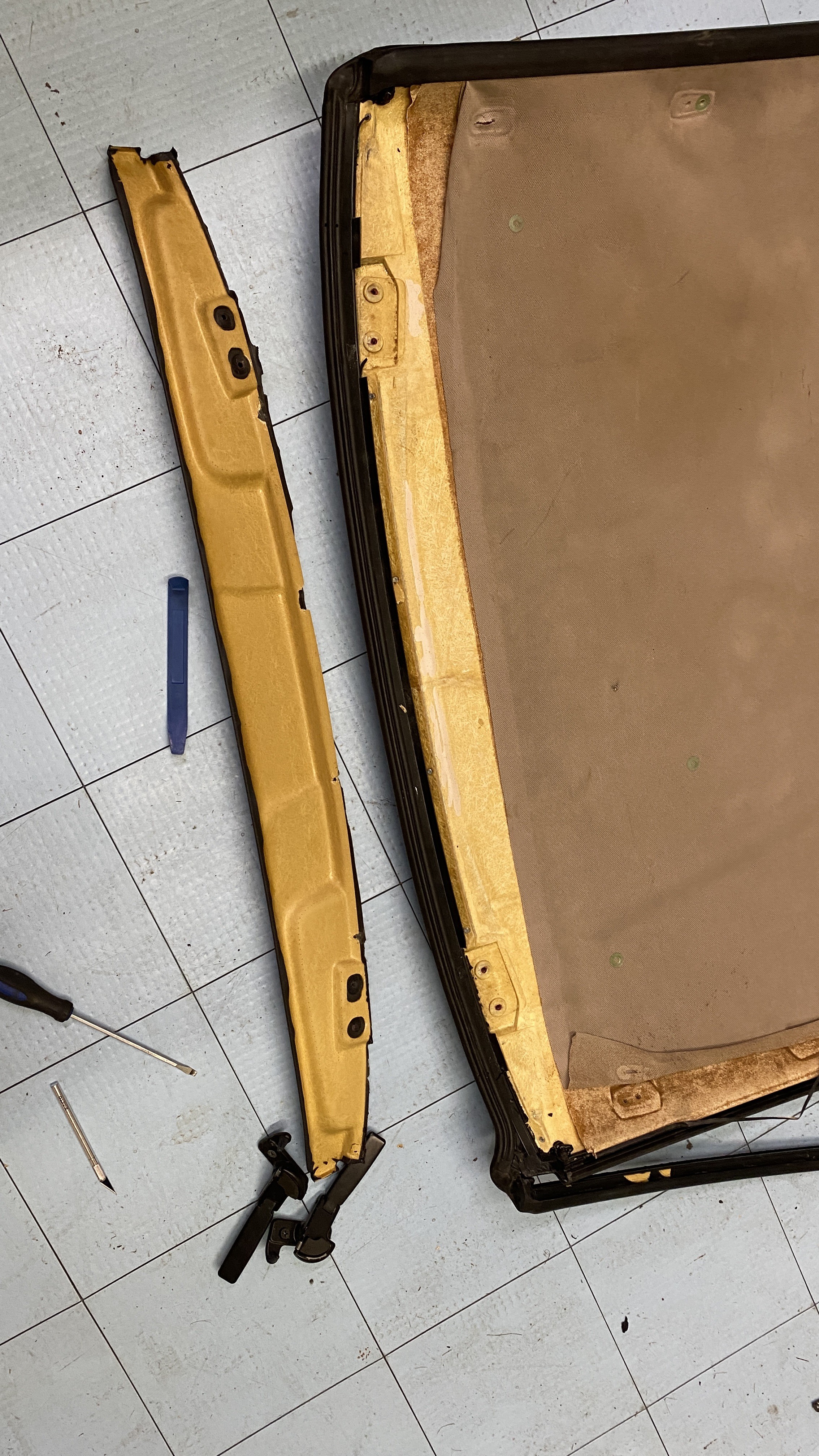

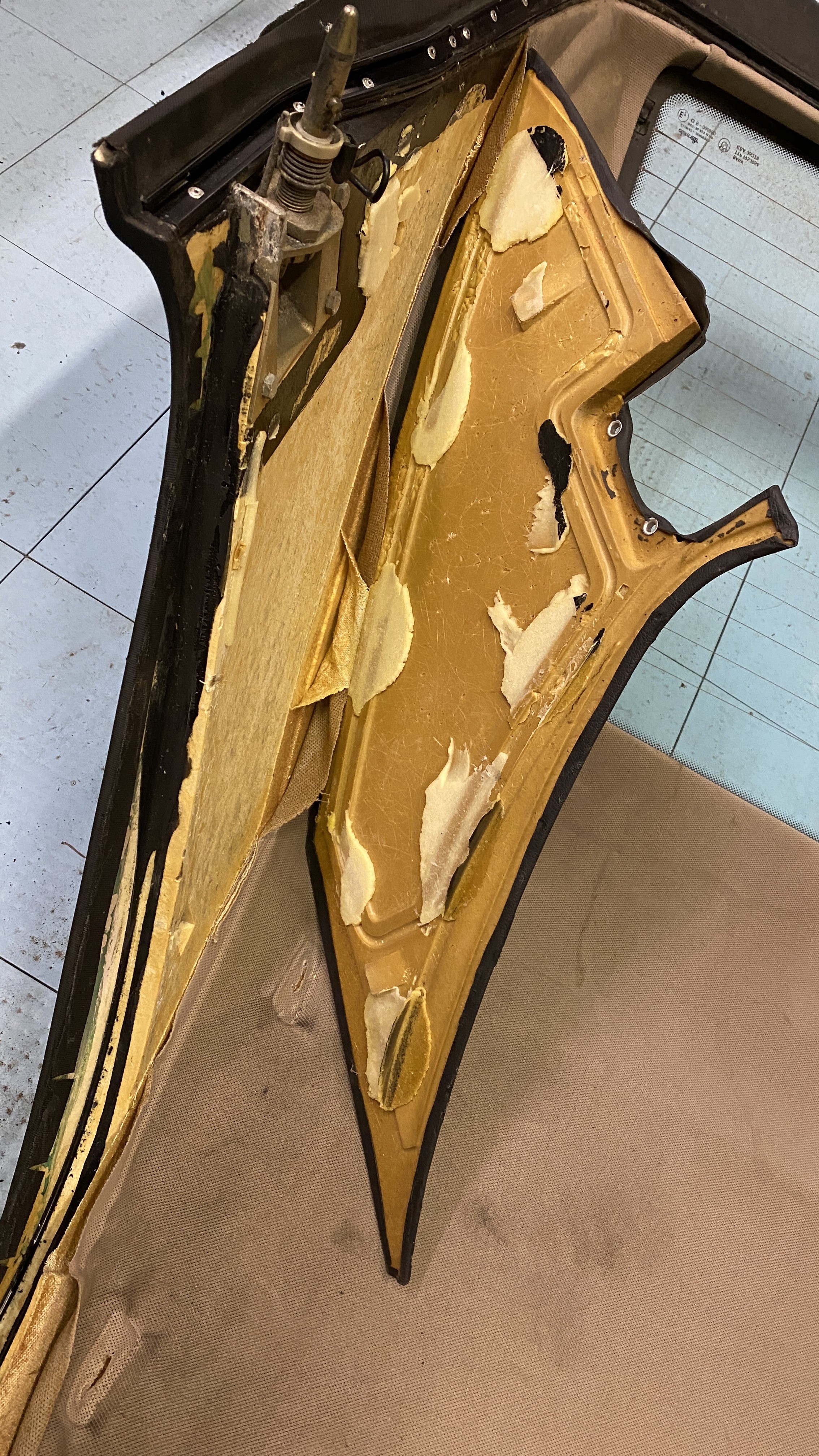

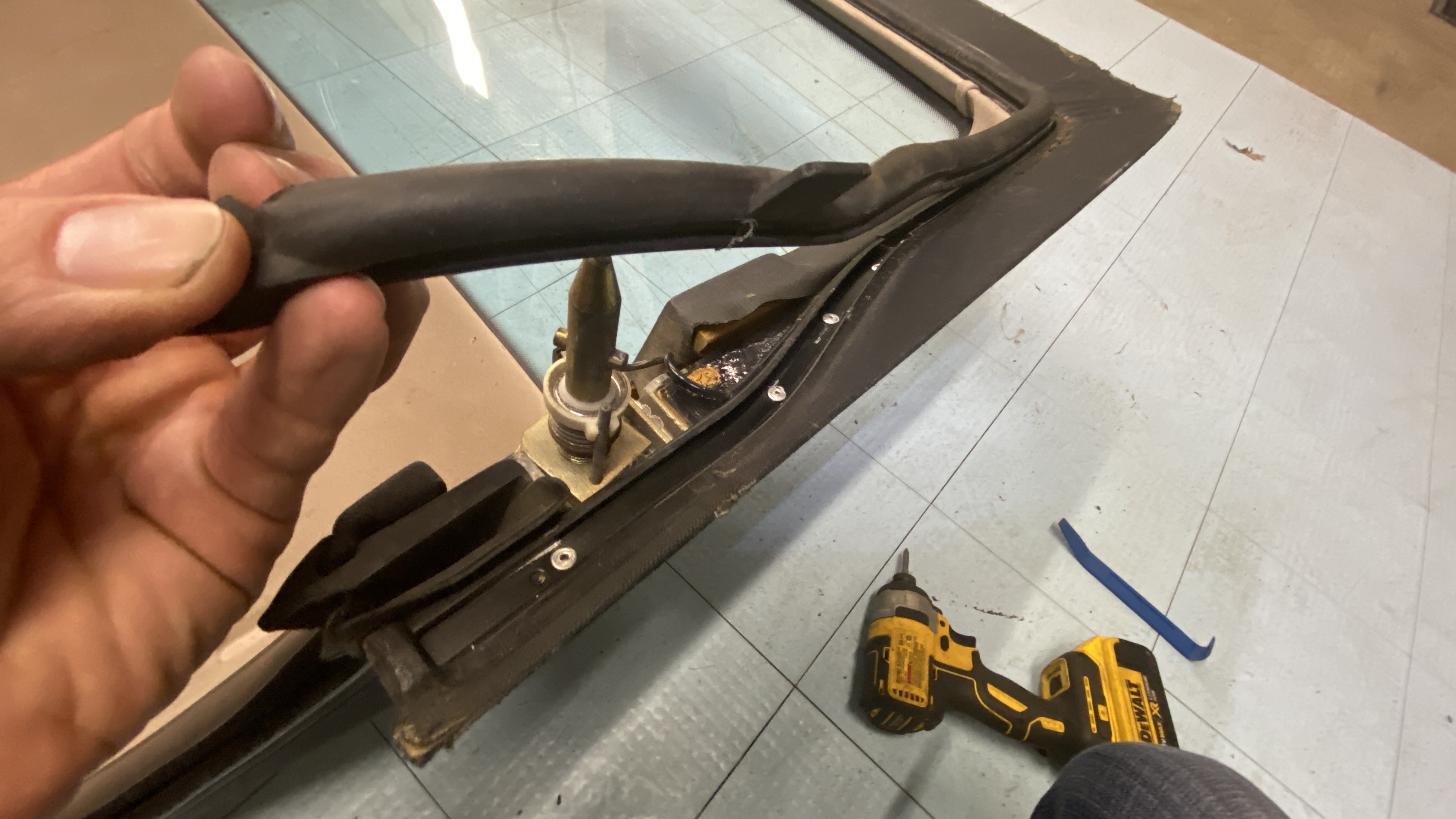

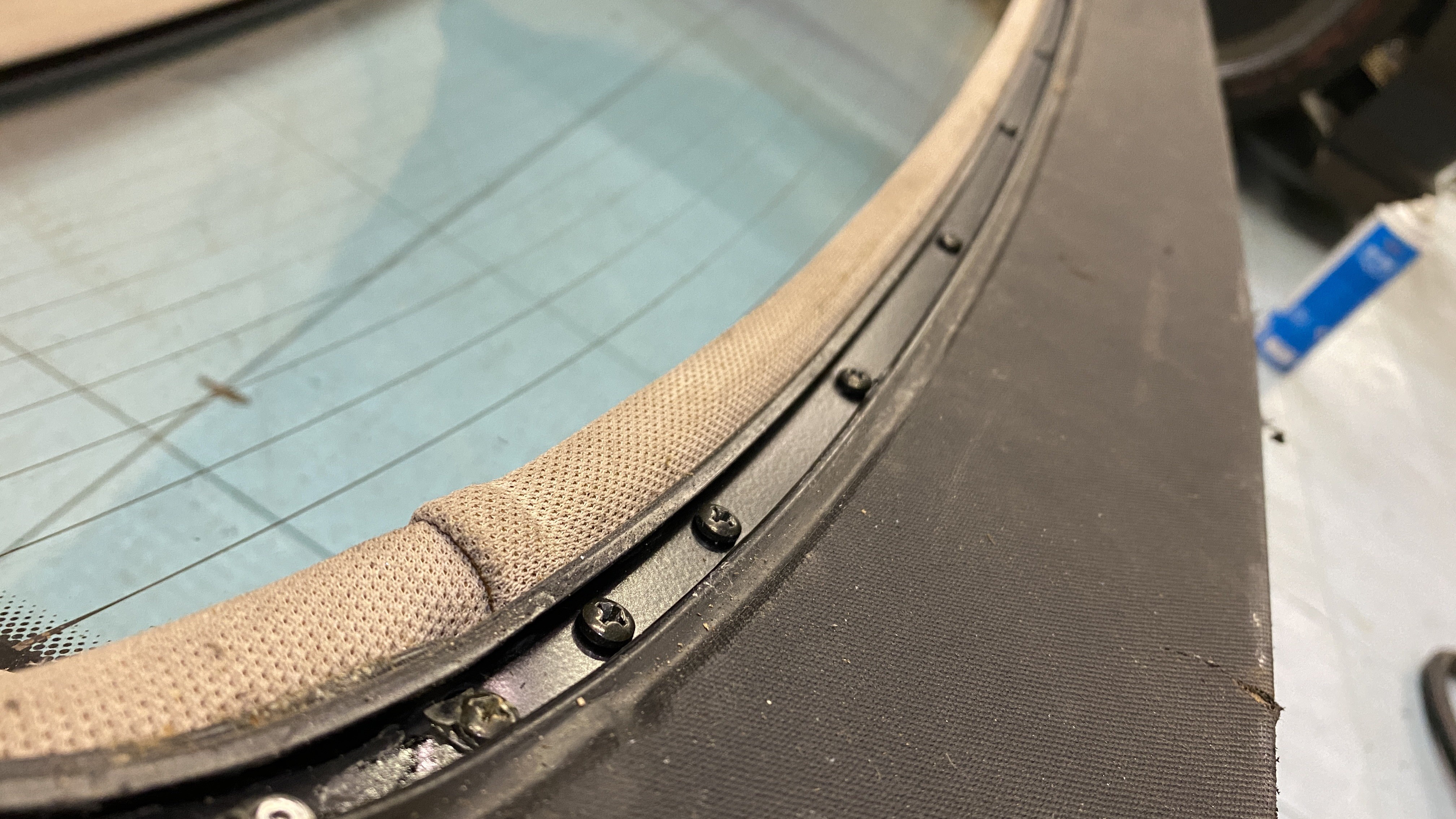

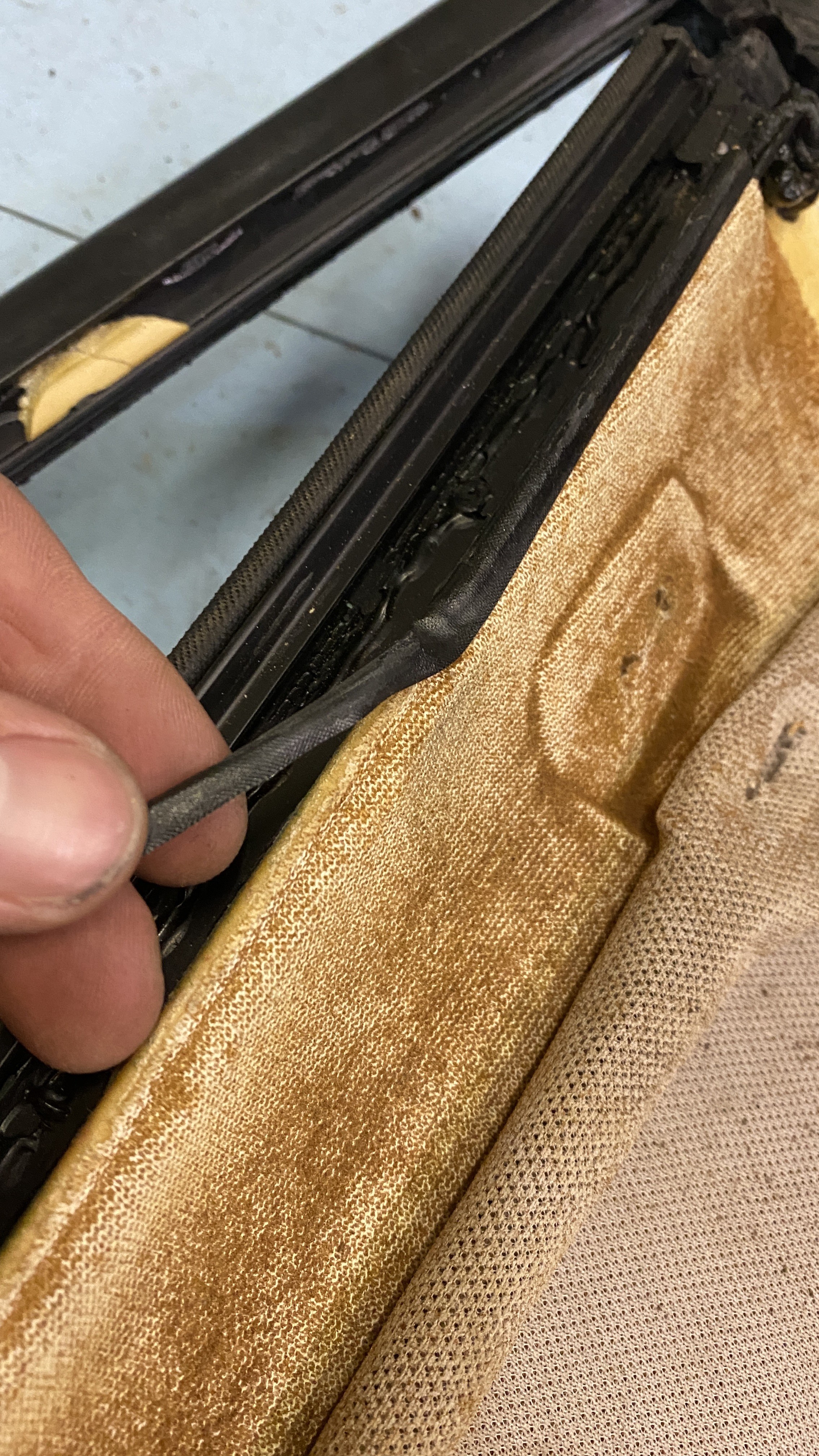

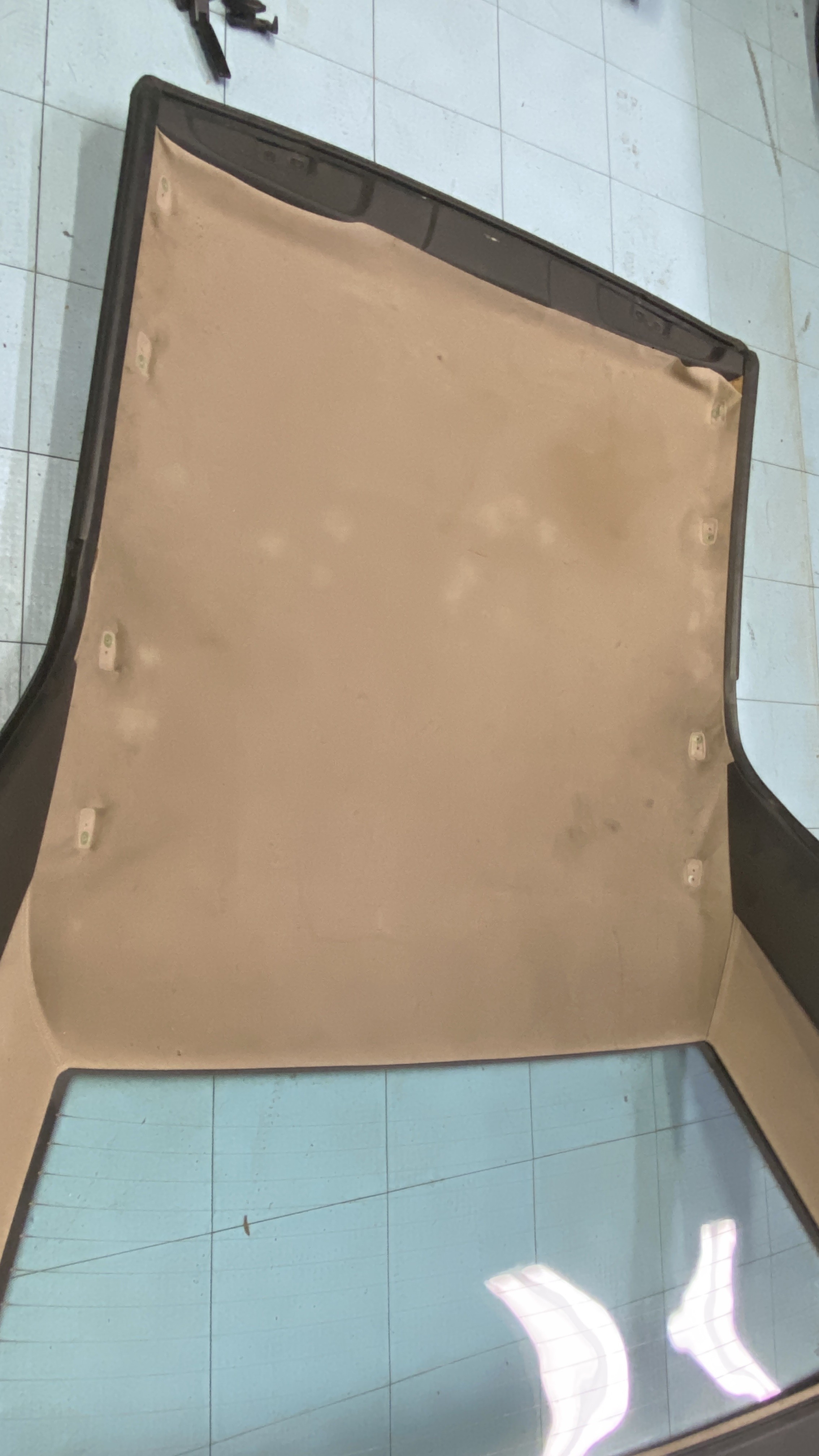

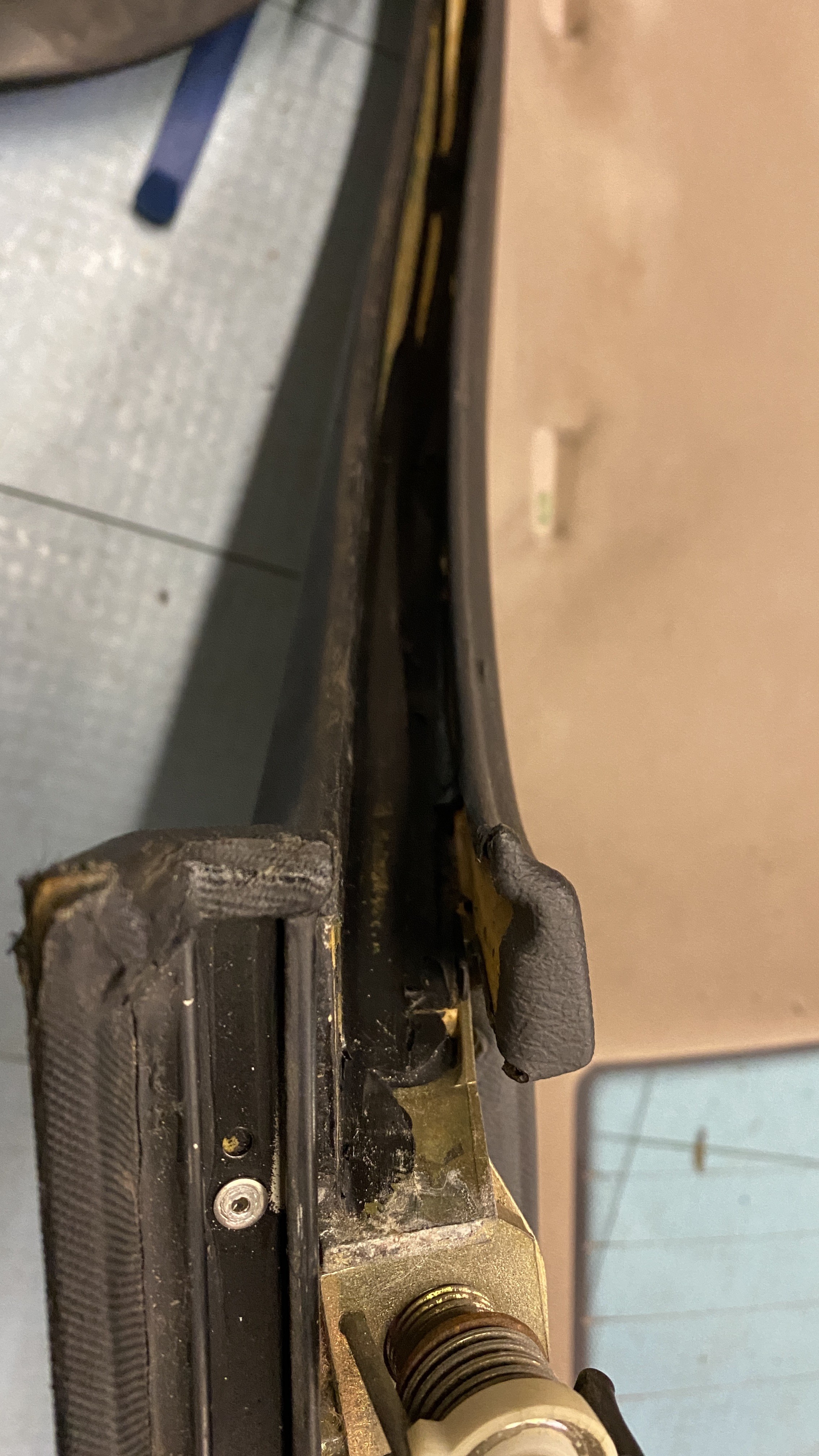

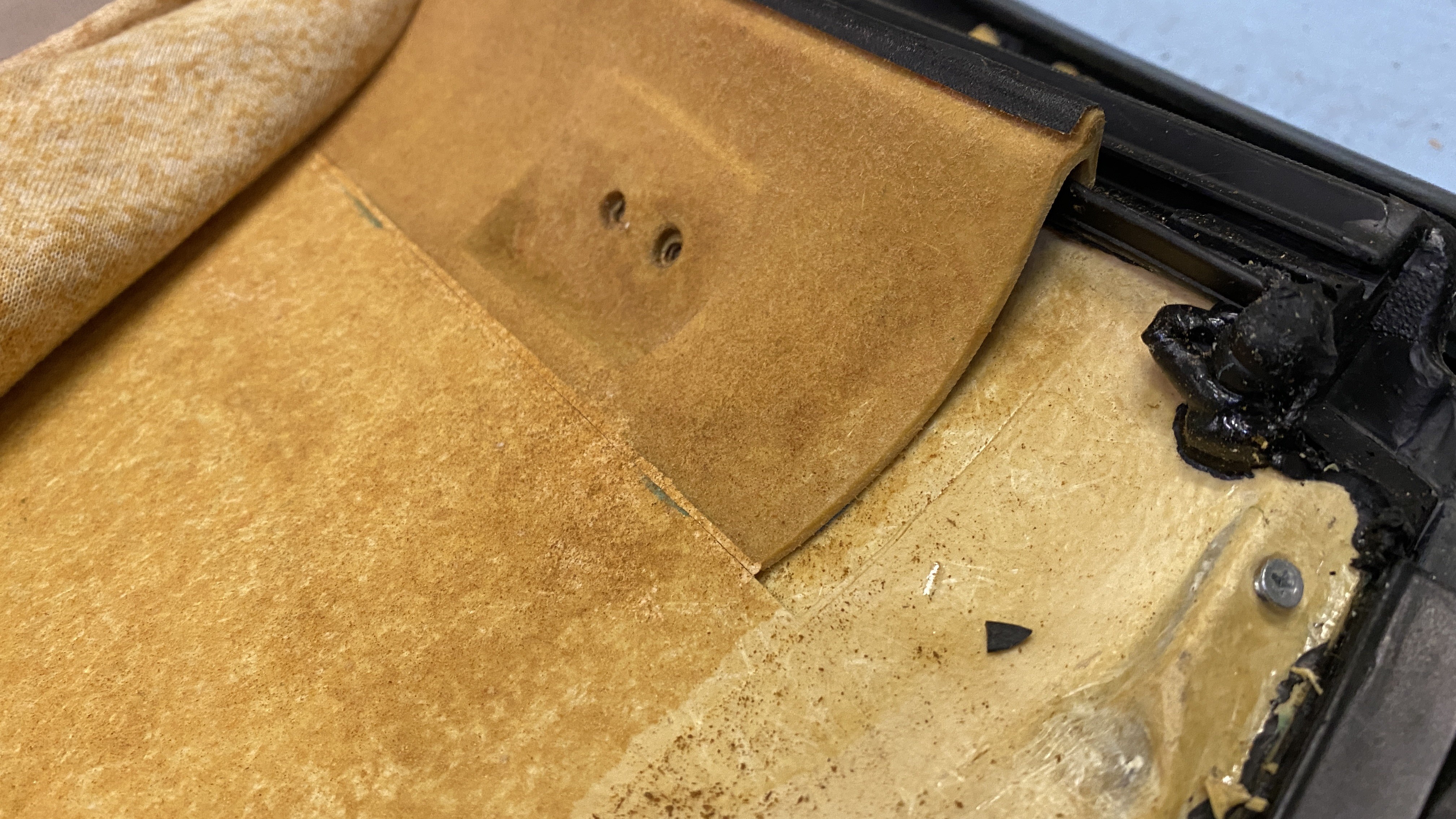

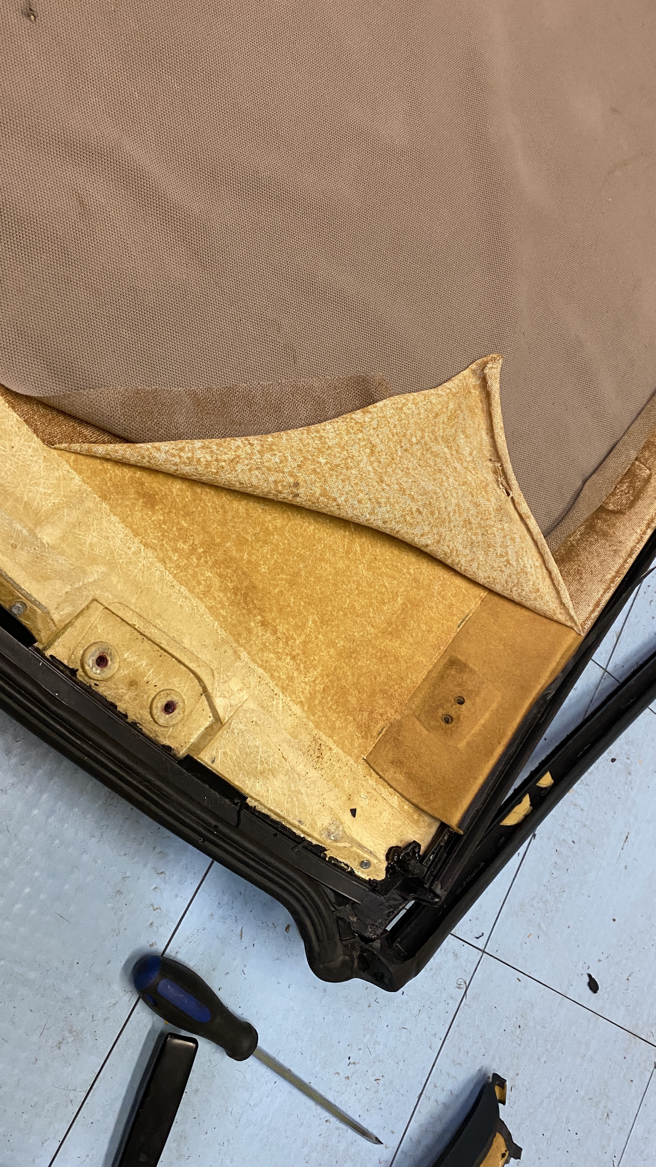

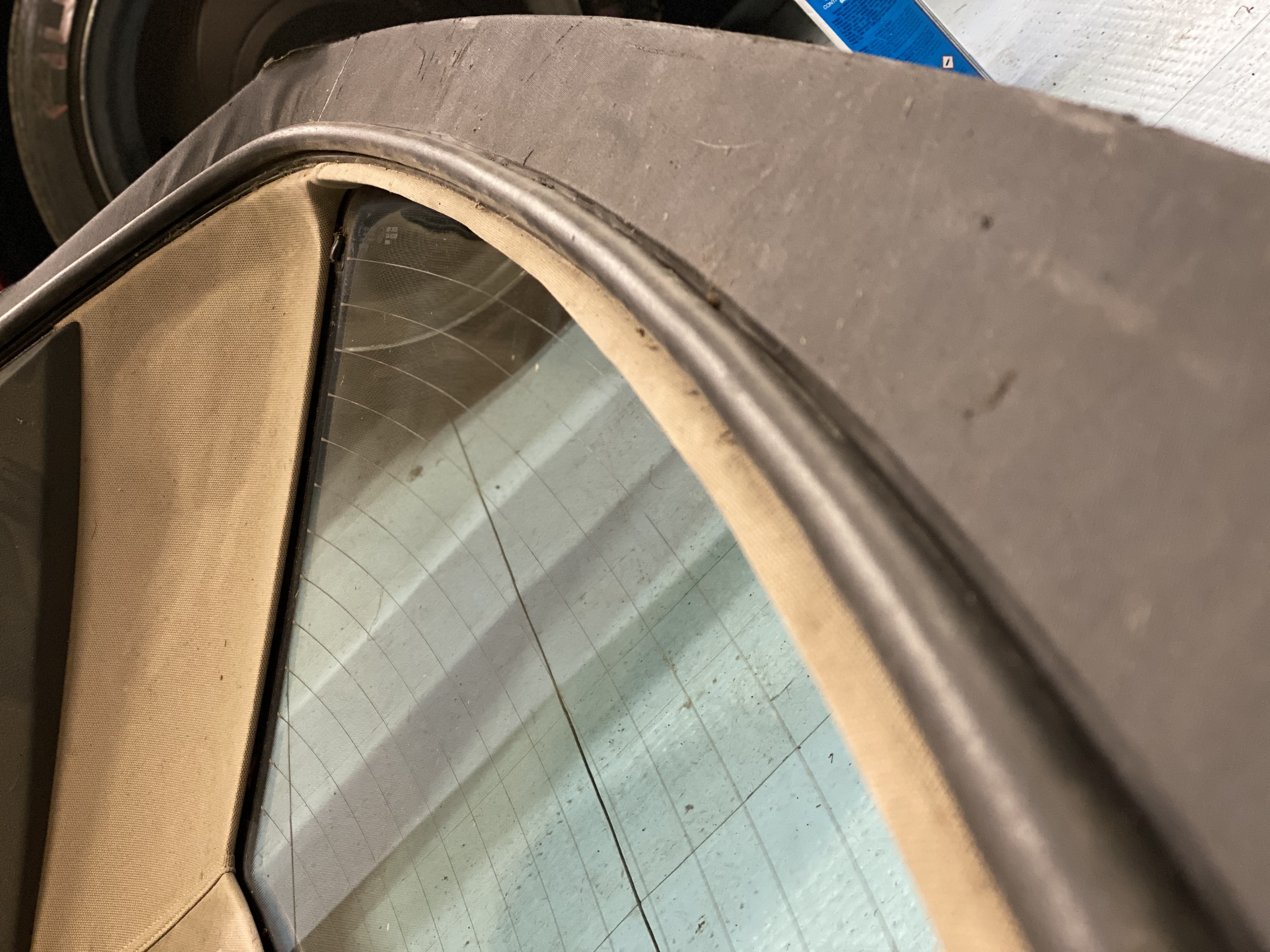

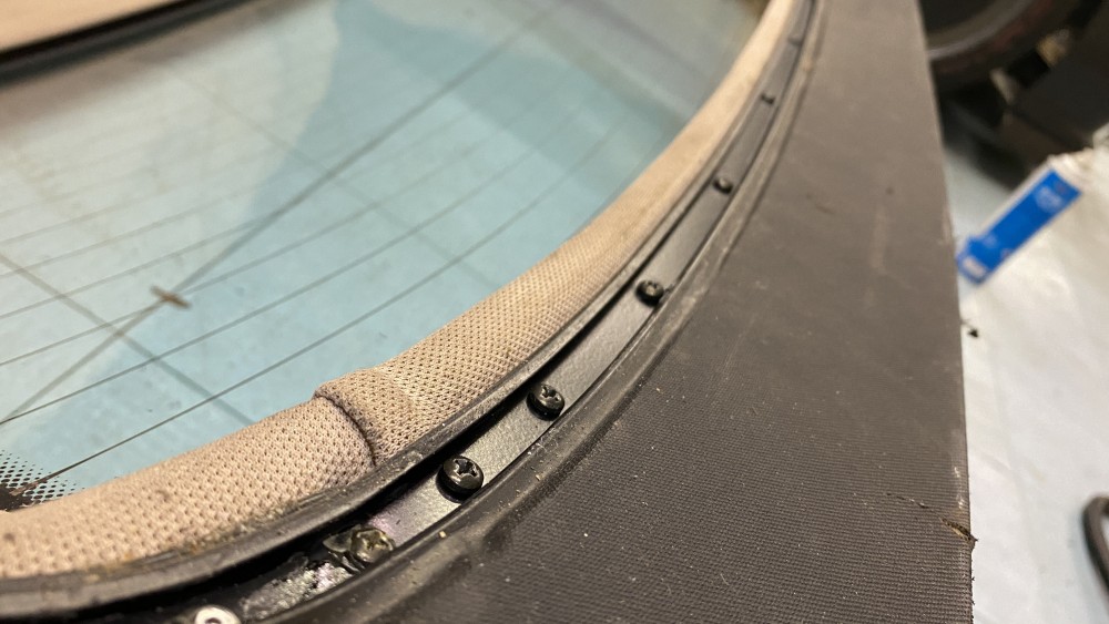

Sick of moving the hardtop around, and I didnt want to leave it on the top of the car, I decided to start taking the hardtop apart over the weekend. It proved to be MUCH more challenging than I expected.
One reason; GLUE.

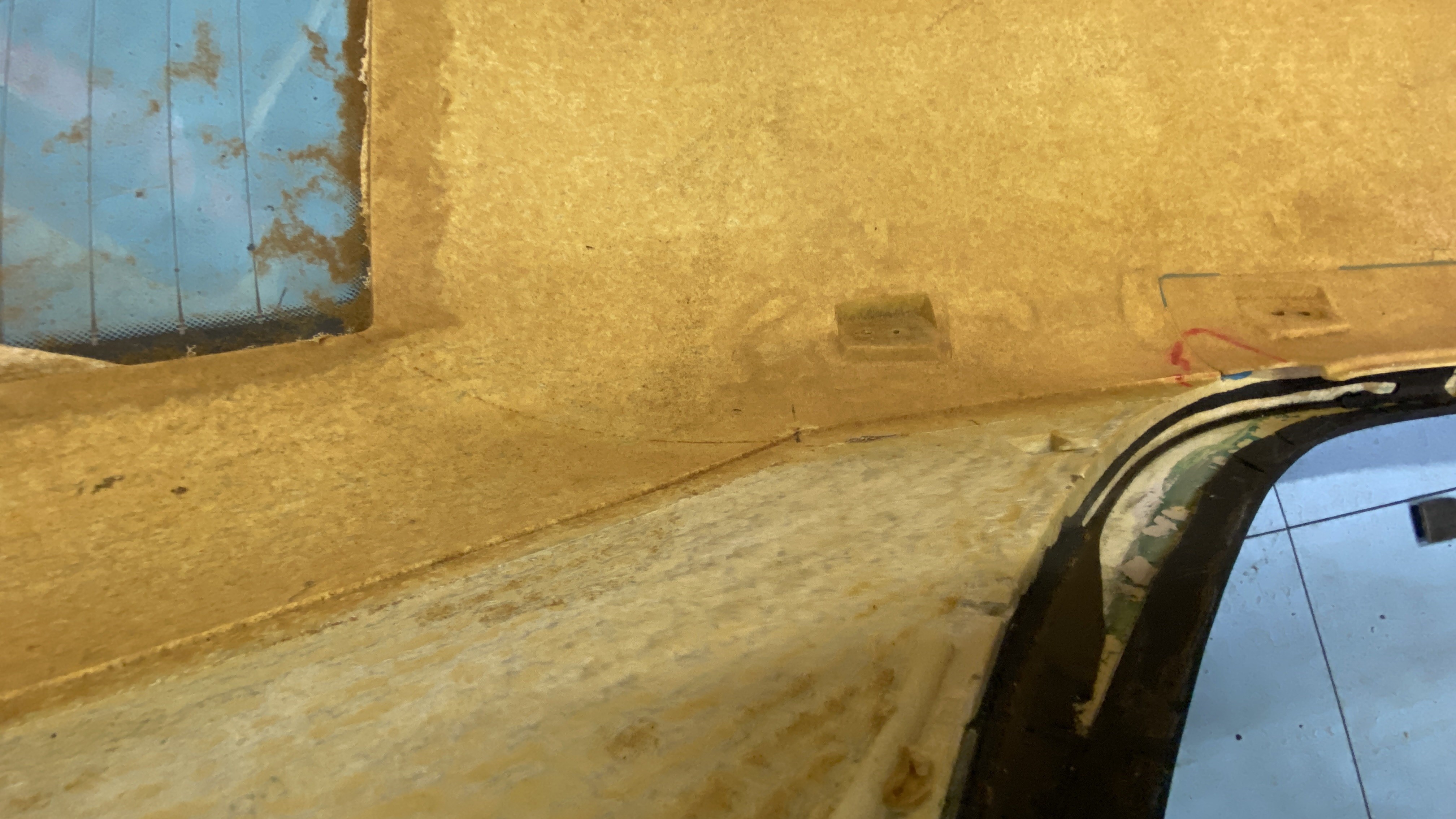

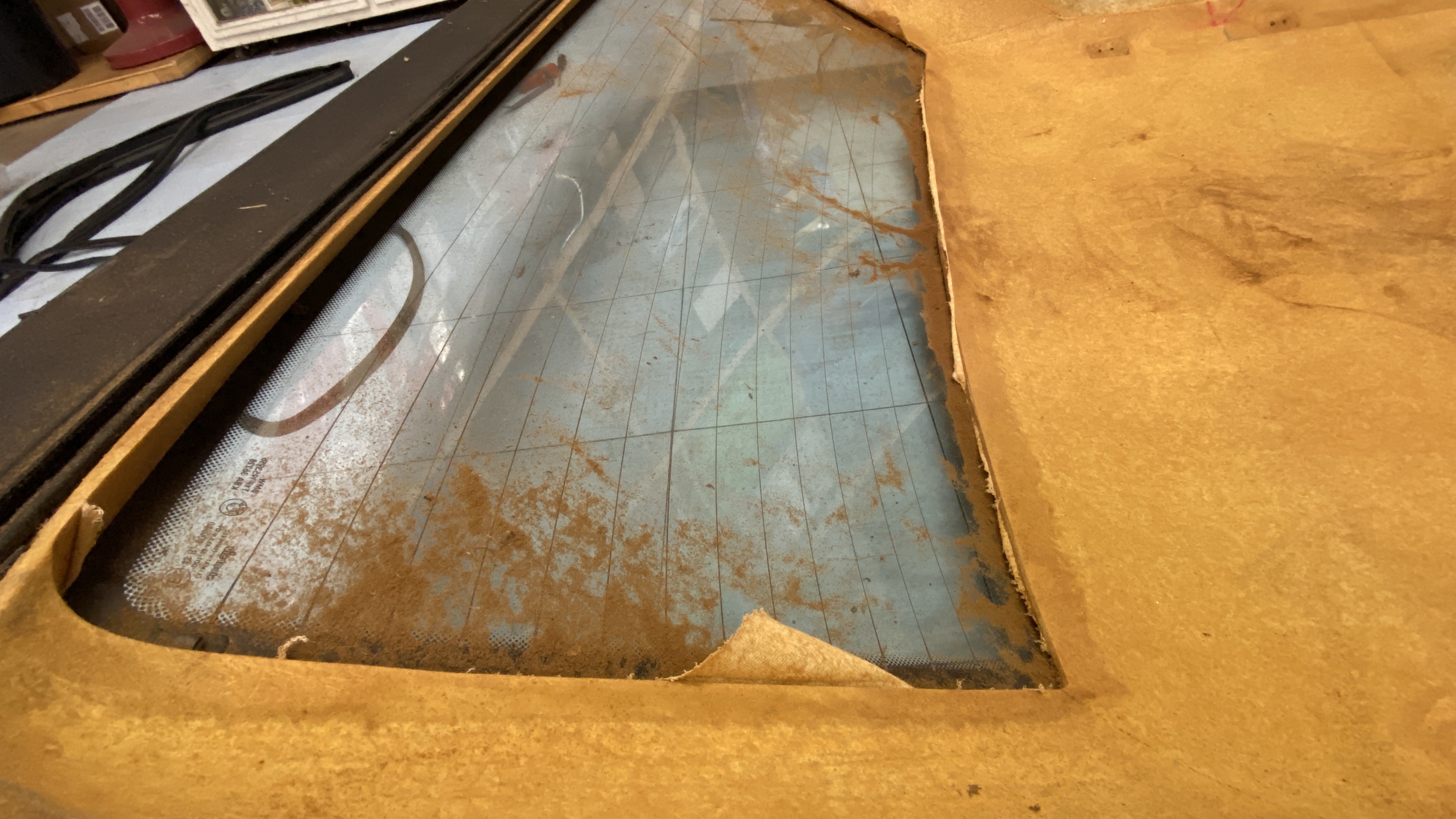

During the assembly, they literally use resin everywhere and glue almost everything in, EVEN if it has fasteners holding it in. Seals, trim, mounts, and fabric are all glued. On the plus side, I inspected all of the seals, latches, and trim and it is all in great shape, just the vinyl and headliner is in visually aging.

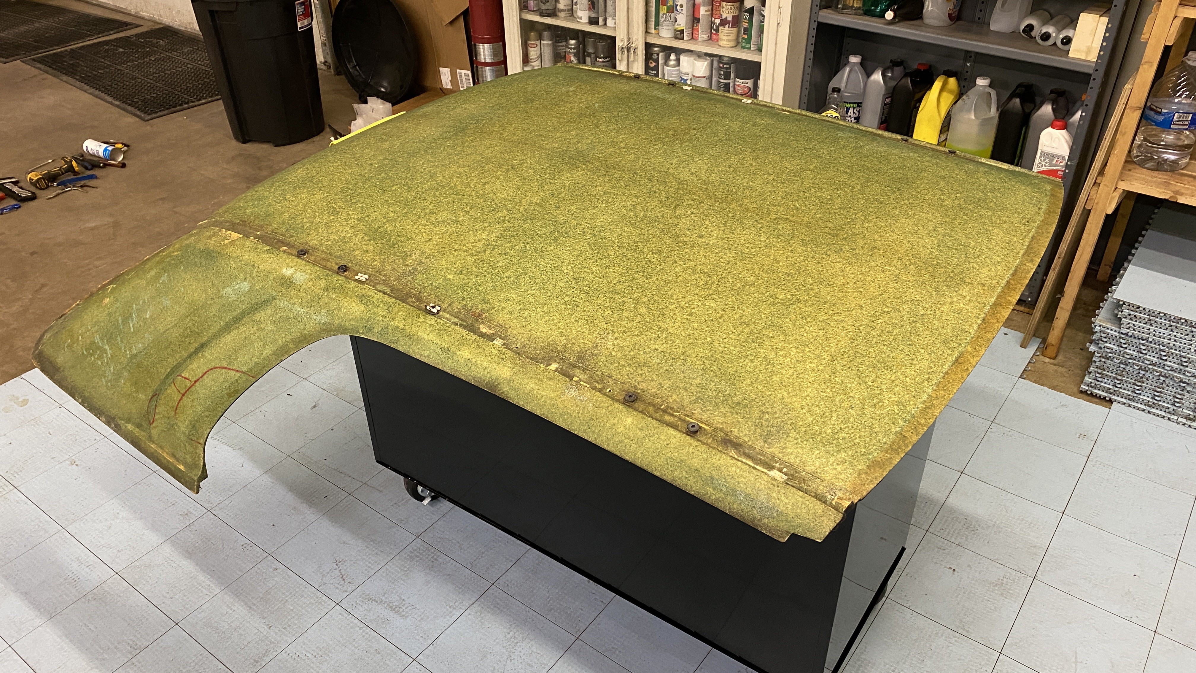

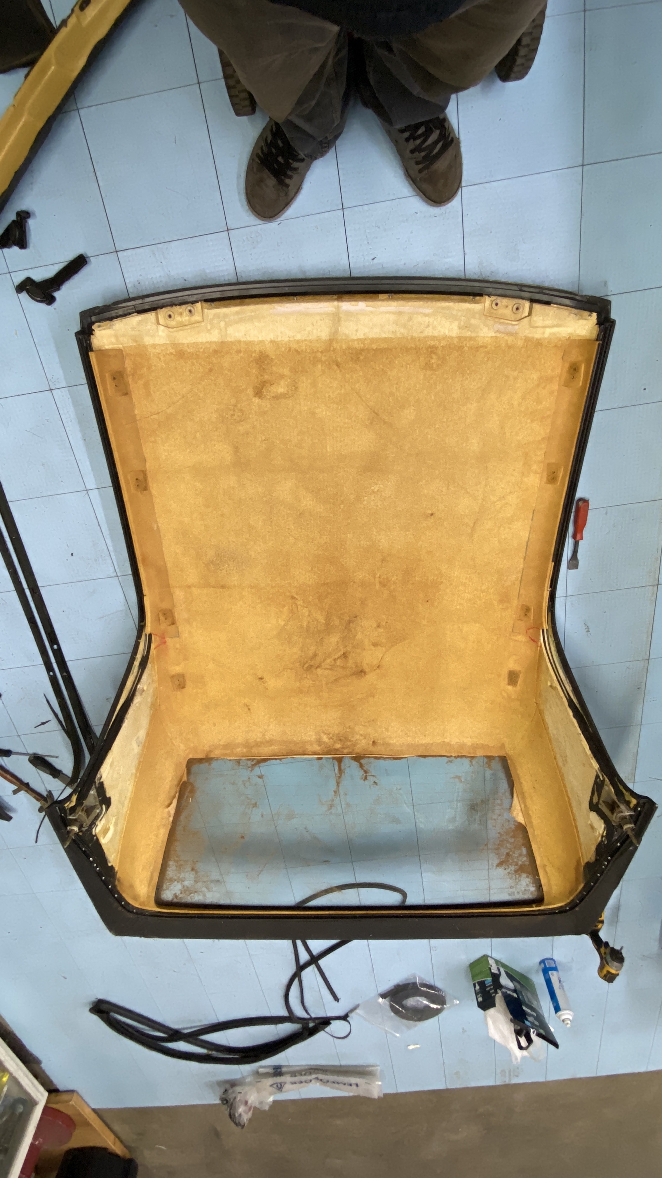

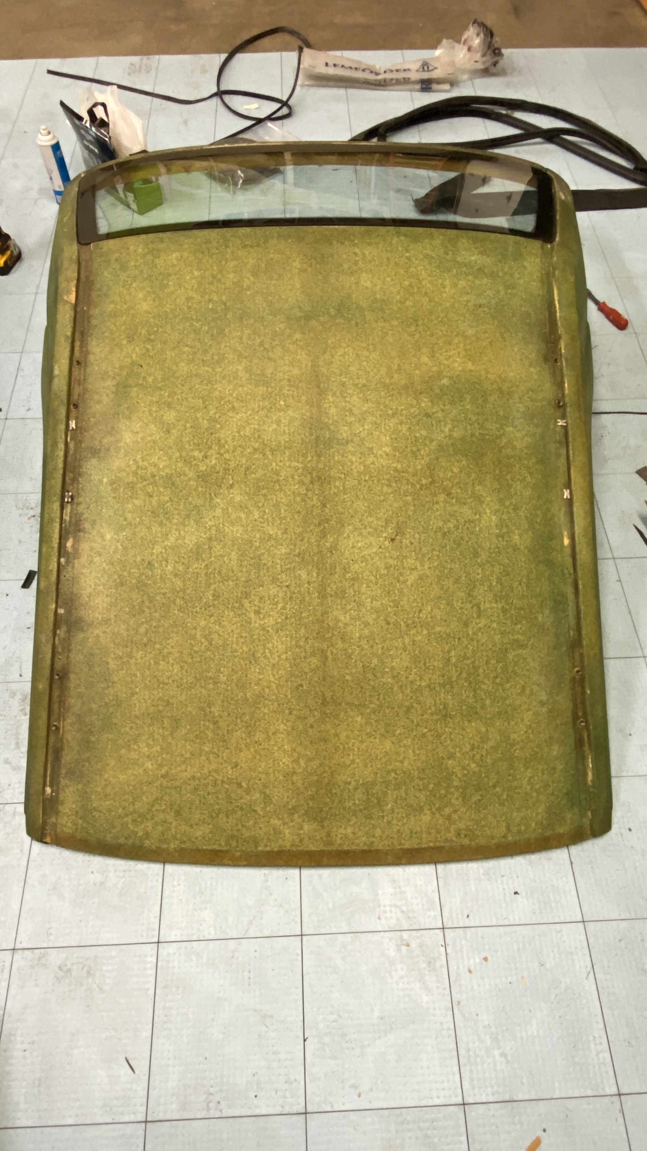

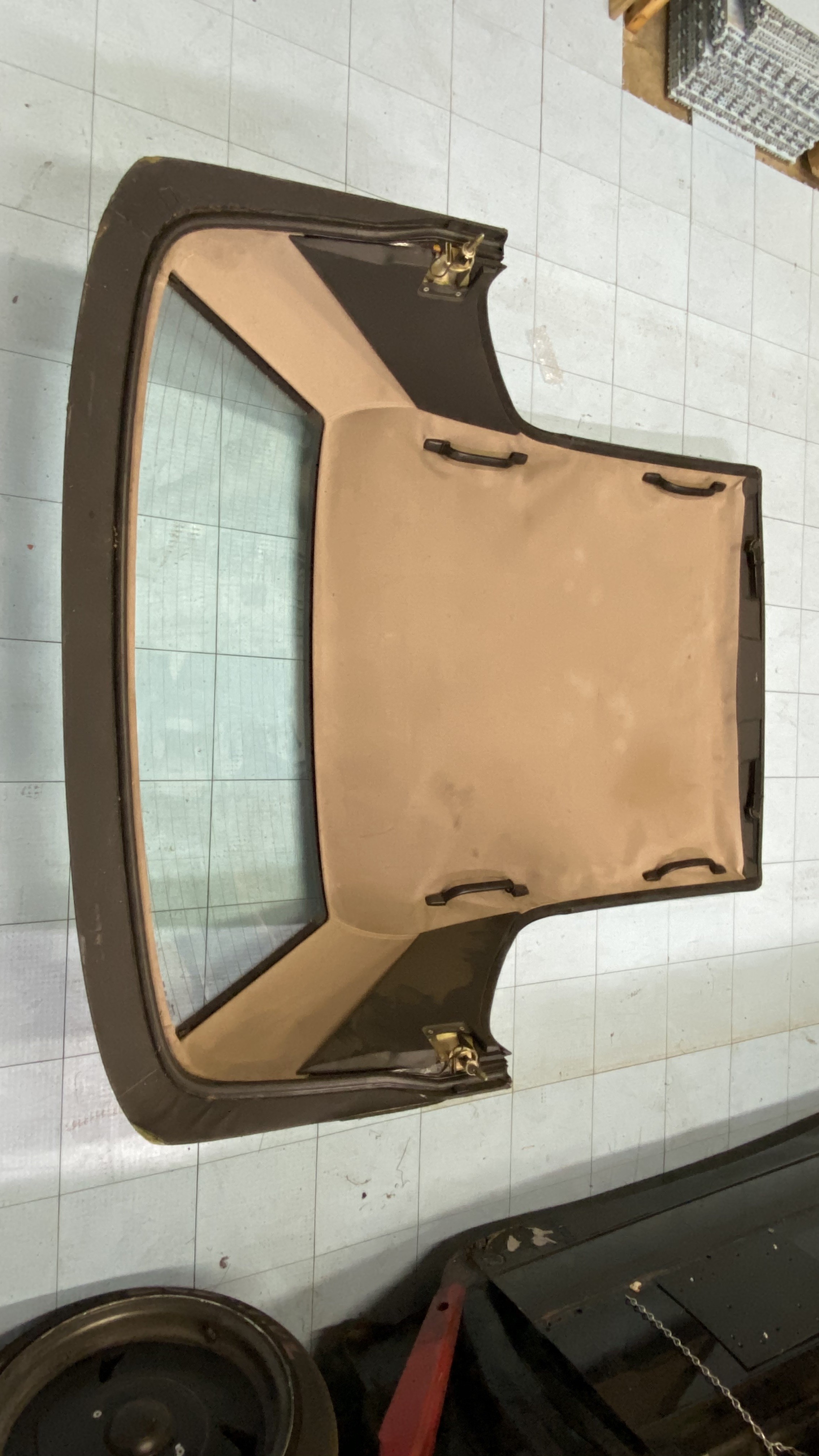

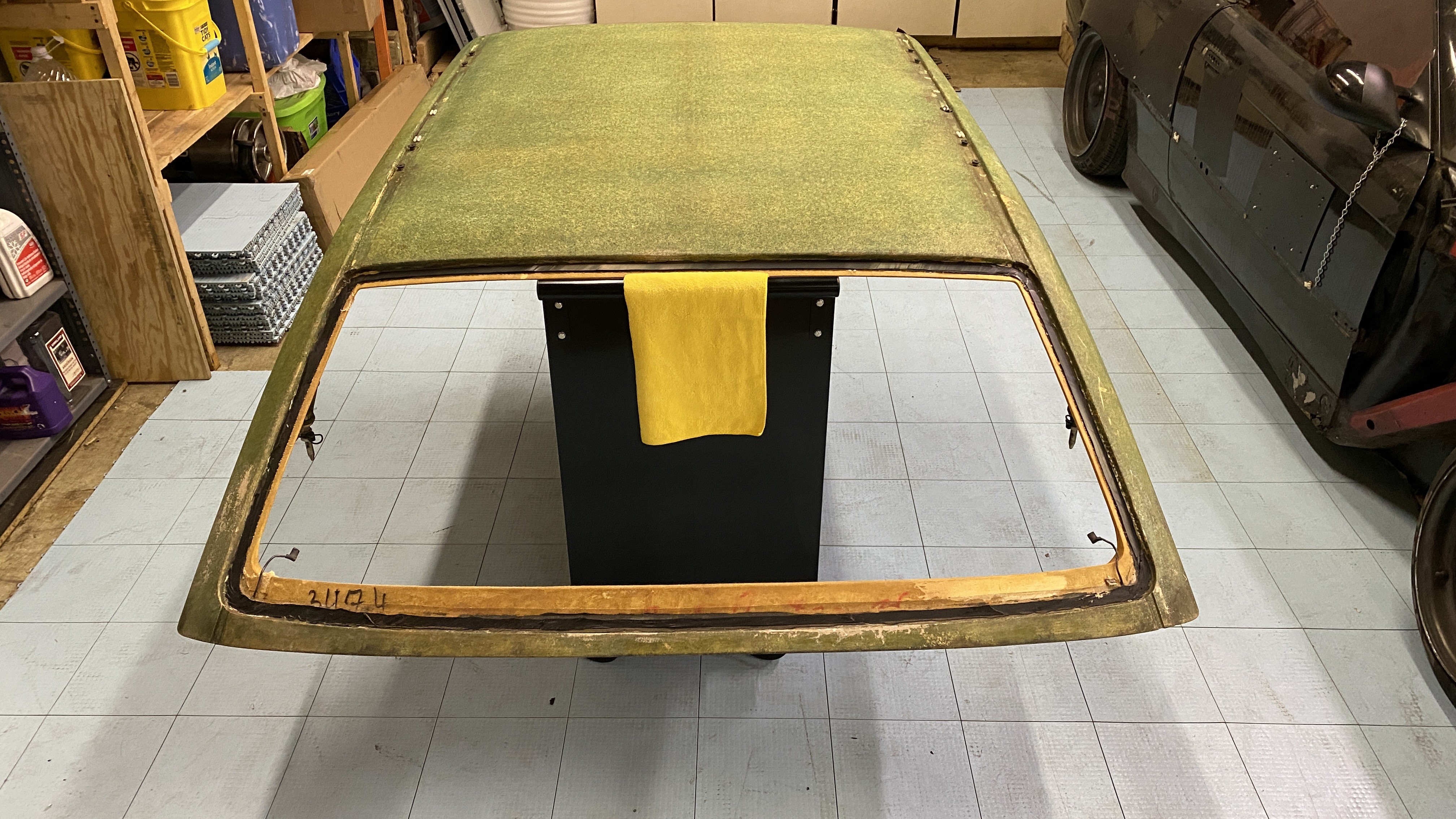

Here are pictures as I dismantled it;

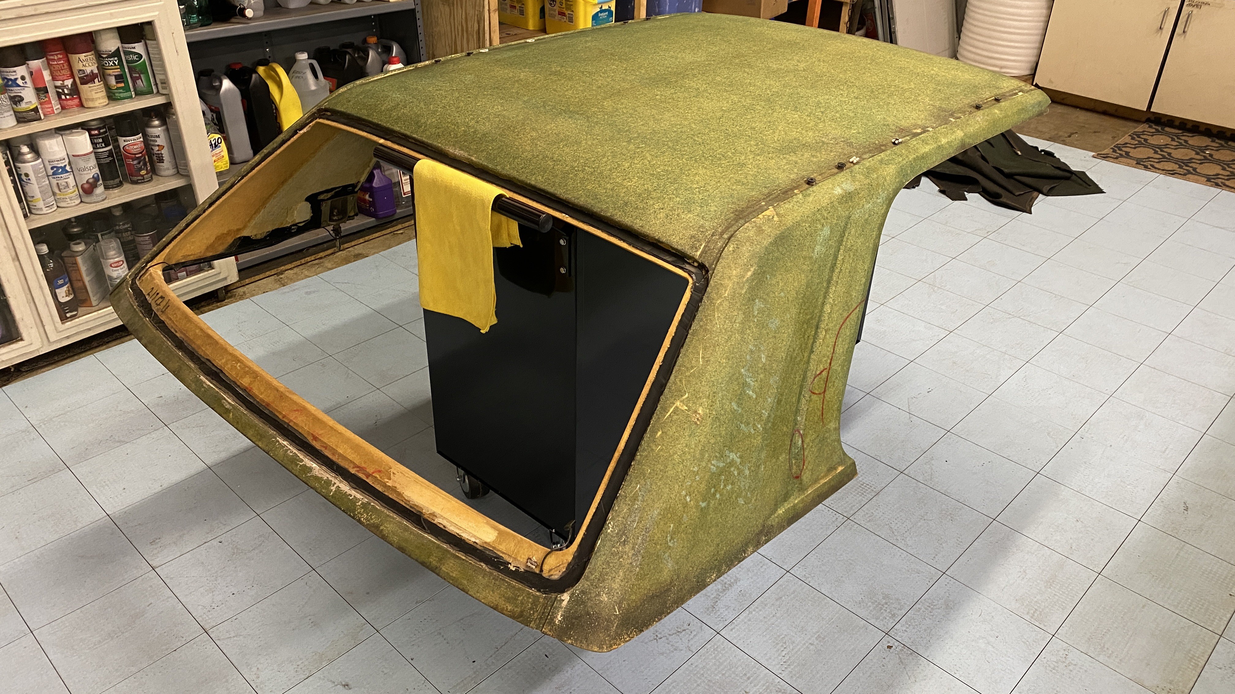

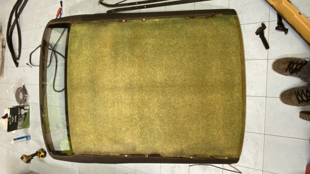

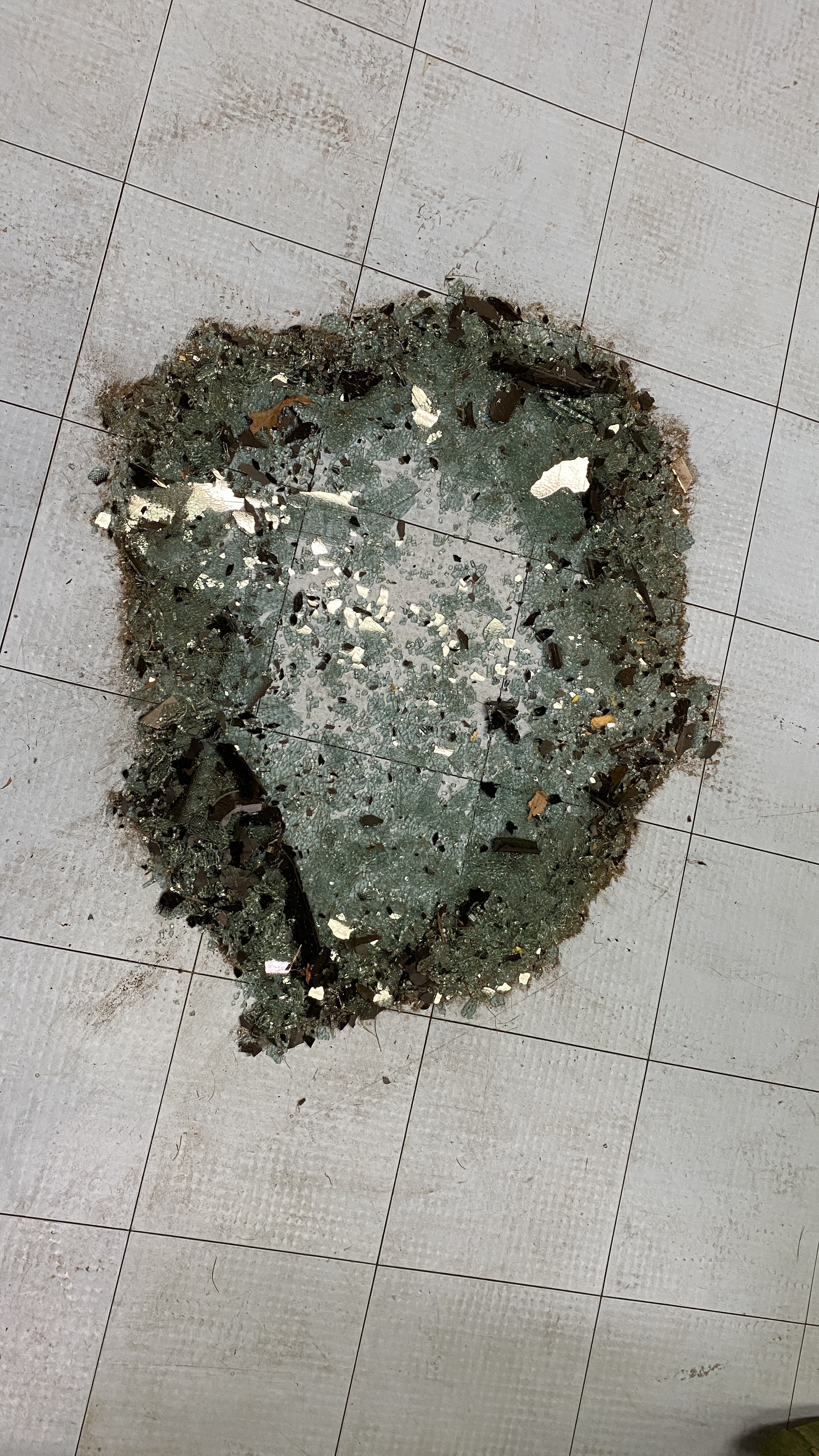

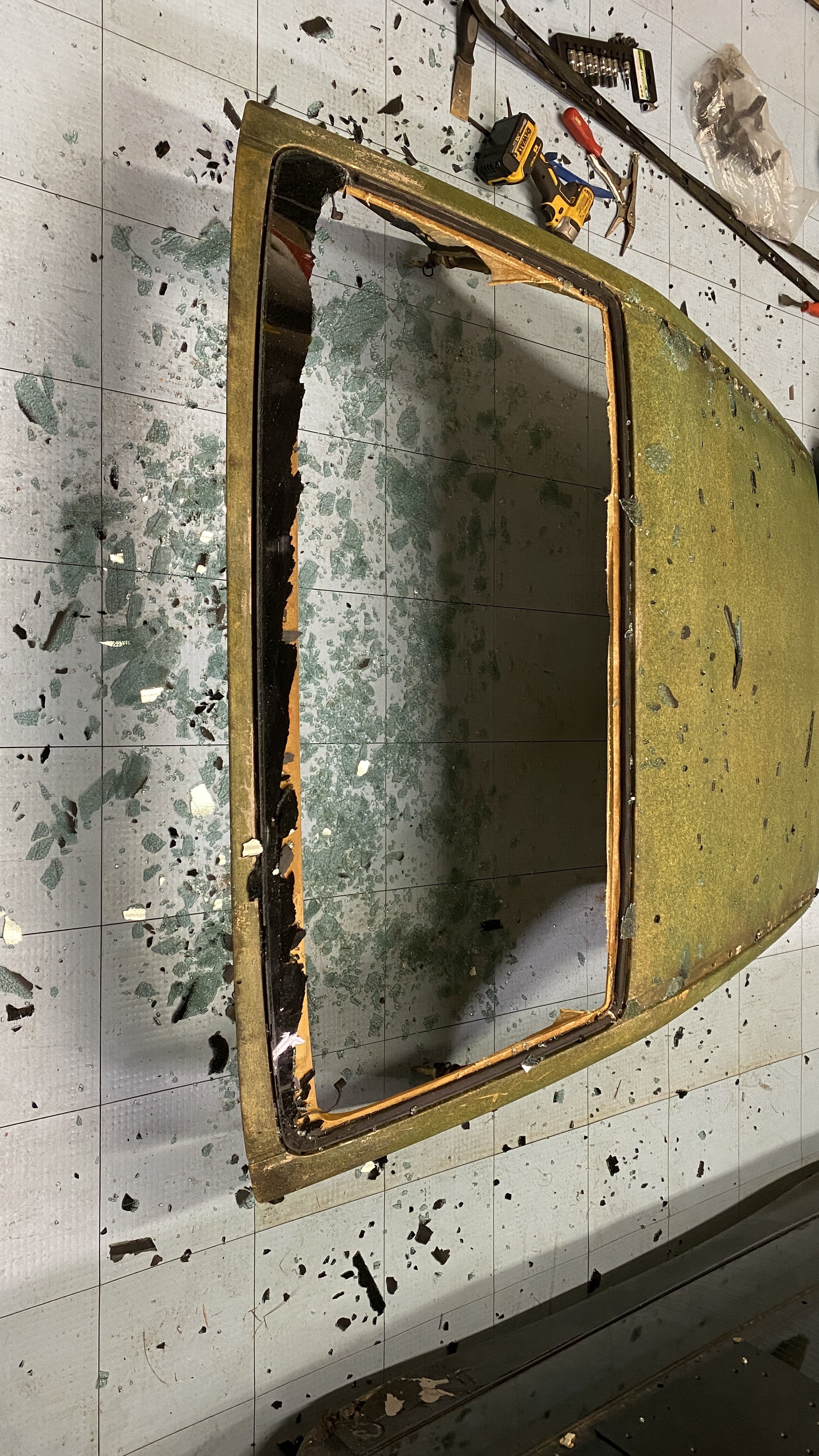

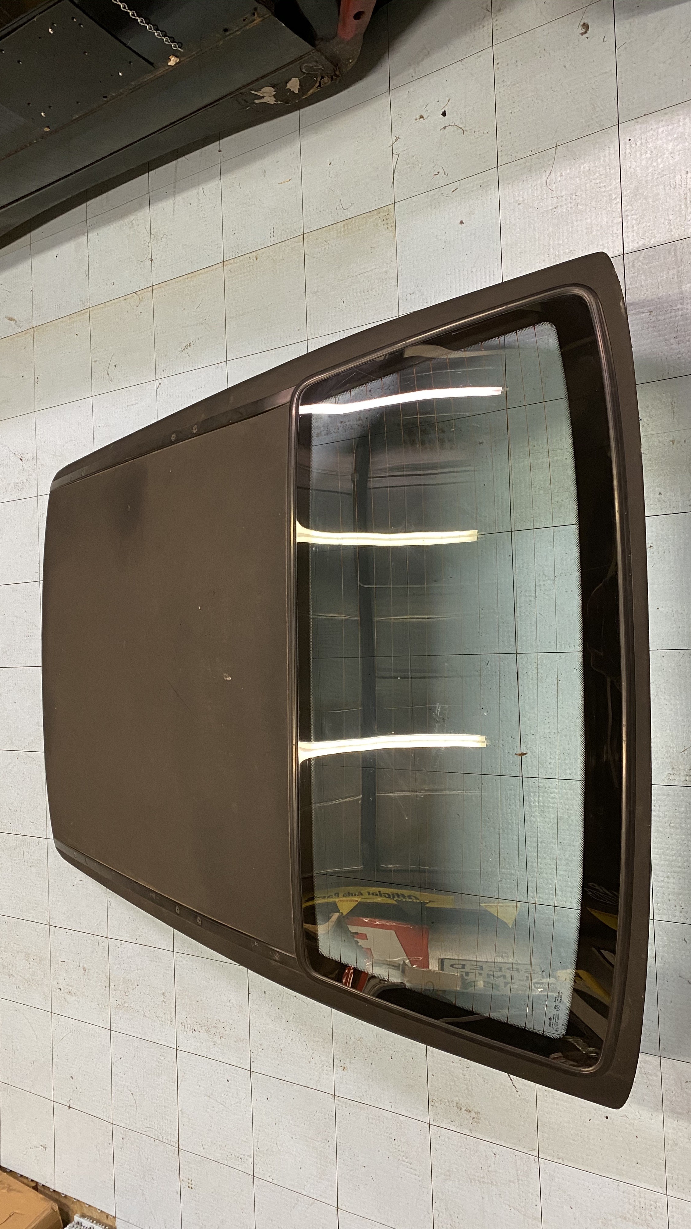

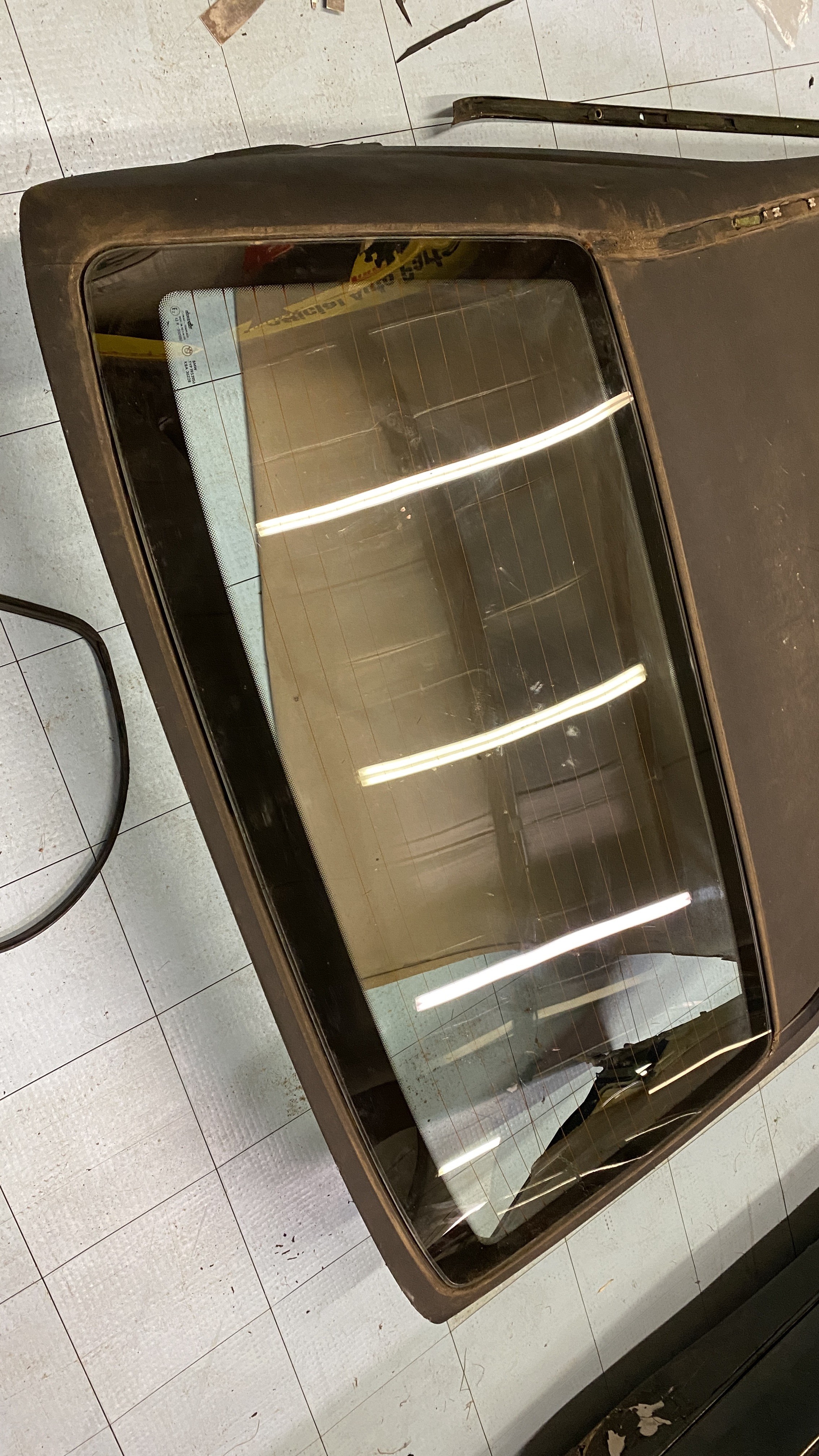

So yeah that happened. I was able to get 3 of the 4 sides completely detached and I didnt think it would be a problem to finish. Although it was a work out as the top wasn't secured to anything, I was holding the top and pulling the carbide through the seal without a problem. the last edge I stopped and determined if I wanted to tape the glass to preventing it from falling or shifting. I removed the tool and stepped back. Heard a loud sealing/suction type noise and watched the window blow out about 5 feet into the air as I was standing about 3 feet away.
I immediately went over to the fridge and poured myself a strong drink.

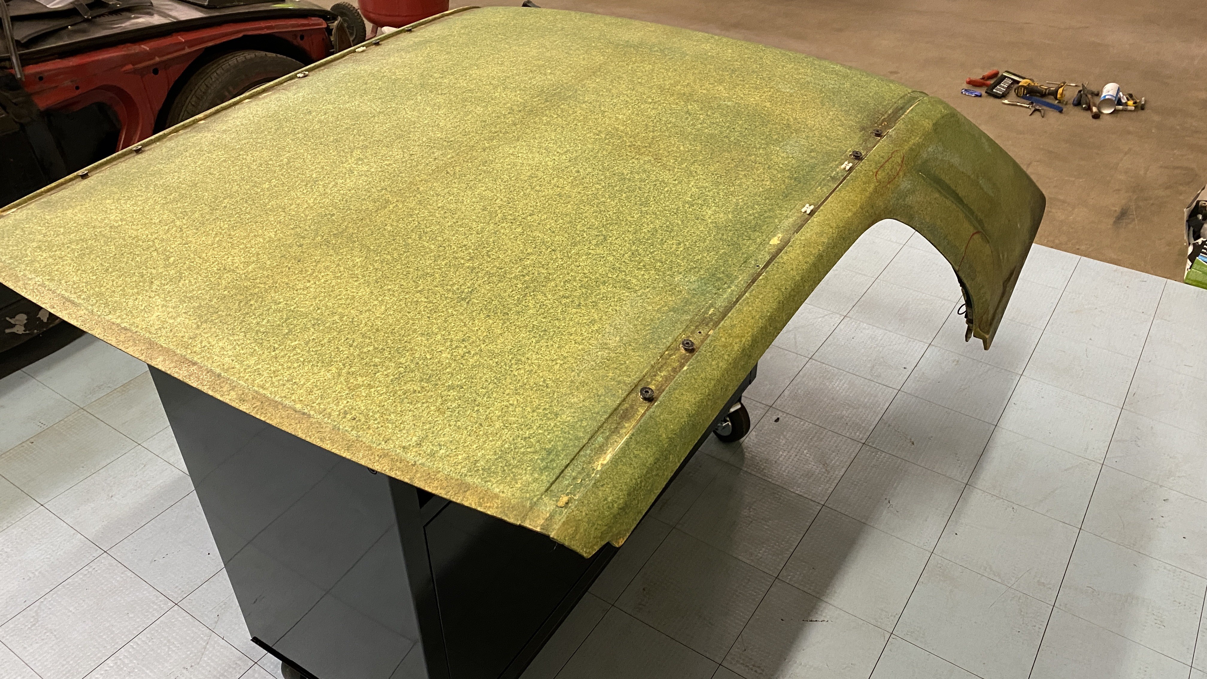

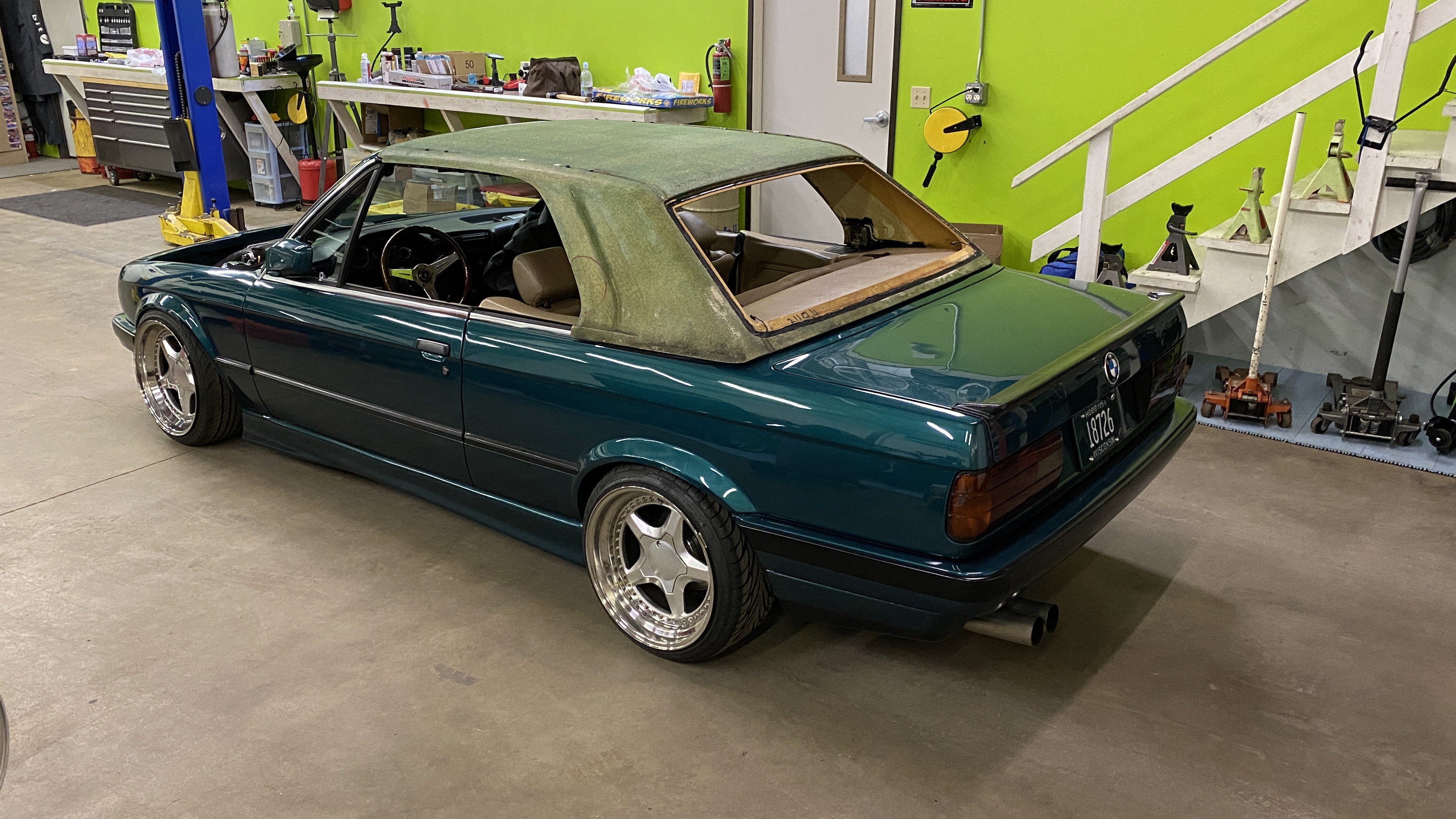

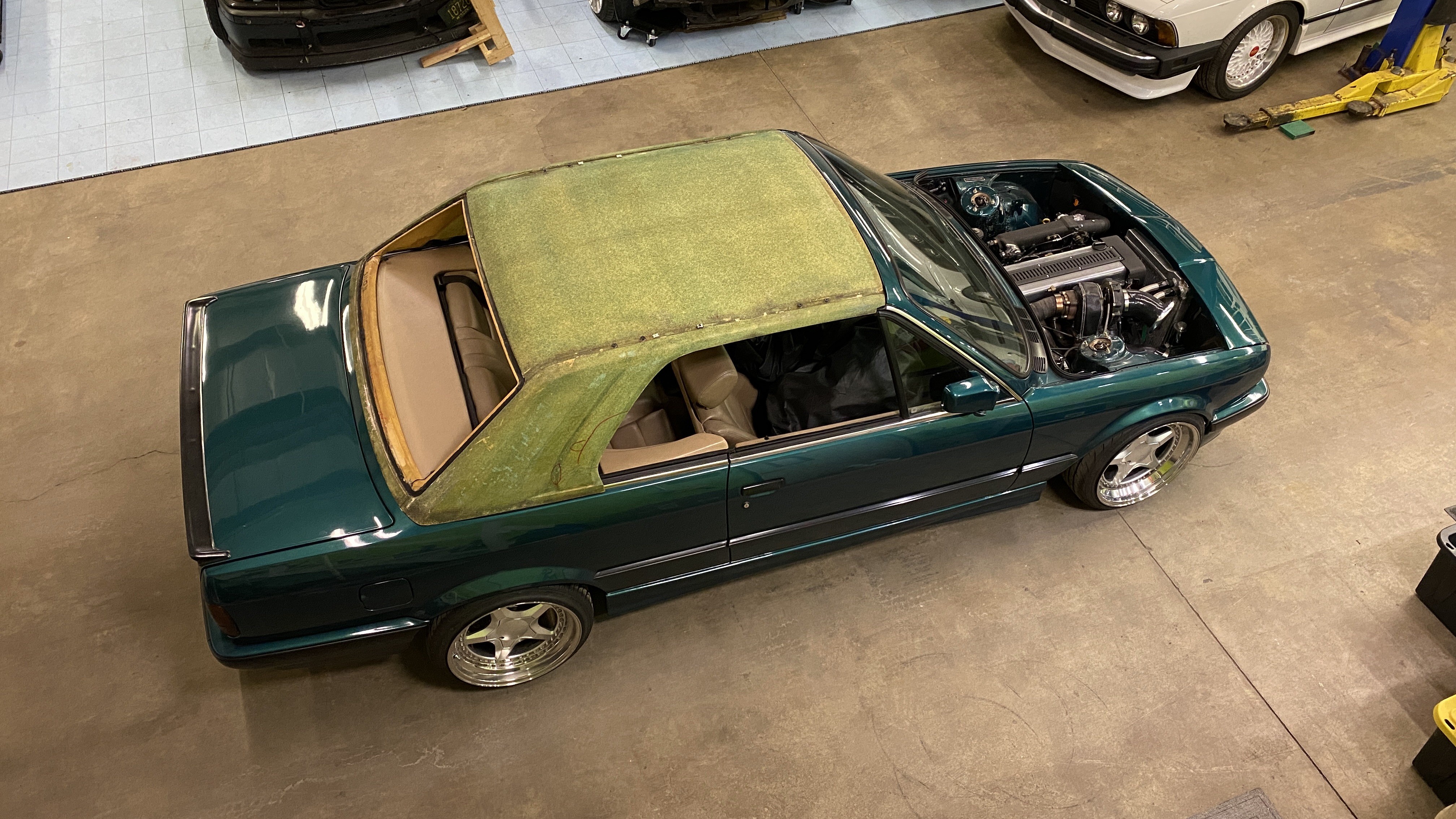

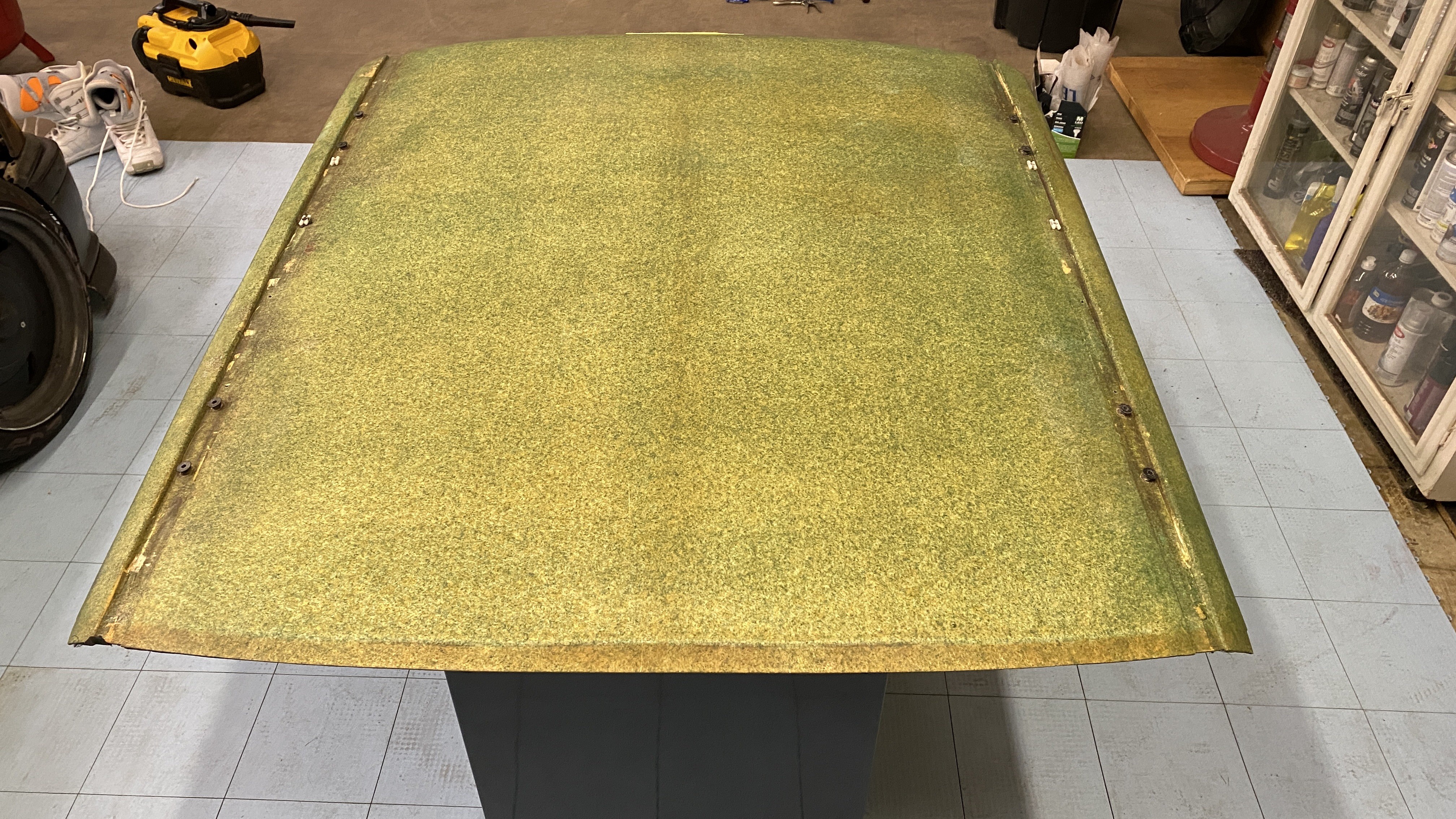

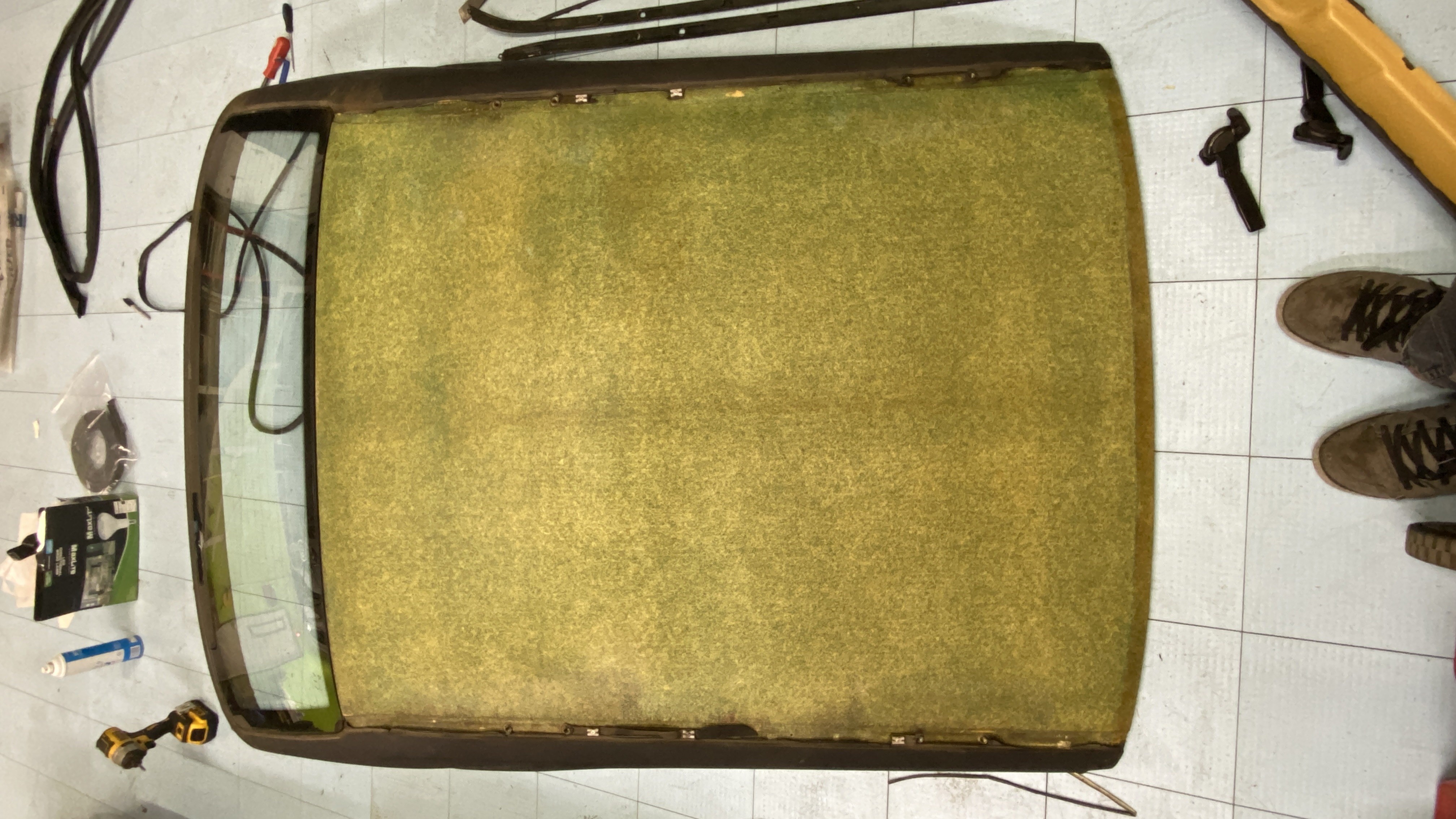

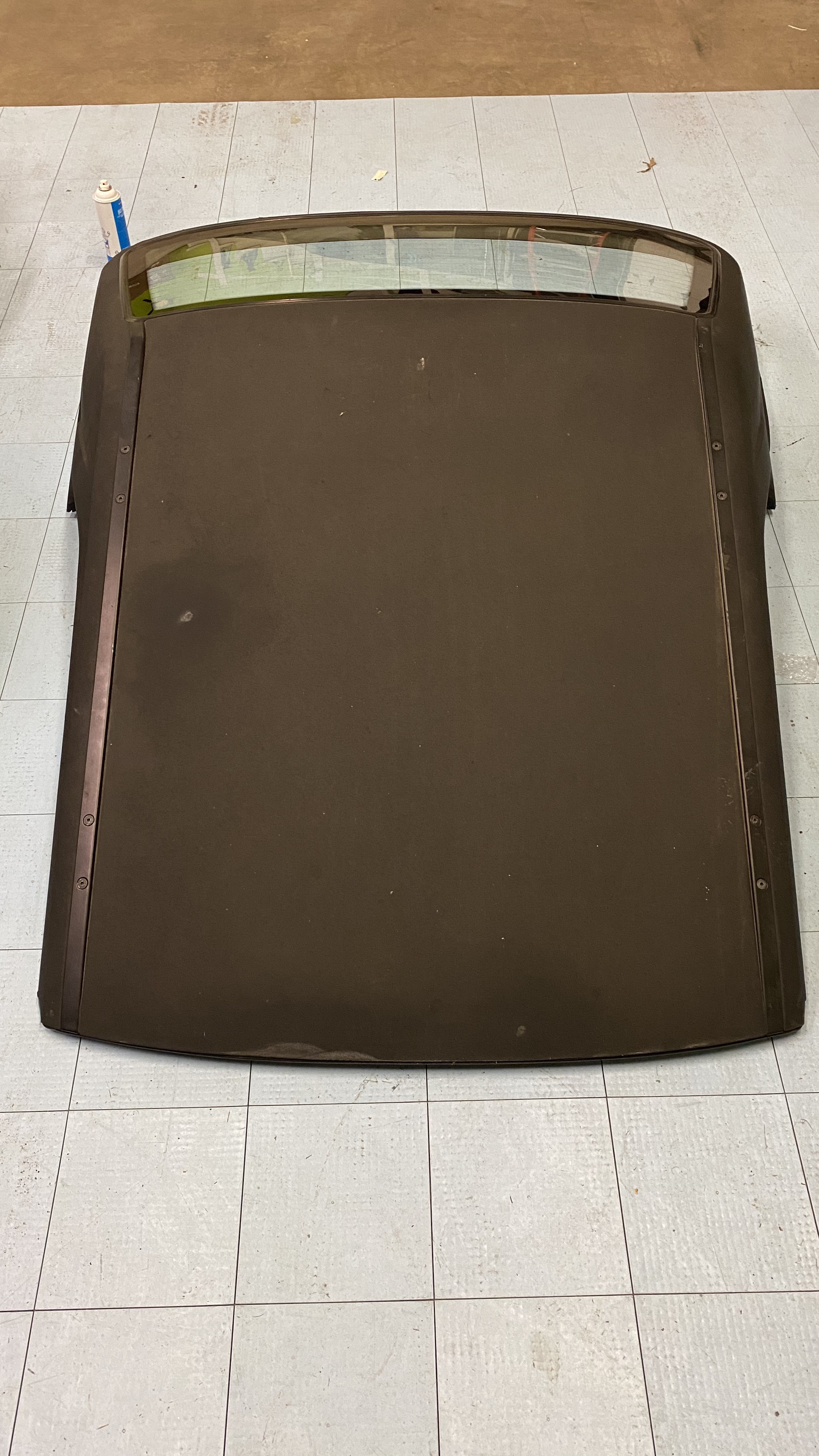

So here is the top now. Its a weird astro turf color which I would like to think is the dye from the canvas.
Must’ve had the rear defrost turned on
