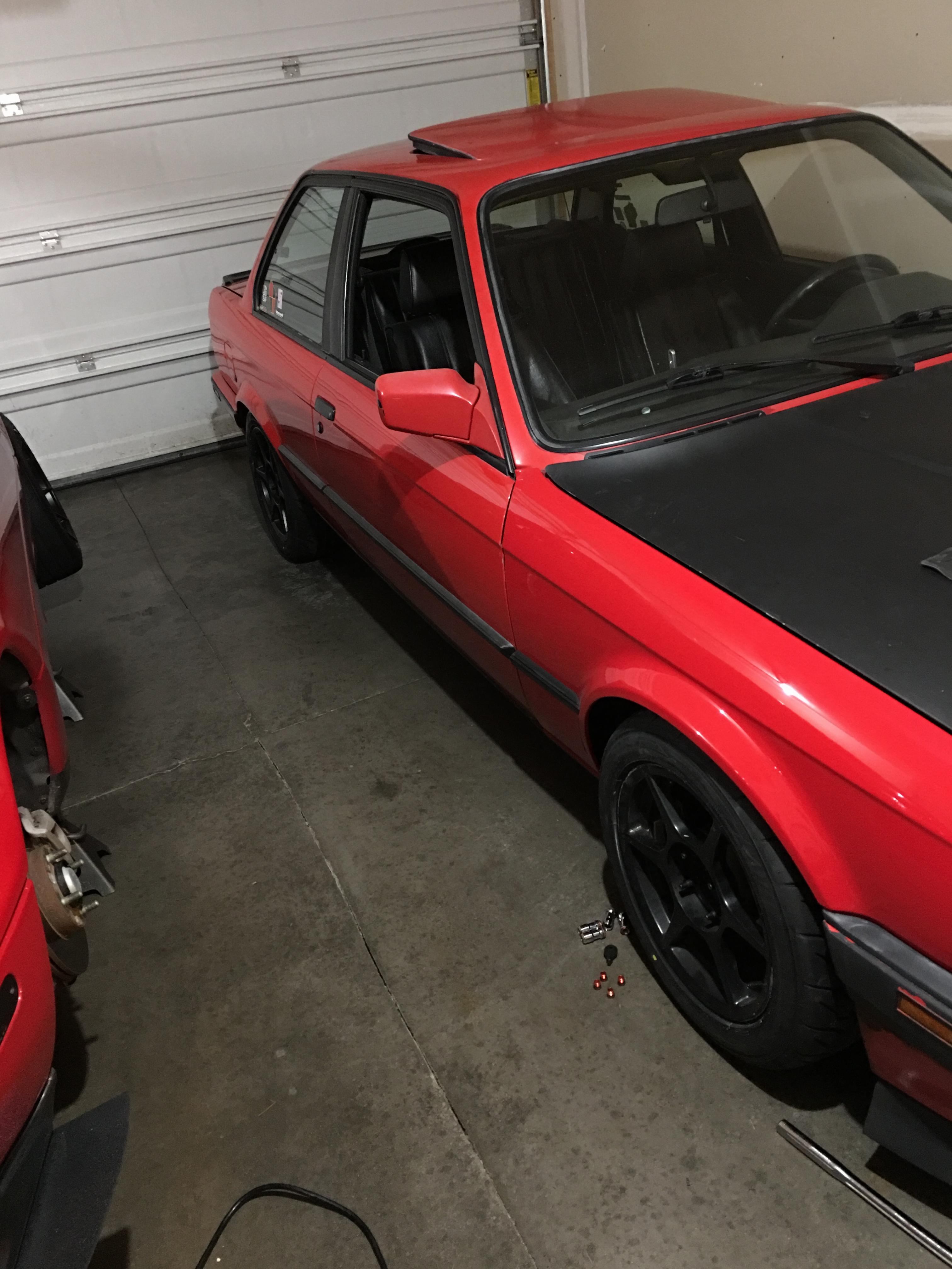

        Great news, the tires grip the garage floor way better. 7822ff974794fa7541f93d3e516a004f.jpg

          Grips the garage floor much better
            #765
            love the meaty tire look
