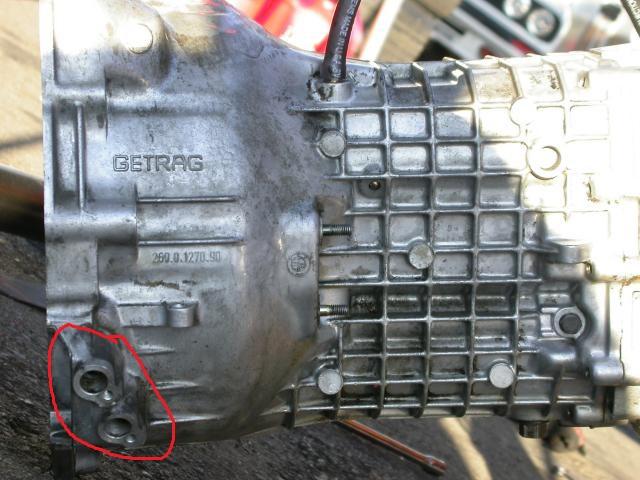

                                          The other problem I ran into last night while talking to Mike was that his transmission bell housing has to have the provisions for the speed and reference sensors for motronic 1 which use the flywheel. The bell housing needs those two holes on the drivers side as circled below. I don't think it will have those holes though because the SETA has motronic 1.1 which moved those sensors to the crank pully.
                                          post-2724-0-08637100-1395263542thumb.jp
                                          So the options for your manual swap are:
                                          • Swap G260 onto the ETA along with the motronic 1.1 harness and required sensors (which would included fixing your harness)
                                          • Swap Complete SETA drive line into the car (again requiring fixing the harness)
                                          • Find a compatible G260 from 1987 or earlier 528e/325e
