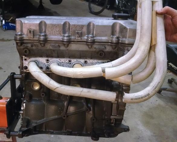

    Craptastic header mock-up v0.2 complete
    The PVC didn't work out as well as I thought it would. I couldn't get it to bend tight enough without kinking, or get a consistent radius bends. Regardless, I was able to figure out how to route things. There's not a lot of room on that side of the engine, but I was at least able to verify that I will be able to build something that will fit in the chassis.
    Still need to get flanges made, but I'm hoping to be able to start round 1 of header fab next weekend.

      filling the PVC with sand, capping the ends and using a little heat while bending helps keep the PVC from kinking. But either way, looking good!
        #145
        That's how they make jacked race headers for boats. They have two tubes, one inside the other, and fill the void with sand before bending. The only difference here is that its PVC and not stainless.
