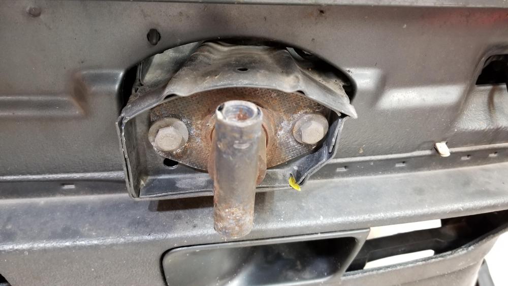

                                  So my front bumper was always a little out of alignment. The PS stuck out further and there was a gap. Can see it here kind of.
                                  Took it off and found these with the mounts. Looks like someone was a little too aggressive when towing the car at some point. 20181104145656.jpg
                                  After beating on it with a sledge hammer it's much improved, but still a little ways to go.
