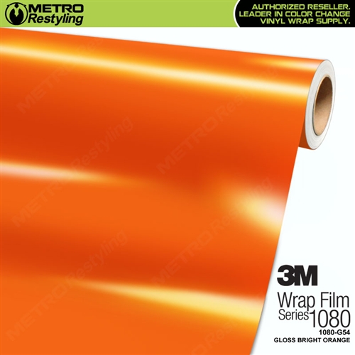

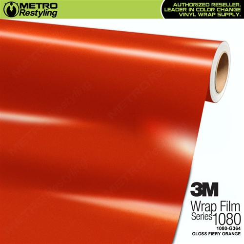

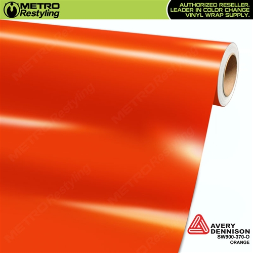

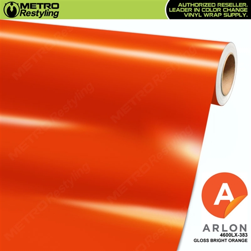

        So I have decided on doing a high gloss vinyl wrap on the car instead of paying thousands for a paint job. I've been talking with a local vehicle wrap company (Diamond Graphics, LLC in Cedarburg) and one of the guys even dropped off a few color books at my house for me to look through. I have been jumping around with colors a lot since I am kind of indecisive when it comes to things like this. First was white, then I thought about an olive green or super dark green, but now I am more dead set on orange. Seeing this obviously helped...
        Looking through the color sample books, here are the oranges that I found caught my eye the most. I know colors look different depending on what type of screen you are looking at them on and so forth, but what do you guys think. Looking for your opinions. I am leaning towards Arlon 4600LX-383 Gloss Bright Orange.

          Have to see them on the car to make up your mind dude
            #350
            That's the thing, holding up a 3" square sample piece still doesn't give you the right visual of what the entire car will look like anyways.
              #351
              You can order enough to do a fender for probably like $60
              • The Full BananaT
                The Full BananaT
                The Full Banana
                #352
                Good call on orange. A shouty body kit calls for a shouty color.
                  #353
                  Personally I'd go with one of the 3M vinyls just because it's gonna be a better quality. You should also just put all the jägermiester logos on too!

                      3M G14 gets my vote also
