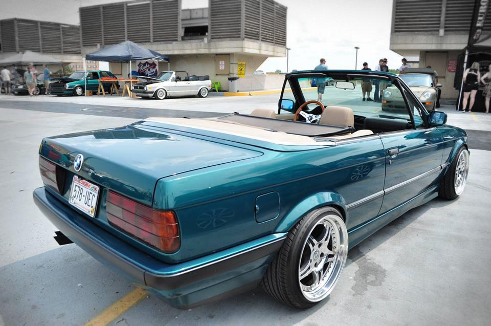

                                          Someone was nice enough to shoot some really nice pics of my car at Dubs in the Valley!!
