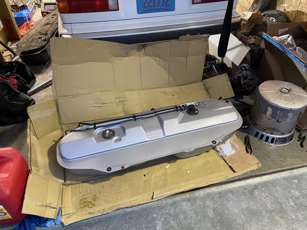

    Got some more work done today, but more of a one step forward, 1.5 steps back deal.
    I successfully pulled the tank, no thanks to the engineer that specced those horrible ass crimp fittings to all the fuel lines (I have choice words I’d like to use, but won’t). They do their job fine but are such a pain when it comes time to replacing and removing things.
    Anywho, got the tank down, all the lines and senders/pump and whatnot transferred to the new tank. Fit was pretty solid, the new mounting grommets fit in snugly, the sender and pump fit tightly, and all bracketry mounts right up. My only gripe is that the tank thickness appears to be different between the replacement and OEM one where the senders mount, so you cannot use new OEM o-rings; thankfully, they include slightly thinner o-rings in the packaging, but something worth noting. Otherwise, barring the lack of drain plug everything seems to be more than up to snuff. The holes all seem to line up well with the mounting points on the body, finish is nice, all the inlets/outlets are in the correct spots. Honestly, if they had painted it black, you could’ve told me it was genuine BMW and I might’ve believed you.

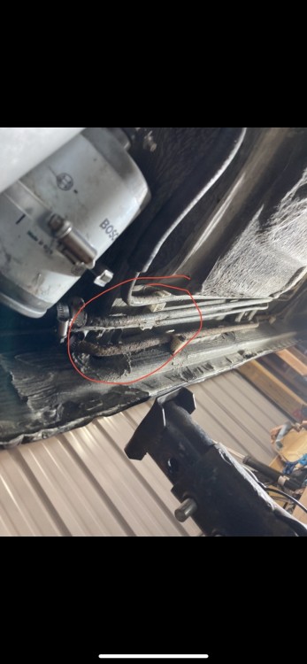

    So that was a win, but when disconnecting the fuel lines to remove the tank I noticed that my fuel hard lines were pretty crusty.
    So those need to be done. I have no desire to burn this car down or worse, and it seems foolish to not take the opportunity to fix it all while it’s disconnected. In the same vein, I noticed the rear brake lines were also getting pretty gnarly. I replaced the hard lines on the trailing arms a few years ago but never touched the soft or hard lines upstream of that, and they’re pretty bad (soft lines have hairline cracks, hard line junctions look like they spent time on the titanic, etc.). So the plan is to either buy all new OEM hardlines from FCP and bend them myself, or install the ChaseBays hard line delete that just runs soft lines all the way back and to the trailing arms. It takes it down to three total lines for the whole rear brake system after the ABS pump, and I’m weighing whether the cost is worth the simplicity it adds. Any thoughts? Potential concerns about longevity?

      Depending on your OCD level, oem steel line is gonna be hard to bend making it that much harder to match up. I’ve always gone with copper-nickel for it’s ease of use and even then it’s hard to match the curves/angles. If you wanna make your own lines, I have the Eastwood flaring tool which makes that job 1000% easier. The only difficult part I remember from that job on the calypso was the 3 way tee in the rear took quite a bit of work to remove and clean up. The flares were seized for us at least so had to cut the line short and put the tee in the vice to use a socket on the flare. Idk if those tees are available new but that would save a lot of work too.
        #125
        Noted, good to know. I’m perhaps unnecessarily wary of flaring my own lines, but it’s an option for sure. Might’ve been the shitty kits I used in the past though too. Bending the trailing arm line wasn’t too bad from what I remember, but I suppose these lines are a bit more complicated. I’ll let you know! It’s probably going to come down to price, if the OEM lines and fittings come out to be more than $150 or so I might just get the chase bays setup to be done with it.
          #126
          OEM lines don’t show up pre bent, at least for the long run to the rear brakes
          on my old red e30 I ran chase bays line for the main rear run, it was quick and easy
          my current car I went the copper nickel route and re did all the front line and flared stuff. Also super easy to work with
            #127
            ^ thats the same tee used in the stock position in the rear. I hear ya on the diy flaring, you’re right though the tools have always been the problem. The split die style flaring tool makes perfect flares about 95% of the time. The only time it doesn’t work is because the line wasn’t square. Remembering to put the flare nut on the line is the hardest part 😂
              #128
              That is the exact part for the rear T lol, wanted a m10 bubble flare fitting, figured that would be the easiest to find 😁
