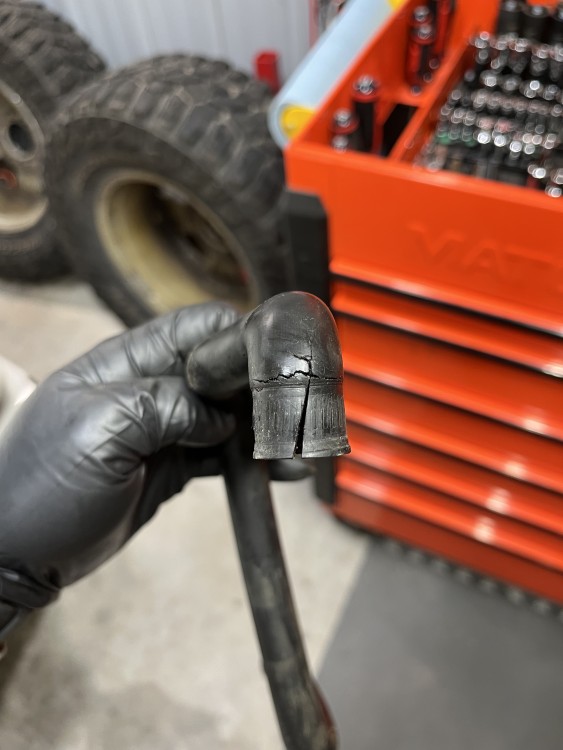

      Had a minor snafu with it running though on initial start. When I first lit it off last week it was idling super slow but Infigured it was just from time sitting and would quickly adjust, but no such luck. Got a CEL, read it via stomp test, and it came back as an “Injector Batch 1 Fault”. Some quick research pointed to the C191 connector under the intake manifold as a likely culprit, especially since I wasn’t able to separate it despite a lot of trying when the engine was out.
      I pulled the boots off of the connector and immediately saw major corrosion, and made the executive decision to just cut the connector out. It turned out to be the right call - I had to pretty much destroy the connector on the bench to eventually separate the halves. I spliced the wires back together, and lo and behold, running on all 6 again. Idle is a bit slow and it stumbles a little when recs return to idle, but I’ll chase that in time.
      Drove around for 20 minutes, bled the cooling system, checked function of all major systems, and it all seems OK. Next steps are interior and body reassembly, then I’ll get my skidplate welded and be good to go!

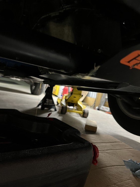

                    Oil change: 208,357. Used a Mann filter and trying out the Liqui Moly Classic 20W-50. Seems okay for a car of this age and appears to have a little more ZDDP than standard Castrol GTX, and falls under the FCP euro lifetime guarantee, most importantly. It’s not like M20’s are overly picky about their oil.

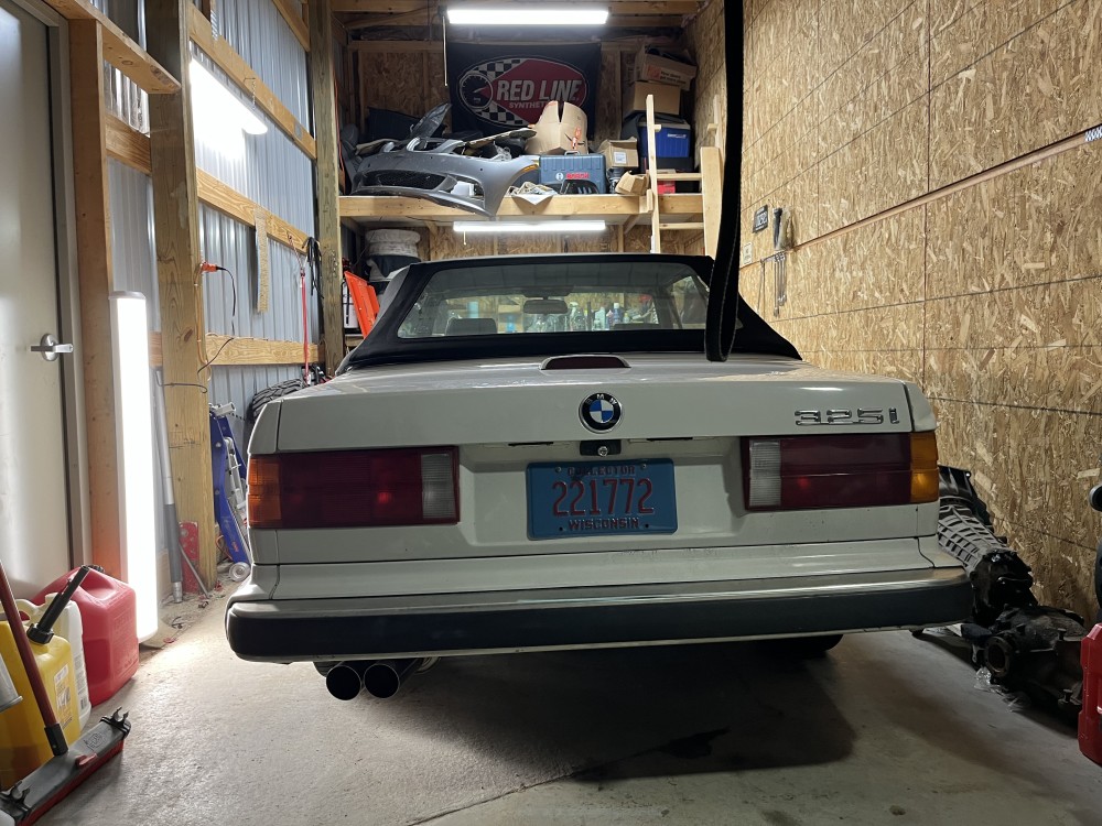

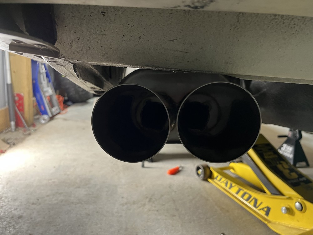

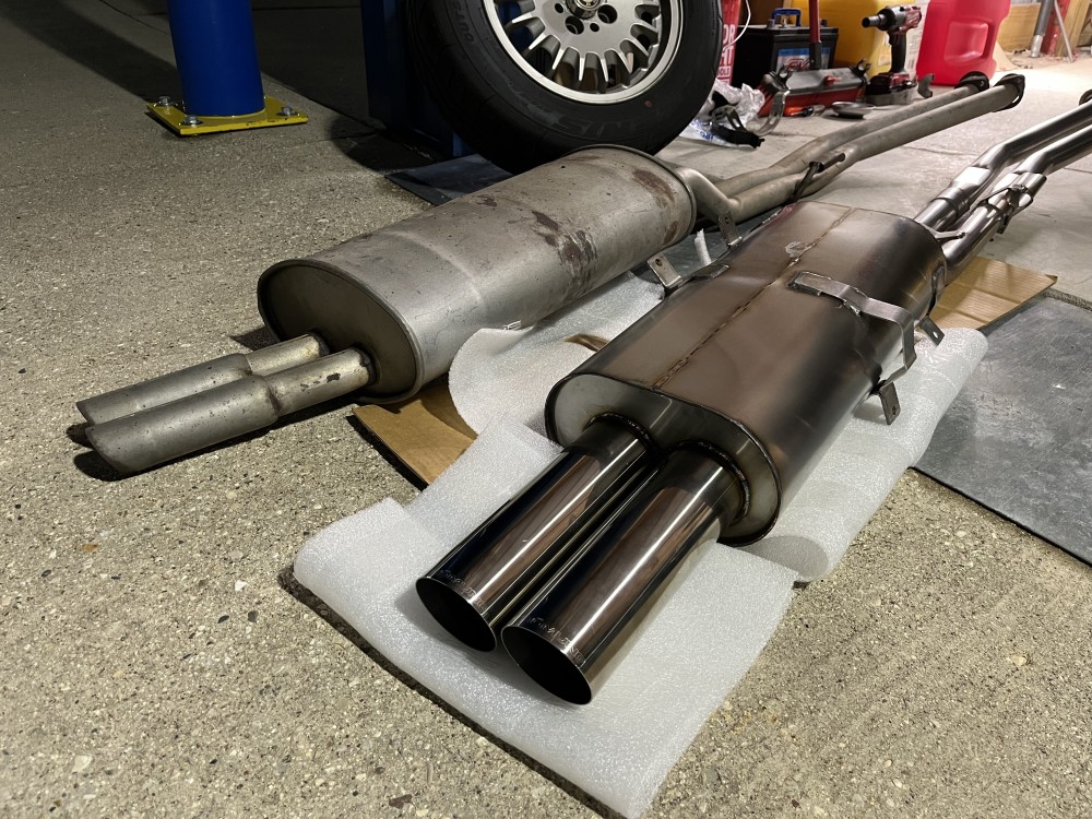

                    Also installed a new valve cover breather hose, and most importantly, my Strömung catback!
                    The perforated old one that despite being so rusty it sounds like a maraca, weighs a good 10lbs more at least:

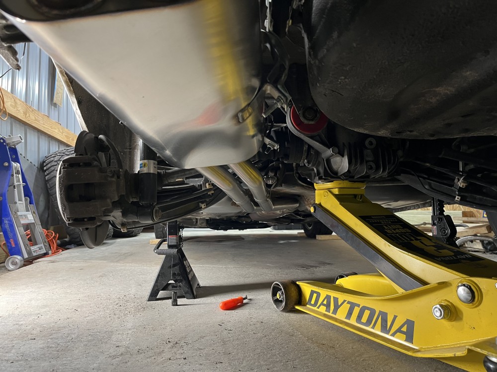

                    Bonus pics of my skidplate that saved my trip:

                        The hikfab plate has saved my pan so many times, it owes me nothing. If it’s bent bad you can straighten them in a press (ask me how I know)
                        Glad to see the car made it relatively unscathed

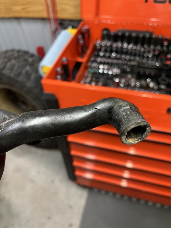

                          - New oil dipstick o-ring, the tube is dirty and im assuming the crankcase pressure is just enough to blow oily air past that o ring.

                          Skidplate hit I took on Shenandoah from a fat ass rock. The HIKfab plate saved my trip and maybe me - oil on the tires where I hit it might’ve sent me off a cliff.

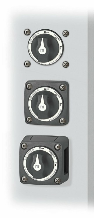

                              No, I mostly want the room to install a dedicated battery cutoff with a nice mount plate and maybe a heat shield. I keep nuking batteries in the fall when I forgot to disconnect the battery; there’s a parasitic draw somewhere and I’ve never worked that hard to find it. I hoped the new radio would do it but no dice. This is the battery switch I plan to use:
                              It’s a marine rated switch and we use them on all our ski team boats; some have had them installed for 15 years in what I would call a pretty brutal environment (vibration, heat, water, cold) with zero issues. This car used to have one of the screw type disconnects on the terminal and it sucked.
                              I’m envisioning doing a flush mount in a bracket similar to this, mounted right in front of the strut tower so I can reuse the factory ground location. I’ll have custom cables made (and probably put them in some sort of cable hider, maybe something printed?) so it all works and looks fairly OEM.
