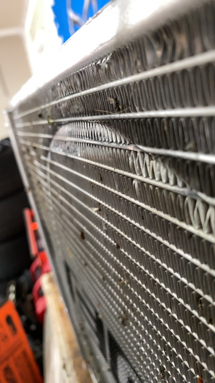

                Ok so found the leak, radiator apparently bit the bullet 429BCDC2-0315-42F8-869D-0EE40BB4DC9F.jpeg
                really odd spot, right in front of the tstat housing, which is why I thought it was the tstat housing
                not going to mess around having it fixed, went ahead and ordered a z3m mishimoto xline rad. Thicker core and more coolant capacity. Also got some more adhesive foam so I can better seal up some remaining gaps from my first go around.

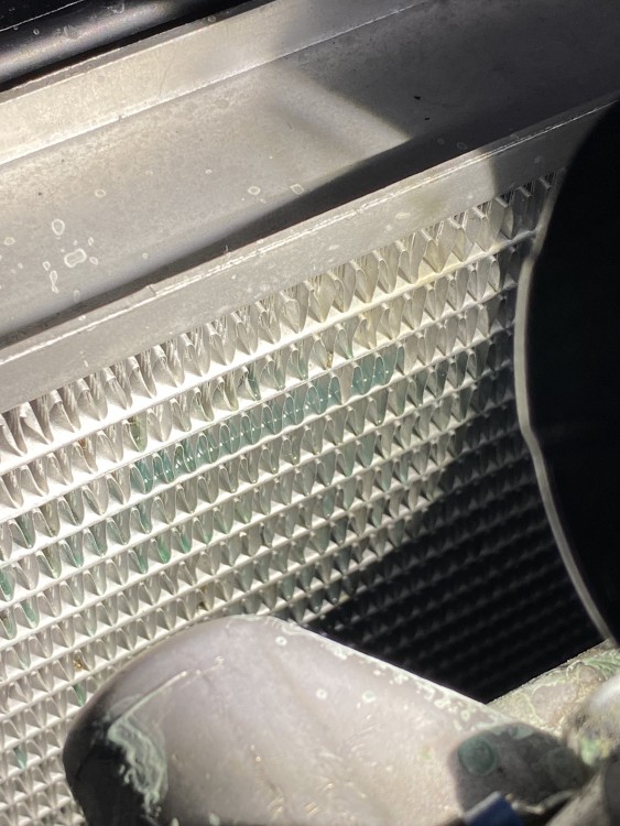

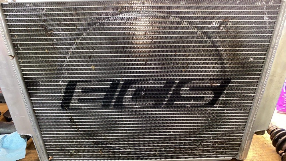

                                Confirmed radiator was the issue lolA799A74C-66C0-4B10-97A4-2BFEA2F05017.jpeg31A8CECD-FFC8-4414-8E20-D6C0C0C072B8.png
                                must’ve hit something during the trip that made the fan push into the rad at a funny angle.
                                ordered a new 14” curved blade pusher fan To replace the 16” straight blade pusher. The fan will now be able to fit in the opening of the core support without hitting the top or bottom of the support (the 16” fan shroud hits the top of the core support by like .5”)
                                here’s a different in core sizes
                                I have some hoses on the way that I’ll be trying to make work

                                  That thing is quite thicc!
                                  Don't brake too hard!
                                  Looks like it should have plenty of cooling capacity though. What hoses are you attempting?
                                  Did the e36 hose have too much of a back bend to it?
                                    #358
                                    Poly mounts will keep the engine from visiting the radiator.
                                    The outlets on the rad are now like an inch further back in the bay which kind of makes the angles funky for off the shelf hoses. I’ve got a combo of e36 hoses and some other stuff that I’m going to be chopping up. This motor also has the 5 series thermostat housing which kind of changes things as well
