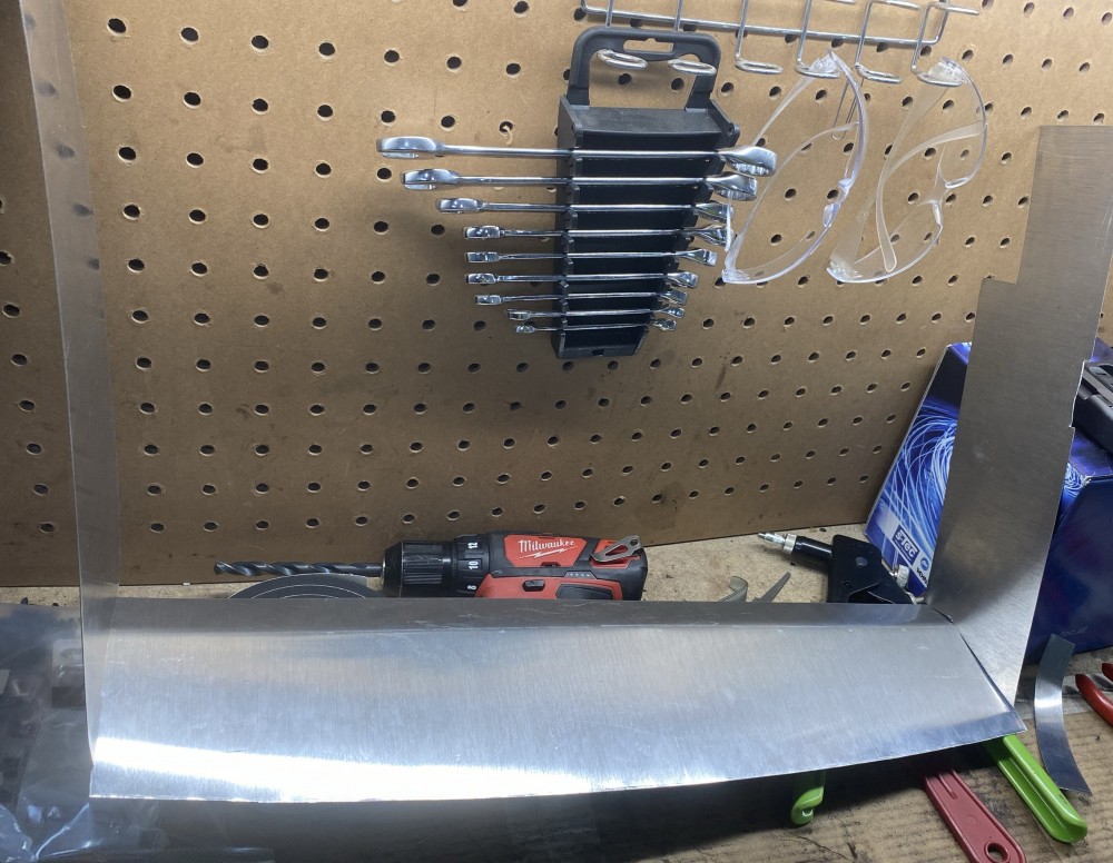

              Decided to make some ducting for the radiator.
              started by adding adhesive backed foam in between the core support and the rad, trying to block all the openings I could.
              you can see how wide open everything is in front of/on the sides the radiator

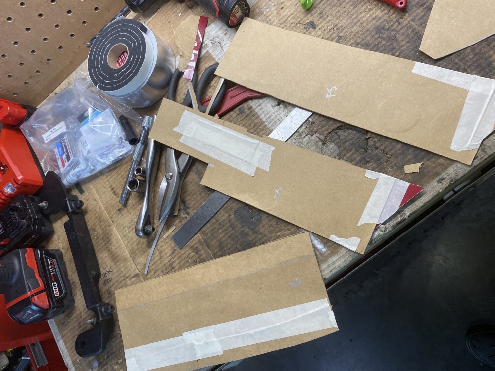

              then moved on to dr. Pepper box templates.
              transferred to some thin aluminum sheet
              there were existing holes in the core support that I had to enlarge a bit to use 1/4-20 rivnuts
              here’s the basic idea - it needed a bit more trimming to clear a wire harness1BBBDC26-9ACF-43BA-8FFC-DEB388E05997.jpeg
              holes drilled and installed. I added aluminum foil tape to the corners to better secure the 3 pieces together. Also used some adhesive backed foam in certain areas to eliminate vibration

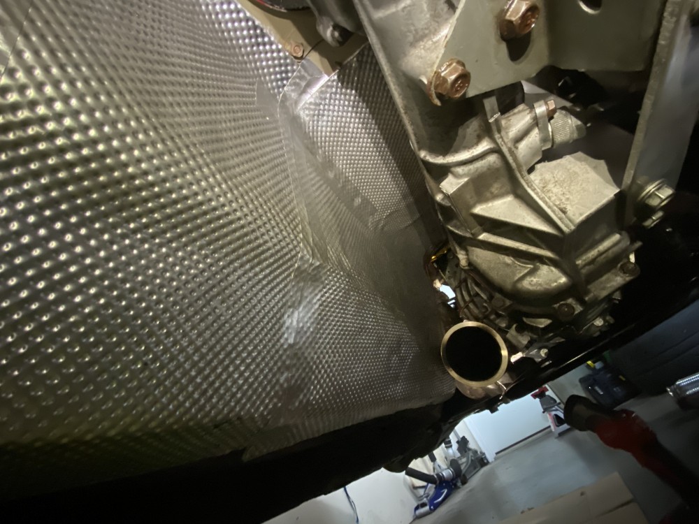

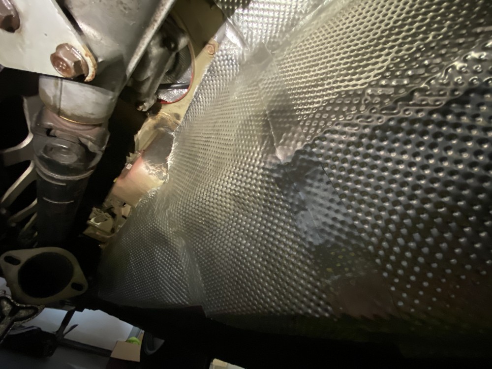

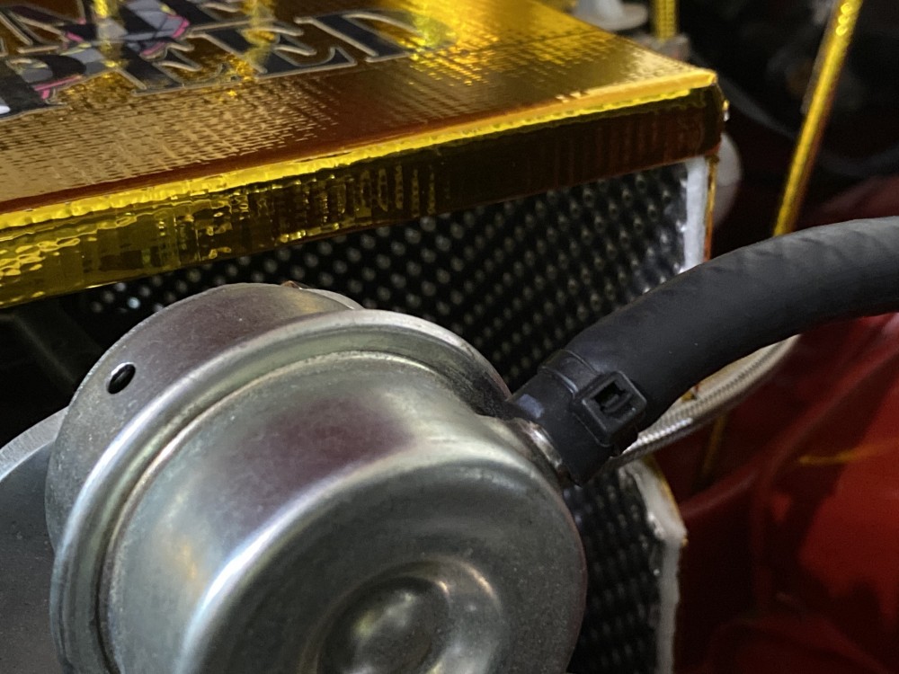

                in an attempt to keep the Miata cabin cool we added a turbo heat shield. Used DEI Floor and tunnel ii adhesive heat shield in the inside of the turbo shield and some reflective tape on the exterior. Also lined the entire firewall behind the down pipe and trans tunnel with the stuffC54BB289-D48E-4CE3-9DE7-94381B8B2E1E.jpeg
                F5659EF6-2BF4-40D5-BDFE-CF605A540EEE.jpegAD53358C-000F-46D0-9D84-94598A533916.jpegE1D7E604-1299-4F76-8365-AC2CAEC81DFA.jpeg
                only posting Miata content because that DEI heat shield stuff is awesome, an aftermarket product that actually works worth a crap. If your floor/tunnel gets too hot, I’d recommend this stuff.
