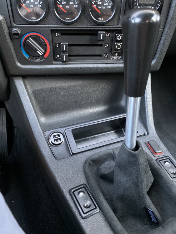

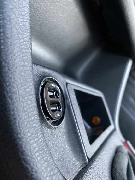

                                        This may seem dumb but I finally found a usb charger that doesn’t look like a giant tumor with 6 bright LEDs sticking 8” off the console.
                                        https://www.amazon.com/gp/aw/d/B00M6QODH2?psc=1&ref=ppx_pop_mob_b_asin_title

                                          Much more useful than a cigar lighter
