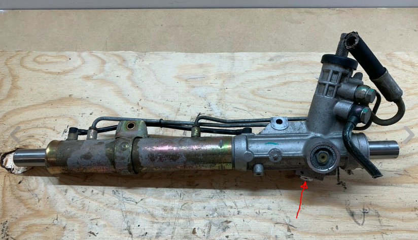

                                    We can collectively agree that the gear is not supposed to rotate within the rack, right?
                                      #867
                                      right, it should not rotate.
                                      The rack adjustment is here:
                                      Again im really unsure that it will do much in your situation but its a good last-ditch effort in case it has been fiddled with incorrectly in the past.
