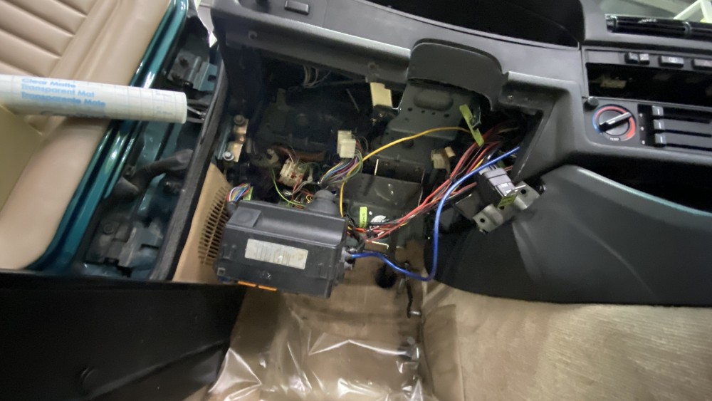

I started on the more frustrating part of the brake upgrade. So far I haven’t determined that I can use my airbag column per garagistics instructions. But they also said I need to remove my dash, and I proved that was a lie already.
Here is all the factory parts out of the car..

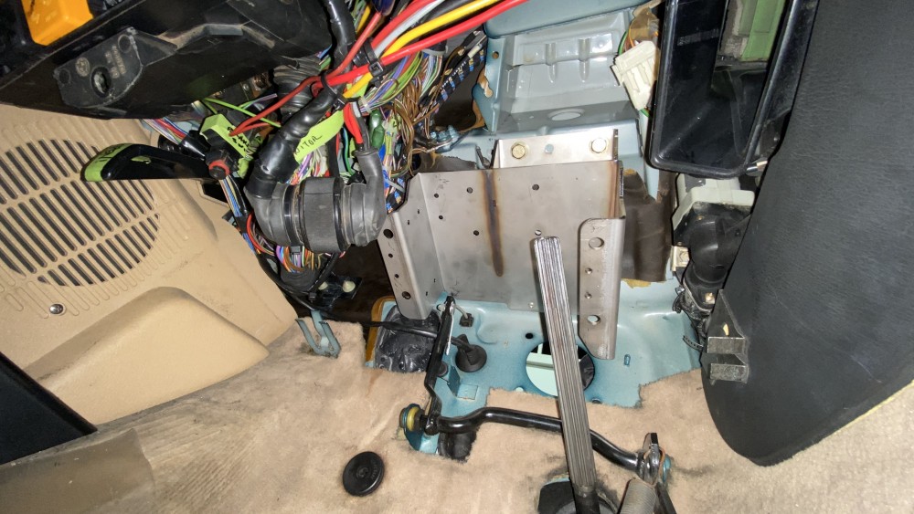

This is a shot of the garagistic bracket mocked up before I drill the holes in the firewall. I later noticed before I drilled the holes that I was off by 1 bolt and had to shift the whole thing to the left. I’m glad I noticed before drilling.

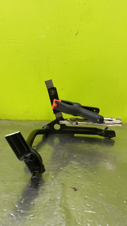

I also have to modify the throttle lever. Originally the throttle cable exits far to the left of the pedal assembly. I had to cut the cam portion of the lever as it hits the clutch pedal if you don’t. I plan on welding it above the pivot of the pedal itself. That’s what you can see mocked up here. What’s nice about this is that the cable will now exit right behind the manifold and give it a cleaner look.

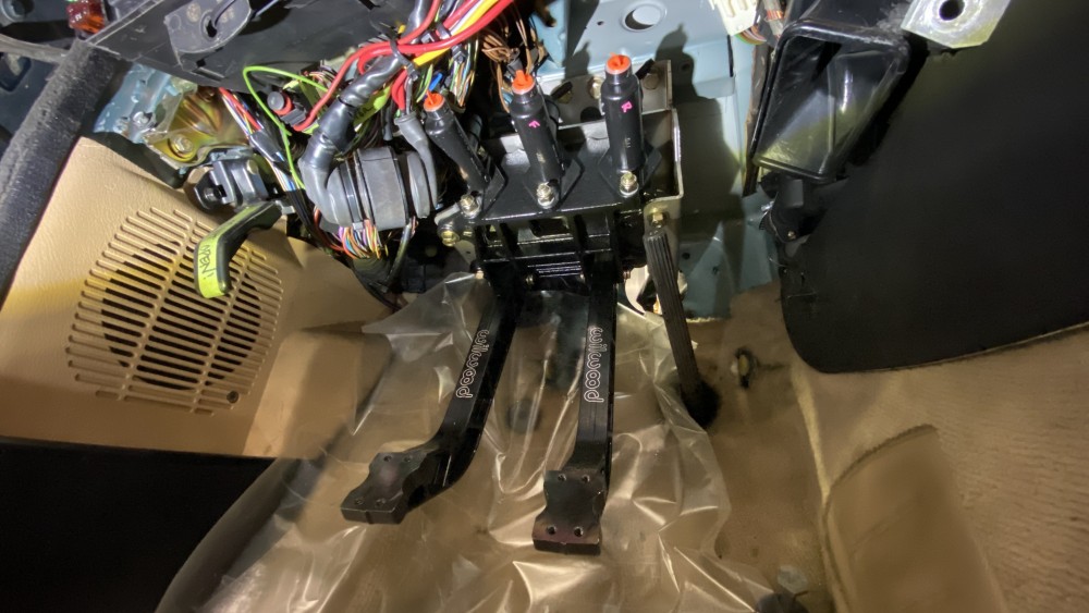

The pedals in their final resting place. Unfortunately they will probably come back out a few more times as I route the brake lines and reservoir lines.
here’s a shot of the bracket and bolts that you have to drill into the firewall.

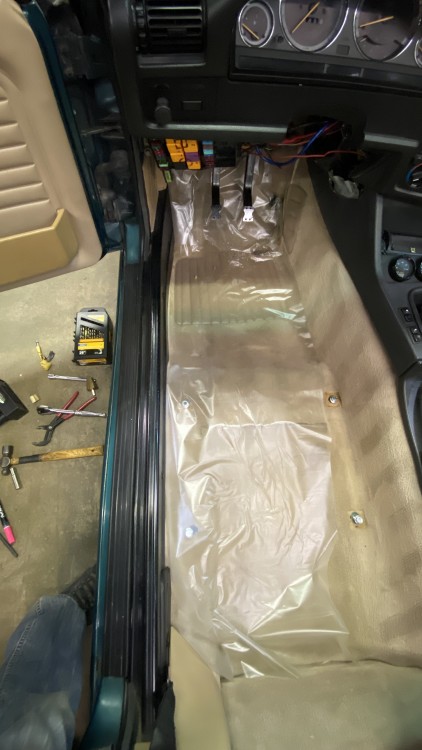

This last picture is just a picture of my carpet. I used drawer liners to protect the carpet from getting dirty as I’m crawling out from under the dash 40 some times fitting everything. I use this stuff all the time to protect surfaces. It doesn’t leave any residue and is around $3 for an entire roll of it.

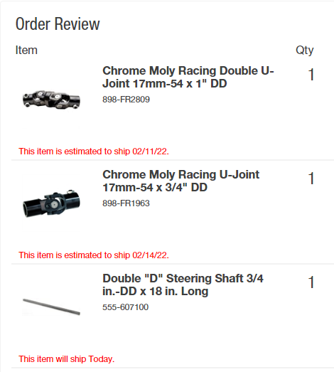

This is my solution; use a flaming river double U joint to make the "Z" and then a D shaft through the firewall and a second U joint to mate it to the Z4 rack. the second part im still not sure I have all the puzzle pieces yet. I previously made an adapter a few pages back in this thread to mate the Z4 to my column, but now I am using a D shaft, I will likely have to make a different adapter. I just ordered everything and will have to figure this out when I have everything in my hands.
If anyone knows the spline count on the shaft of a Z4 rack, please let me know. I looked high and low and found nothing. it measures to 18mm on a caliper, but I had a hell of a time trying to get an accurate spline count. It is NOT the 17mm 54 spline that is commonly used.
