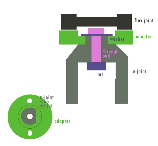

                                        First idea:
                                        Use the Z4 u-joint bit and fabricate an adapter so that it could be bolted to the rubber damper on the E30 bits. Welding on the cast piece probably isn't a good idea, but the stock shaft is attached to it somehow...?
                                          #488
                                          not sure how limited you want to keep the fab work on this but here's what popped in my head:
                                          leave a stub of the z4 shaft connected to the u-joint. cut a flat onto it and put a hole through the middle.
                                          key the flat into the adapter plate and put a bolt through to clamp the two parts together. a recess in the adapter plate could keep the bolt away from the flex joint.
