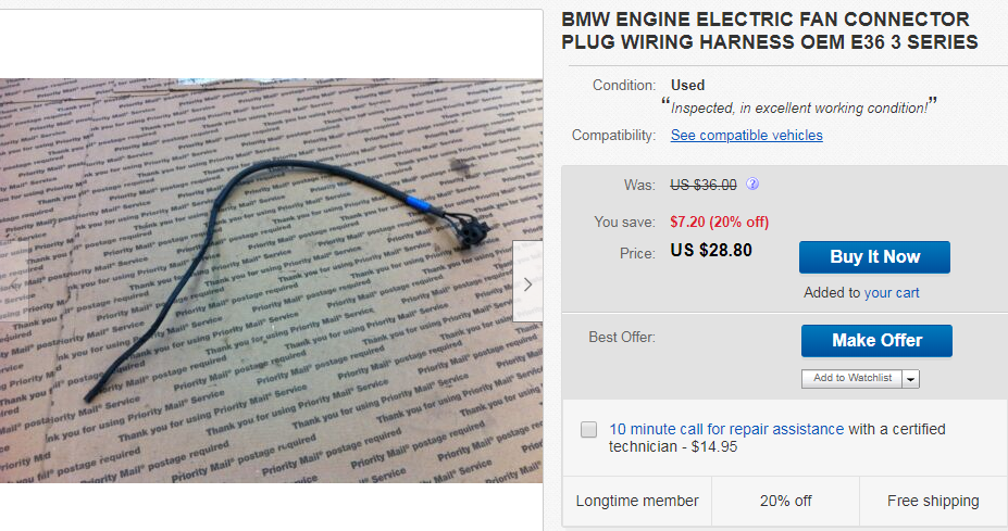

                            Anyways - can anyone confirm if these wires work with this connector? I need to replace the harness for the aux fan switch and I need this plug:
                            But I can't confirm if the 90 degree receptacle fits with that plug or if only the straight one does. The original plug for the temp switch has been discontinued.
                              i suppose 2 y.o. kids and fetuses don't really fit into the category of 'kids that will remember' LOL
                              that 3-pol connector is the straight plug style.
                              the 90deg one would has a very distinct flat cap on the back, and I think its NLA at this point

                                Correct. I have found that the 90* one has been discontinued. I found this post that labels the new straight connector but it seems to suggest the 90* plug fits? It's difficult to understand which connector works with which plug style.
                                I am not confident there is enough room between the aux temp switch and the headlight cover to fit the straight plug with straight wires. It would be very tight.
                                  #626
                                  you could certainly shove the 90 deg connectors into the straight housing, but you may need to modify it, and there would be no back cap that holds the plugs in. maybe you could just epoxy them in? you could also skip the plug housing completely and plug the connectors right into the sensor, you'd just have to remember/label the locations.
                                  i believe the 90deg plug might also be found on e36s, although realoem barely shows the existence of the part number. someone here parting an e36 maybe has one?

                                    I bought the connector and pigtail from someone and when I got it, the wires were bad and the connector fell apart when i accidentally sneezed on it.
                                      #628
                                      Yes the same one is used on an e36.  You may have the same crumbly results.
