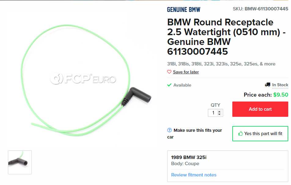

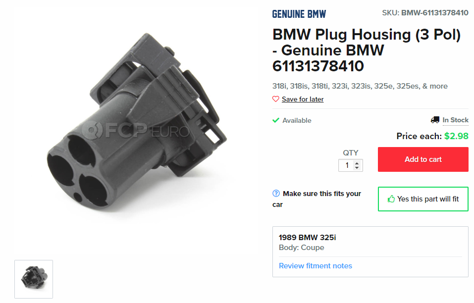

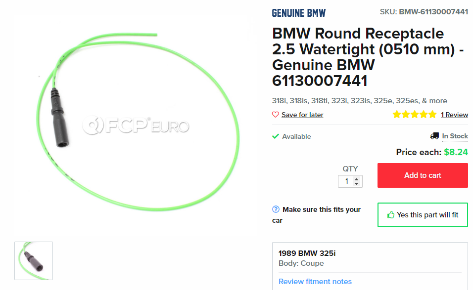

                                      Anyways - can anyone confirm if these wires work with this connector? I need to replace the harness for the aux fan switch and I need this plug:
                                      But I can't confirm if the 90 degree receptacle fits with that plug or if only the straight one does. The original plug for the temp switch has been discontinued.
                                        i suppose 2 y.o. kids and fetuses don't really fit into the category of 'kids that will remember' LOL
                                        that 3-pol connector is the straight plug style.
                                        the 90deg one would has a very distinct flat cap on the back, and I think its NLA at this point
                                        https://www.turnermotorsport.com/p-10467-61131378412-genuine-bmw-part/

                                          Correct. I have found that the 90* one has been discontinued. I found this post that labels the new straight connector but it seems to suggest the 90* plug fits? It's difficult to understand which connector works with which plug style.
                                          I am not confident there is enough room between the aux temp switch and the headlight cover to fit the straight plug with straight wires. It would be very tight.
