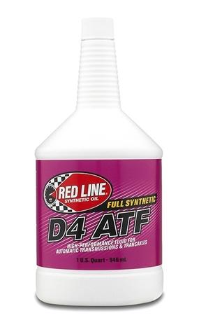

                        I like to experiment and feel like the cold shift quality could be improved so I am trying out some Redline D4 ATF.

                            How are the cold shifts now?

                                The amber looks great on the black. 👍 Let us know how the cold shifts feel!

                                    New fill plug came in the mail today so I was able to get it all buttoned back together.
                                    The shifting is improved MUCH more than I had ever hoped for!  The oil that was in it was clean and newer but maybe was on the thicker side. The Redline D4 ATF shifts cold like the other oil felt when it was hot. This is how it is supposed to be and I hope the shift quality doesnt degrade in 1000 miles. Im fine changing it every 10k though if I have to.
                                    The clutch delay valve removal and changing the trans oil have made the biggest difference in driving enjoyment and getting the clutch and shifter feel where they should be
